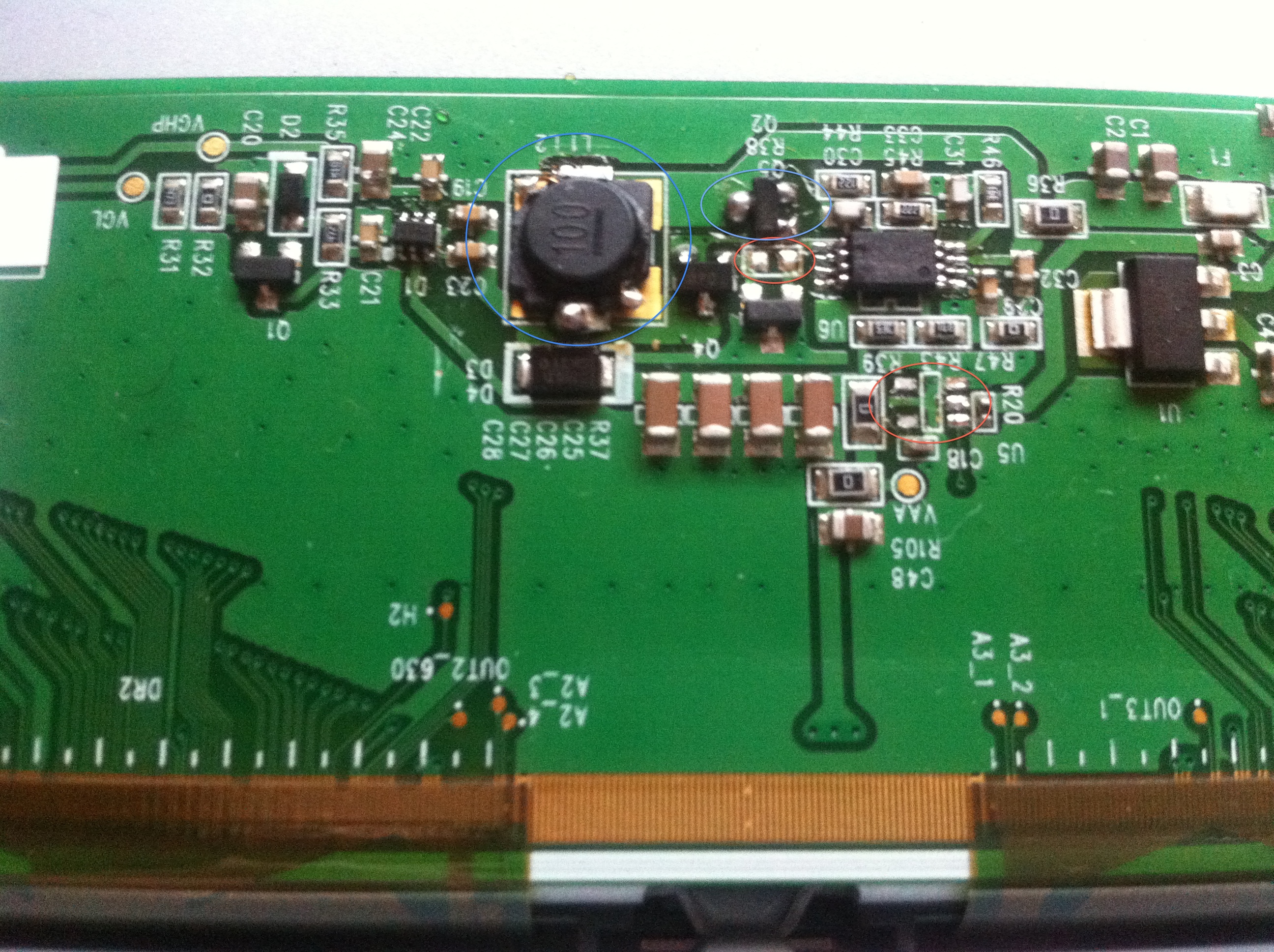

      Ok I am having bigger problems than i thought
      two parts on panel PCB are missing on picture they are marked with red
      and theres 2 new parts installed marked with blue
      Now i dont know whats missing and i cant find pcb schematics

                I did a research and i found that i am missing one component TC74A5-3.3VCT
                its Temperature sensor
                Tomorrow i will replace all Capacitors and i will check everything
                If T-CON board is dead can i use another board to replace it i have two monitors with broken display but they are LG Flatron 19"
                  Re: Fujitsu Siemens 23" LCD Scaleoview
                  The T-CON is part of the LCD panel glass assembly, you will have to replace the panel with the same model.

                    Is that a CHI MEI panel? model A220Z5 ? On mine that cap. is also not installed and U2 is marked:
                    MT
                    8J

                      it's A220Z1-P01 model
                      i tested panel with LG LS20WS MB and PSU and same results White Screen
                      Panel died

                          I just checked two M220z-L01 that I have here and both have the 5 pin part at u5 which I think is part # BD5237G-TR
                          The part in your orange circle is also not installed on mine
                          and the 3 pin part that looks resoldered is a K1P and probabaly part number MMBT2222A

                            On my board the 5 pin device is labeled U2, on yours its labeled U5

                                I did, on first fuse it's showing 4.7v before and after fuse
                                on second fuse 13.8v
                                but when display is disconnected and orange indicator light start on second fuse voltage bump up to 19.8V
