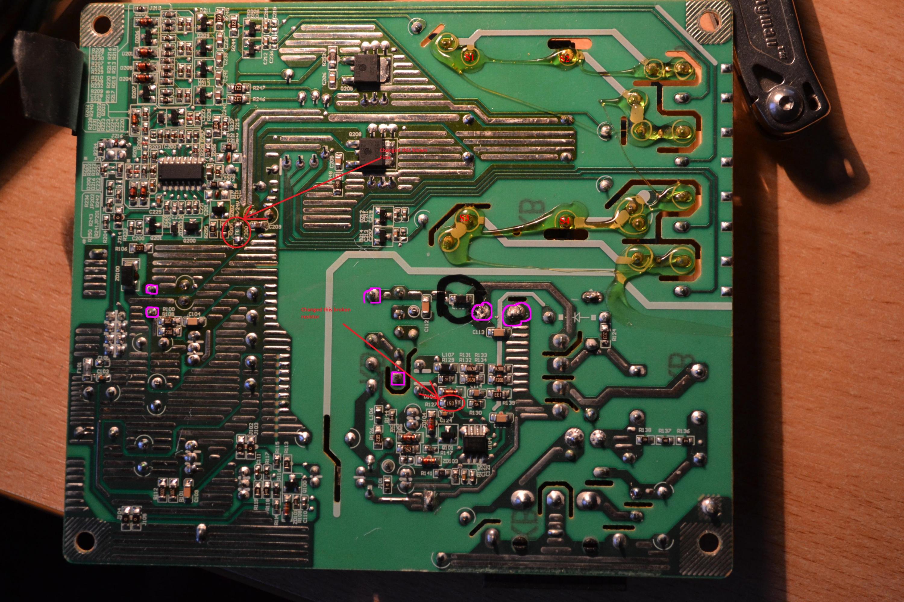

    I have a problem with Viewsonic VX2255 monitor, got it from my friend.
    When I turn it on, the blue light lights up for 5 - 10 seconds, the screen flashes and I can see something on the screen with my flashlight. After 10seconds, it turns off. I've replaced the F200 fuse and one resistor. I've also browsed several threads about this monitor with no luck. Also, when it the monitor goes off ( red light) Then I can hear a buzzing sound.
    Picture of the board :

    Pictures of the top side of the board? Any bad caps with domed tops?
      Re: Viewsonic VX2255WMB No Backlight/screen (With video link)
      No, all the caps seemed to be alright to me, picture of the top side :

              Secondary Resistance - You will need to get the Glue/Laquer off the
              test points - Power OFF - Meter on Ohms 2000 test S1 to S2 and S3 to S4
              I have also marked some solder joints in pink? It may be the picture but they look like they may need a reflow- try and remove the old solder and add fresh.- look for more with a magnifier.

                          I measured the resistance of the two big smd transistors behind the board, got readings from 300 ohms to infinite, does that mean the smd-s are open?
                            OK - First test your small fuse again.
                            Next to test would be the fets on the back. 9973GH
                            See this thread for instructions - Read the whole thread
                            https://www.badcaps.net/forum/showth...ghlight=9973gh

                              F101 : 0.3ohms
                              F200 : 1.3ohms (this fuse was blown, replaced it before I started this thread )

                                Monitor is ALIVE!!! The problem was still with that F200 fuse, the one I replaced was still bad, so I replaced it again and now the monitor works!!!
