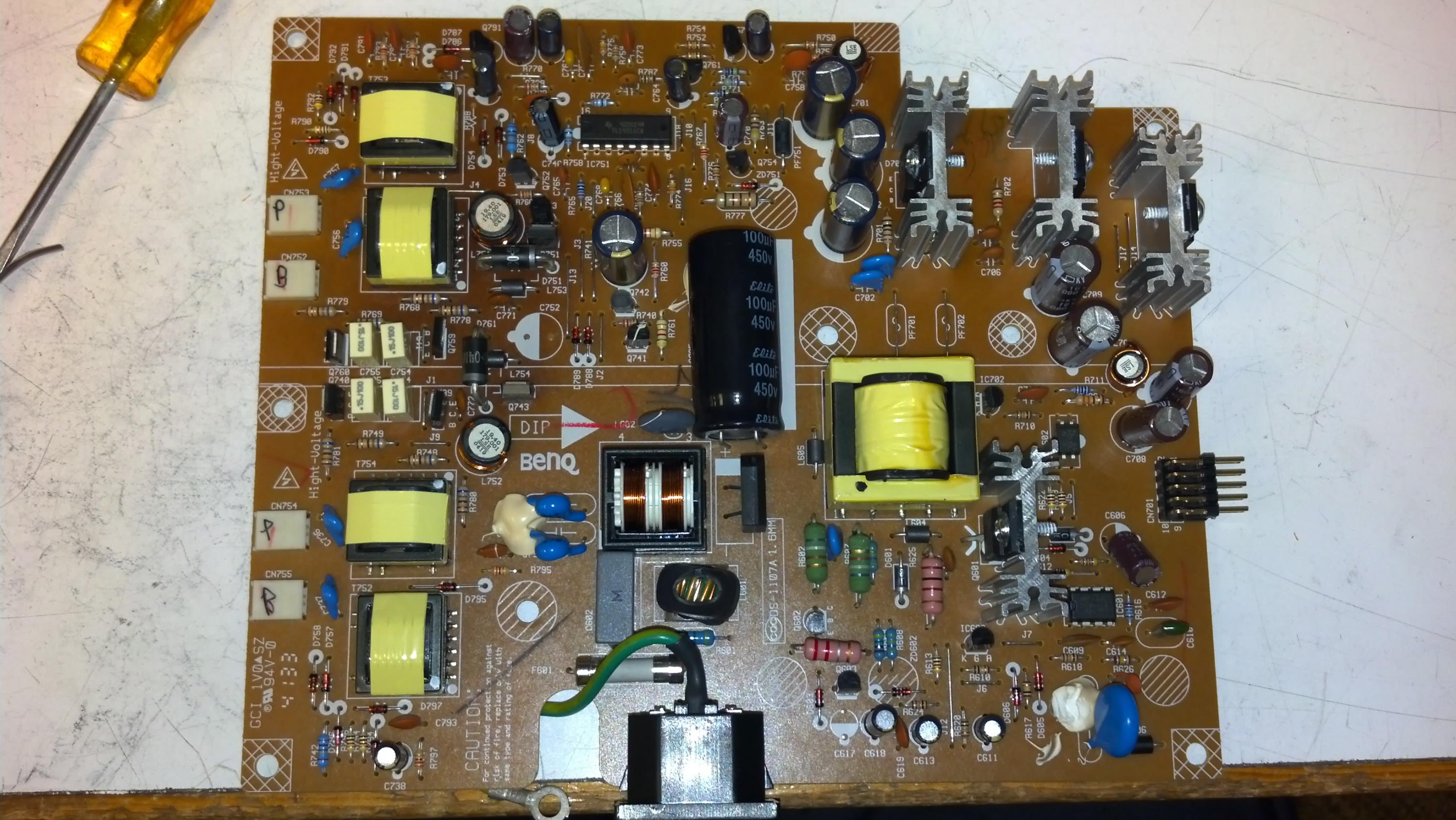

    Dell Monitor blinking LED

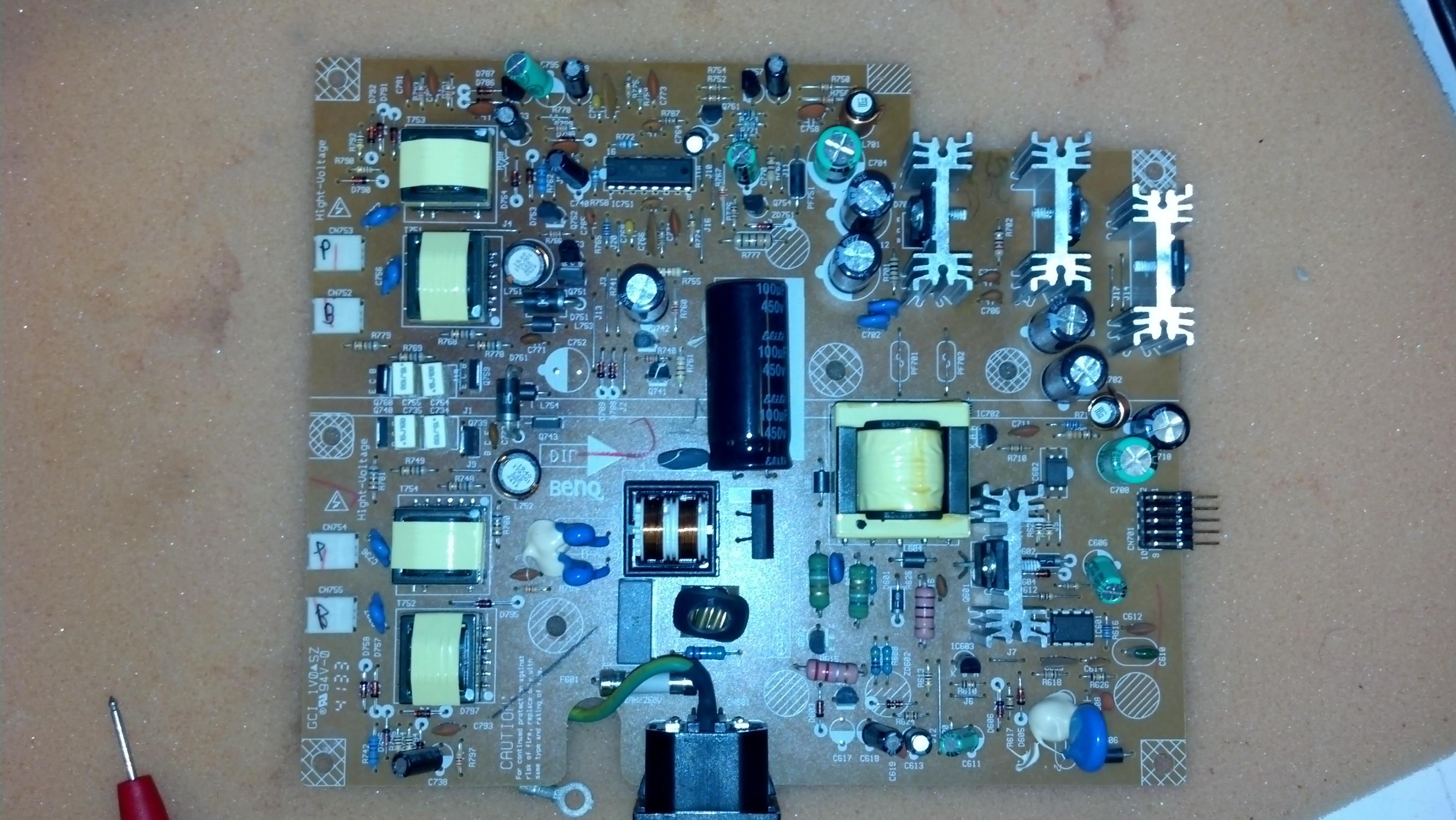

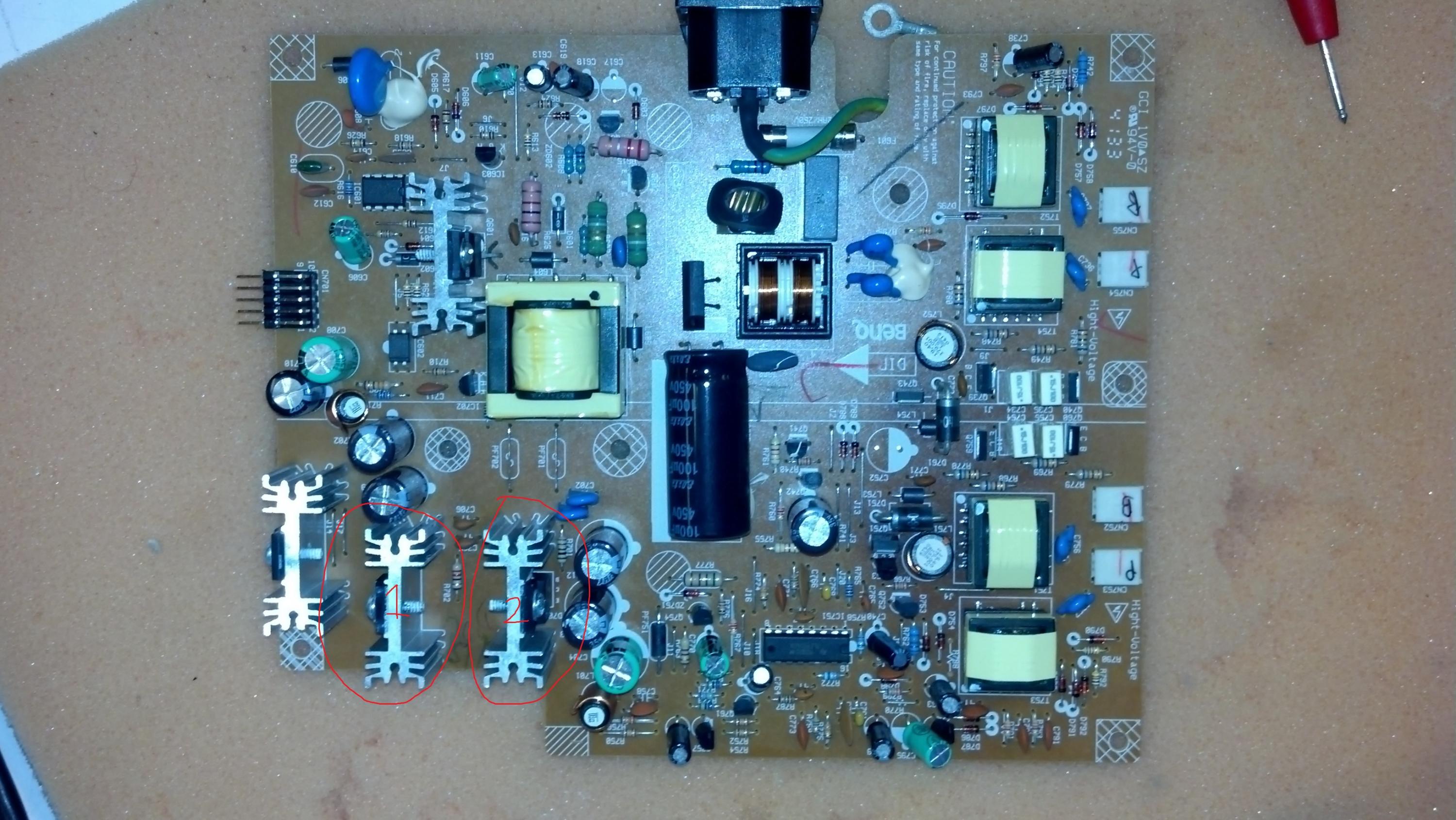

    This thing on rare occasion will turn on for a split second, most of the time just have a blinking LED. Fuse F601 and PF751 tested good. 164V across the input cap. Diodes D751 and D761 aren't shorted. I think the problem is either with the caps or the voltage regulator on the main board. That regulator U10 (which reads G061 950T65) acts very strange:
    Pin 1: Bounces between 0.985V - 1.300V
    Pin 2: 0.00V
    Pin 3: Bounces between 0.980V - 1.060V
    Could that be one of the caps next to the regulator? All the caps in this thing are trash (It is a Benq afterall...) The power board has Lelon/Elite and the main board has Lelon/Jamicon/Elite

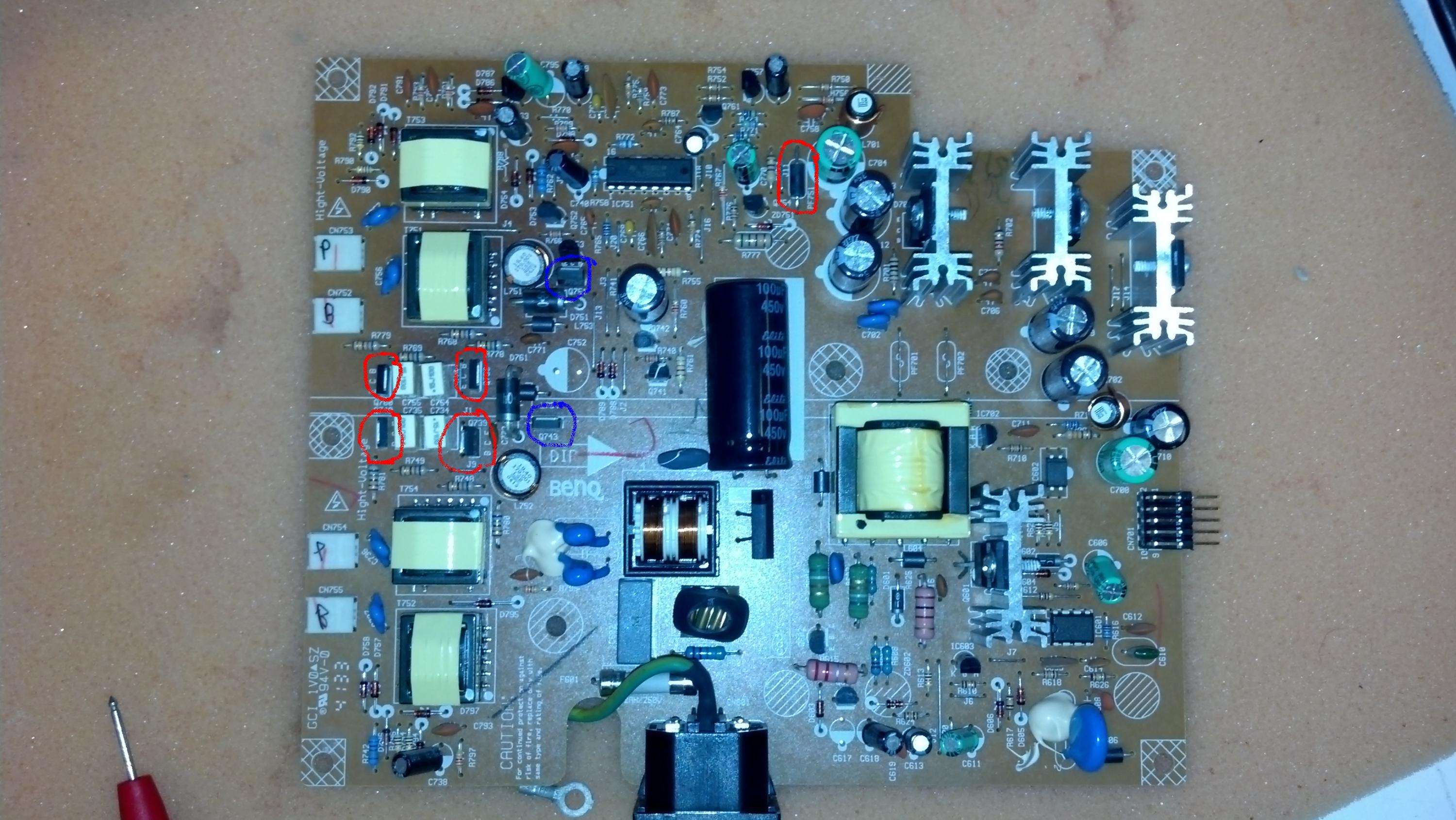

    Re: Dell Monitor blinking LED
    Hmmm .....
    This has so many revisions and yet they have the same common issue.
    If my memory isn't that fuzzy :
    - Check/replace Q739, Q740, Q759, Q760, Q743, Q751
    - Resolder T751, T752, T753, T754
    - Replace all secondary caps

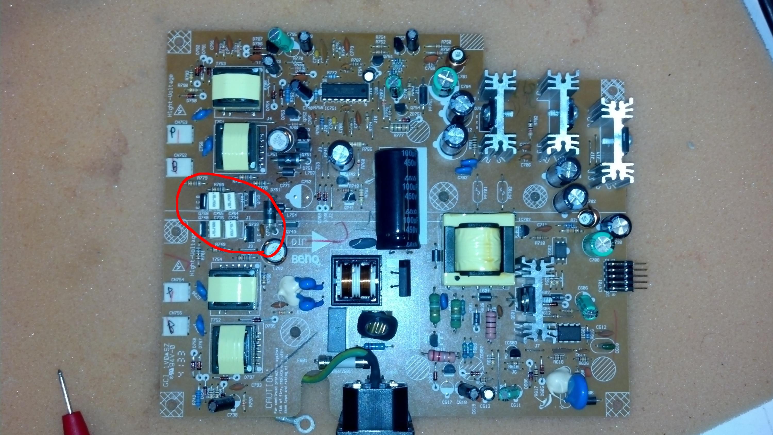

      Check those 4 inveter tansistors 2SC 5706/5707 for low resistance reding between E and C, and yes, the solder joints
      Which Dell is this?
        It's a Dell E172FPb. All the joints look good on both boards, could they still be bad? When checking the transistors which legs are E and C? Well some are labeled some aren't
          #1 it gets < 1 Ω, and #2 gets 7.7 Ω
            These are the transistors that usually shorted out.
              All of those between C and E (going both ways) either tested ~7.3Ω or ~287Ω. So I replaced just the secondary caps and now the voltage regulator on the main board is still drastically fluctuating but now the voltages are lower (the low and high) Can that indicate anything?
                Yeah. retiredcaps knows this board very well. It's the "BenQ board". It's almost always one of the inverter transistors circled in red. Or 1 of the 2 circled in blue. And also check the picofuse circled in red.
                    Shorted. They are bad.

                      • retiredcaps
                        • Apr 2010
                        • 9271
                        All of them? Do I need exact replacements? Oh and by the way I tested them still soldered to the board. Did I need to desolder them before I tested them?
                        Desolder all of them and verify out of circuit. We generally recommend they be replaced in pairs.
                        The c5707s are sold as "kits" on ebay because these Benq have known problems.
                        http://www.ebay.com/sch/i.html?_trks...313&_nkw=c5707
                        Resolder all your inverter transformers regardless how they look.

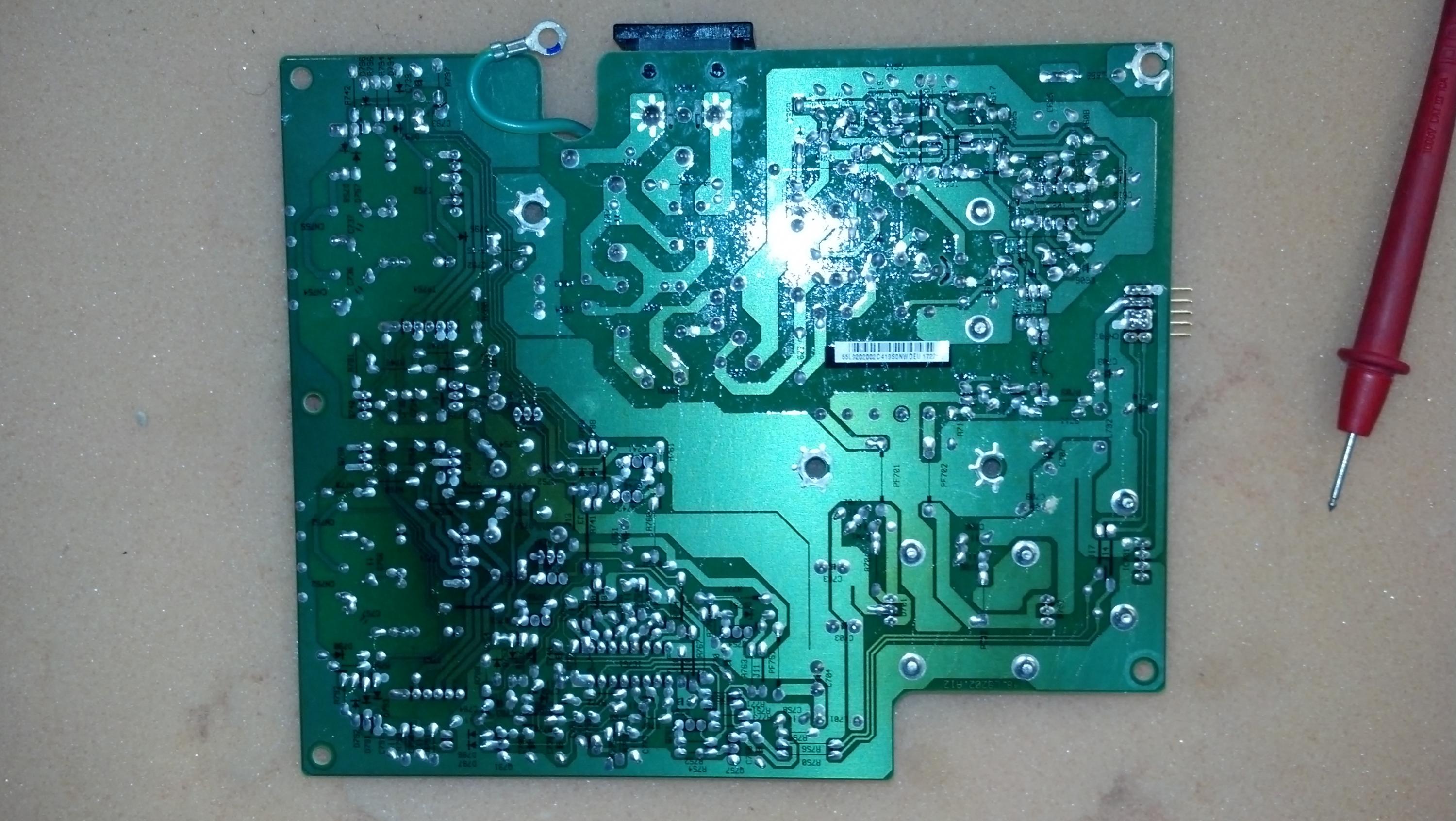

                                      I have skimmed through and cant see it - you should also resolder the joints on the capacitors between the 5707s
                                        I replaced those transistors, replaced all the caps, and re-soldered all the joints of the 4 inverter transformers. Now it will turn on but I have to use a flashlight to see a picture. Could one of the inverters be bad?
