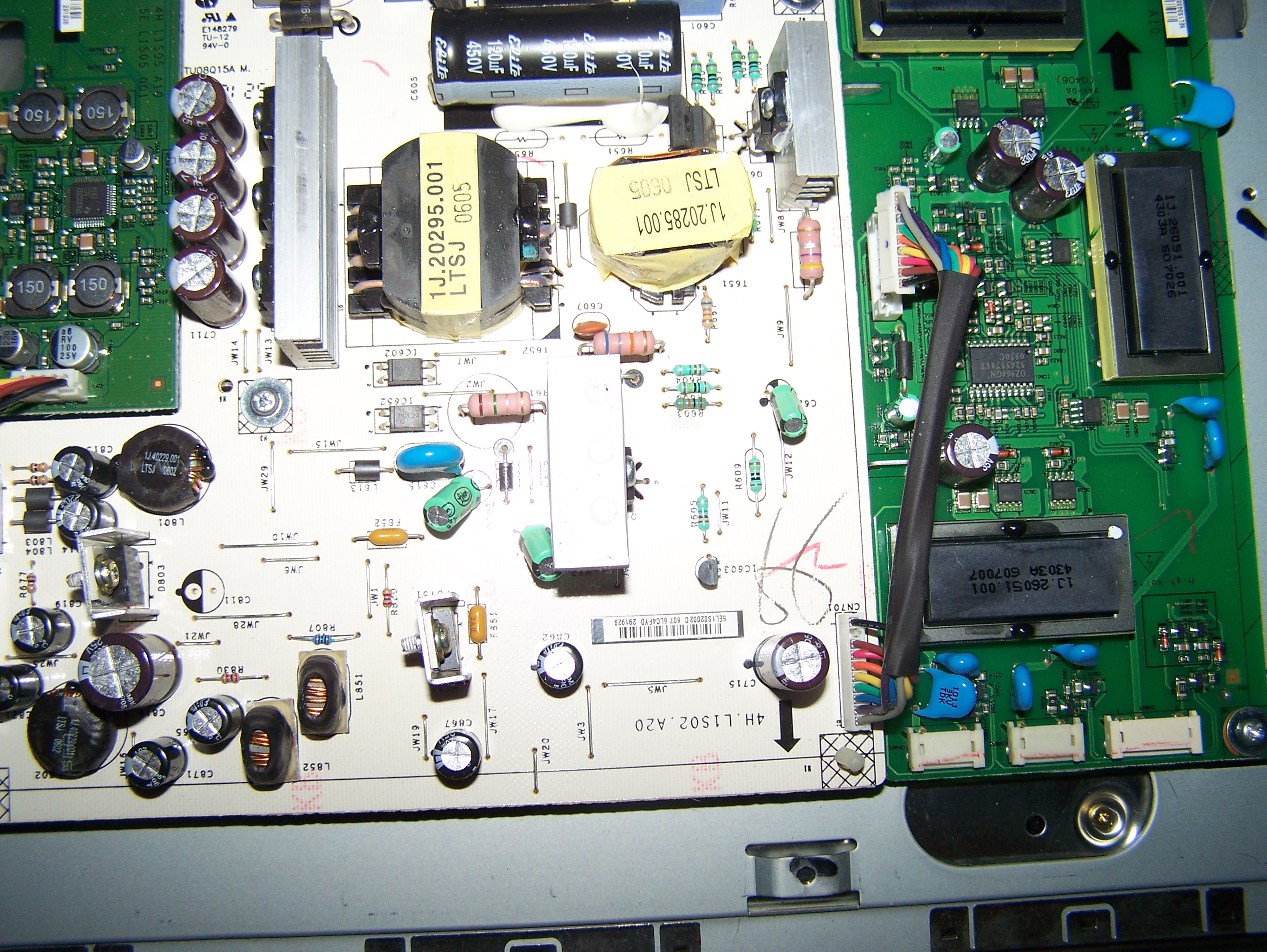

    i have had this f2105 for a while and when i got it i searched google and everyone said the ccfl's were bad. and at that times i didn't wont to put $60.00 into it, a while back bought a strip of water proof flexible smd 5050 leds. so last night i took the screen apart and the strip of leds fit right in the ccfl tray, this morning i put it back together for testing and hooked the two led strings to a computer psu, after testing i find the the psu on the monitor is putting out 18.98v and 3.3v and i need 12v @ .75 amp
    do you think a voltage regulator will work? i was thinking of using a TO-220 L7812CV will it have to be heat sinked ?
    psu for monitor is a 4h.l1s02.a20 but i can't find a pdf on it.
    where can i pull the voltage for the regulator i was thinking right off the plug for the ccfl inverter being it is a spare part right now.

      i was going to take the inverter pcb right out it is a separate board and the monitor works with out it hooked up, and take the power from cn7 of the psu pcb.

            The power supply takes 19v and outputs 600v on those connectors to the CCFL lamps. Be careful what you do there, I hope you don't plan to connect the leds to the old lamp connectors.
            The controller on board takes 19v and generates AC to the lamps at about 200 Hz, then uses PWM to change the brightness based on an input voltage from the other board... with leds you would ignore that adjust wire.

              Actually, the AC supplying the CCFl's is closer to ~50kHz. The PWM-dimming frequency's around 200Hz

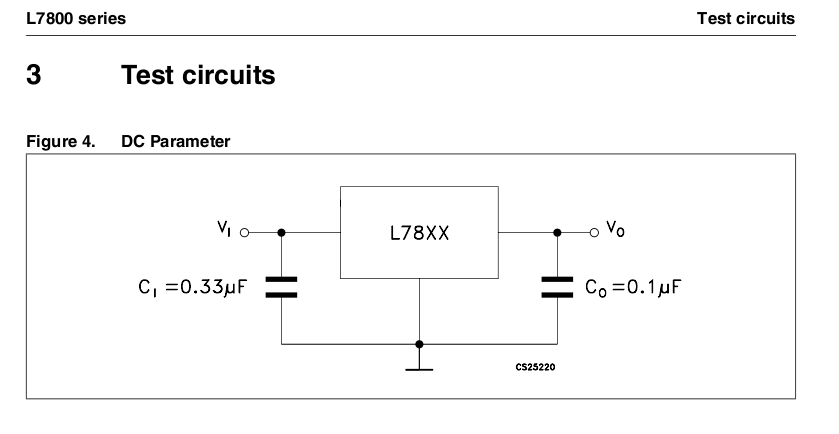

                do you guys think i should put caps before and after the voltage regulator as the pdf shows for test conditions .

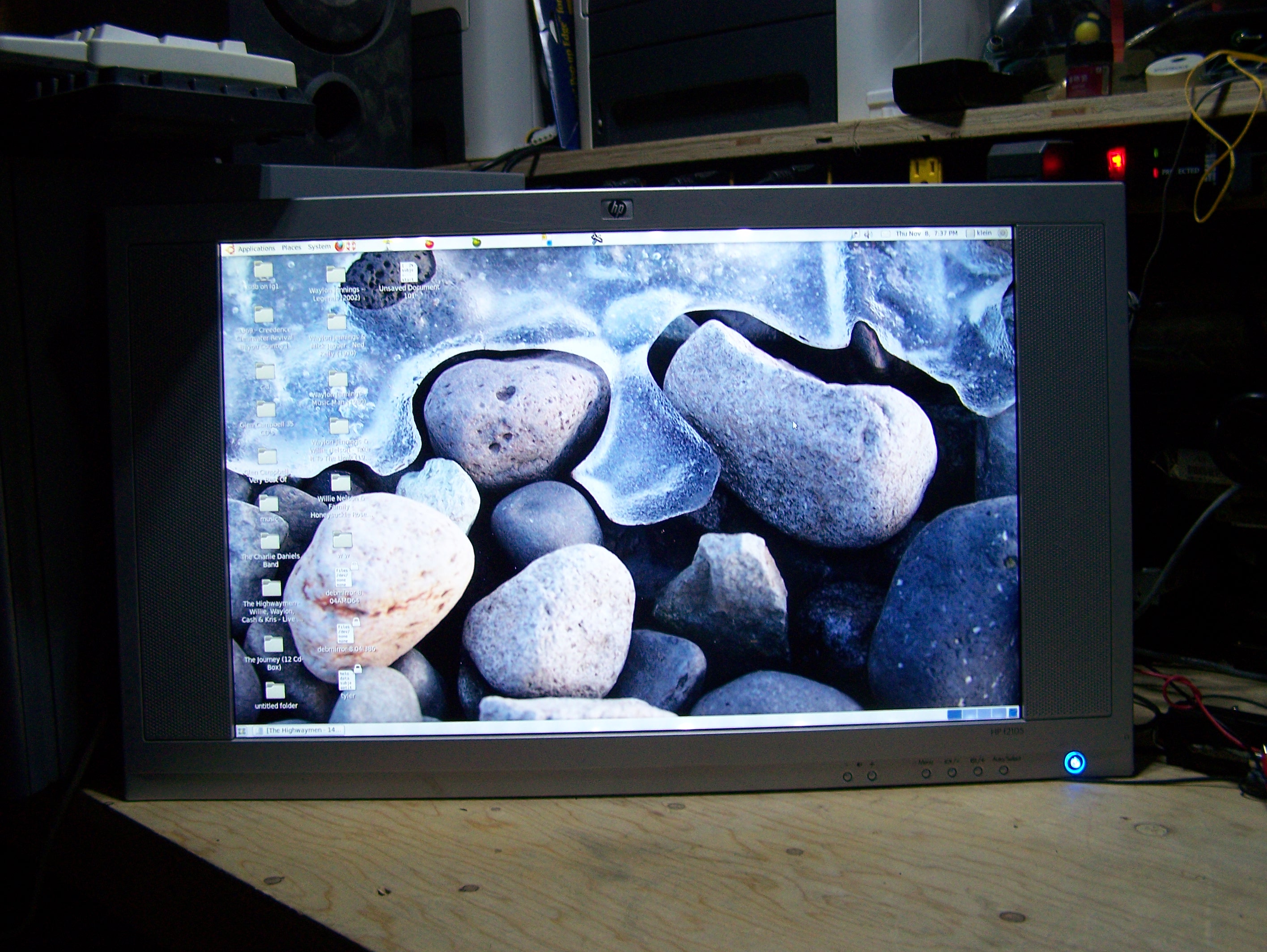

                        Just out of curiosity, since you put the monitor back together, can you please post a photo of what the monitor image looks like with the 2 LED strips lit? I'd like to see how bright and uniform the light is.

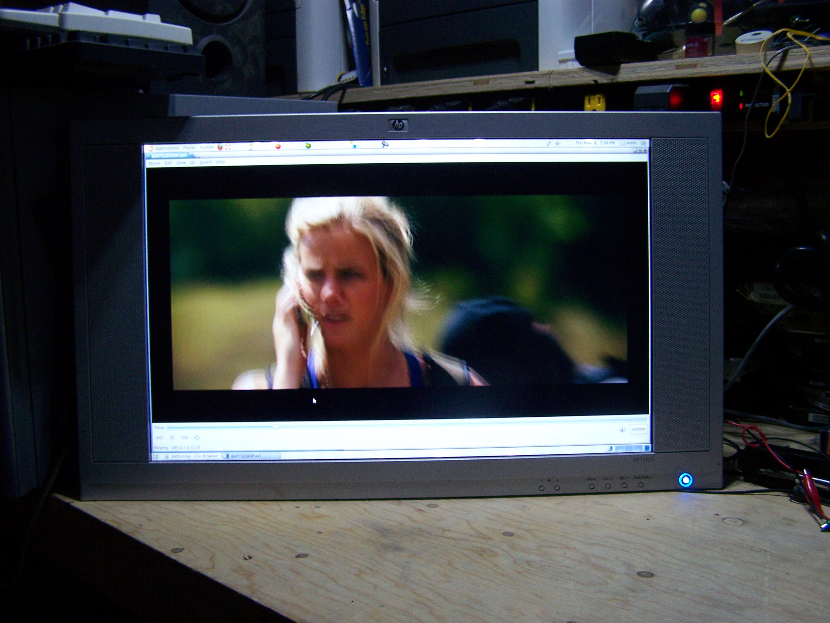

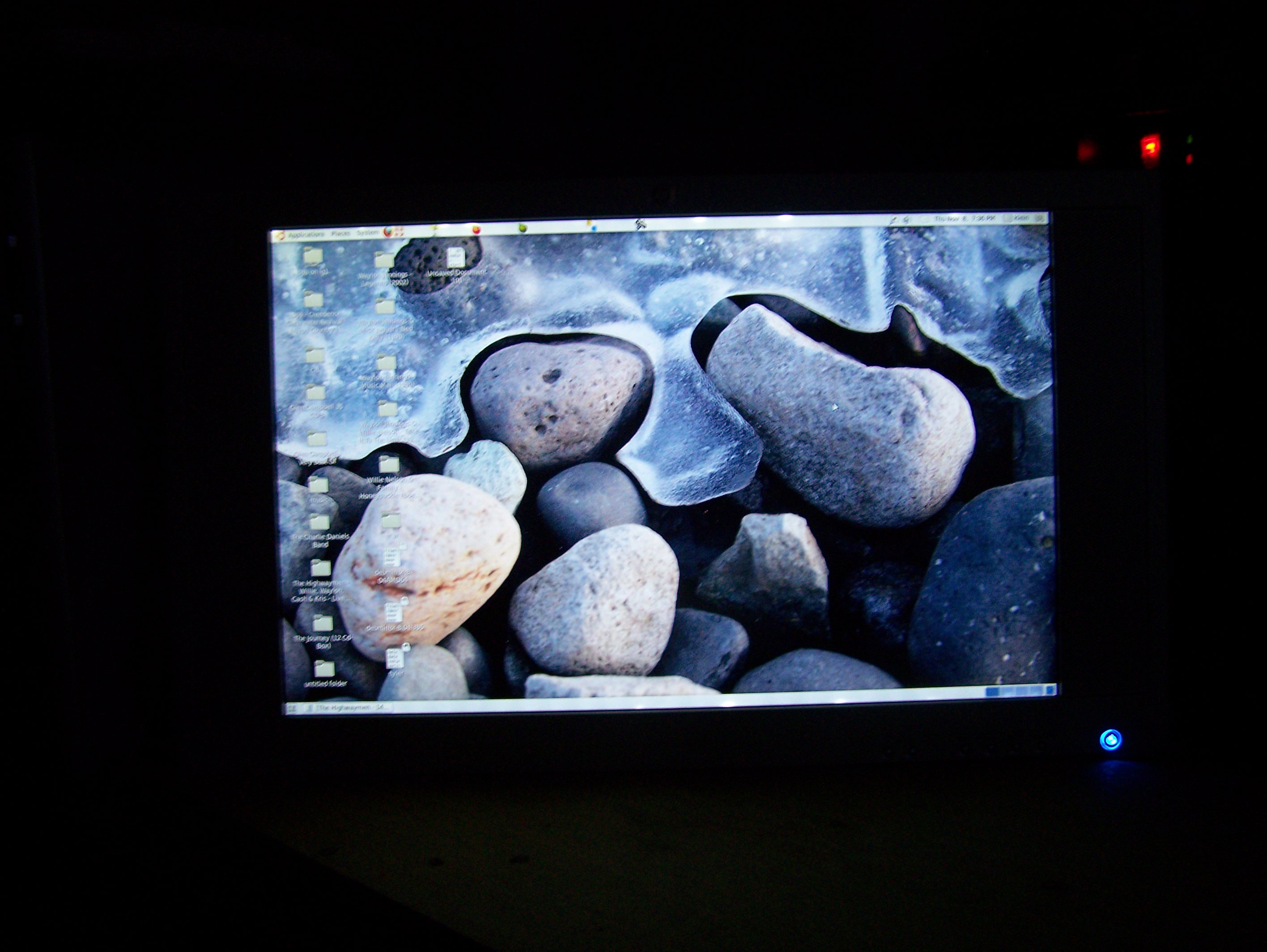

                          ok here they are :
                          lights out
                          lights on
                          lights on movie playing
                          you can see some of the leds at the top and the bottom but when i put the strips in i didn't stick them to the pans, if they were stuck to the pans you wouldn't see the led i believe.

                            accentual monitor looks better then the pictures
                              Re: hp f2105 conversion to smd led
                              It looks really good.

                                One of the better repairs I've seen using a LED strip as a substitute. And much cheaper than new ccfl's!
