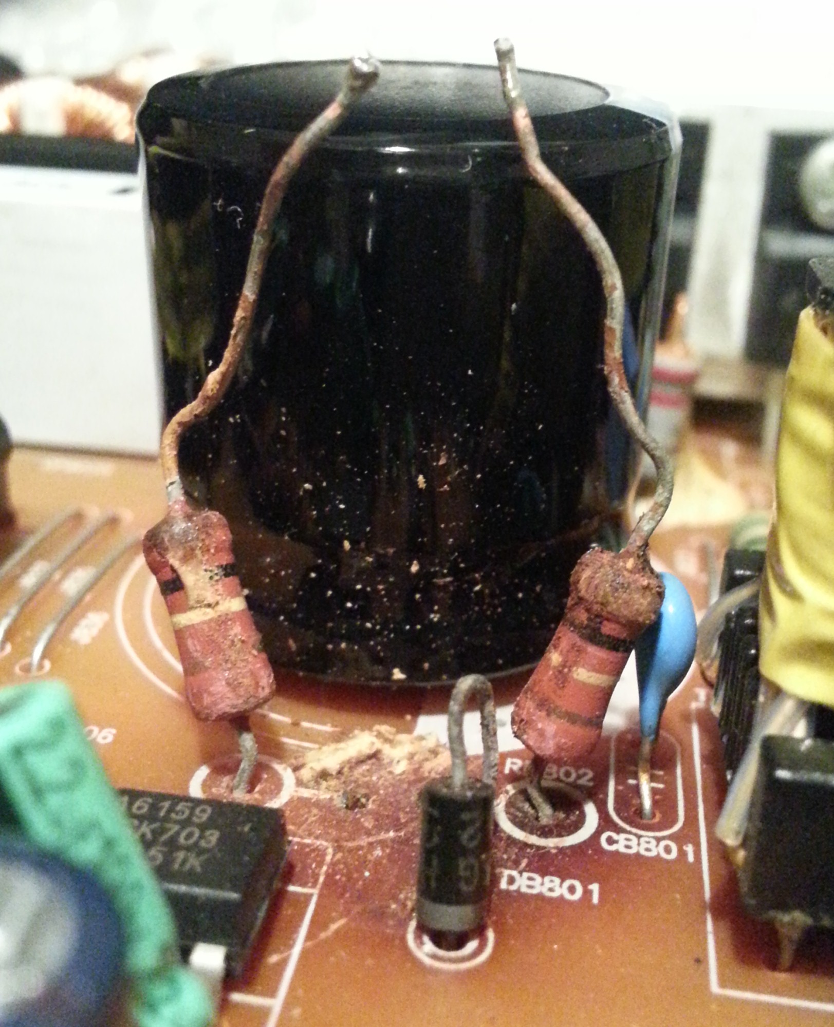

        The two resistors measure (with the meter setting at 200k) 98.1 (left) and 100 (right)
        The colours (not clear from this angle in the picture) are Brown-Black-Yellow-Gold which I found out that it amounts to 9.5 and 10.5 Ohms, so I guess that is correct.
        Yes I must figure a way to remove the glue without causing more damage.
        As I said earlier I am not very good at soldering/unsoldering and neither is my equipment, so I would really like to avoid replacing the caps, if you guys here think that the caps I used as replacements can cause the exact same problem as the original ones then I will get any brand you suggest, but I would like to make sure before changing them again that the brand I used is the source of the problem. If I manage to get the screen working with these caps I will definitely invest into getting better caps for the final repair.
        I have realised this power board that samsung used also in other 24" displays is problematic and I have read many other posts on this forum proving it, they seem to be able to have a great variety of problems. And it is discouraging that even gurus like Toasty and PlainBill among others have a hard time diagnosing this power board (ok their hands are tied if they have to go through questions instead of actually checking things themselves).

        2) How can I measure the diode in the image infront of the two resistors? My meter has a diode symbol and with that it shows that it works in only one direction (as supposed)

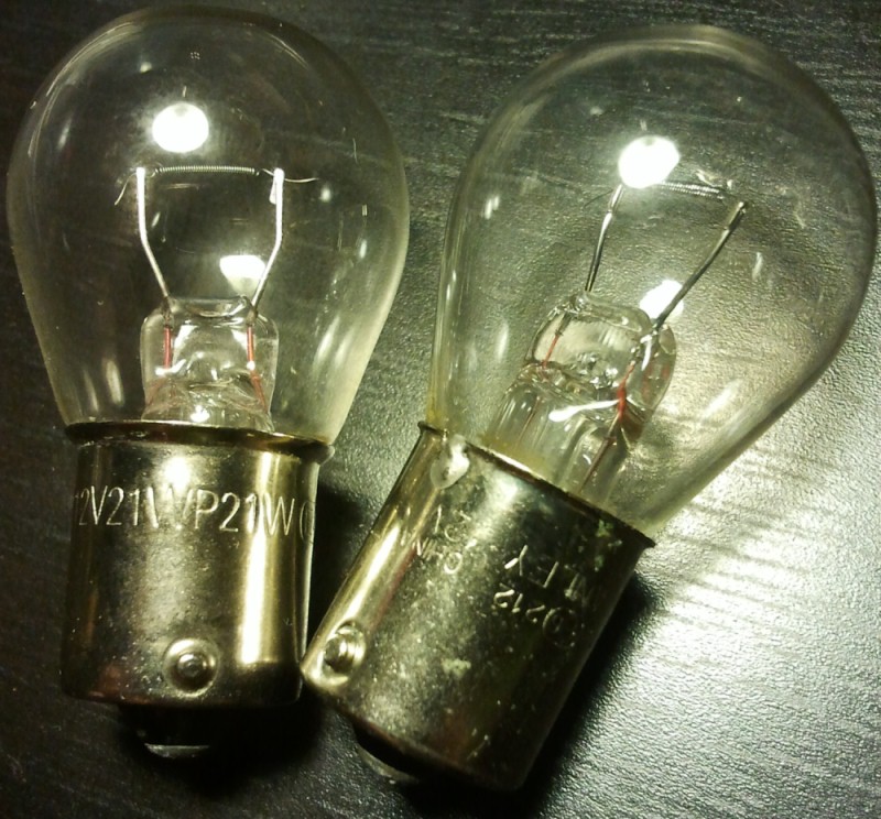

          You can use two 12v car lamps in series to chek the out put of the 24v power supply, if it is fluctuating then you can easily see with the lamps connecred.

          ALL the glues should also be removed as you can see in this thread:
          https://www.badcaps.net/forum/showth...965#post274965

            Ok, I think I might find some old working 12V car lamps somewhere.....will try tomorrow hopefully.
            This is to check the 24V output to the inverter, right?
              Re: Samsung 2493hm flashing backlight
              Just do not use the head lights, too low cold resistance which will cause the power supply to shutdown. Not sure what you have in Greece, I use 1157 lamps low elements to start with in the US.

                  Ok, I dont have at hand car lights, so I guess I will go buy some cheap ones for my bikes turn signals.
                  I did try two 12v 10W ikea lights and they light up nice and bright with no flicker at all when connected to the 24v output to the inverter (inverter disconnected)
                  • radicalmjp
                    • Oct 2012
                    • 22
                    • Greece
                    #29
                    Ok , removed most of the glue and where I didn't yet I at least cut and separated it from most components(will remove it all), this damn thing is like a chewing gum stuck under a cheap cafeteria table for 10 years... the purpose of this yuck eludes me as it seems randomly dropped on the board....why does a simple resistor need to be secured with glue, or a single capacitor but not the rest of the resistors?
                    Did the test with the two 12v lightbulbs from my motorcycle turn signals
                    With the inverter disconnected the lights turn on nice an steady and bright.
                    With the inverter connected the lights turn on nice an steady and bright.
                    I assume these results mean the power supply is ok and that the inverter should be the cause of the problems, right?

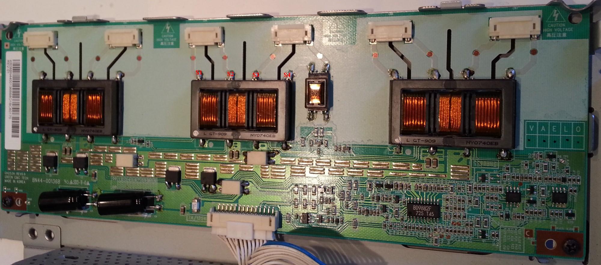

                        Update!
                        I ordered a used inverter (yes I cheated) from ebay and installed it today. The screen works, turns on but if no input is connected it scans for inputs (digital/analog/hdmi) and after few seconds it starts flashing, until it is completely black. If there is a video signal from a PC then it turns on for less than two seconds and goes black, so I guess unless anyone suggests something I will study the "two seconds to black" thread.
                        Note: if the screen has been resting for some time it takes longer to go blank. If it's still `warm` it goes immediately into flashing.... as if something is overheating.

                                #35
                                Transformer measurements
                                Old inverter board (fully disconnected from power and ccfl's)
                                transformer #1, S1+S2: 1712 ohm
                                transformer #1, S3+S4: 1700 ohm
                                transformer #2, S1+S2: 1754 ohm
                                transformer #2, S3+S4: 1719 ohm
                                transformer #3, S1+S2: 1747 ohm
                                transformer #3, S3+S4: 1694 ohm
                                New inverter board (fully disconnected from power and ccfl's)
                                transformer #1, S1+S2: 1662 ohm
                                transformer #1, S3+S4: 1654 ohm
                                transformer #2, S1+S2: 1640 ohm
                                transformer #2, S3+S4: 1634 ohm
                                transformer #3, S1+S2: 1664 ohm
                                transformer #3, S3+S4: 1654 ohm
                                Power board output to inverter measurement
                                Measurements of new (used) inverter installed and plugged
                                when ccfl are on 27.1V
                                when ccfl turn off with video input 27.9V
                                could it be some over voltage cut out thing?
