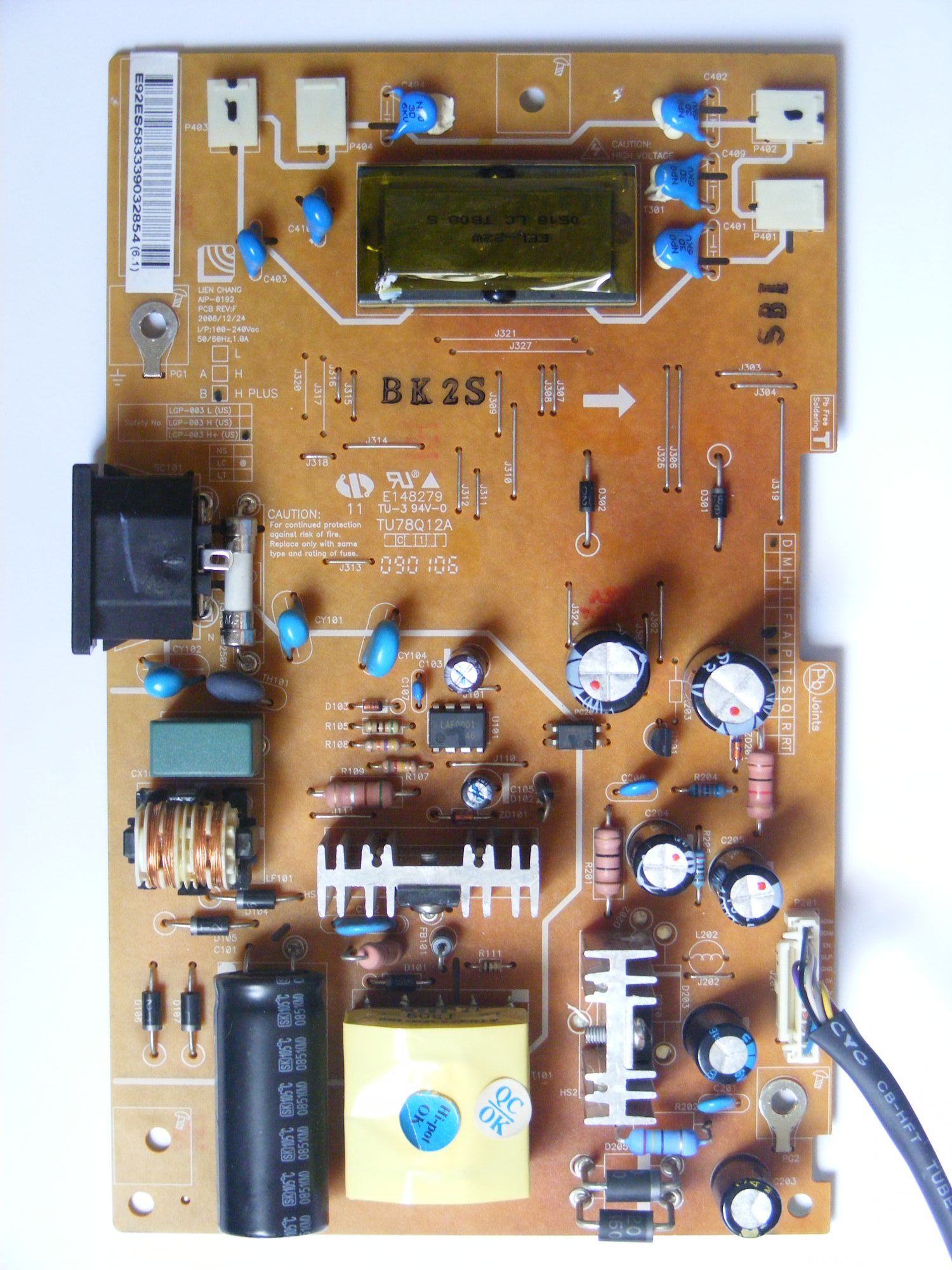

    First of all, I wanna say hello to this great forum and its inhabitants. Found some interesting readings here through google, before decided to register myself.
    Now to the point. Bought this monitor new in 2009. Served flawlessly for 3 years, until started to get sleepy. First it happened once in a couple of weeks, then days, now it's hours and minutes.
    How it looks
    Screen suddenly goes black. Power LED still shows active state, but all of the touch sensitive controls are unresponsive. After reconnecting power cable monitor might turn on, but for a while. Working time decreases with each reconnection, until it becomes minute or two. After resting for a couple of days it's again hours (looks like some capacitor related behavior to me).
    What I tried
    First thought about some software problem (drivers, DVI frequency bug, corrupted EDID, etc). No result.

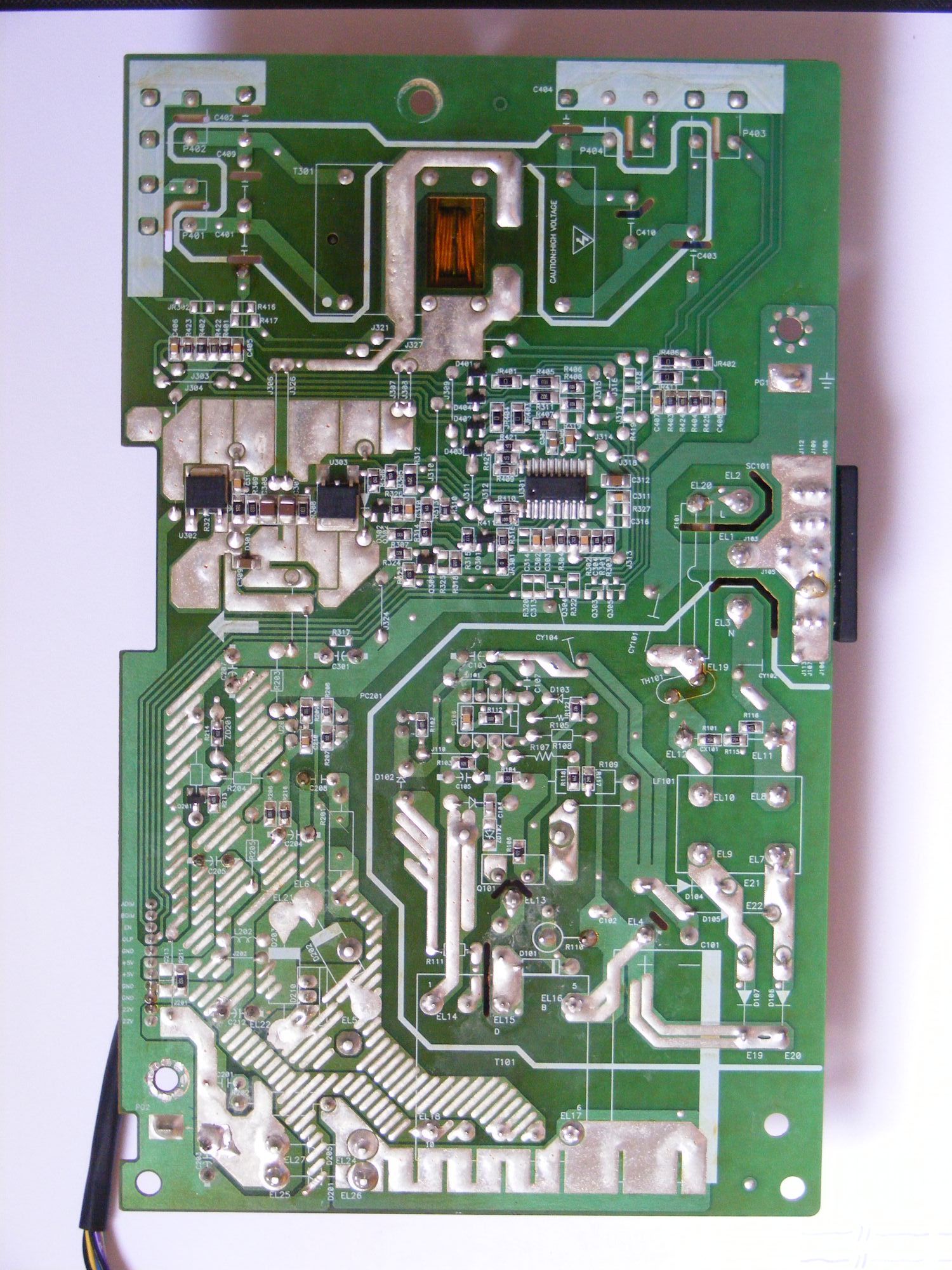

    So here comes hardware. Didn't managed to see anything with flashlight. After opening I saw one bulged cap on power board and blindly changed most of them (six middle-sized). Still the same.
    Checked voltages, using service manual and circuit diagram. Luckily, I can check board in both normal and "sleepy" state, so there is a small table.
    Code:
    			| Normal	| "Sleepy"	|
    +22V/GND		| +22V		| +27V		|
    +5V/GND			| +5V		| +5V		|
    T301 (first winding)	| AC 588V	| 0V		| (Using a legacy multimeter. According to manual has to be AC 700Vrms)
    EN/GND			| 3.3V		| [COLOR="Red"][B]0V[/B][/COLOR]		|
    Last number is highlighted, because until this I was almost sure the problem is with inverter. But now, seeing that control pin supplied by logic board is zeroed got me mixed up.
    Any help, suggestions or even personal successful experiences will be much appreciated )
    Specifications and photos
    Monitor
    Model: LG Flatron W2353V-PF
    Power board
    Model: AIP-0192
    Revision: F
    Inverter IC (U301): MP61093ES
    Inverter transformer: EEL-22W
    U101: LAF0001 VJ46
    Logic board
    Model: EAX58159501(8)
    Safety Mark: W53/54V
    IC101: TSUM088GDI-LF-1 AFV05259990

    Could be bad caps or bad solder joint. Try heating various sections of both the power supply and logic board with a hair dryer to see if can accelerate the shutdown process. Hopefully, it will help you narrow down the area of the board that's causing the problem.

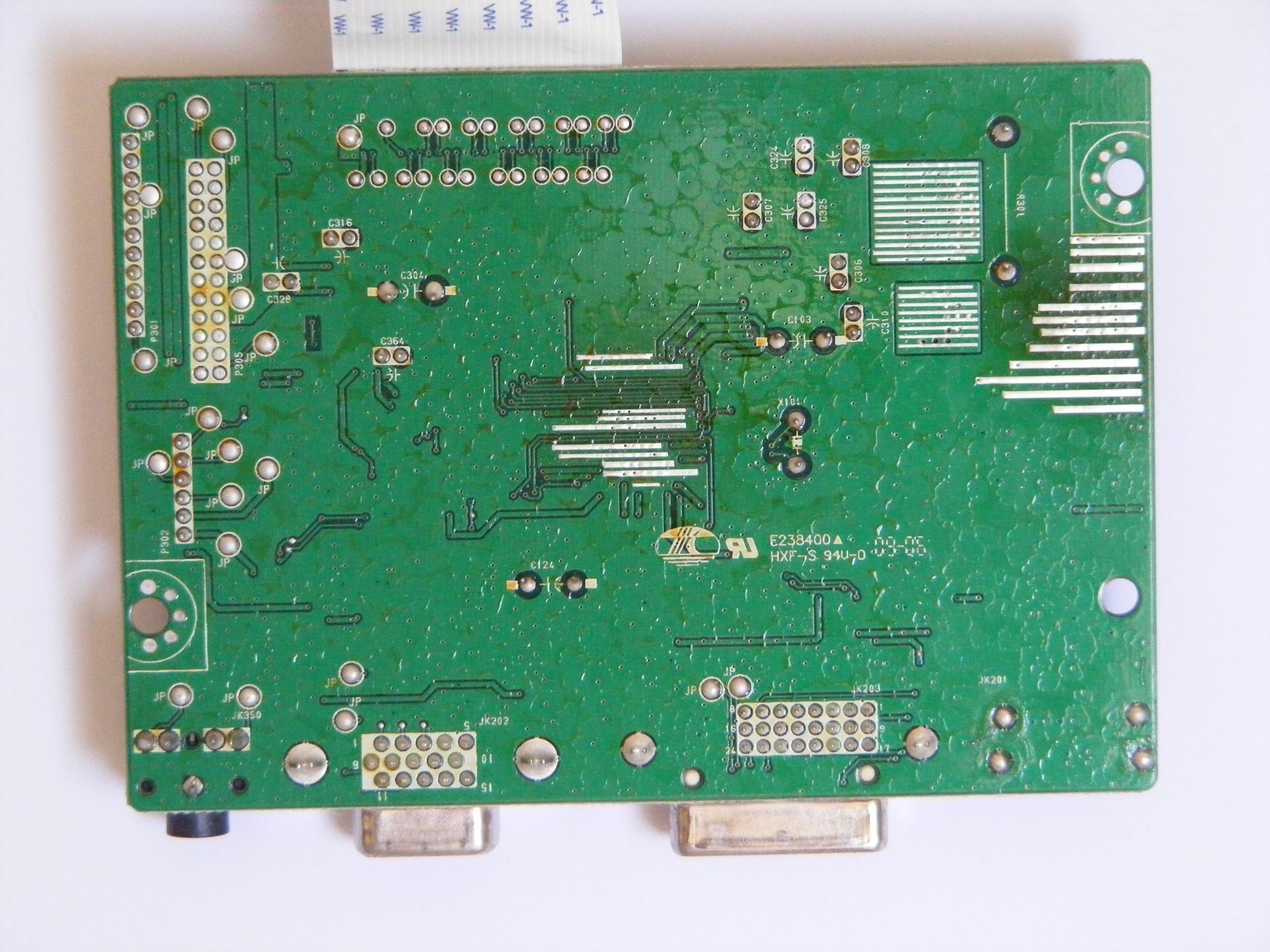

      Changed another cap on power board. Also redid soldering on some suspicious joints, but nothing obviously criminal. Tried hair dryer thing, but didn't saw any direct effect. Nevertheless, I don't have any experience with this, so here is what I did.
      Turned on monitor and started heating power board for couple of minutes - no effect, switched to logic board and after some time monitor turned black (could be coincidence, because of time). Next try - same result, just shorter time period. Tried another technique: preheat board before turning monitor on. No effect - every time it starts normal and works for some time.
      It's +28(C) outside. Heated from both sides. Every time heated until at least 60+(C) (almost hurts when touching).
      I hope this gives you any glue.

          Also, have you tried replacing any of the caps on the logic board?
          Not yet, but now I'll buy them as soon as possible. Also, there is one small SMD type cap on logic board, should I change it too?
          As for the voltage chart - yes. "Sleepy" means that I waited until monitor goes to its faulty state and then checked voltages on board.

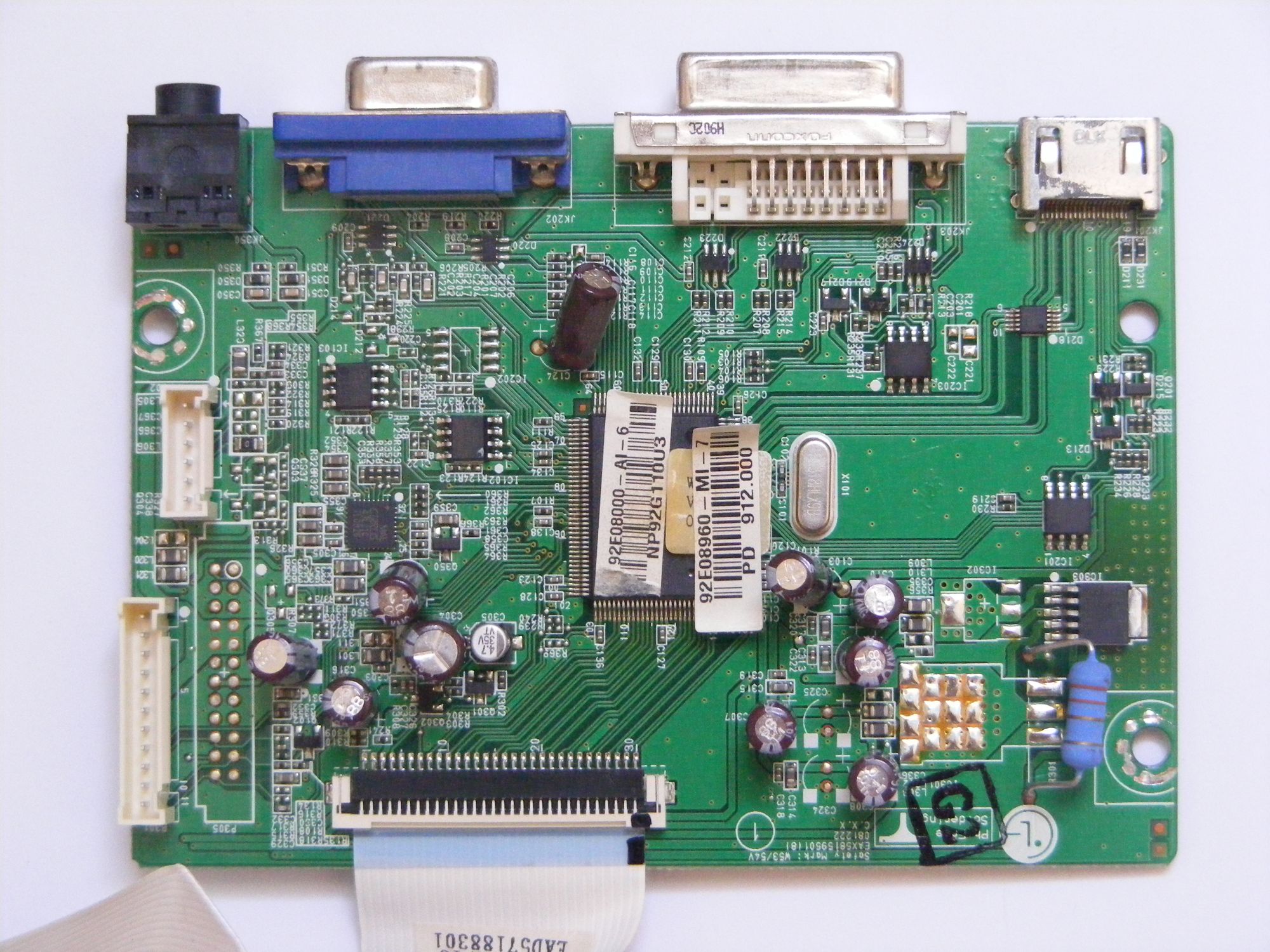

                                  I have had the same problem. After the replacement of all capacitors of the power supply, the monitor came to work properly again.
                                  • turcobom
                                    • Jun 2020
                                    • 4
                                    • Brasil
                                    Re: LG Flatron W2353V - Two hours to black
                                    Unhappily the problem was not fixed with the replacement of the power supply capacitors. After some hours of use the monitor failed again.
                                    Then I realized that the 1.8V (IC303 pin 4) of the Control Board drops to approximately 1.1V when the fail appears. Then I disconnected the IC303 pin 4 from the board and I supplied the 1.8V with an external power supply and the monitor started to work again. My next step will be to replace the IC303 of the Control Board.
                                    • R_J
                                      • Jun 2012
                                      • 9550
                                      Your problem could be with ic301, the 1.8v regulator or more likley C307,C308, C324 or C325

                                        Yep, replace the 1.8V Voltage regulator and caps nearby. If the power to the MC is not stable, anomalies start to show up.
