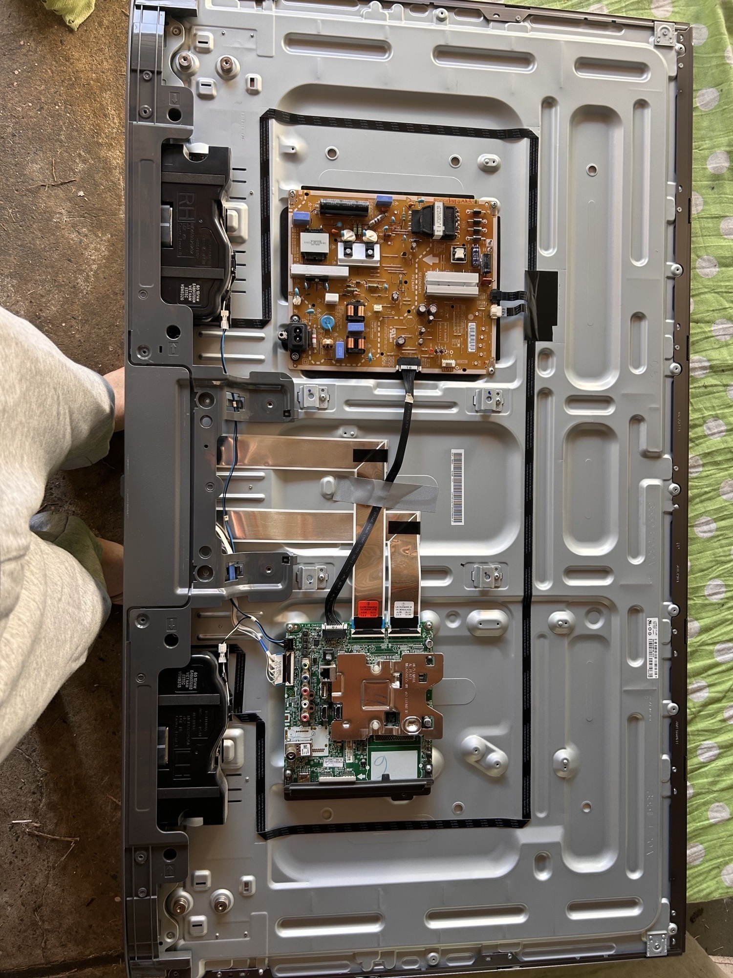

    Hello Forum team
    Have this TV; searched for the model and could not anything so thought I would share in here
    Had an issue, some years ago, and looks like some placed sticky tape over some of the lines on the FFC cables between the T con and the mainboard
    Anyway, the owner, who gave me the TV, says it starts to blink after a few hours
    So I removed the covers, and could not see anything visibly

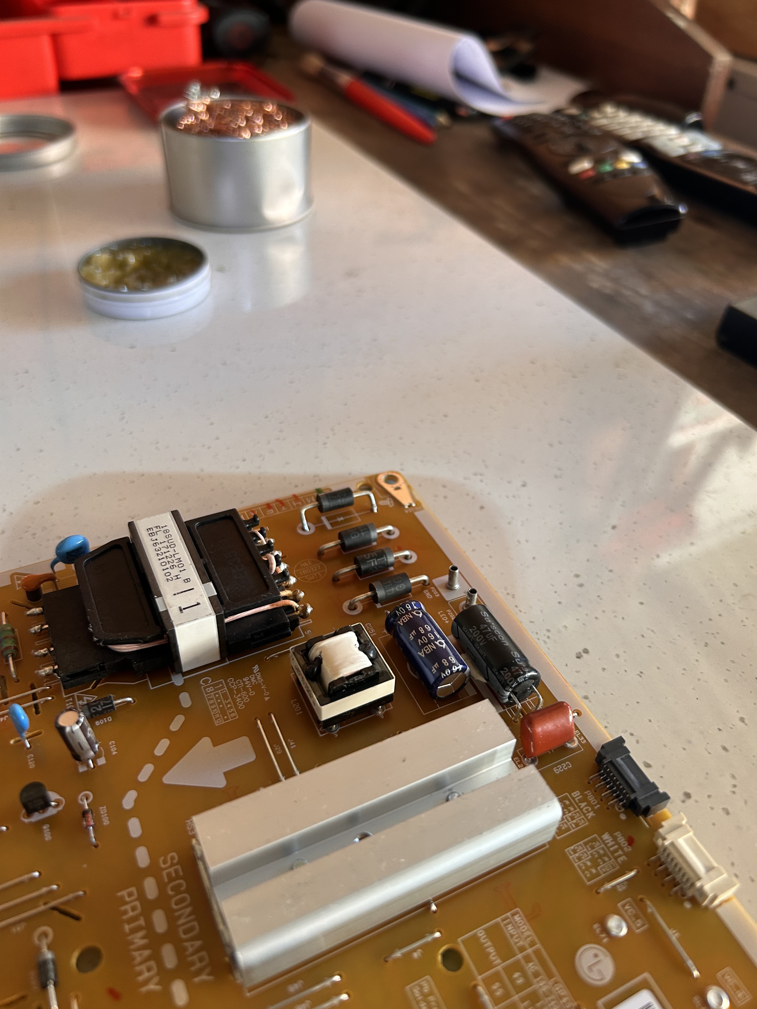

    Removed the power supply and thought some of the solder joints, on the hot side, were not the best. I thought some looked like they were cracked.
    So I resoldered any joints that did not look good

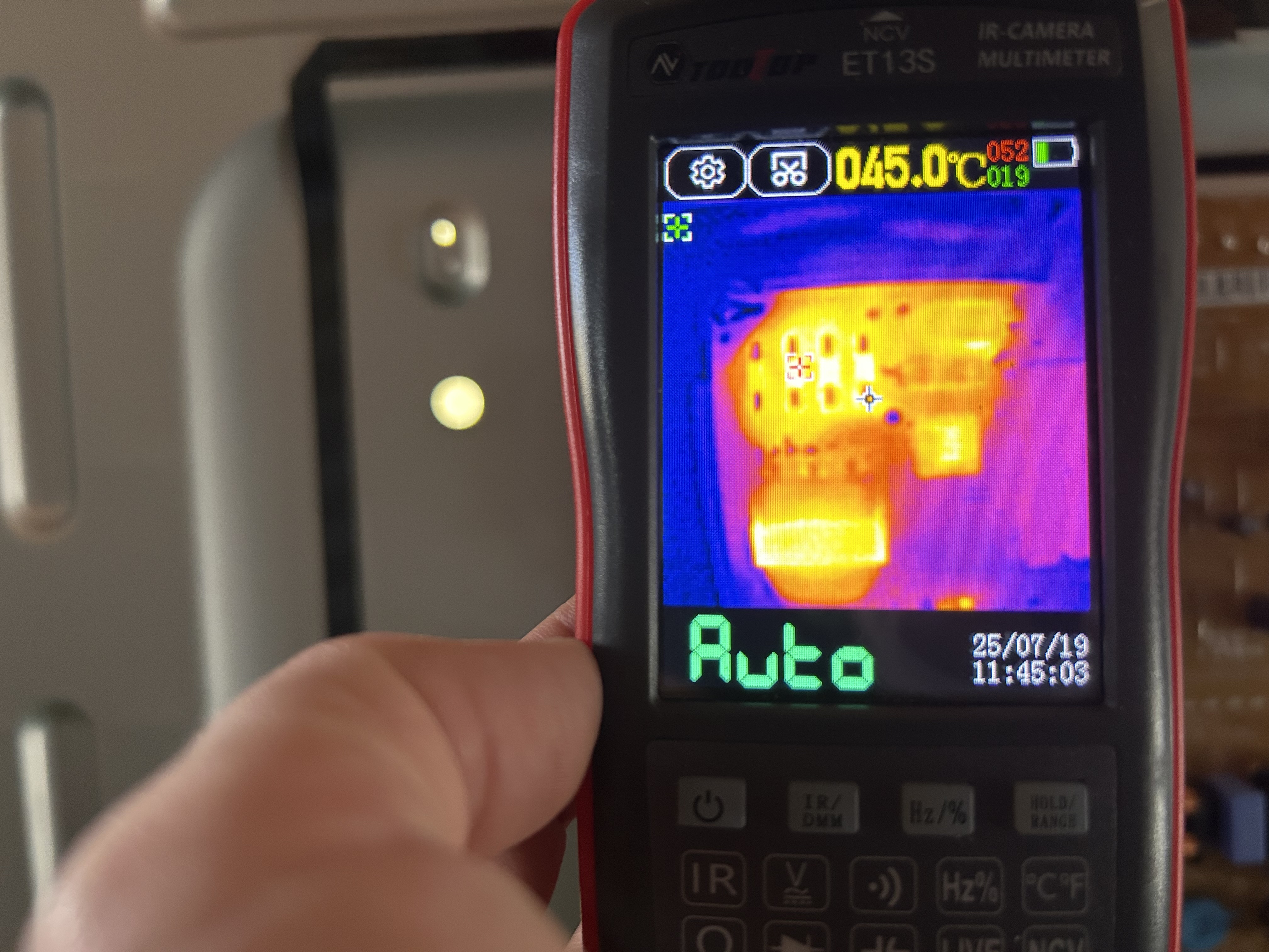

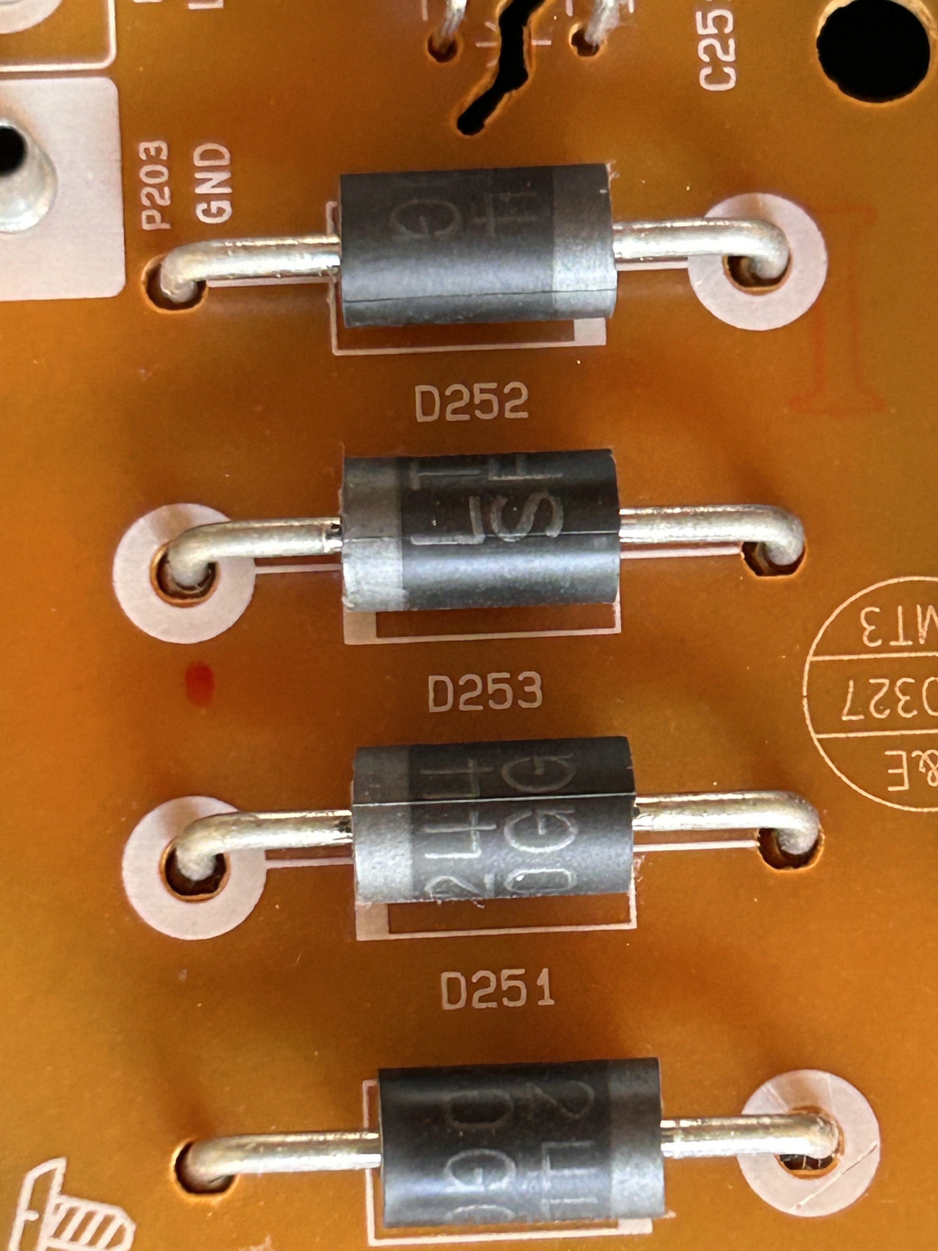

    Then I turned TV and noted some diodes did not look the same temperature and I replaced these with new
    New ones look the same as the old ones under thermal camera
    Anyway; since I did the soldering and did the new diodes I have not run the TV for a few hours and experienced the blinking
    So I am going to try that next and share the outcomes here.
    Shall welcome any inputs or experiences you all might have.

    The diodes, or the area around them, appears to have been hot. They measure okay, or the same, as far as I am concerned but I replaced with new anyway.

      Update on this one
      With the new diodes I do not note any temperature difference
      Have been running the TV for fours now
      Yet to see any blinking and I should have by now
      I guess the factory reset and the re-soldering of the joints may have resolved this TV
      will do another five hours of testing
      thank you

        Probably good to clarify what is "blinking" but sounds like you've not seen it. Backlight blinking and LCD panel blinking would be very different problems.
        Those 4 diodes you changed looks fairly close to the backlight output connector and after the backlight voltage transformer. I'd guess they are on the output path to the LED power rail. I recently fixed a LED TV PSU with shorted diode in the backlight output path ( barrier rectifiers link ) I ended up replacing the entire board set (main, zoned LED driver, PSU) due to Samsung's firmware update that killed the dimming backlights + max brightness only. Which probably is what killed the LED voltage output section of the PSU.
        T-Con to buffer board flex tape masking is still there? Likely solving a short on the panel and/or panel's edge buffer board.

          Hello Howardc64
          Thank you and I had read your post a few days ago
          The flex tape is still there from a previous repair and I shall leave it there.
          No doubt you are correct on this point
          It looks like the tape has been heat welded and not easy to remove
          So I want to leave that alone
          For the blinking I have not seen and I am five hours into testing
          Let us see how I go
          again, thank you
