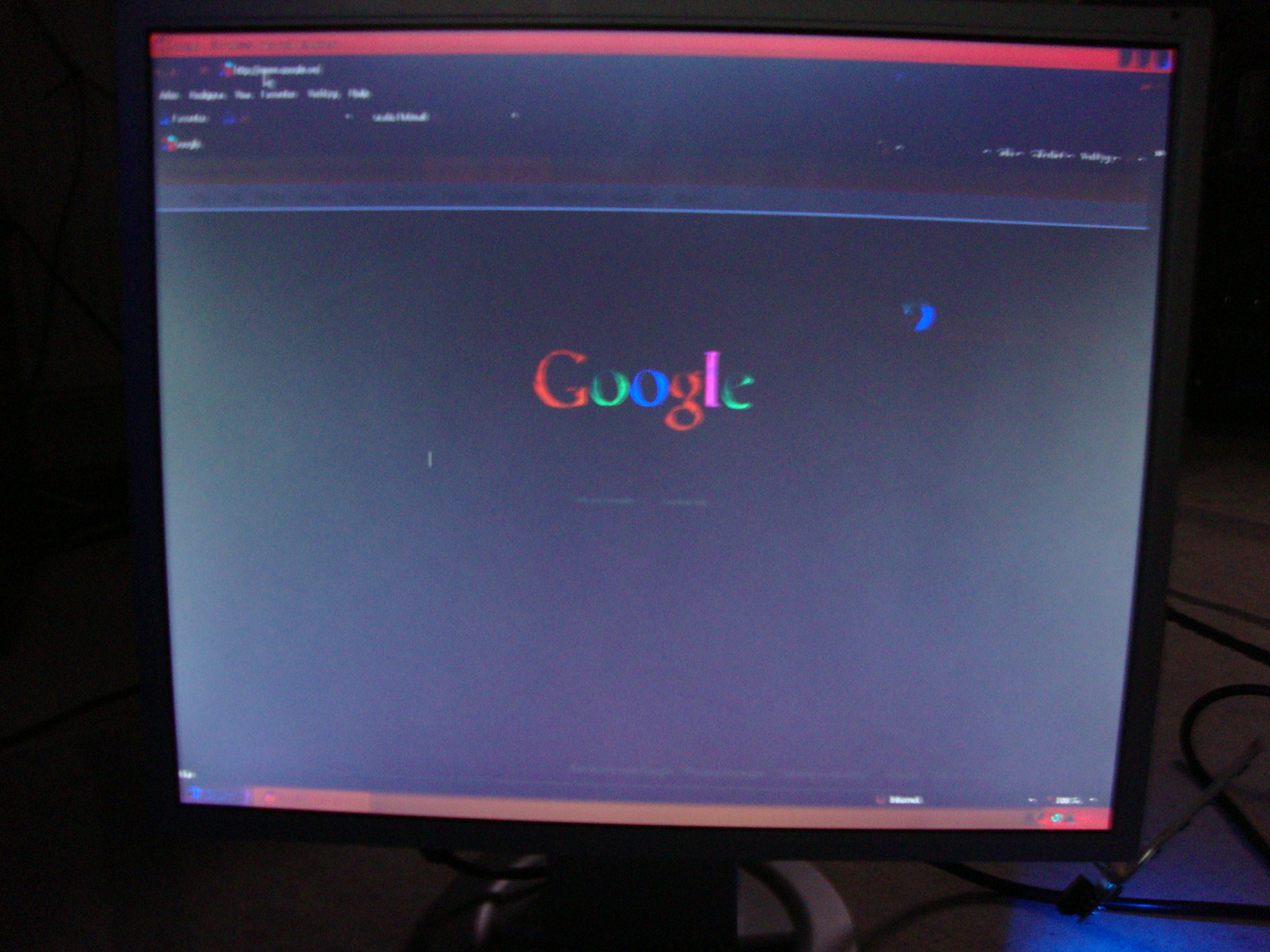

    So to the symptoms. It lights up normal and everything except the colouring of the picture is way off. It's like if you are on the google page the white parts are all black and the black lettering is white. Almost like it's inverted but not quite.
    On a Xp machine you got the blue activity field and it's all read. The picture quality is overall poor. To mention I have tested to autoadjust and change colours etc but no success. So that's why I'm here to perphaps solve this.

      Re: HPvs19
      Yes I have tried the monitor on another PC, a laptop actually.
      The PC it self is not to blame it usually have another screen that have no problem. I just got this monitor from my friend. Different VGA cables where used since it only has this conncetion. What I didn't do before my first post was factory reset but this has been done now and nothing changed at all.
      Here is a picture on how it looks when having the google page up.

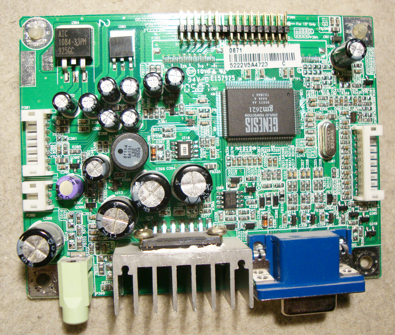

        Nothing external to add - internal , if it is removable remove and clean the LVDS cable - usually flat at the panel end.
        Pictures
        each board, front and back and close up of connectors, (max resolution 2000x2000 and 2MB) using the manage attachments button, which is found by clicking "go advanced" under quick reply.

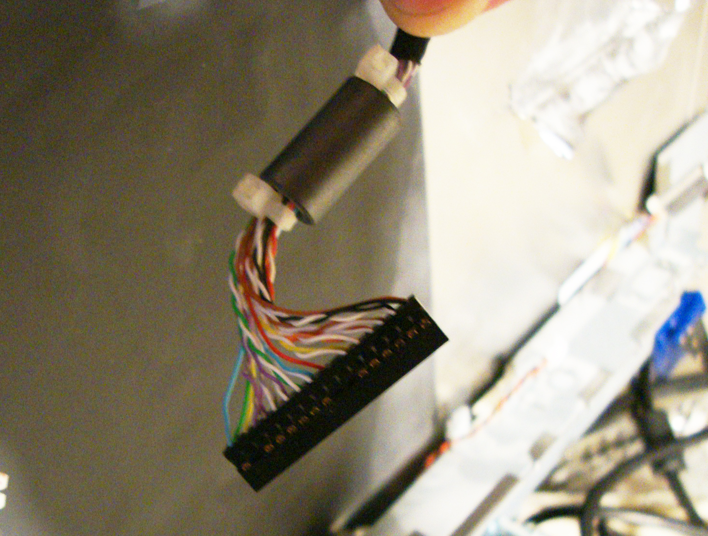

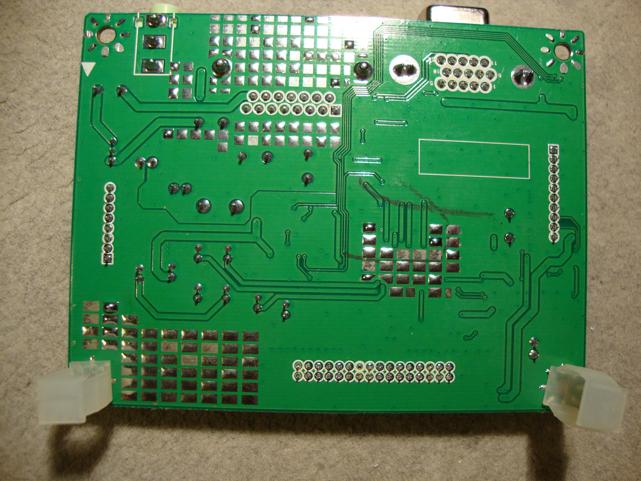

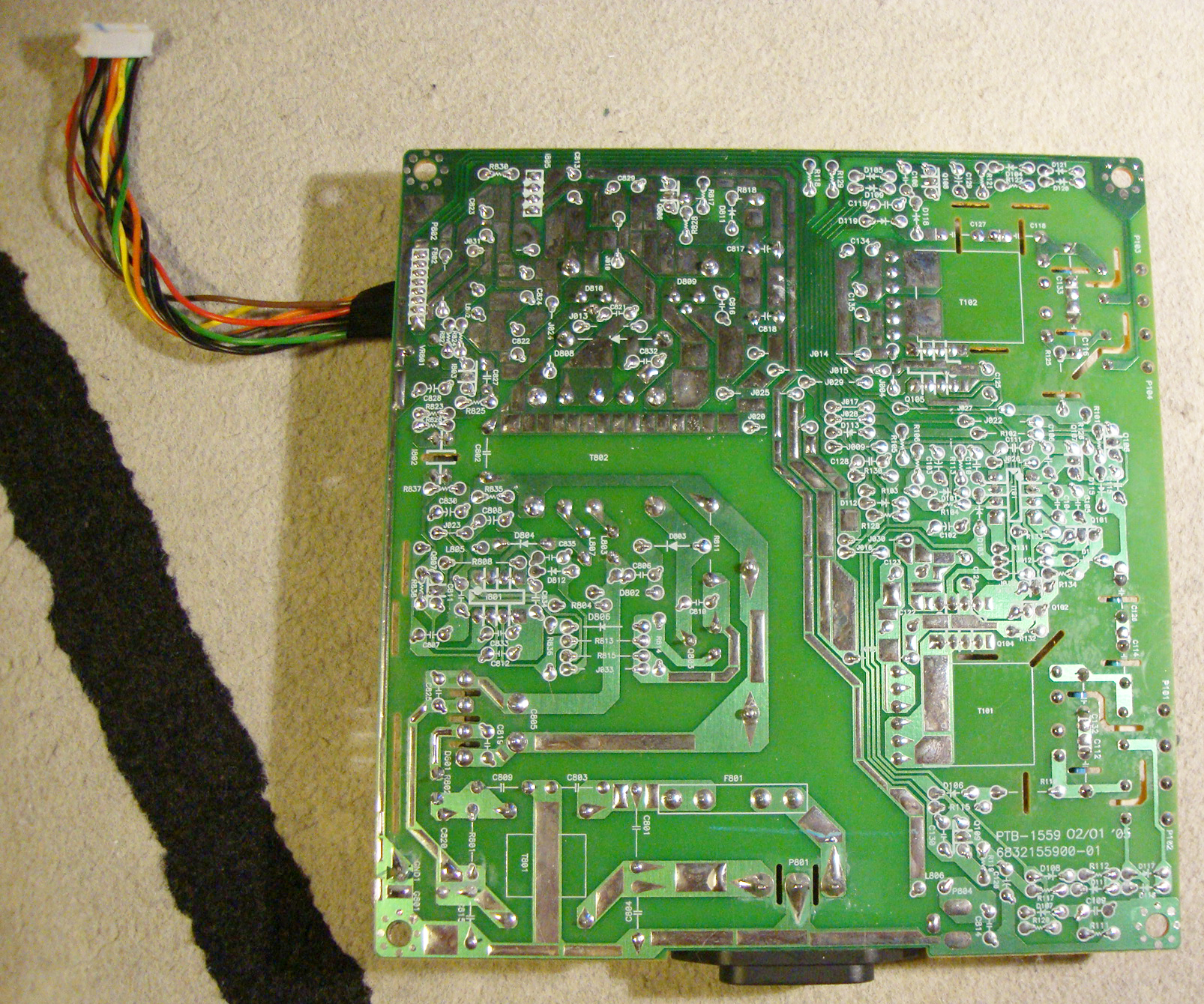

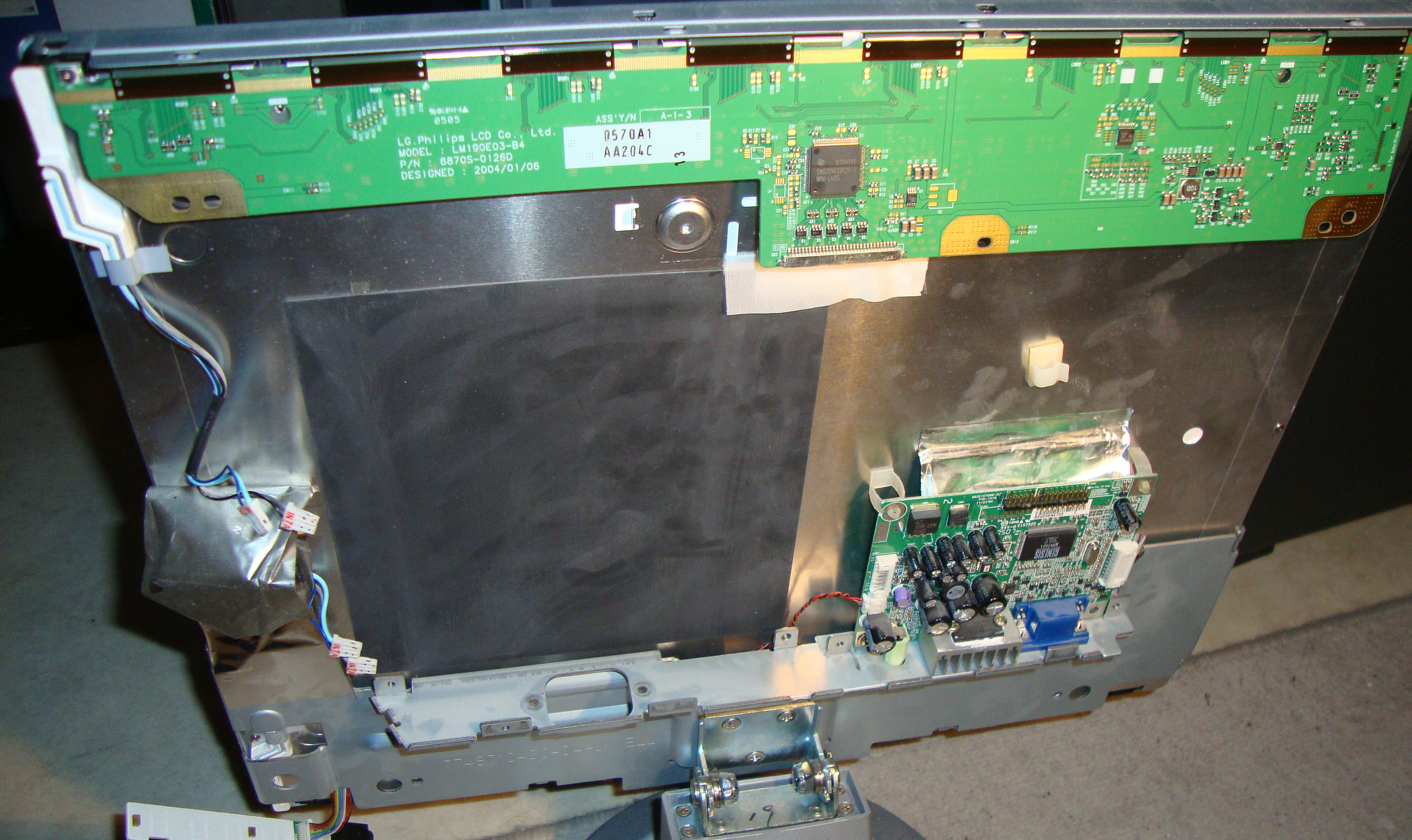

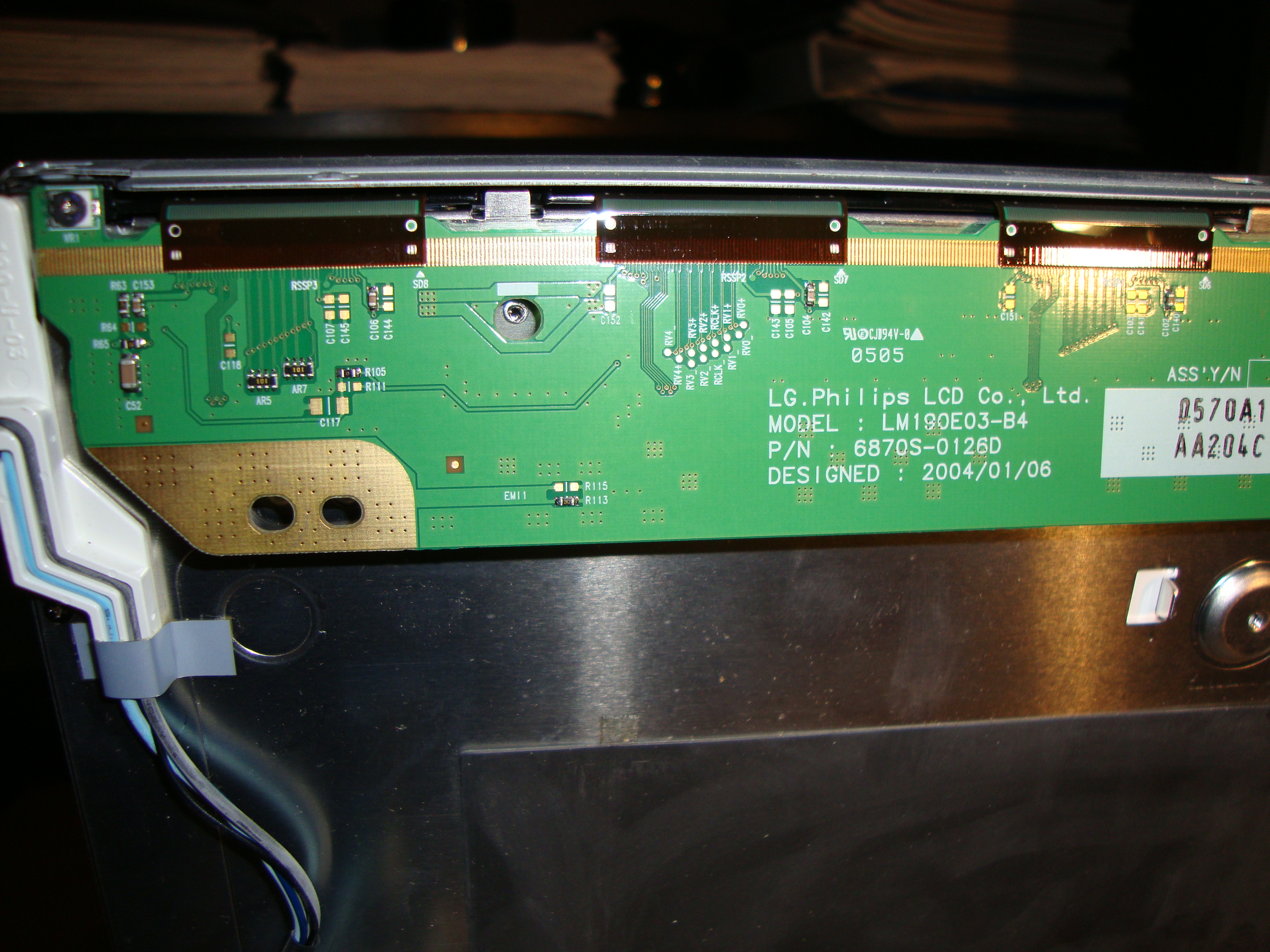

            Re: HPvs19
            Hello again!
            Hope these pictures are not to bad.
            The last picture on the cable is that the cable you mean that could be the cause? It's still attached to the screen don't know how it looks at the other end though...
            Tried to find a function that would elimintate what you refer to as inline and offsite but couldn't so....
            Sounds interesting that you had similar problems inline79 =)
            • terminatorX
              • Feb 2012
              • 63
              Re: HPvs19
              Should I try to detach the cable on the last picture?
                master hoarder
                • May 2008
                • 12170
                • Bulgaria
                Re: HPvs19
                Yes.
                When you do, you should get a white or near-white screen.

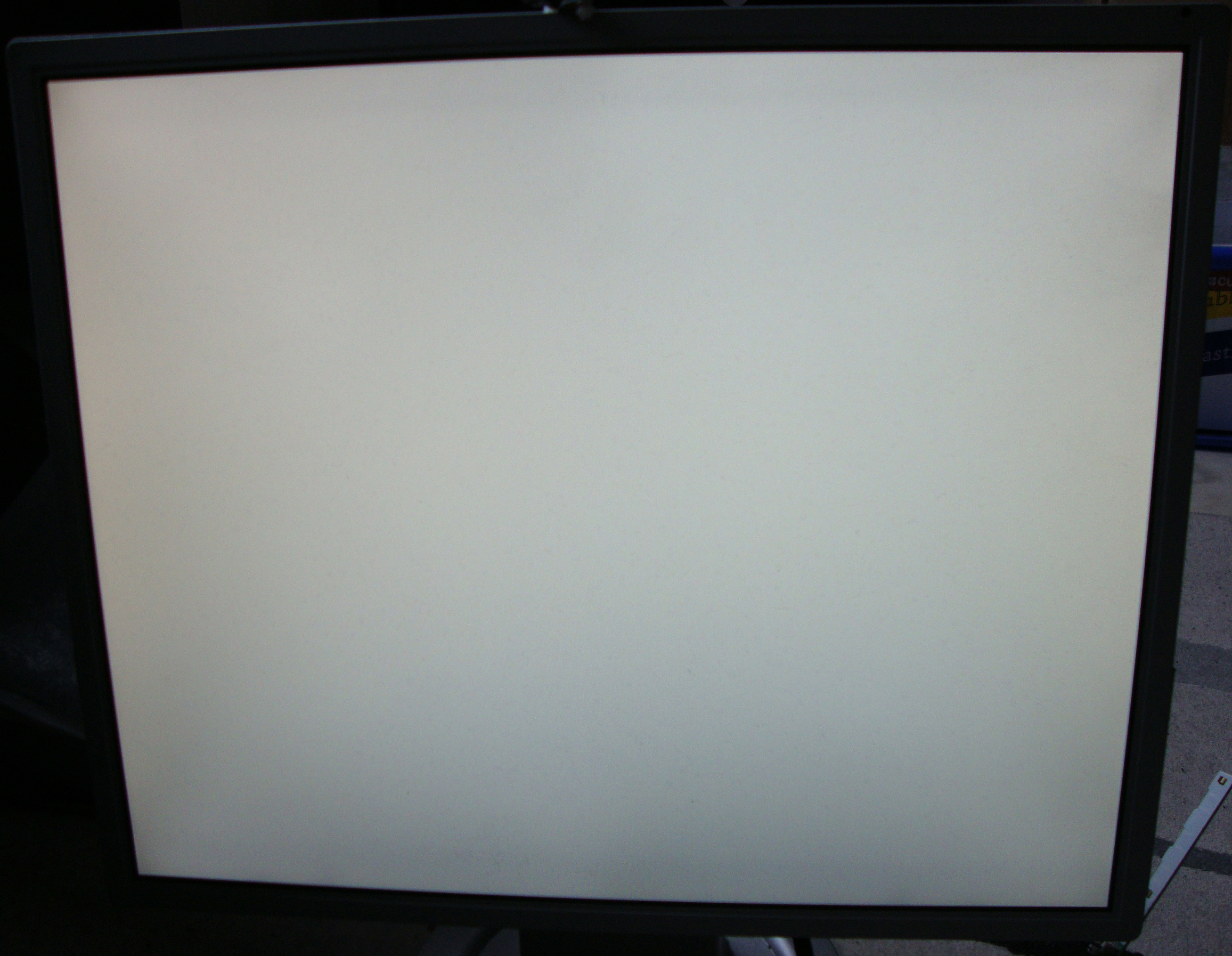

                  Re: HPvs19
                  Hello and thanks for you respons momaka!
                  Did what you said and I got a white screen picture just as in the picture.

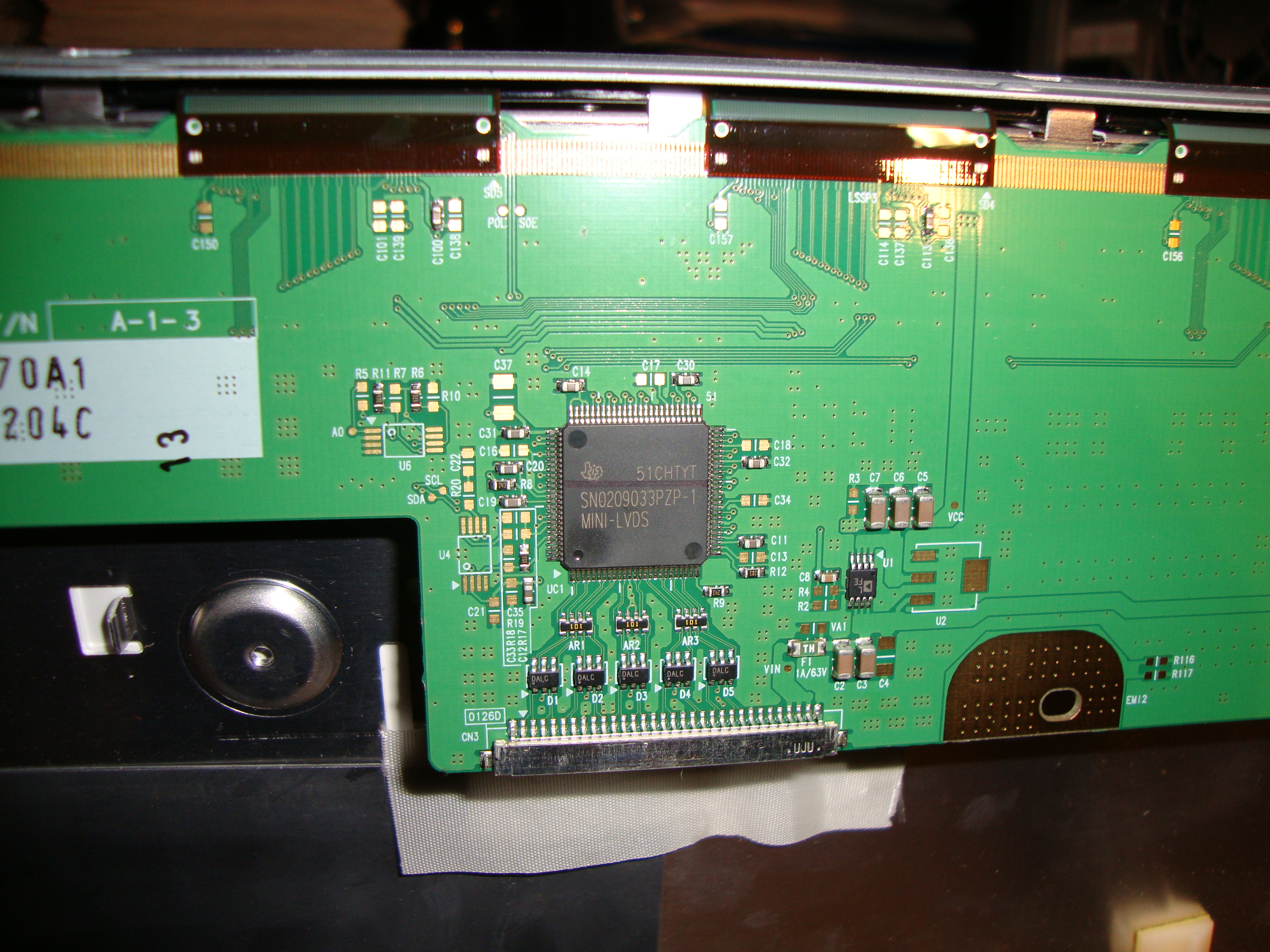

                    Re: HPvs19
                    Hmm..
                    Hard to say if the issue is with the t-con board or the video board. I do see a lot of CapXon caps on the video board (more particularly it's the smaller ones I'm suspecting... the bigger ones are for the headphone/speaker amplifier).
                    Do you have a multimeter and know how to use it? Perhaps before me suggesting to change the capacitors on the video board, maybe you can check some of the voltages on the t-con. To do that, post some pictures of the t-con so we can tell you which points to measure.

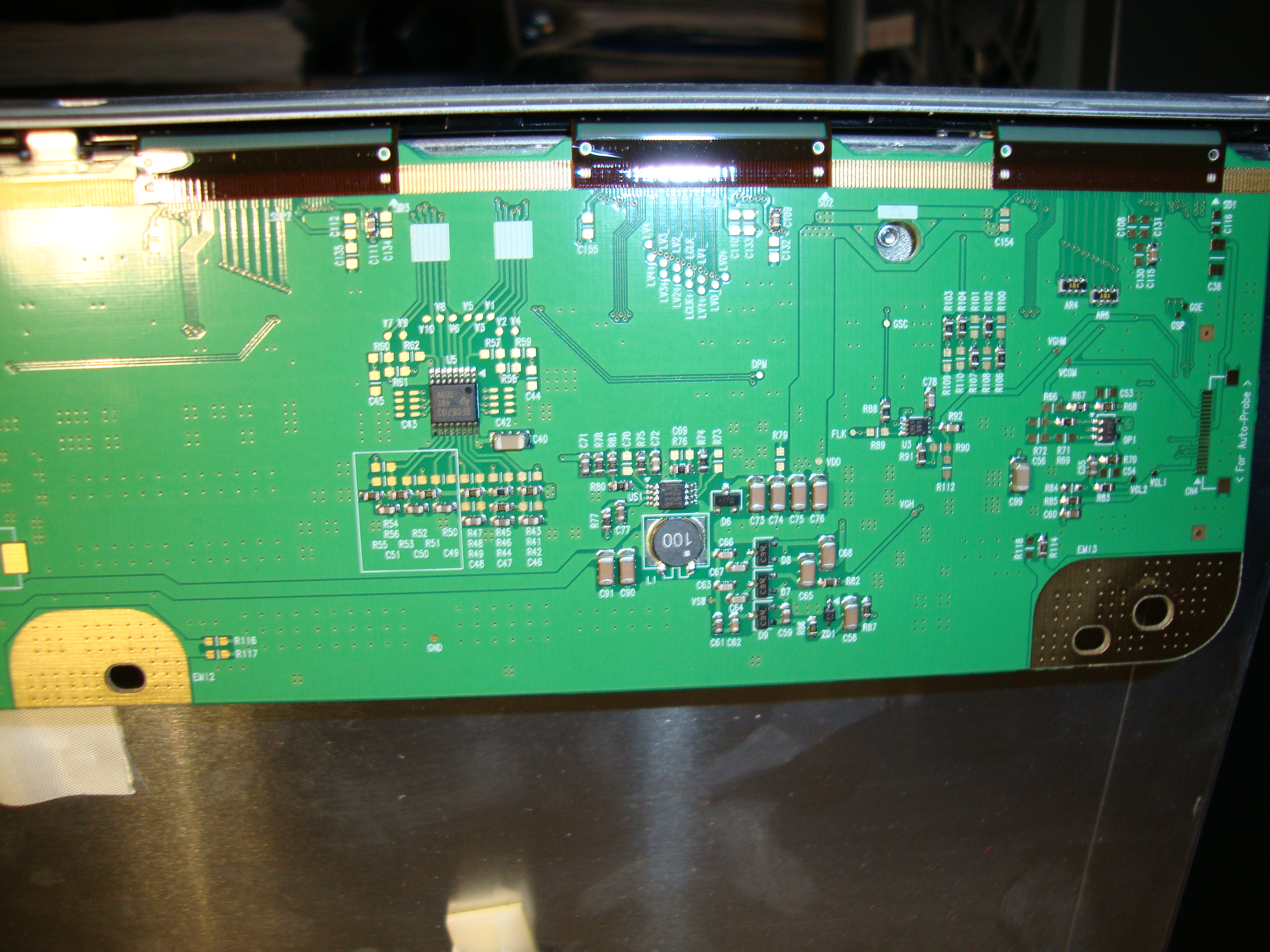

                      Re: HPvs19
                      Hello again after a long time=) Thanks for your interest momaka.
                      I do have a multimeter and my usage capabilities are decent. Nevertheless please be exakt with what you mean and advice from experienced are always appreciated.
                      Actually first time I heard of the t-con board so after googling I took the pictures below hope it's right.
                      Just got one question. Would it be possible to identify a faulty capacitator with an IR gun. Maybe lacking the possibility to build up charge maybe causes it to be significantly colder than the other capacitators?

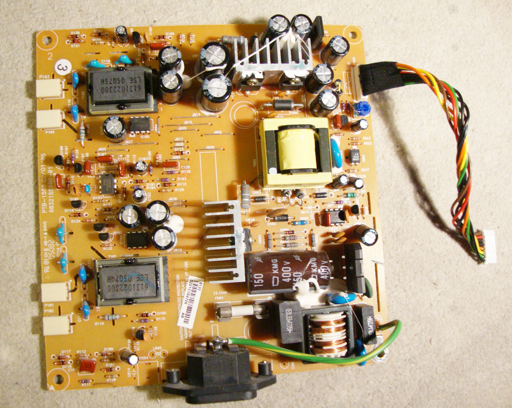

                        Re: HPvs19
                        Check that F1 fuse to see if it is open. It looks like the T-CON is not getting the power due to open fuse on the T-CON or the main board may not be sending either 5V or 12V to power the T-CON board.

                          Re: HPvs19
                          Well, since there IS an image on the monitor (messed up colors aside), then fuse F1 on the T-con should be fine.
                          One thing you can check is the voltages on the t-con. Lucky for you, the test points in the power section of the t-con are labeled.
                          Using this picture as a reference
                          https://www.badcaps.net/forum/attach...4&d=1351875415
                          Do the following:
                          1) connect all cables and boards in the monitor normally
                          2) set your multimeter to measure voltage
                          3) power on the monitor and measure the voltage between ground and the following test points on the t-con: VDD, VGH, VGL1, VGL2, VCC (VCC is shown in the 3rd picture you posted, a bit above the t-con main connector)
                          Note: if your multimeter is manual ranging, make sure to set it to a scale that can measure up to 50V. On some monitors, VGH can be as high as 35V or higher (depends on design).
                          4) report the voltages you got for the above test points.
                          Those test points show the voltages at the various voltage rails on the t-con. If you're interested in knowing what those voltage rails are, read the end of this post:
                          https://www.badcaps.net/forum/showpo...02&postcount=7
                          On your monitor VIN is the main 5V (or is it 3.3V?) power supply rail to the t-con. VCC is the regulated 3.3V, 2.5V, or 1.8V rail for the TFT driver IC. VDD is the main boosted voltage rail (the main step-up). Finally, VGH and VGL1/VGL2 are the secondary step-up voltage rails (with VGL1/VGL2 actually being negative).

                                Re: HPvs19
                                Hi! Has been a while and thanks for your inputs!
                                So I have tested all the points VIN is 5.11V, VDD:10.47V, VGH 21.03V, VGL1:-5.06, VGL2:-5.06 and VCC:3.314V.
                                Hope to see what you say on this=)

                                  Re: HPvs19
                                  The voltages on your t-con board seem to be fine, so at least we know the weird colors are not due to that.
                                  Try this: connect everything in the monitor the way it should be, then connect it to a computer and display a normal picture. Finally, bring up the monitor's OSD/menu. Do the OSD colors look inverter too or are they normal?
                                  I'm inclined to think this is a video board problem now. I've never spent much time troubleshooting those, so I don't know what could be bad. I doubt the caps on it are the problem, but if you have replacements on hand, it won't hurt to replace them.
