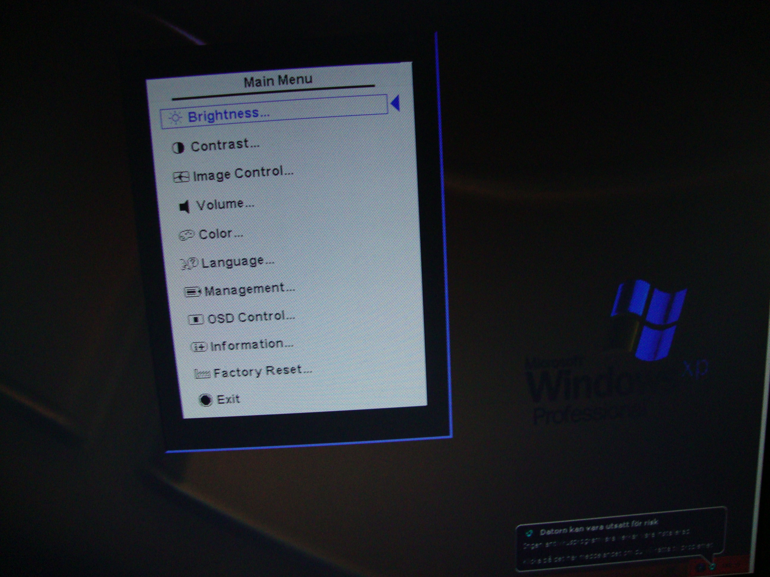

      I have tried to tweak stuff in the overall menu option but there is none or very little change in picture.
      Right.
      The information I was interested in, however, is if the colors of the actuall OSD/menu on the screen were affected the same way as the picture. Because if they are not, then that means the problem is definitely in the video/logic board and not the t-con.
      Now that you oven-cooked the board, though, I wouldn't suggest you go any further until you change the bulging capacitors (or at the very least that big one). It's probably not worth it for this monitor, but you can always re-use the new caps for another monitor later on, so it is not a complete loss of time either.
        Re: HPvs19
        Hehehe funny selldoor =)

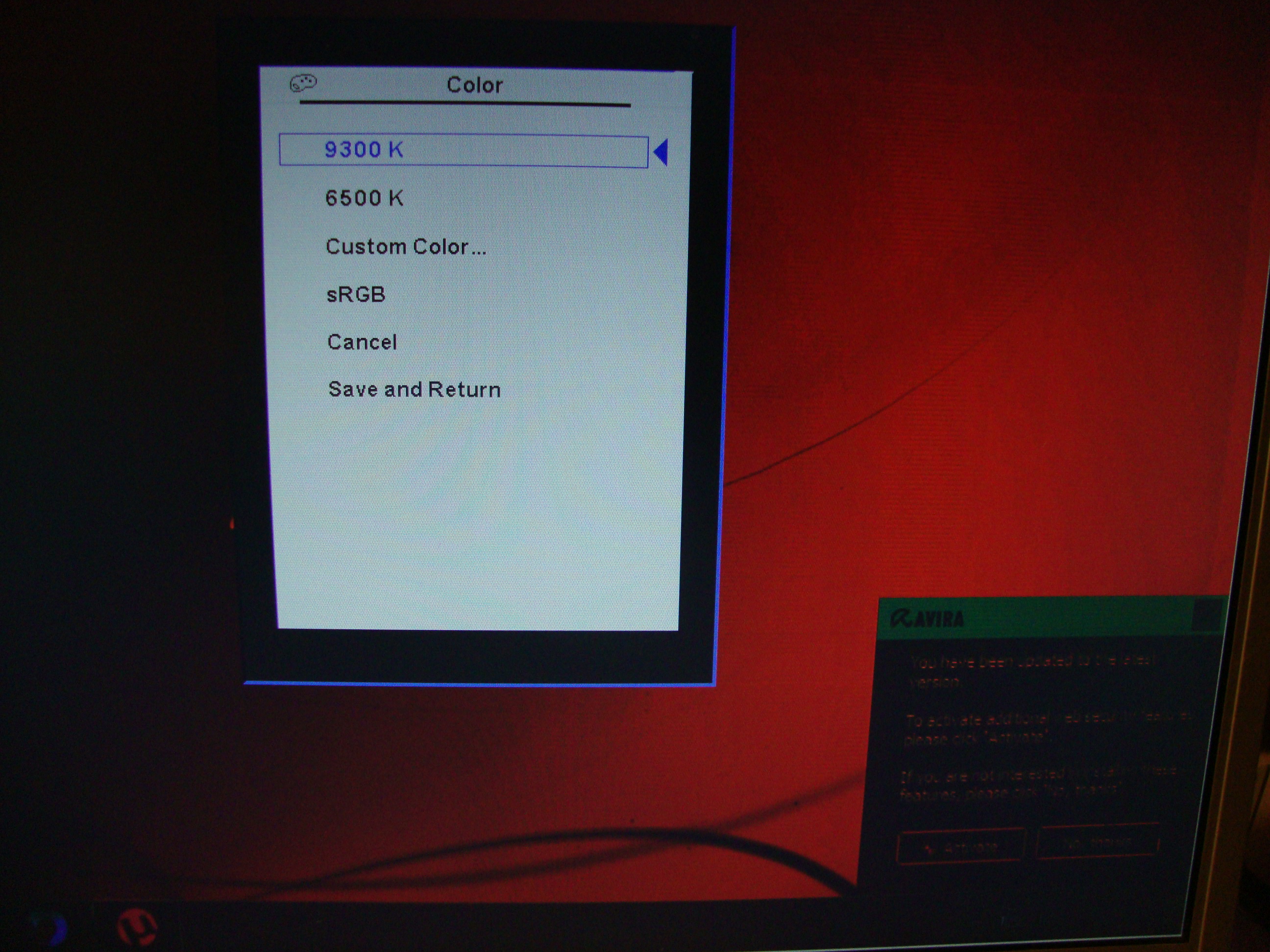

        I'll see maybe I'll try and replace the caps. Here is a picture of the menu if it's of any use. But its still seems that you have little doubt on other parts. Do you still
        believe that the caps may play bigger part in this than other stuff?
          Re: HPvs19
          It is.
          OSD menu colors look okay, though I'm not familiar with the way they should look for this monitor so I don't know if the colors are off or right. Go in the Color... submenu and take a picture of that. I'm trying to see if the OSD menu appears correctly as well. If it does, then it's a video/logic board and not t-con.

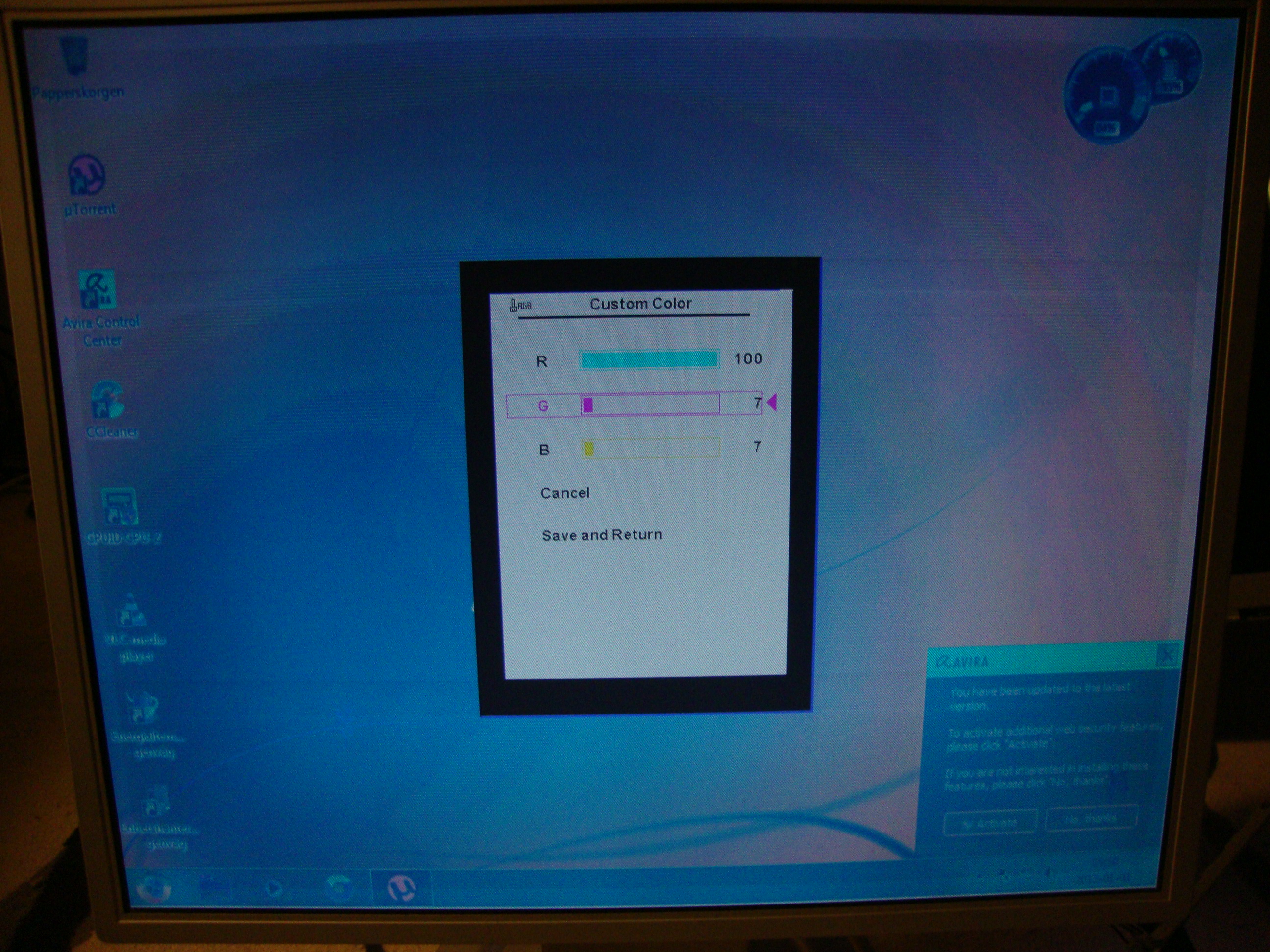

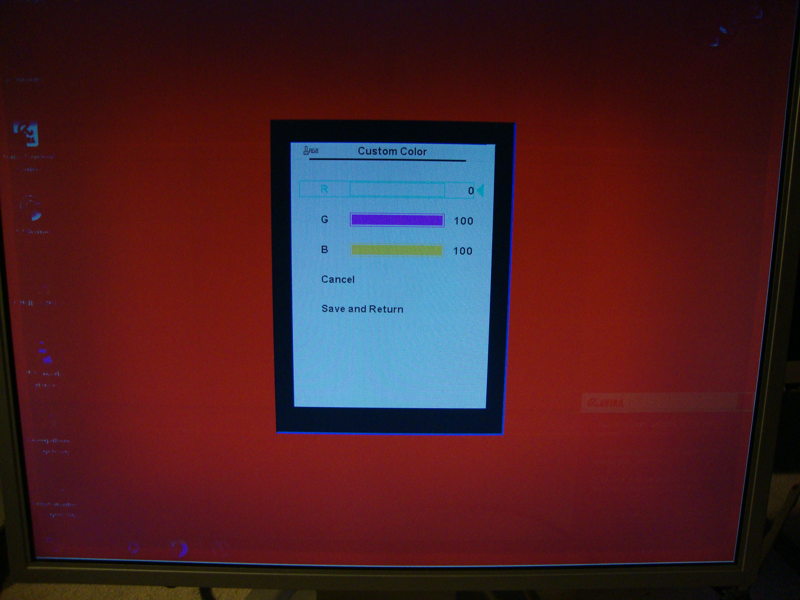

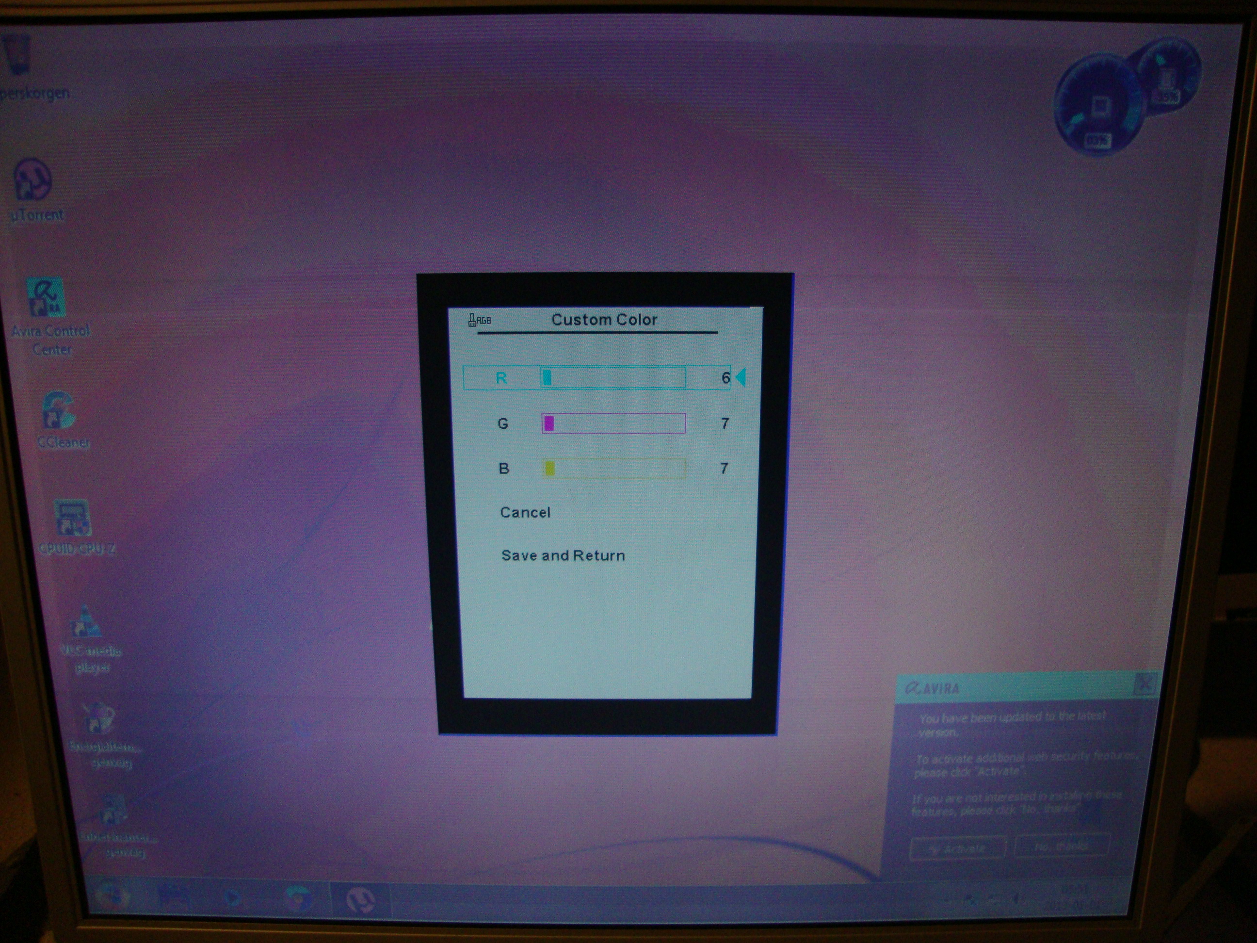

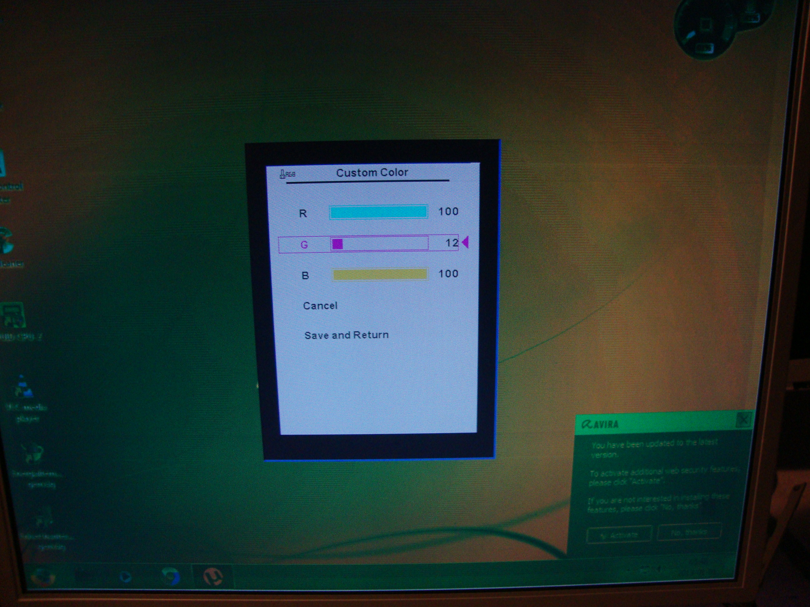

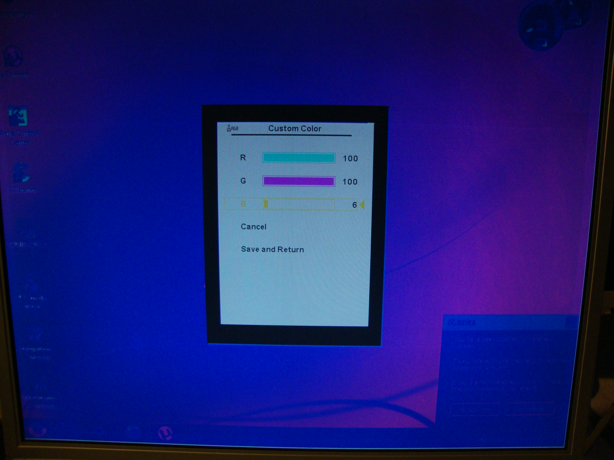

            So I took some pictures. Actually I went into custom colours and played with the bars there, maybe it will help better to interpret the status. Just changing the modes quickly in the colour sub menu almost changes nothing. You just get a hint that pictures gets just a little more or less brighter.
              Yes.
              Those RGB bars should be the same the color as their name - i.e. R should have appeared red, B blue, and G green in the OSD menu. The fact that they don't means that the whole video signal is getting messed up. Unfortunately, that still doesn't tell us if it's the t-con or video board.
              I would say check diodes D1, D2, D3, D4, and D5 on the t-con board first (those devices labeled with "DALC" on them). This is their data sheet (see "Functional Diagram"):
              Basically, check with your multimeter if there is a short circuit between any of the I/O and Ref 1/2 pins - you should see none.
