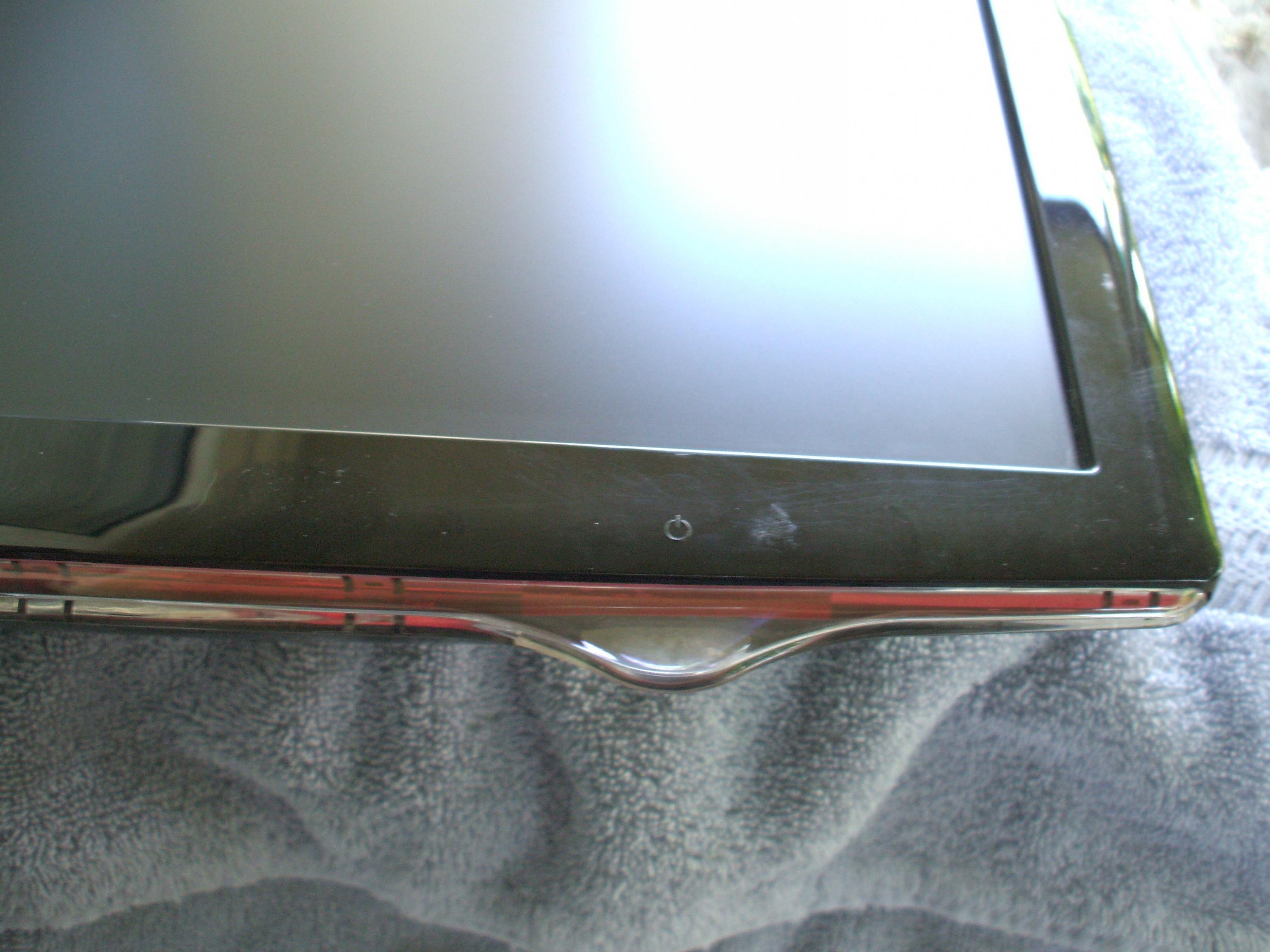

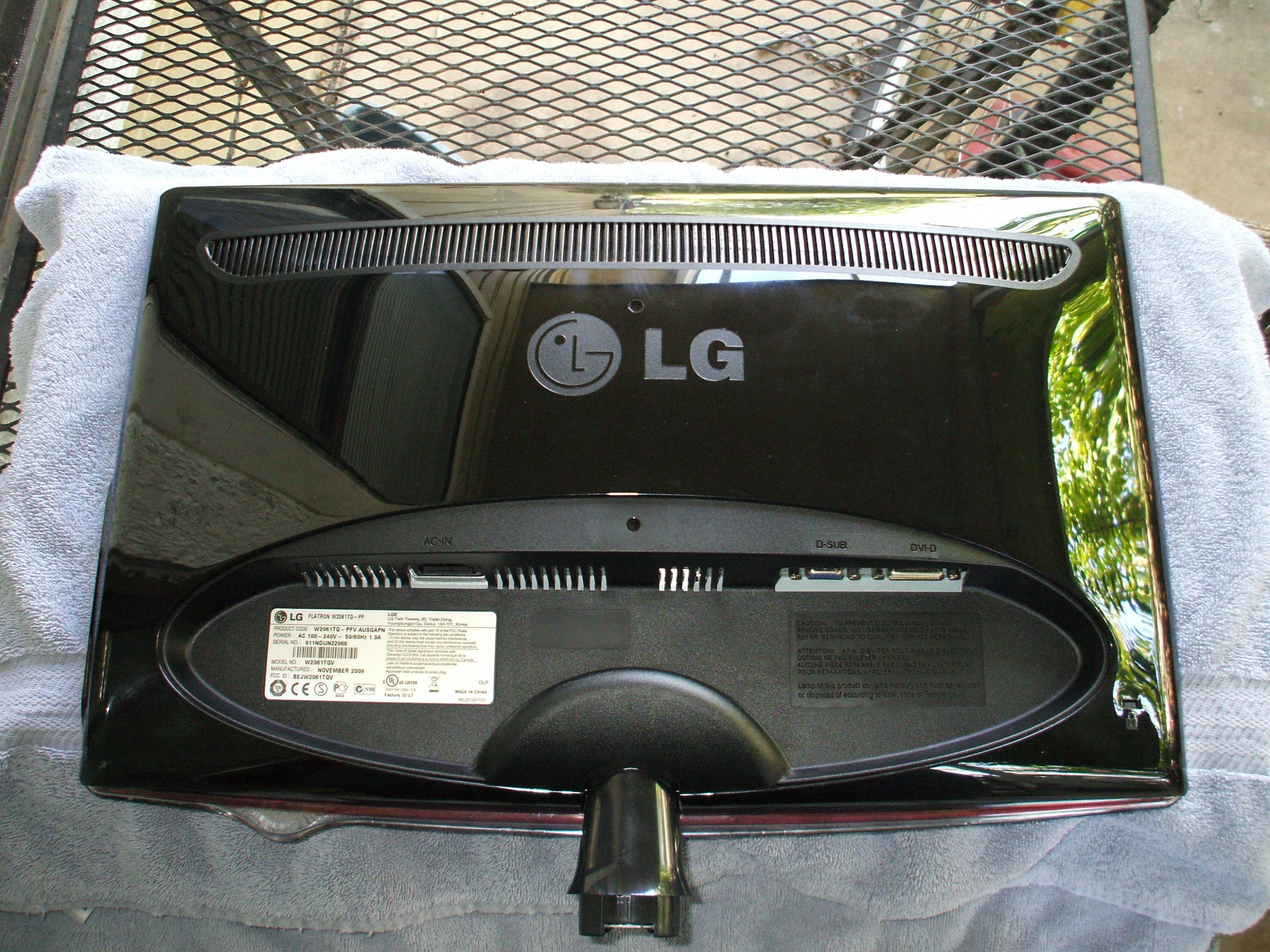

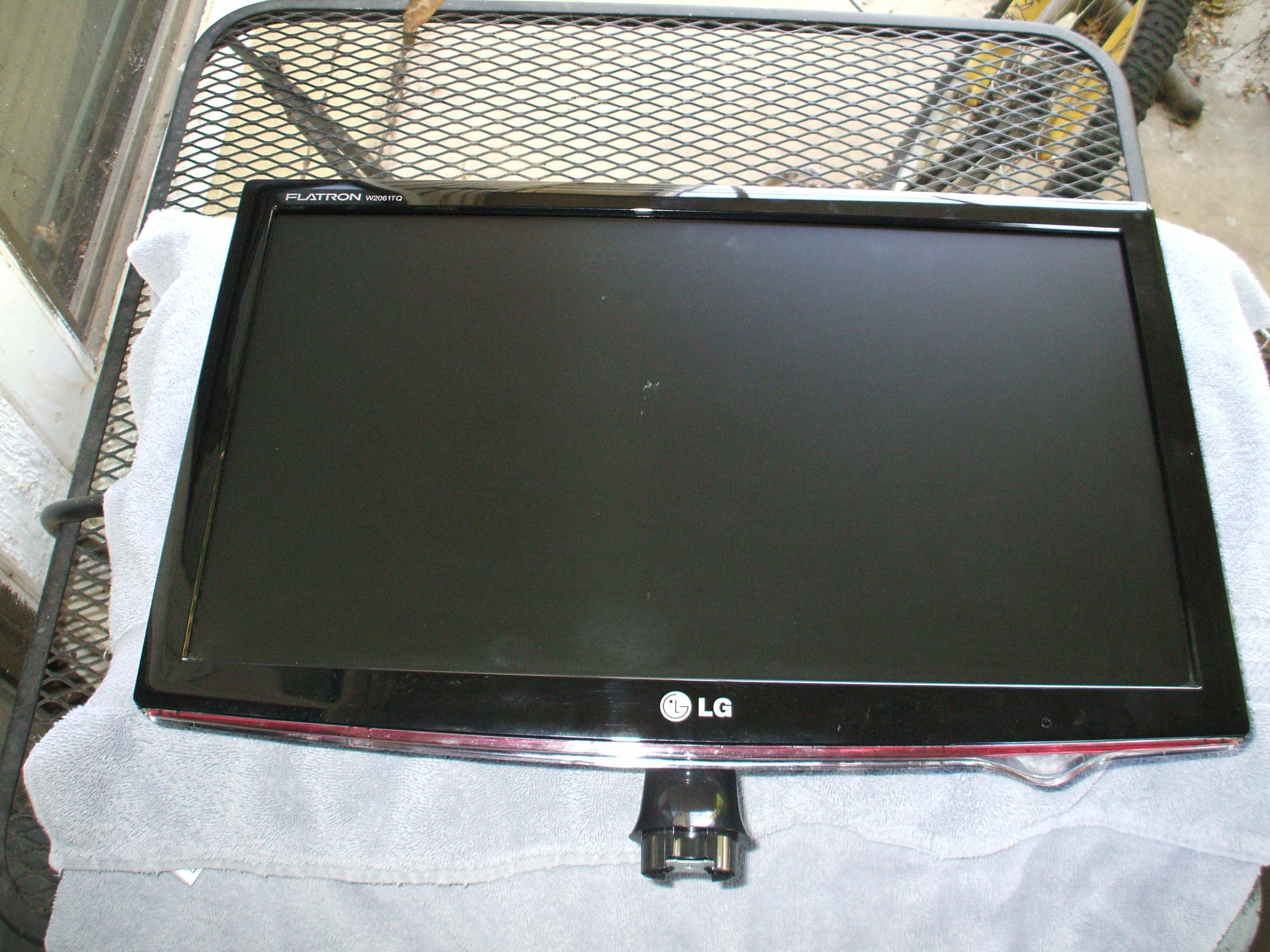

    I have this LG monitor model # W2061TQV and I cant figure out how to take it apart. I am thinking that it is just held together by clips because I cant find any screws. Anyone have any suggestions?
    The monitor turns on, displays the LG logo and will briefly show a picture then turn black. If I mess with the bottom right corner of the bezel, it will turn back on for a few seconds and then turn right back off.
    Edit: I figured it out. I was on Fixya, (i know, i know) and it showed a picture from a service manual of another LG monitor where you just pull on the bezel inside of the front of the screen.

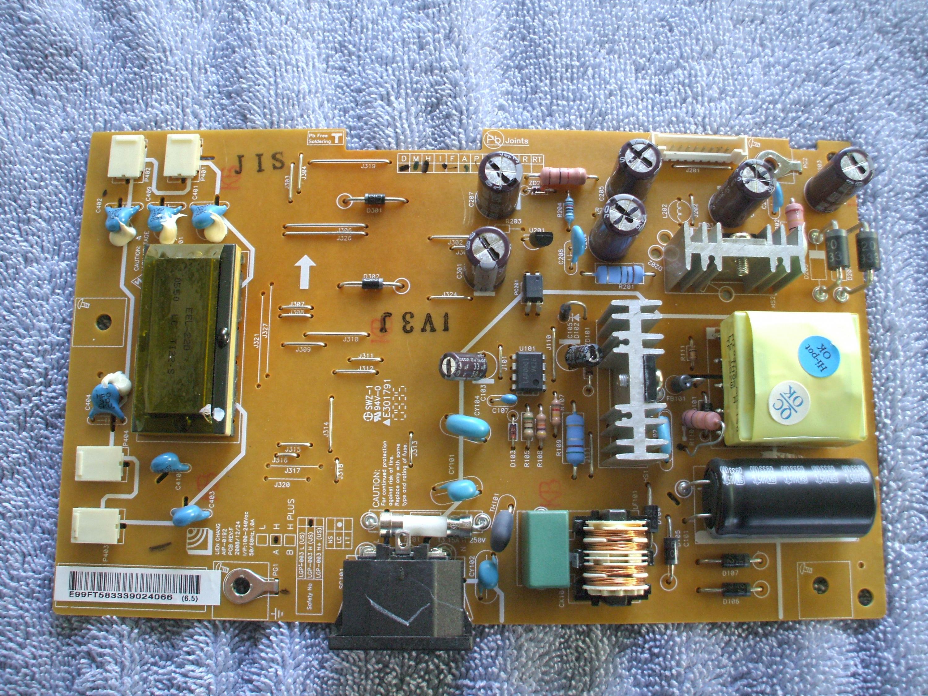

    A couple of pictures of the power board with its Su'scon capacitors.
    Measuring the transformer EEL-22D in circuit, with 1-2 pins being on the very bottom of the picture and 7&8 being on the very top, I get:
    1&2: .987k ohms
    7&8: .986k ohms
    Nothing on the board really jumps out at me as being obviously faulty, like none of the capacitors are bulging from the top.

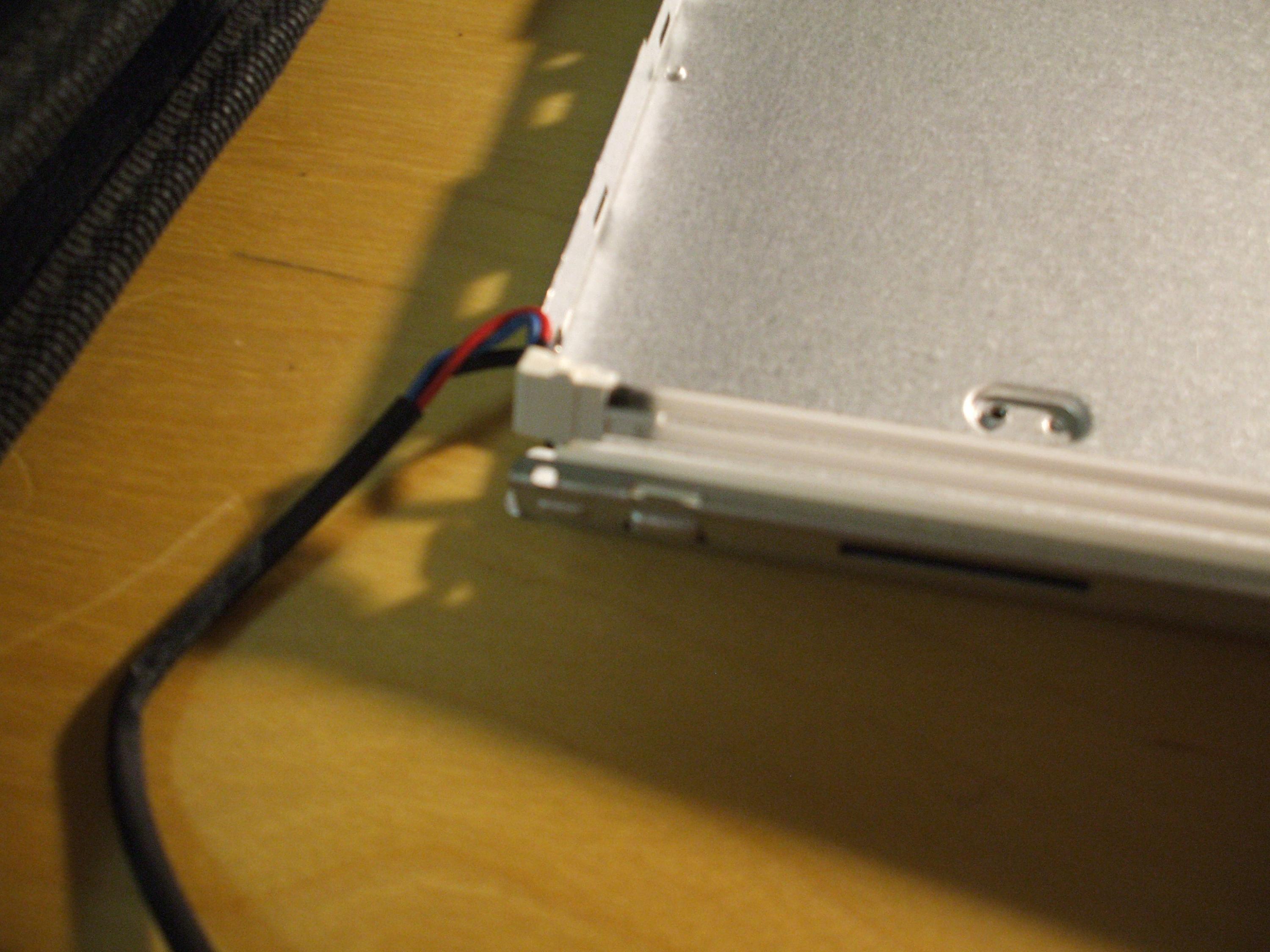

                        Today I said what the hell and took it all the way apart.
                        The top 2 CCFLs are one unit, and blackened on both ends but not burnt. Bottom 2 CCFLs are also blackened and the white wire was disintegrating at the end of the rubber end piece.
                          Resolder it.

                            I tried to pull the ends off but the CCFLs were so brittle in that area they just broke on me. The other end came off fine.
                            Thanks for the info, I am looking at prices on CCFL replacements right now. May build 2 of those testers budm talked about to see if I can get the lamps to stay on.

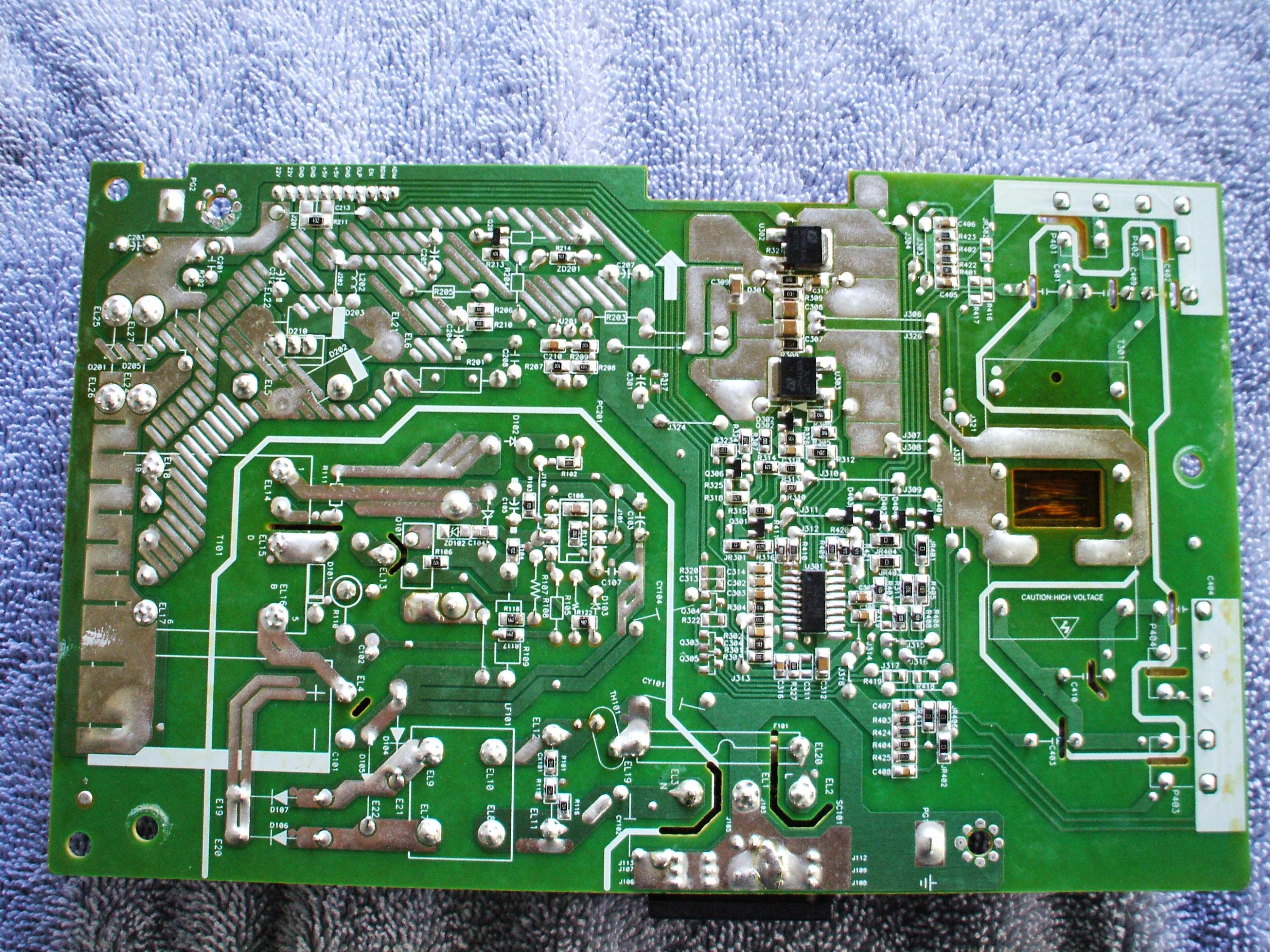

                              I have one with bad caps on its power supply board, and stupidly I looked at one of them, then removed the bad ones (they're all physically the same size, so I just assumed they were all the same). The problem? Three of them were 1000uf @ 16v and one was 470uf at 35v, and since I wasn't paying attention (I've never had this issue with any other monitors I've repaired), I don't know what locations they were in.
                              The bits I removed were C203, C204, C205, and C212,. Does anyone know which values each had?
                              THANKS!

                                Good pictures of YOUR board, top and bottom side?
                                • retiredcaps
                                  • Apr 2010
                                  • 9271
                                  Re: LG W2061TQV Disassembly?
                                  It looks like C212 is the 470uF 35V judging from the photos in post #2.
                                    OK, I traced out the connections:
                                    D201, D205 are connected in parallel to provide +22V for the inverter circuits, there are 3 caps all connected in parallel: C203, C207, and C301 which should be 35V rating caps for the +22V power supply section.
                                    D210 (Dual Diode TO220 case) is the rectifier for the +5V power supply, there are 3 caps all connected in parallel (they do not even use Pi filter, the inductor L202 is bypassed by the jumper J202): the caps are C204, C205, and C212, they can be 10V~16V cap rating.
