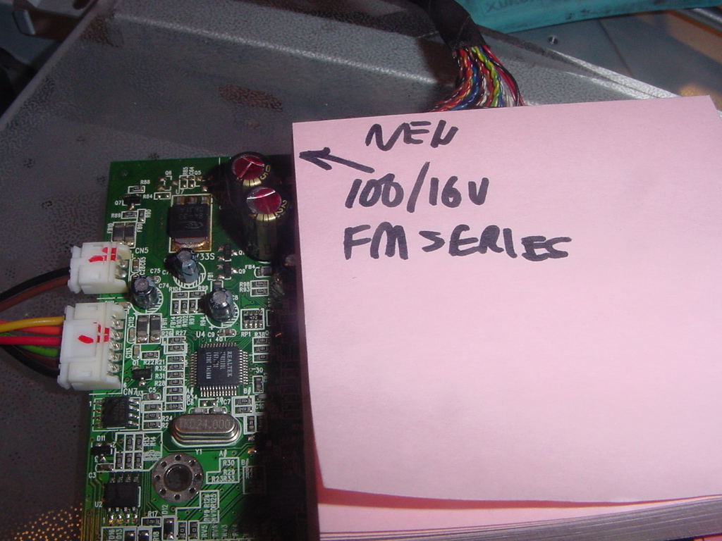

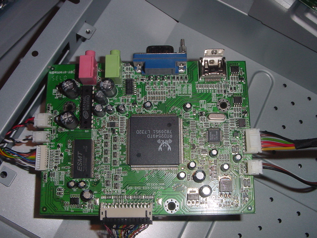

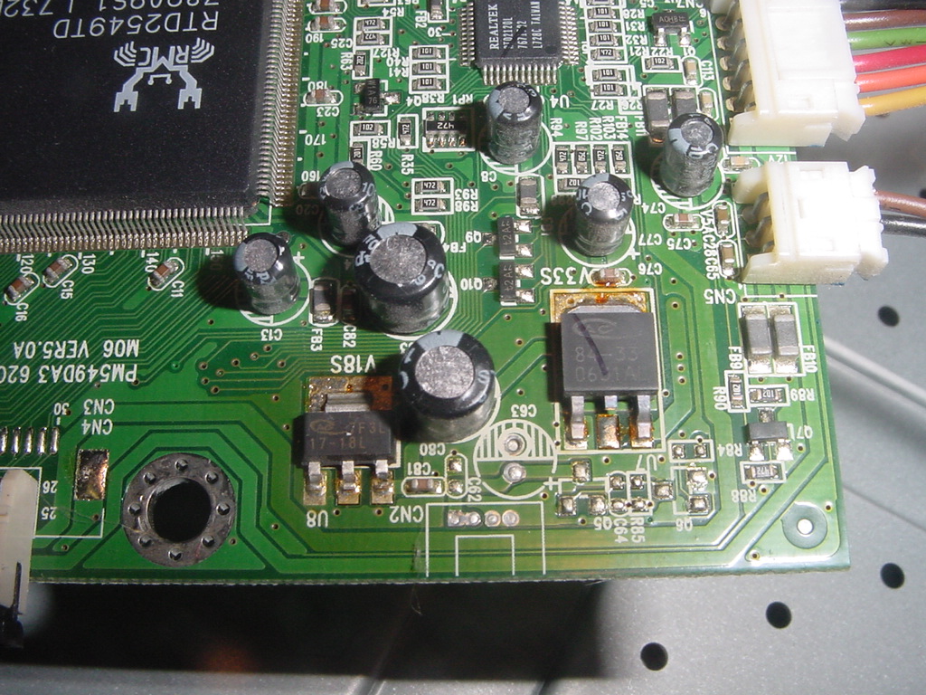

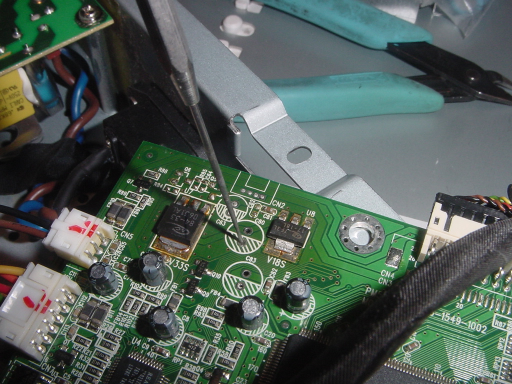

    Just fixed this model, the symptom is, at low resolution, the backlights will be on but I can noise and horizontal noise bar, when I set the resolution to its native resolution, it will act like 2-second to black, the blue power light will stay on.

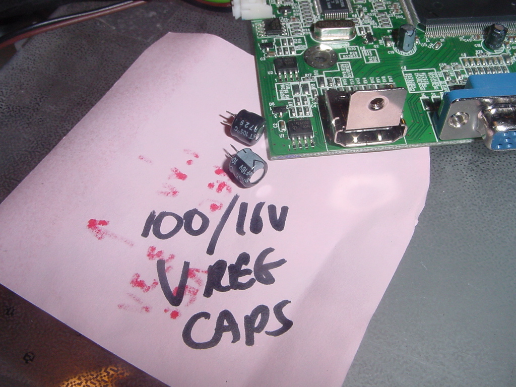

    The cause of the problem was due to two bad DC filter caps (100uF 16V) for the 3.3V and the 1.8V LDO on the logic board.
    See pictures.
    One cap show 80uF with 3 Ohms ESR, another one read 100uF with 3 Ohms ESR.

      By the way, at first I thought the 3.3 and the 1.8 regulator were bad because the out put were more than 3% less than it should be, so I use the scope to see how bad AC ripples were, and they were high, around 150mV, so I just parallel the caps with another caps, then the output voltages went back to where they should be, 1.8 & 3.3V.
      So sometime you do need to use the scope or just parallel the filter caps with good know caps to see if it solves the problem, parallel is so much easier for DIY, I use the scope to find out what is going on.
        Re: HANNSG HG281D problem with pix and backlights
        Or if you don't have the expensive equipment or knowledge to use it, when you see electrolytic caps (especially ones from a crappy or not well-known brand) next to hot linear regulators, always try replacing those/adding new ones in parallel before suspecting the regulator.
        Congrats on the fix by the way .

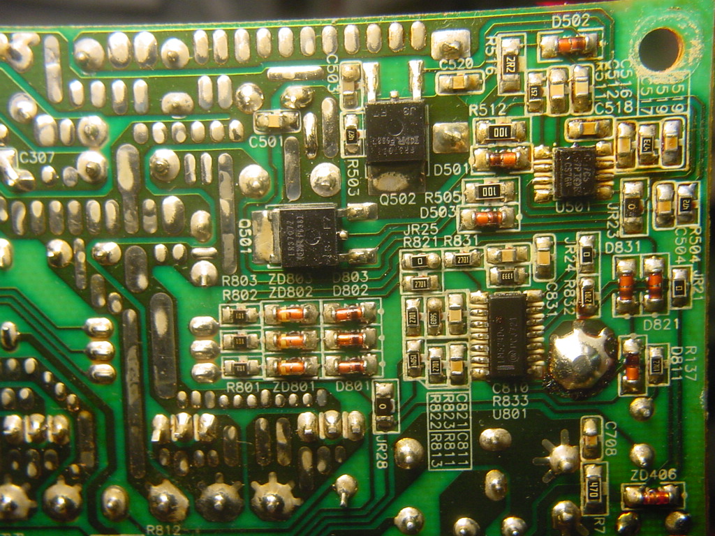

                I will post pictures here.
                I posted another post before I saw this response.
                I noticed it seemed this was an old thread so I thought no one saw it.
                I took the thing apart and see no bad caps. SO now I am going to take some high res pics of the boards so someone else can see these caps. I could be wrong of course.
