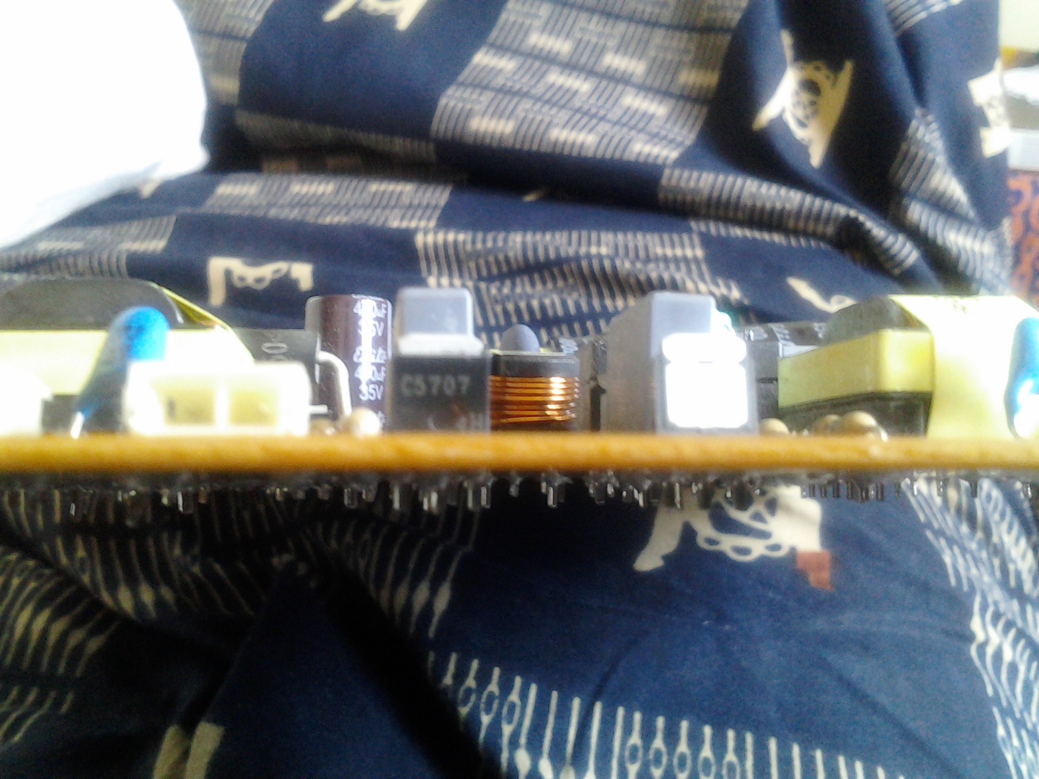

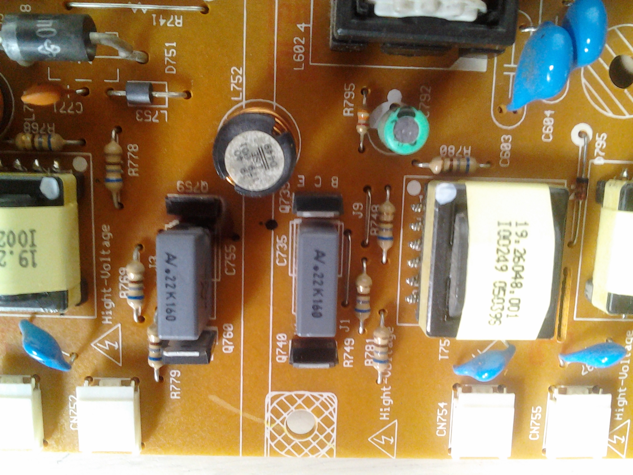

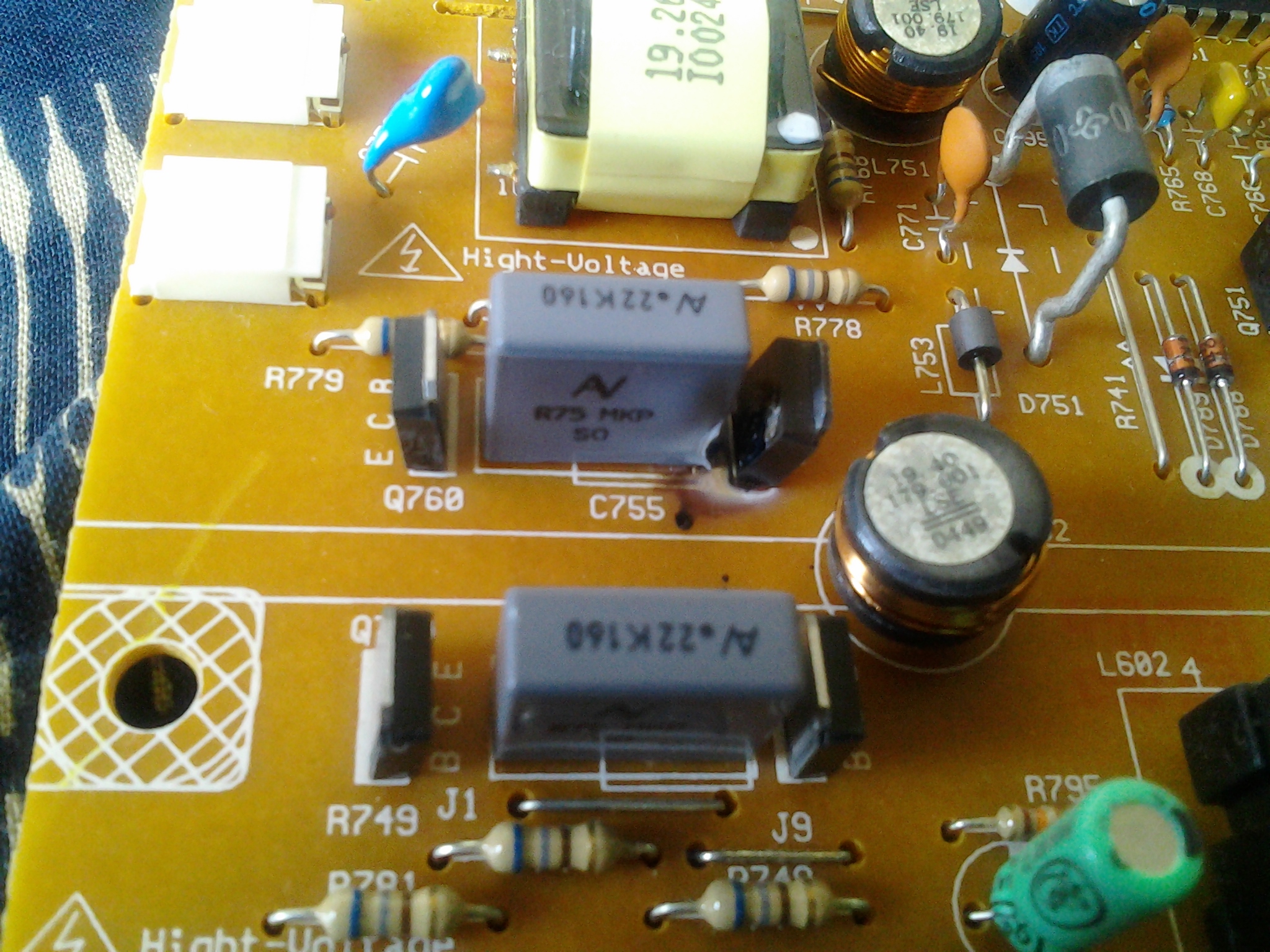

    Hi specialistS,
    I'm new here.I'm a musician (damn!).But I'm about to try repair my living room monitor and I need a real PRO advice.
    I have the infamous "my display won't turn on issue".It happened in the past with another monitor.I was able to fix it myself changing a faulty capacitor (a challenge for simple music maker)
    I did my research reading posts,trying to educate myself.I attached what I think is the issue this time.(a burned capacitor/transistor not sure which one so I'm bout to change both).
    I attached some pictures.I think I was able to identify the transistor a C5707 http://www.mouser.com/ProductDetail/...nJU2aai%252beQ
    I think I found the cap.too a : Film Capacitors .22UF 160V 10% BUT I want to be sure and check with PRO before I order it.
    Thanks a lot for any advice.
    Also any other advice on the cause or the problem itself is welcome.

      Its a standard fault with these boards.You need to change all 4 of the 2sc5707,the capacitor value you have also got right as well.The transistors may well be found on Ebay in smaller quantities.On fitting them you must ensure they go in the correct orientation, also you need to resolder all of the 4 yellow transformers,as they were probably the cause of the fault, due to a dry joint.

          By the way it is usual to replace all the 5707s as they usually work in pairs and both caps or all four if there are four.
          Detail of the monitor or the full board would help.

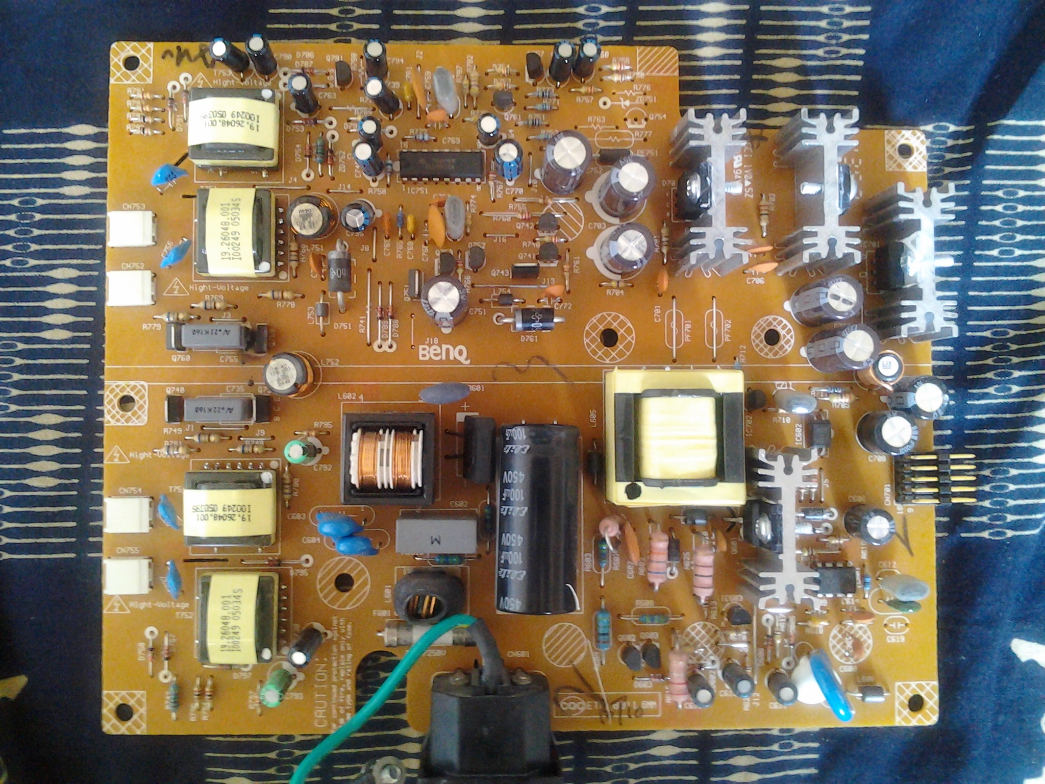

            Here :
            - the board seems to be a BenQ J18 or CQC ETL 8011.6MM or GCI1V0 SZ (I don't really know what makes sence to you here).
            - the monitor is a old Dell 17" model E173 FPb
            Is a picture from the top of the board might be useful ?

              A pic of the board from the top in case you guys think of any warning/advice before I start...

                This looks like a good sub
                http://uk.mouser.com/Search/ProductD...Cn7NBVyg%3d%3d
                You will need to measure the one you have (physical size) gap between legs and see if it is similar.
                As Rtech says this is a Benq board and you will need to reflow as many joints as you can.
                Some people remove as much old solder as they can, then resolder. Some introduce a little new solder to make it melt/flow a little easier.
