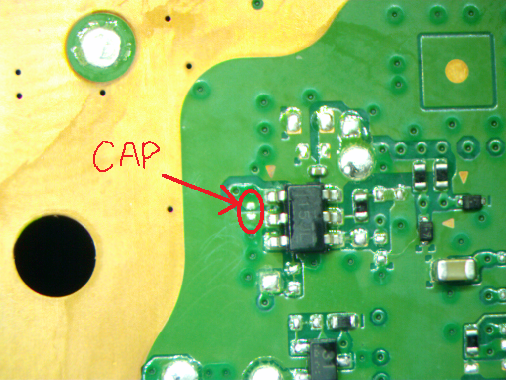

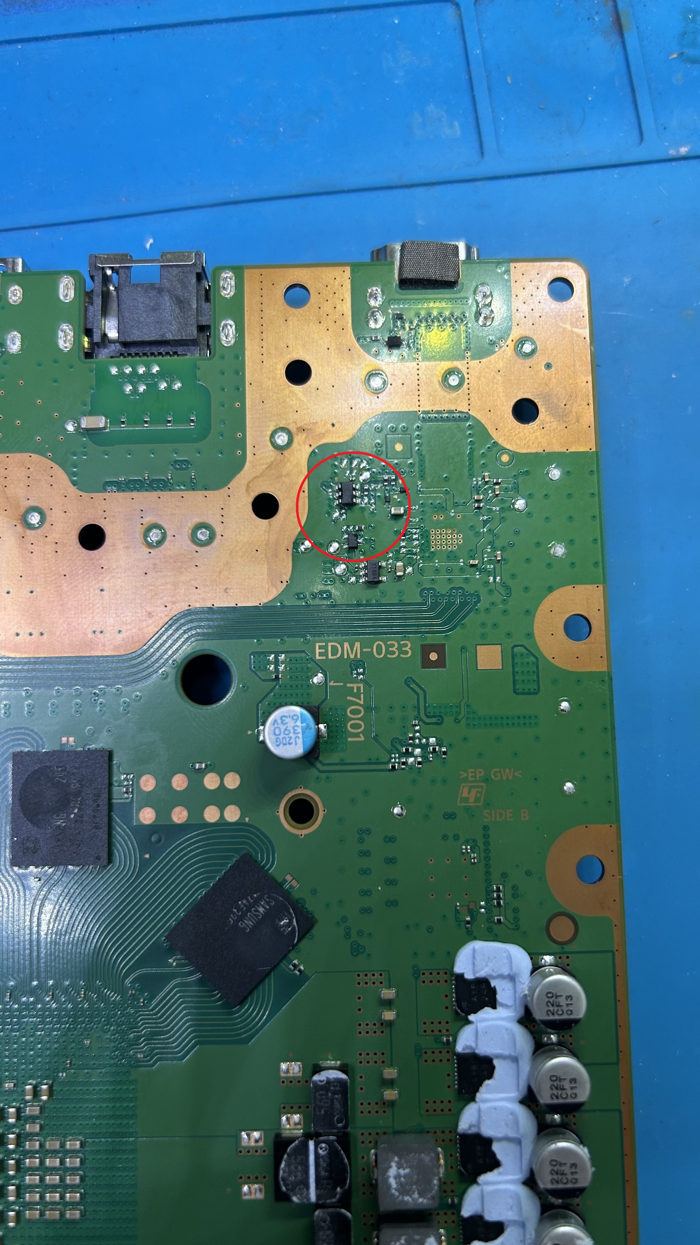

    Dead PS5 CFI-1216A, only 12v present on the board EDM-033

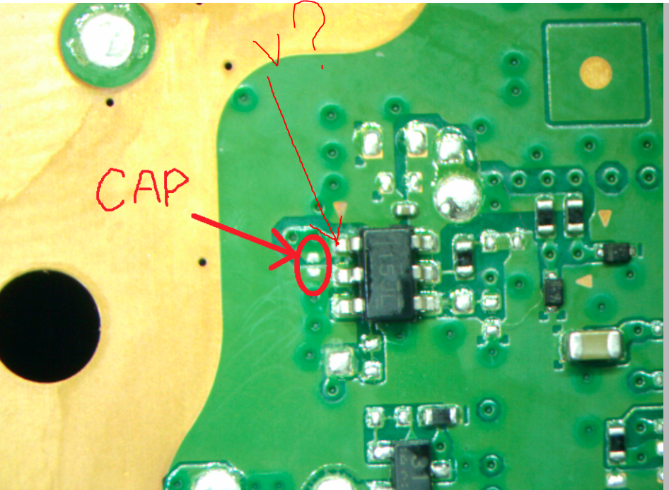

    Blown capacitor which is located 'under' HDMI Decoder IC on the other side of the board. Does anyone know what is the value of the capacitor, please? Pics included.
    Thank you

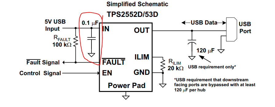

    First, find out what kind of chip it is by the marking, its marking is 15JL - and this means TPS2553D, download the datasheet for it and find out that between pin 1 (IN) and pin 2 (GND) there is a 0.1uF ceramic capacitor.

        thank you, shorts gone now.

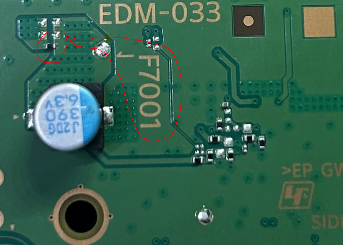

          Check if the voltage on this 1 pin is relative to the ground, if there was a short circuit on this bus, then the smd fuse could have burned out, they are marked Fxxxx on the board, with a directional arrow, check them all.

            all fuses are ok. both pins 1 and 4 show 5v
