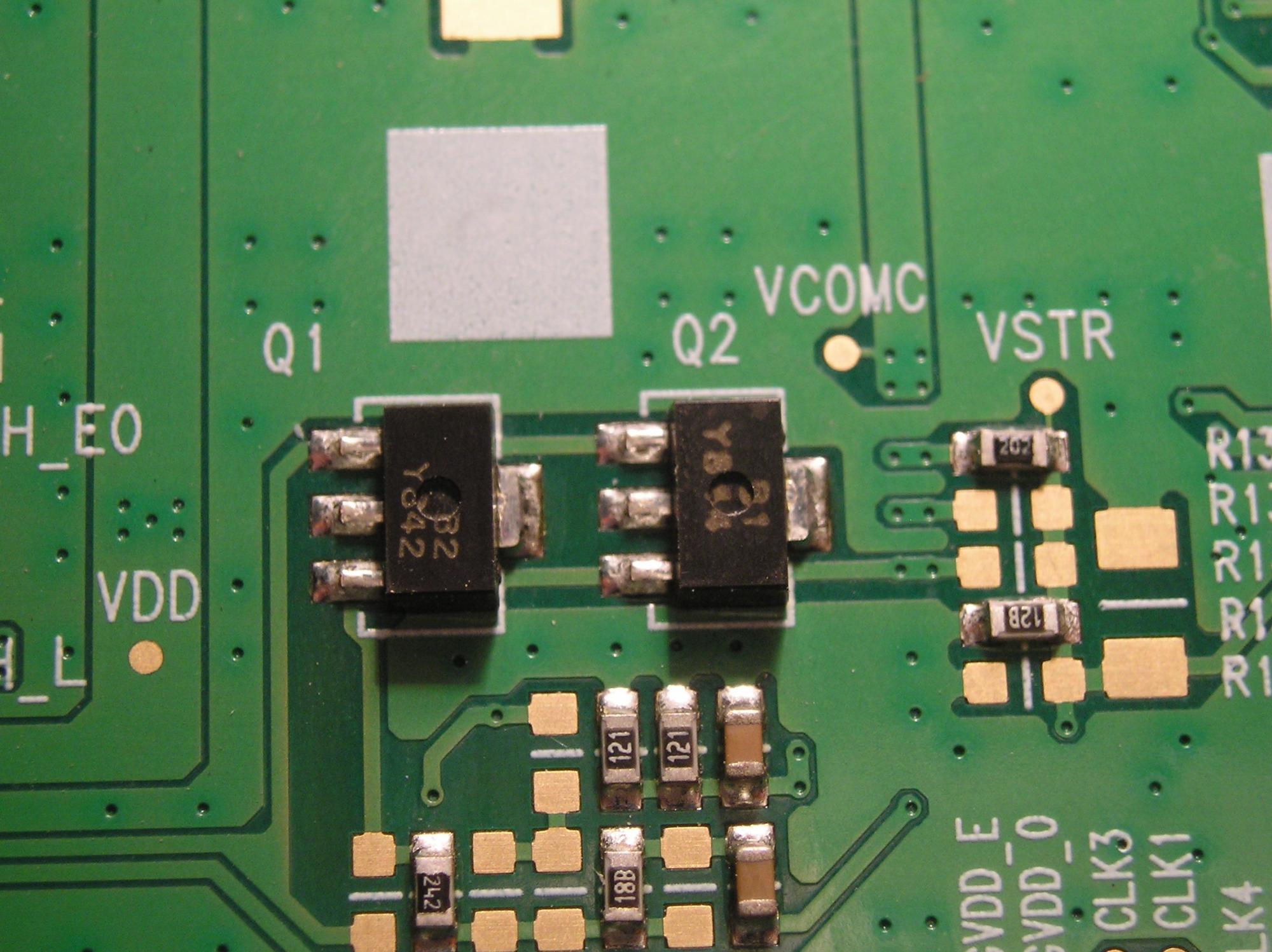

        Also there are two components on the right hand side of the board Q1 & Q2 can you read the part numbers. We could do with some panel experts on this
        alexanna would know just where to do what tests.

          Sorry selldoor i'm unable to read the writing on Q1 Q2
          But i went over all the tcon lvds connector pins, no change,

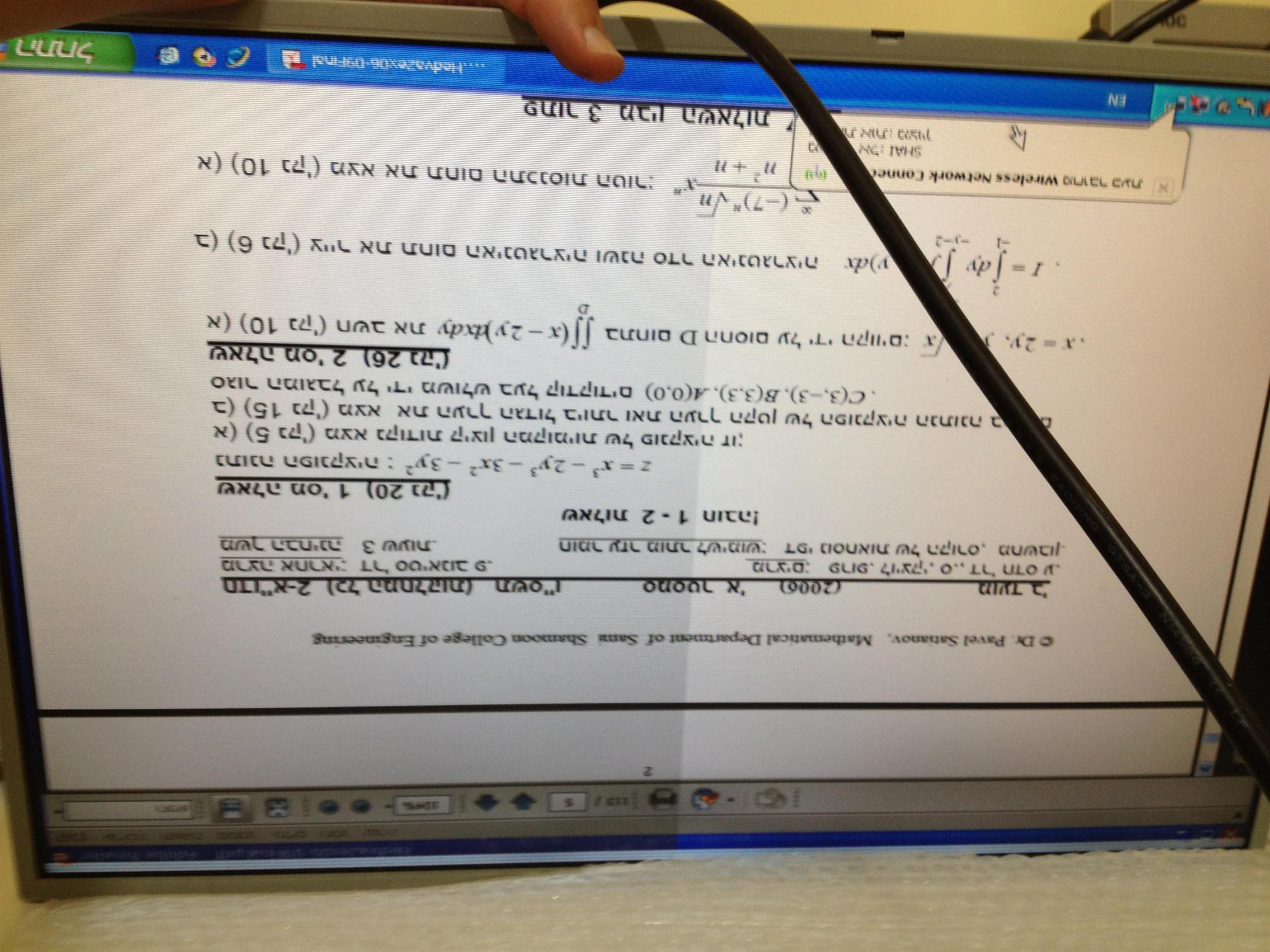

          Its weird, on a cold start i have strips all over,
          after a minute or two, the strips dissapear,
          And the image is pretty good, but half of the screen has much more light than the other.
          Did some more voltage testing on Q1 Q2:
          Q1:
          PIN1:5.7
          PIN2:12.2
          PIN3:5.23
          Q1:
          PIN1:5.7
          PIN2:0.05
          PIN3:5.23
          Any ideas? by the way i have never replaced a smd transistor,
          tried once, on a old bad mainboard, transistors came out totally bad!.
          maybe to long on the hot air 450 degres ruined them....

            0.05 doesnt look good but I dont really know. We need someone who does to look at it.
            Sometimes if you clean with a little isopropyl alcohol on a qtip it brings the writing up- tried a magnifying glass?
            U is usually a regulator and Q is usually a transistor but not always - great system!
            This one of our members removing a component just needs confidence - Ive not done it.

                if i knew what type of transistor is it i would order one or two and replace,
                but i cant read clearly as you can see...

                    selldor your guide helped a bit, thank you
                    the half screen was a function :-)
                    but there a still some strips on power on and little lines on the screen,
                    im going to investigate some more tommorow and update as soon as possible

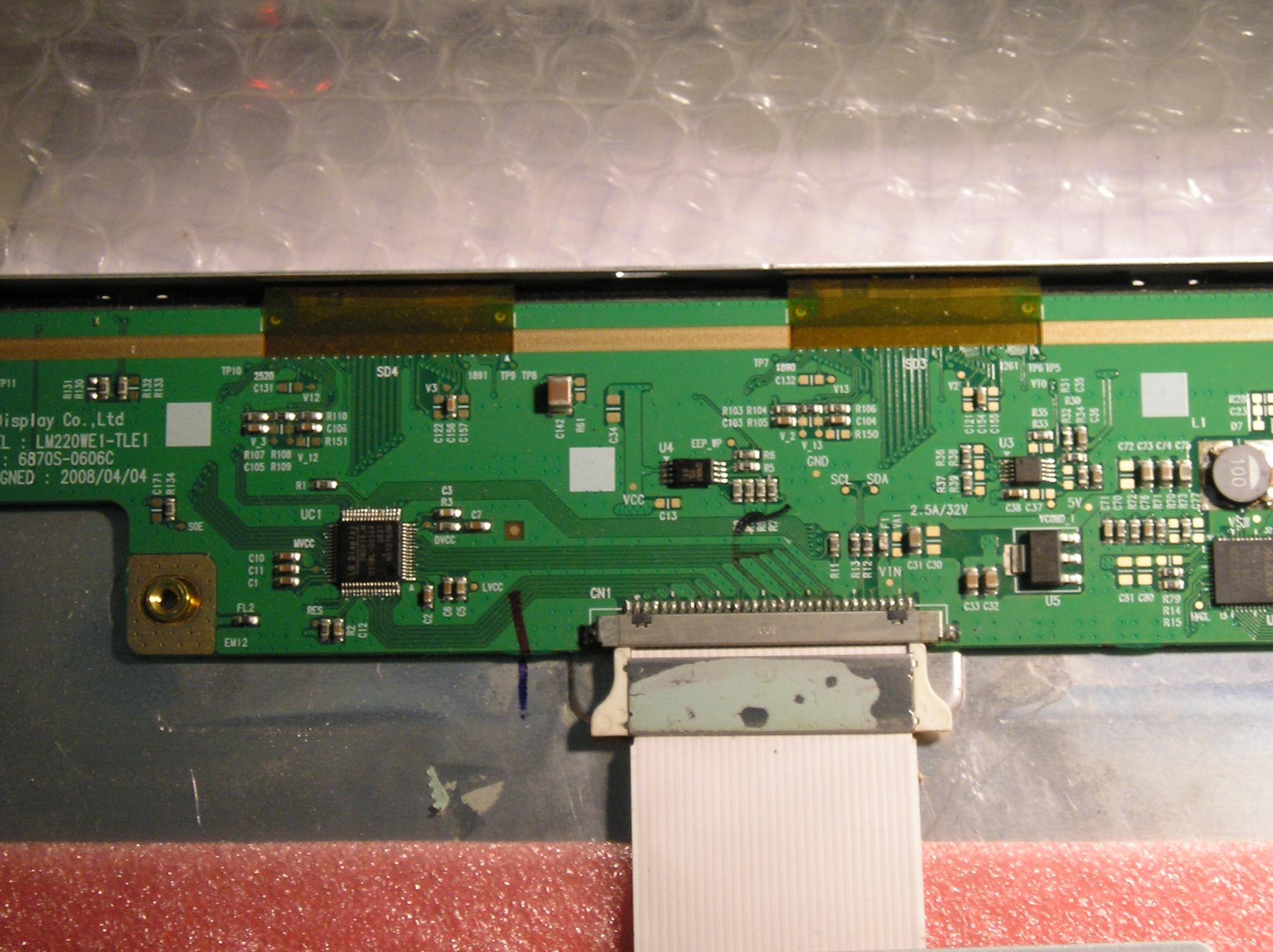

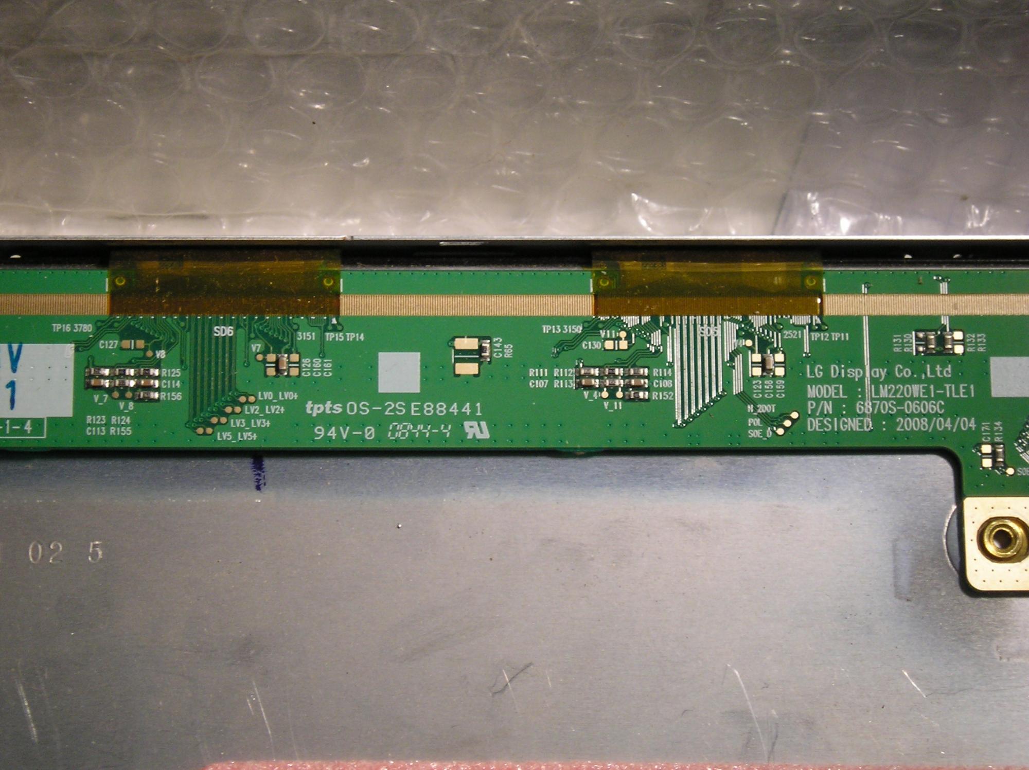

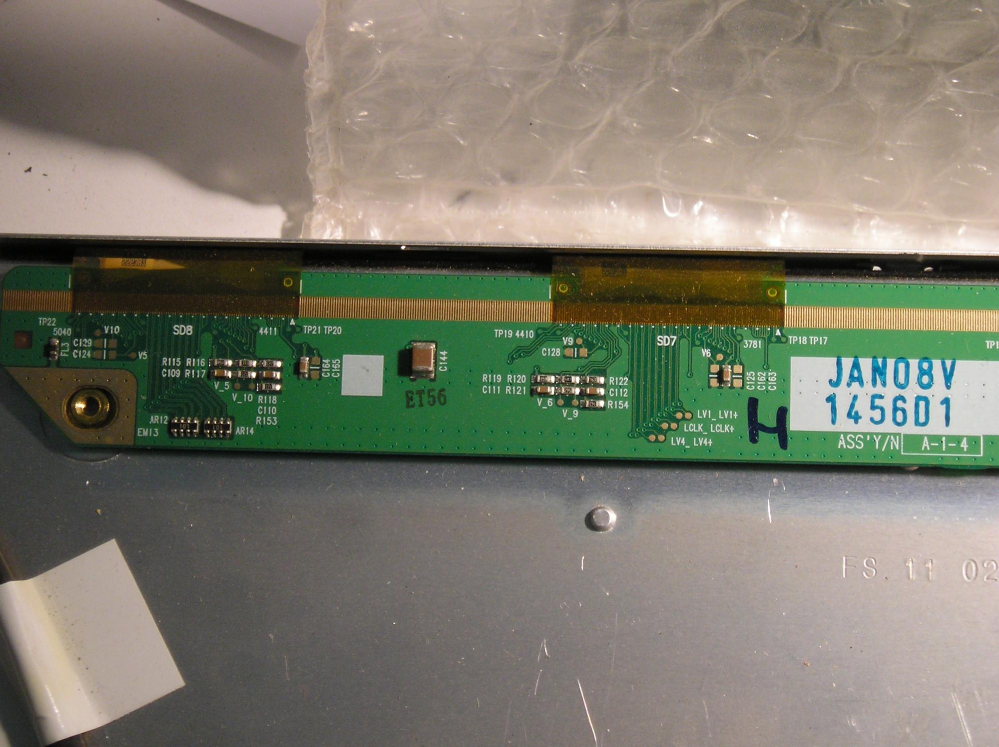

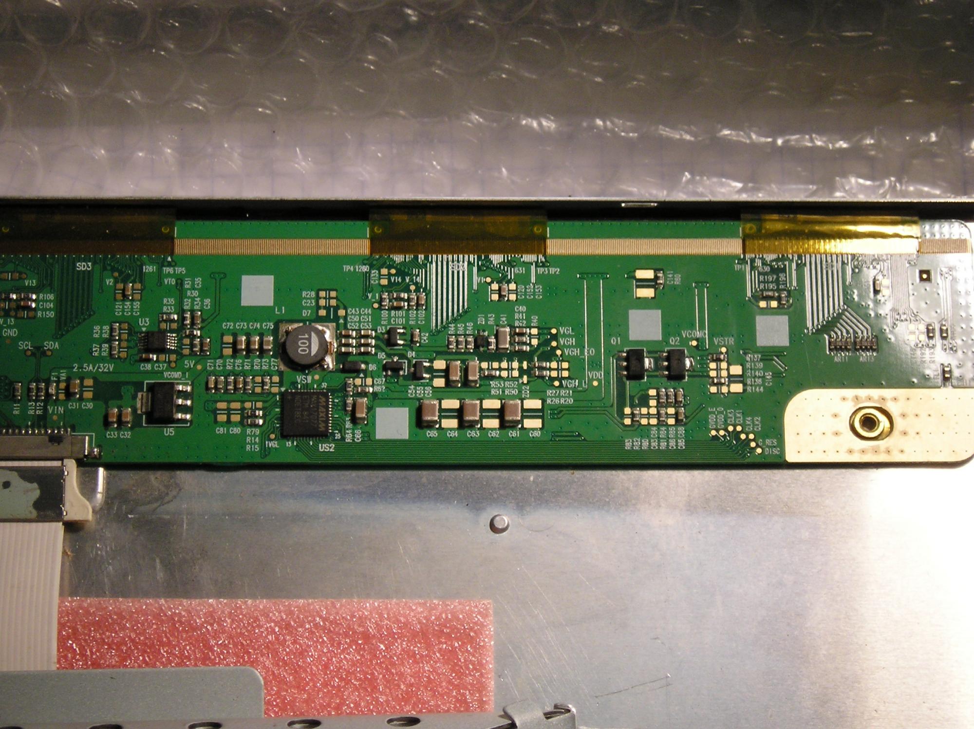

                      the tcon model: LM220WE1-TLE1
                      i've added 4 more pics it goes from left to right

                                got a 20.5 samsung with a little crack,
                                plugged the cracked screen to the power supply and logic board of the lg
                                and the picture is perfect,
                                plugged the samsung power supply and logic board and the image is even more
                                scrambeled,
                                so the tcon board a bad for sure,
                                i need some instructions for fixing it if even possible,
                                could be a bad ic or lvds connector?
                                the tcon is attached with ribbon cables to the screen and i dont think it could be replaced.
