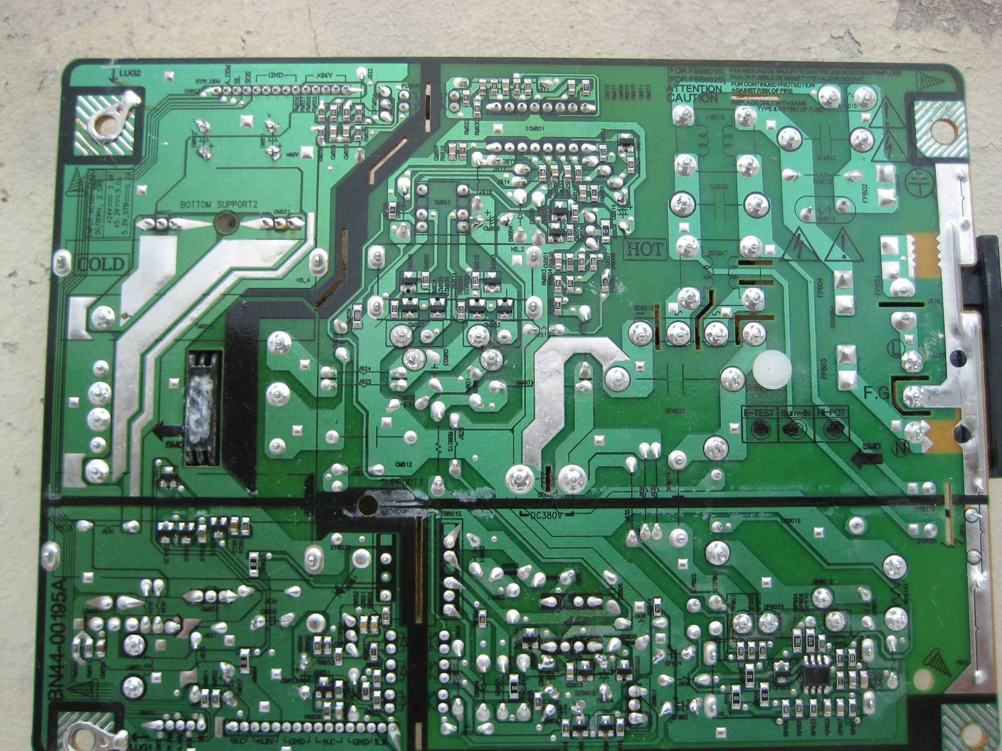

    I've been trying unsuccessfully to resurrect my 2493hm reading throught
    badcaps.net
    It started like that: I tried to switch it on and heard "pschtt" and the screen went immediately black.
    The symptoms are the following: No image, the blue led stays stable, the 2493hm can be switched on & off from the front panel.
    When telling in several stores that the screen was only 4 years old when it went dead I was told: "Sir, nowadays, most of the screens & tv last an average of 2 to 3 years..."
    THAT annoyed me a bit and I'd like to prove them wrong !

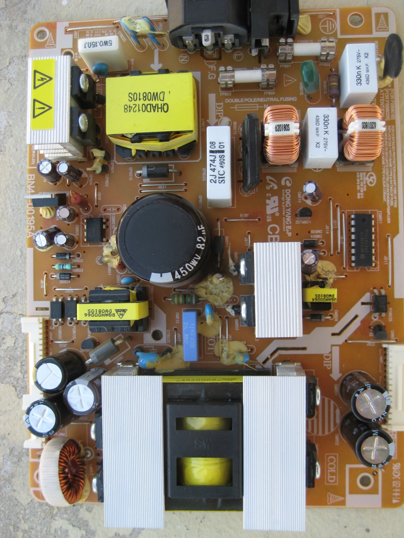

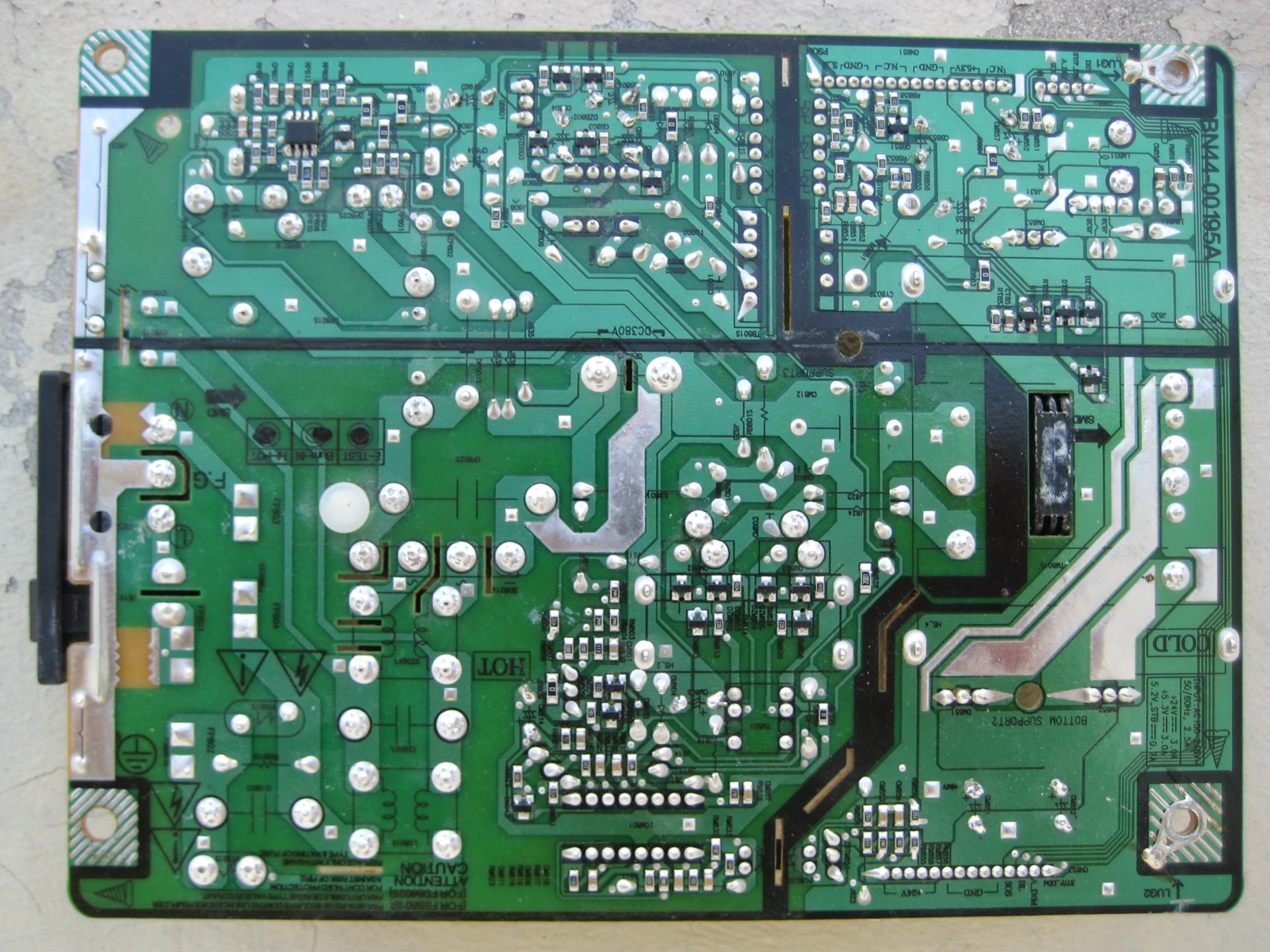

    Attached are the photos of the logic board & power supply.
    The following threads helped me for the following below:
    https://www.badcaps.net/forum/showthread.php?t=15796
    https://www.badcaps.net/forum/showthread.php?t=15843
    https://www.badcaps.net/forum/showthread.php?t=13366
    Power supply BN44-00195A.
    -The fuses are good (tested continuity)
    I've changed all the electrolytic capacitors except the 82uF/450V.

    At the back of the PCB near that MC33067P, I checked a few resistors:
    STRA6159 chip ICB801S
    Code:
    Pins OFF  ON
    3-1  0   0,02
    3-2  14,44 16,51
    3-3  0   0
    3-4  0,44 1,09
    3-5  315  385 <-- seems strange ?
    A few resistor a the back near the STRA6159 chip:
    RB816 99,45K Ohms
    RB815 2,19K Ohms
    RB813 4,16K Ohms
    Tested in-circuit (power off):
    RB??? (next to the RB802) 98,94 KOhms (brown black yellow gold)
    RB802 98,70 kOhms (brown black yellow gold)
    RB803 46,23 Ohms (yellow purple black silver)
    RB808 2,2 Ohms (red black gold gold)
    RB801S 33,08 Ohms (yellow yellow black gold white)
    RX801S 750 kOhms (purple green, yellow kaki black)
    RW801 0,5 Ohms (red red silver gold)

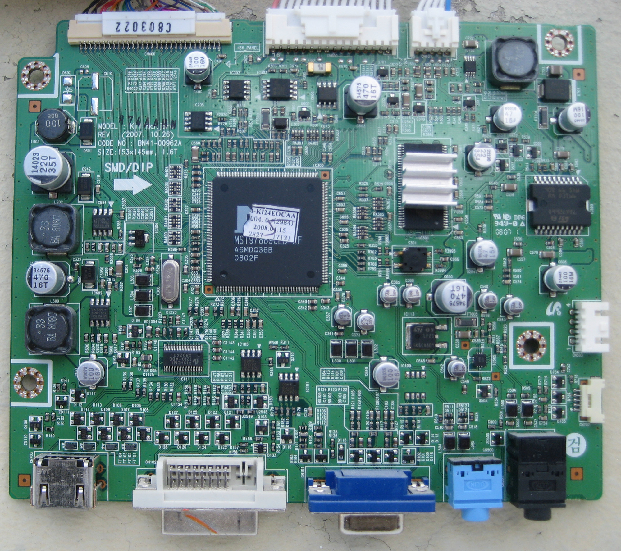

    Logic board BN41-00962A:
    I checked the following:
    IC113 LF25:
    Code:
    Pin ON  OFF
    1  3,25 3,25
    2  0   0
    3  2,5  2,5
    IC305 6P807
    Code:
    Pin ON  OFF
    1  5,22 5,22
    2  0   0
    3  5,21 5,21
    Could the STRA6159 be bad ? Should I change it or check something else ?
    Thanks in advance for your help !

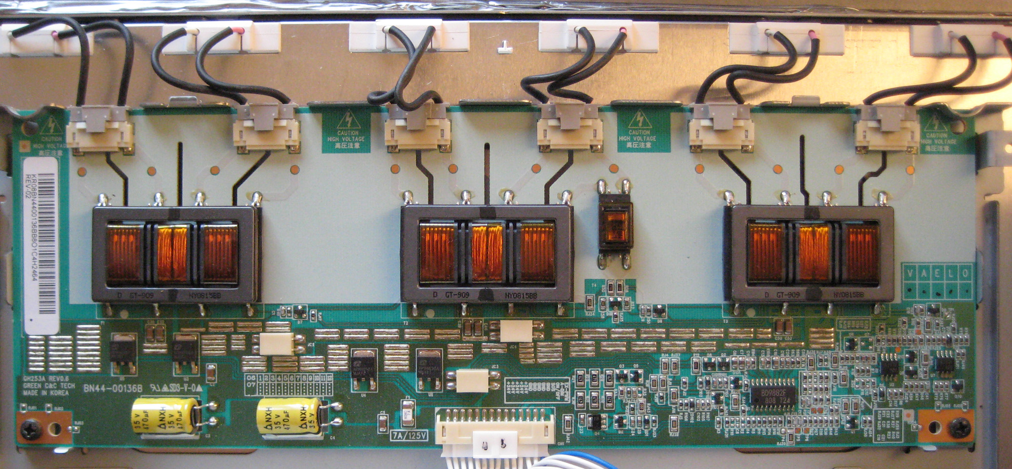

    1) Excellent clear focused photos. A picture of your inverter board is also required.
    2) If you heard a "pschtt", it could be arcing from the ccfls to the metal frame.
    3) If you have no backlights, it implies
    i) blown fuse in the inverter section
    ii) shorted mosfet or transistor in the inverter section
    4) A blue power LED implies your power and main board are likely working okay.
    5) If the backlights are on and you have no picture, then we need a picture of the t-con/panel board. This board is at the top of the lcd and runs the entire length of the lcd. It may be underneath a metal shield. There is usually a SMD fuse and it could be blown.
    6) Clarify "no image" with respect to #3 amd #5 above.

      Along with retiredcaps comments:

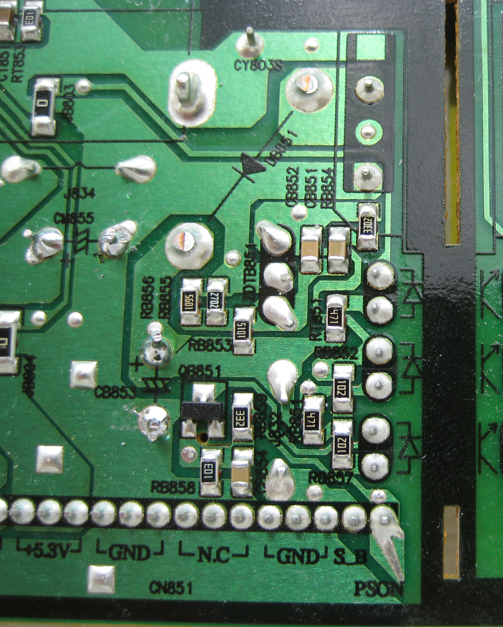

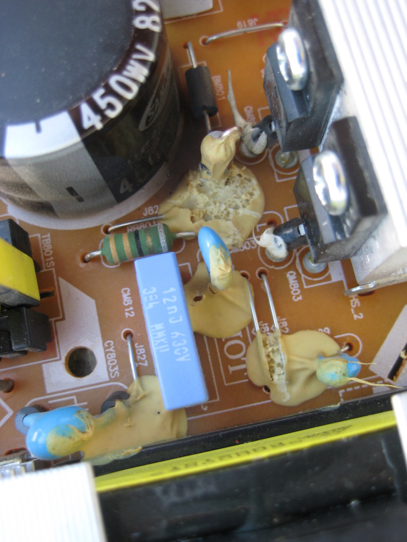

      Need a sharp - clear photo of the back of PSU in the lower left quarter. Starting from just above the horizontal black dividing line, and to the left of the vertical black line. Appears an SMD resistor is blown there.
      Unlikely the IC is bad.
      The rectangular blue cap on top to the left of the transformer has been a problem.
      Discolored adhesive/glue has been a problem. Becomes conductive if it gets heated and turns a darker brown.
      I see Nichicon and Panasonic caps. What brand/series are the other 3 that you used with the elongated "X" ?

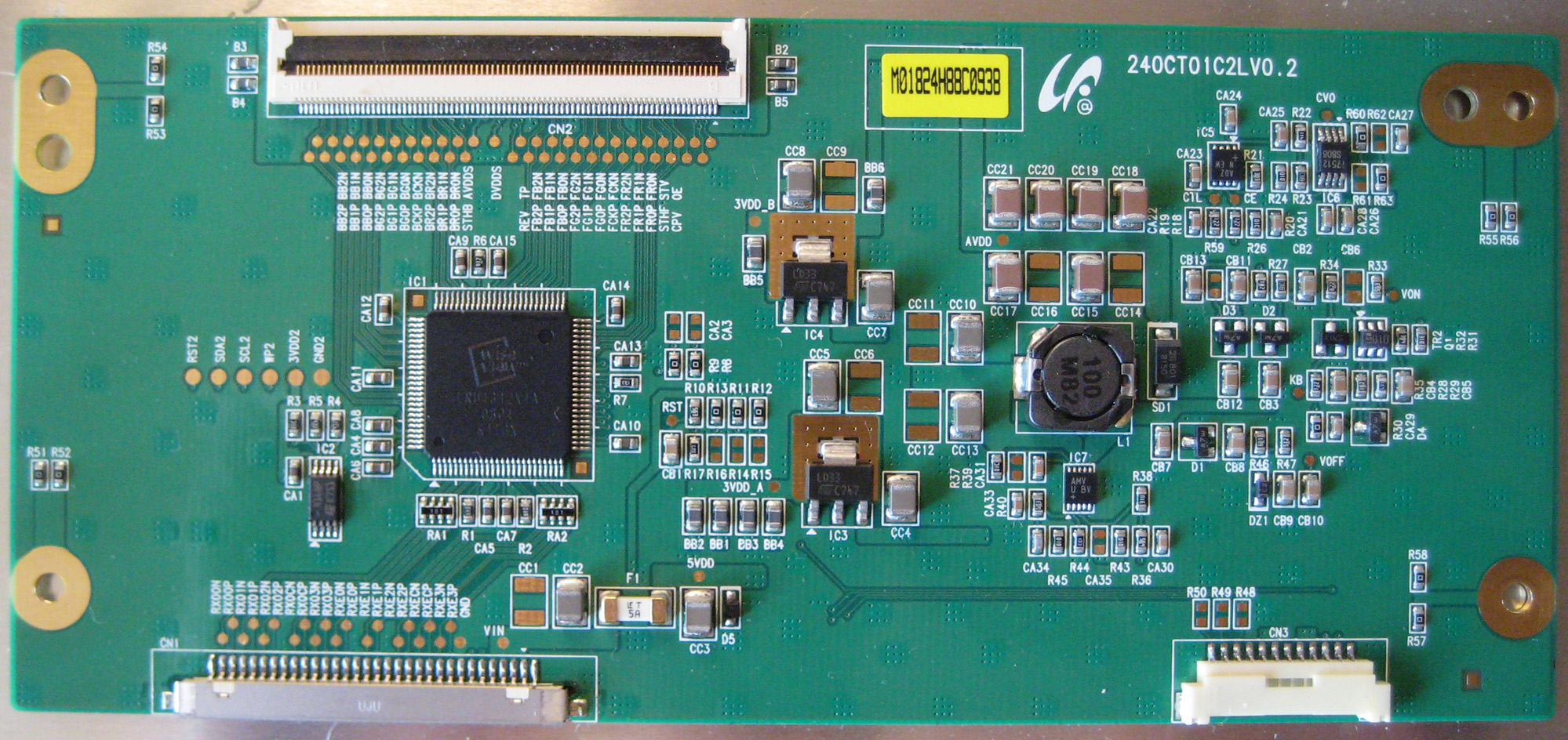

          Checked on the t-con/panel board:
          Code:
          Fuse F1 ok
          Code:
          R3 10K
          R5 3,95K
          R4 3,60K
          R7 13K
          R21 29,91K
          R22 53,44K
          R23 298
          R24 47K
          R27 980
          R28 1,8K
          R29 42,9K
          R30 Variable > 3,1
          R32 230K
          R33 56,18
          R34 6,21K
          R35 1,2K
          R37 10K
          R38 333K
          R40 68K
          R43 12,45K
          R44 10,33K
          R45 10,40K
          R46 680
          R47 5,09K
          R55 0,22
          R56 0,23
          R60 0,22
          R63 Variable >3,1
          R66 1,75K
          the 2200uF is a Panasonic FM serie
          the 35v 1000uf is a NIC Components NRSZ serie
          All the others are nichicon PW series

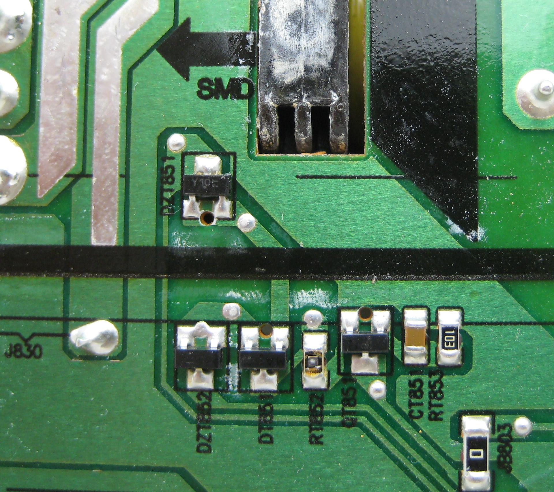

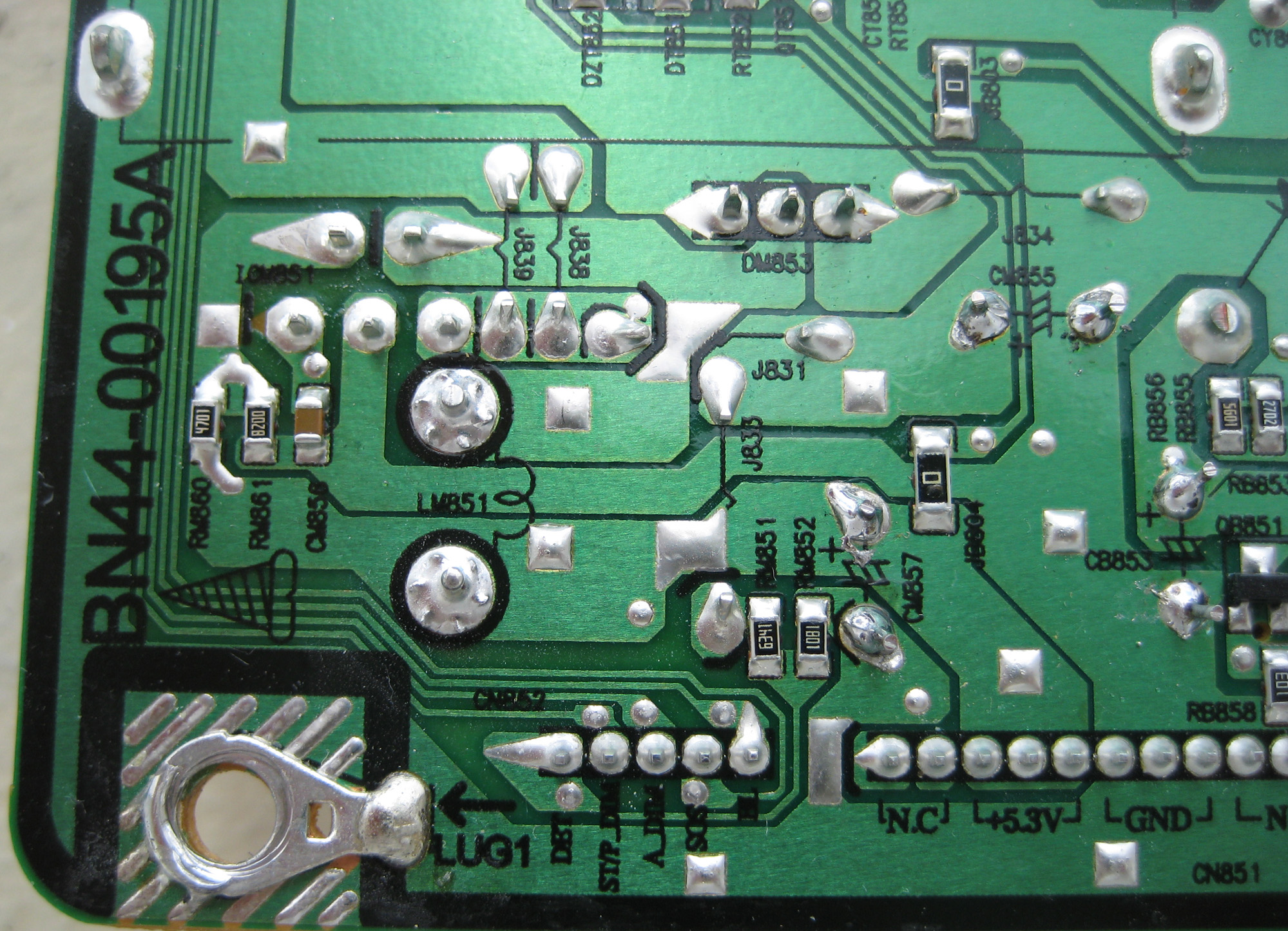

          Toasty, it seems you have an "oeil de lynx"
          The RT852 looks as if it's blown (psu_solder_detail05.jpg), however, my ohmmeter gives a reading of 224,25 Ohms (Is it the expected value ?)
          @Budm: There is no backlight at all, even when connected to a pc
          The requested pictures attached.

            As budm mentioned, the backlight on is generated by the main board. When you press the on/off button repeatedly, does this BL change voltage at all?

              24v is dead.
              Resistor is 100Ω. Transistor to the right is likely blown, and the 24v zener is probably bad too.
              The buzzing could be a short/arc to frame, as RC mentioned. Or, just bad tubes.
              Do you have 5.3v standby? Remember that ground on the LEFT of vertical stripe is different than that on the RIGHT (HOT side).
              Check the 245BW threads. Same PSU is used and I did a bit of work on that with the last thread:
              https://www.badcaps.net/forum/showthread.php?t=18966

                  Following the thread you mentioned, I check the 82uF cap , it reads 385V power on.
                  For the 2 components (DZT851 and QT851) next to the RT852, I get readings that seem ok (I'll post them tonight). But since I need to order a 100Ohm resistor, I'll order the two others as well & change them.

                    Here are my results :
                    QT851:
                    Code:
                    B E 9,9K /9,9K Ohms
                    C E 0 / 3,4M Ohms
                    B C 3,30M / 0 Ohms
                    DZT851
                    Code:
                    0,591 / 0 in diode test mode
                    1,29M Ohms / 9,6M Ohms using the resistance mode
                    @newbie1: from C337 to gnd : 1,20V (monitor on or Off), 81 Ohms (gnd to c337) and 125 Ohms reversed

                        QT851 looks to be shorted B to E. It's a 1P transistor. Common as they come.
                        The emitter sits on ground and explains why the resistor burned.
                        DZT851 & DZT852 are zeners. They sit on the 24v and 5.3v and output to DT851 a dual diode. It's a protection circuit that watches if the 2 voltages get out of line (either zener conducts) and through RT852, trigger QT851 to conduct. That in turn, enables the optoisolator PC804 (top one of the 3 to the right), which sends a signal (via a transistor and resistor) to ICM801, pin 10 (fault input), causing the PWM to shut down.
                        The 24v "makes" the 5.3v when running. Removing QT851 may allow the unit to come on and you can verify operation and voltages.
                        Whew!

                                  GND  0   0
                                  NC  0   0
                                  GND  0   0
                                  5.4V 5,42 5,42
                                  NC  0   0

                                    I changed QT851, DZT851 & RT852...
                                    Voltages are:
                                    CN851
                                    Code:
                                    Pin  OFF  ON
                                    PS_? 0   3,147
                                    S_B  5,24 5,24
                                    GND  0   0
                                    NC  0   0
                                    GND  0   0
                                    5.4V 5,42 5,42
                                    NC  0   0
                                    Here is a change:
                                    CN852
                                    Code:
                                    Pin OFF ON
                                    DBT   0,2 5,34
                                    ST/P_DIM 0 2,2
                                    A_DIM  0 5,34
                                    SOS    0 0,45
                                    BL    0 4,49
                                    There is a slight continuous buzz when the psu is on, but you can't hear it when everything is put back in place.
                                    and..... the monitor works again ! I hope it will last
                                    Toasty,newbie1,budm & retiredcaps a big big BIG thank to you all !
                                    For less than 40Euros I avoided throwing the thing to the bin, that's cool !

                                        ok, back one year later on the same monitor !
                                        I suddendly heard a big >clac< a flash at the bottom of the back side of the monitor and a little smoke : black screen....
                                        I opened it again and found a resistor on the power board that is all back and when tested reads 6,5 MOhms (RM801).
                                        Tested QM803 and QM801 they are shorted.
                                        unlike here, TM801 seems ok:
                                        https://www.badcaps.net/forum/showth...ghlight=2493hm
                                        Going to order 2 FQPF9N50C and a resistor to replace the RM801
                                        but I need 2 infos:
                                        - What is the value of RM801 ?
                                        - and do I need to replace or check something else
                                        preventively ? (caps have already been replaced)
