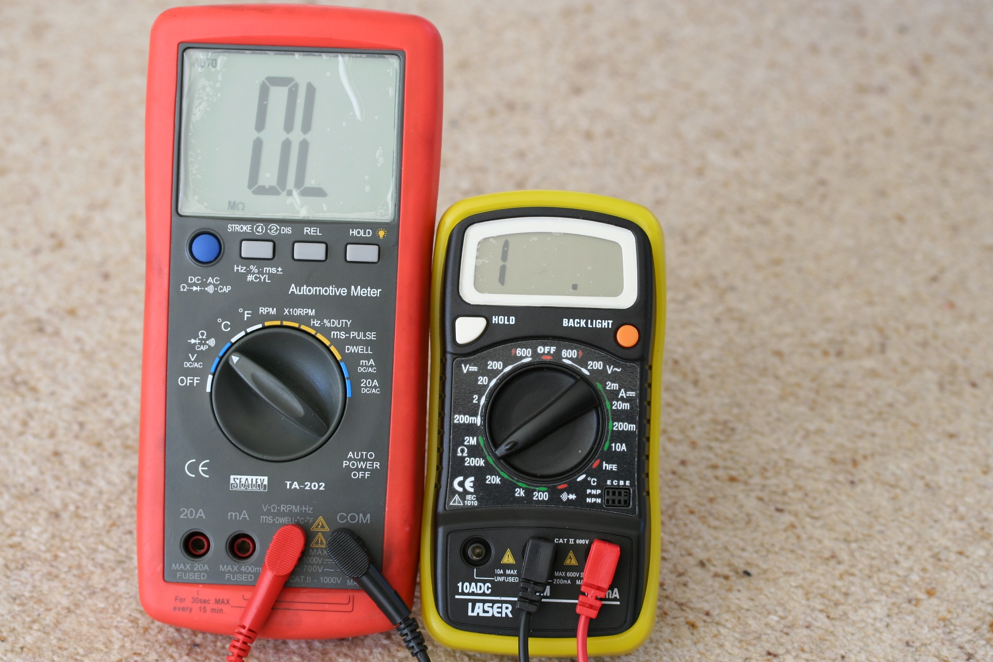

                  Re: Dell E173fpf - No led coming on
                  "1-6 = 130ohm --> open" What does it mean? 130 Ohms one way with the probe, and open when you reverse the probe, just try to figure out the reading.
                  When I put the leads onto the pins it gave me 130ohms initially and then about 1-2 secs later it went to open.
                  Ok so this is the title of the DMM that I used: Laser 3534 Multi Meter/temp Tester - Digital
                  I also have a more advanced multi meter Sealey TA 202 - I haven't tended to use this as there were concerns over it's accuracy which came about when I didn't know much about testing capacitance. Basically I used it on a live (hot) cap and now it doesn't read capacitance, also I am not entirely convinced of the DC voltage readings - these jump up and down a lot. I am going to post it on here at some point. Anyway the resistance readings seem to be ok here they are:

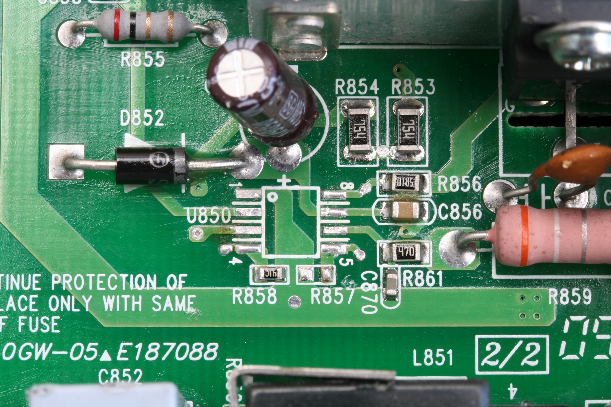

                    #29
                    This technique worked well and I removed the copper strand, but I am not sure how much heat went into the chip (it wasn't smoking). Old chip out of circuit values as follows:
                    1-2 80k
                    1-3 0.476Mohm
                    1-4 1.606Mohm
                    1-5 11.28Mohm
                    1-6 11.09Mohm
                    1-7 13.90Mohm
                    1-8 96K
                    Here's a close up of U850's location and the pads - I may need to clean some of those pads up a bit more? Use pointed tip for this?
                    Fixed so far: GNR TS902W monitor, Sony Game Gear, Philips FCD565, Arcam Alpha 10, Memorex SA 404amp

                      #30
                      Ok so I've got the new SMPS at U850 soldered in and now there is no ticking, but also no led lit up. C857 gives a more consistent voltage across it ~12 -~14v . C854 is sitting happily at 340v dc.
                      Next I put the inductor (L853) back in and tested - no ticking
                      Lastly put the resistor (R870) leg back in, tested - now its ticking like before.
                      Throughout the testing the board has not been connected to the chassis or the screen, would this make a difference?

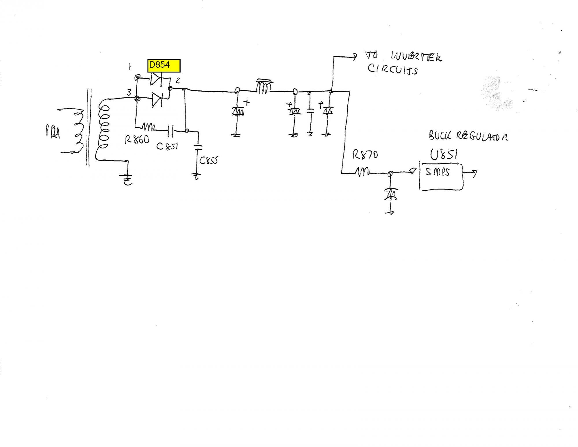

                        #31
                        Ok, R870 is the fusible resistor which is used to supply the voltage to the logic board, that is why the LED does not light up. So the logic board is drawing too much current so it the power supply goes into shutdown again, the inductor is for the ground return for the inverter circuits.
                        Now we need to find out where the shorted circuits are in the logic board section.
                        You do not need to hook up the ribbon cable to the LCD panel, but you should have the lamps connected to the board.

                          #32
                          One retiredcaps' bonus point awarded for the picture. The Laser 3534 is a rebadged version of some generic brand multimeter.
                          http://handsun.en.made-in-china.com/...-HM-838L-.html
                          I also have a more advanced multi meter Sealey TA 202. I am going to post it on here at some point.
                          Start a new thread for that one in
                          "Test Equipment Usage, Techniques, and Reviews"
                          and I'll try to help out.

                                    #37
                                    The D854 does not make sense:
                                    "D854
                                    1-2 0.00
                                    1-3 0.00
                                    2-3 0.00"
                                    It is showing all shorted, but you indicated that you do get the output DC voltage with the load disconnected, then the inverter is connected back, the voltage is still OK, but when the resistor for the Logic board is connected to the power supply output, the power supply would go into ticking mode again.
                                    This D854 is the main rectifier Diode with common Cathode (2 Diode in one package).

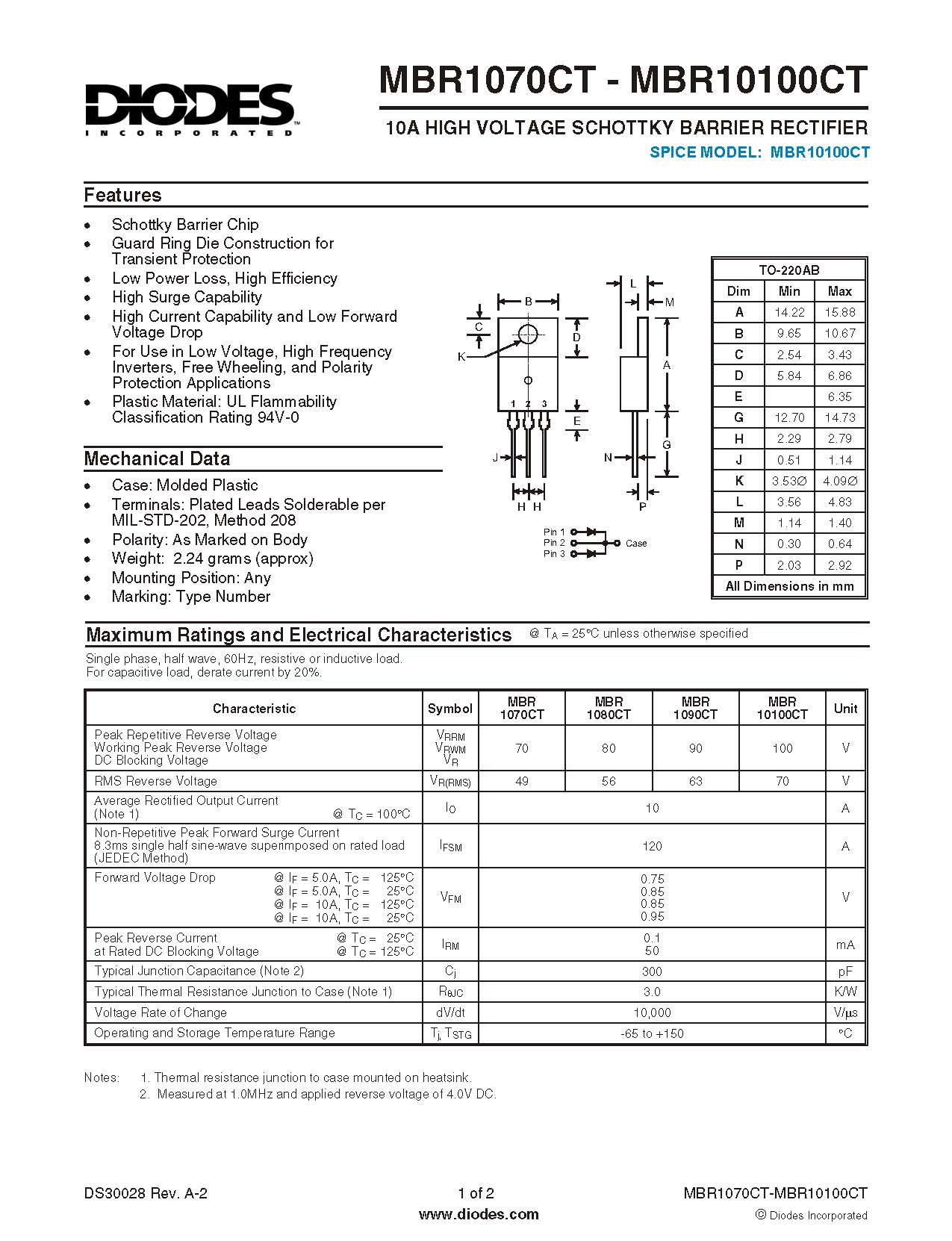

                                      #38
                                      Hi Budm - when I tested the original D854 SRF10-10 it also showed as shorted on all pins. Is something in circuit causing this. I was also quite careful when soldering in the new one as these are more sensitive to heat than caps?
                                      The other thing I am wondering is the original had a plastic body whereas the replacement has a metal back and it's code is MBR10100CT. Is this replacement wrong?

                                          #40
                                          The MBR10100CT is not isolated tab, the metal tab is connected to the common Cathode which is the output side of the rectifier, the heat sink is connected to ground, so basically you short out the winding of the transformer with the Diodes! Please remove it. I should have asked if you replaced wit the same P/N.
