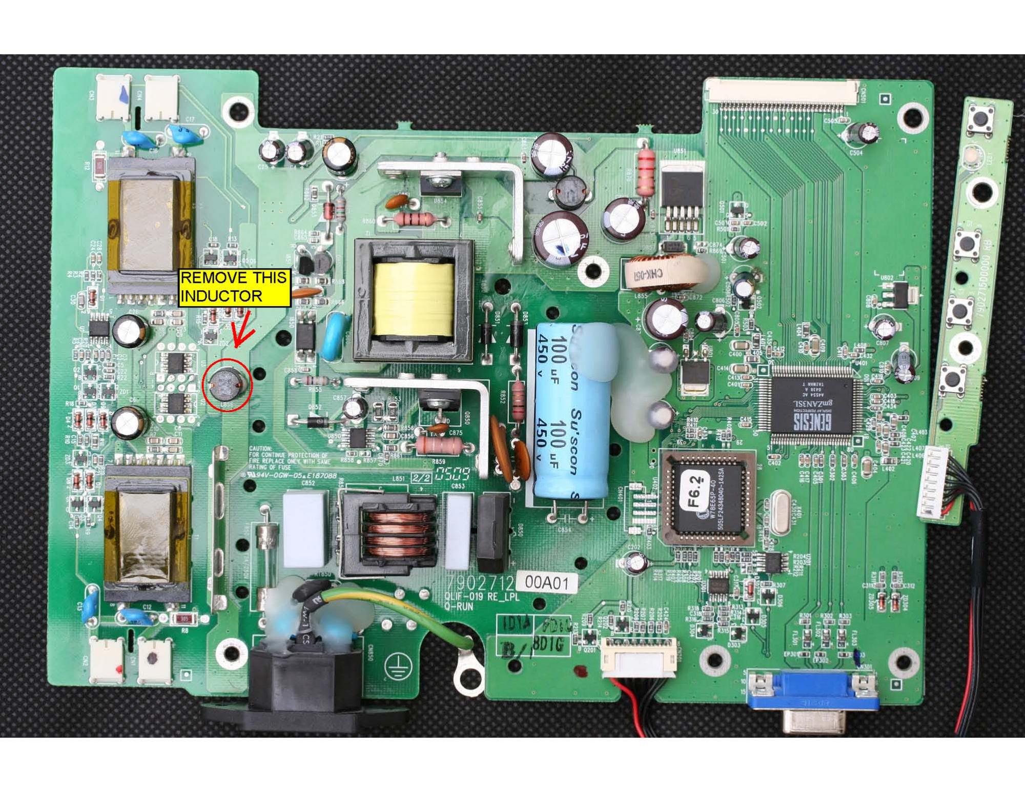

    Fault: No power led comes on and nothing is displayed on the screen at all.
    Observations: constant ticking noise heard from T850 and I get a constant 131v from the primary capacitor (using mains earthing point)
    I have changed cap C506 (4.7uf 16v) as the ESR was slightly high - 2.1
    I have also changed D854 (SRF 10-10) as I had seen on another post that this part was faulty and before I replaced it the solder points looked slightly different compared to the rest, maybe due to it running hot?.
    I have checked the board and cannot see any burn mark at all. I have checked the larger resisters and these are fine. D850 which I think is known as a bridge rectifier tested fine.
    Questions: If I put my negative lead only from the DMM on the primary negative I get some fluctuations in voltage normally between 0.5 to 6v's so what could I do to get an accurate reading from the pins on U850?
    Could someone please confirm what Q850 does and how I might test this component?

                    Re: Dell E173fpf - No led coming on
                    You may want to download one of these service manuals:
                    http://elektrotanya.com/?q=showresul...oria=&kat2=all
                      Please see the notes in the pictures, see what happen when you lift one end of the resistor and let us know what happen.
                      What I am trying to do is try to remove one load at a time to find out if the loads are causing the power supply to go into shutdown, or the power supply itself is having the problem.
                          Ok I lifted one end of the resistor at R870 ( and may have pulled part of the pad unfortunately at the same time) and the ticking still persists. I get no voltage at all when testing to the ground point or between the legs of L853.

                            OK, the shorted circuit is not in the logic circuits side, you will have to remove the round inductor and see if the problem goes away next, you have to use good 40watts or more with large tip (2.5~3mm wide tip) soldering tool to work on this double sided circuit board, otherwise you will be damaging the traces on the board.
                            • quattro alex
                              • Mar 2012
                              • 92
                              I have removed the inductor but the ticking is still there. Also primary cap DC voltage is fluctuating between 280 and 330volts.
