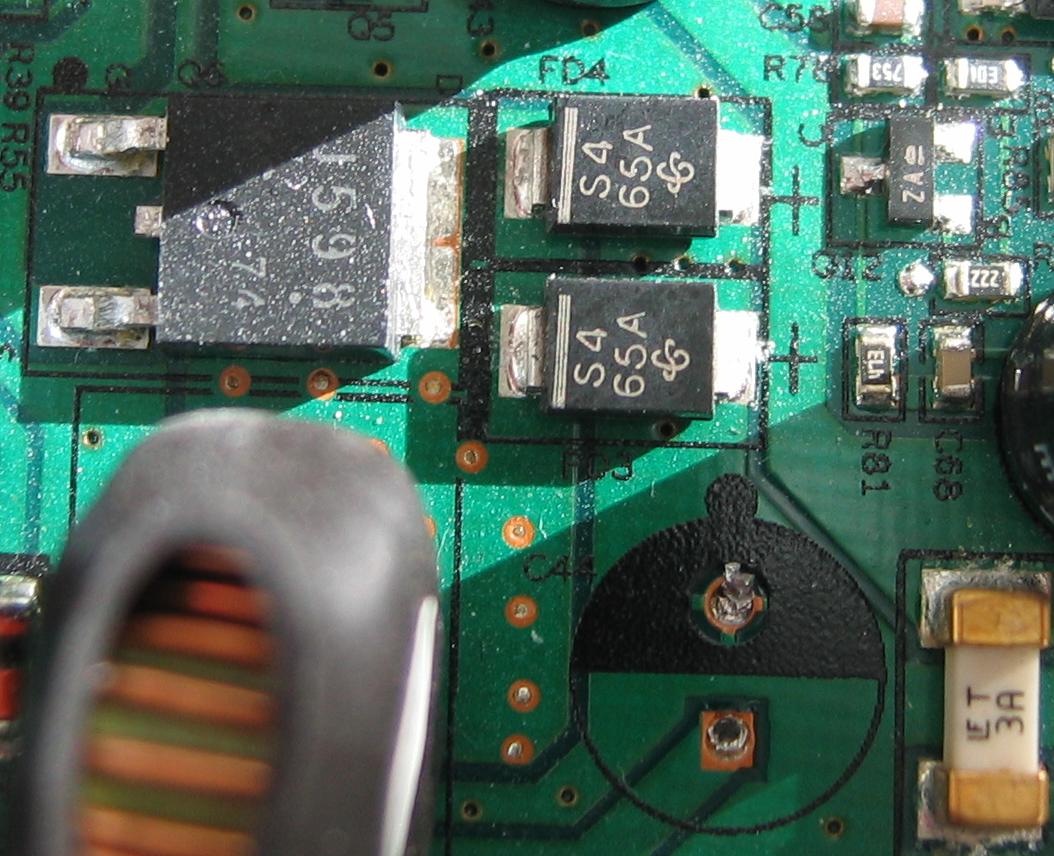

    Okay, I picked this monitor sometime last year and I lacked the equipment to work on it until now. I already identified all the shorted components (several), but can't figure out the markings for FD4 (diode).
    It says S4 65A and a company symbol. It is 3mm x 6mm.
    Ignore the soldering on C4. I removed the cap and didn't clear out the holes yet.

    I believe it to be a S4 schottky diode - hahaha tell you something you didnt know!!!
    Anyway I think the symbol is General Semiconductors Inc /Ltd/Co or whatever and it is now taken over by Vishay.

      Firstly thanks for posting very clear photos and providing a good description it really helps us understand how to help you :-)
      Is the attachment of any help?

        Thanks, 1N4004 is S4. Now off to the junk pile to look for a replacement.

                  Took a look at our old friend eBay and S4 looks to be 1A 40V schottky diode. The 1N4000 series are standard diodes and may not be fast enough.

                        On my boards the part number is S4 78A, while on Budm's teardown post they were S4 66A.
                        On an eBay search for "S4 Diode" there are two part numbers that come up:
                        SD103AWS and 1N5819 both are 1A 40v Schottky.
                        Does anyone know if i can use either part or is one preferential to the other?

                          They are in different package/case type:
                          SD103AWS = SOD-323
                          1N5819 = DO-41
                          The ones that you need is probably SD103AWS = SOD-323 ... Please verify the datasheet.

                              1A 40V SCHOTTKY, they use 2 of them in parallel to increase the current handling, but when you put two Diode in parallel without using small value resistor in series with each Diode for balancing the load current (when you put two diode in parallel, the one with lower Vf will conduct, the one with higher will not be bias on, so one diode will actually takes all the load. I would get the 2A if you can, this is common failure in this monitor. They have to match the Vf if they want to use to diode in parallel. The Diode is made by VISHAY.

                                Hi I think this one might be suitable DB2141300L I think RS online new zealand have them but you have to buy 10

                                  You can also get a vishey one in 2A if you go tohere:
                                  http://www.vishay.com/diodes/list/product-85682/ then
                                  click on download selector guide it has them all.

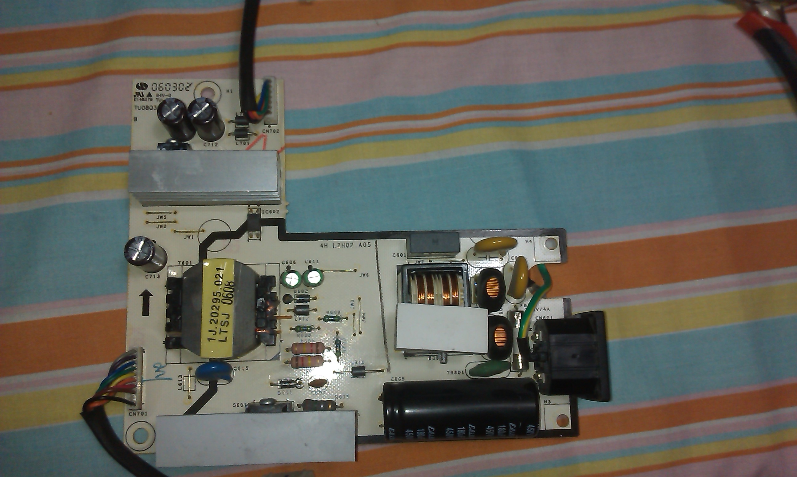

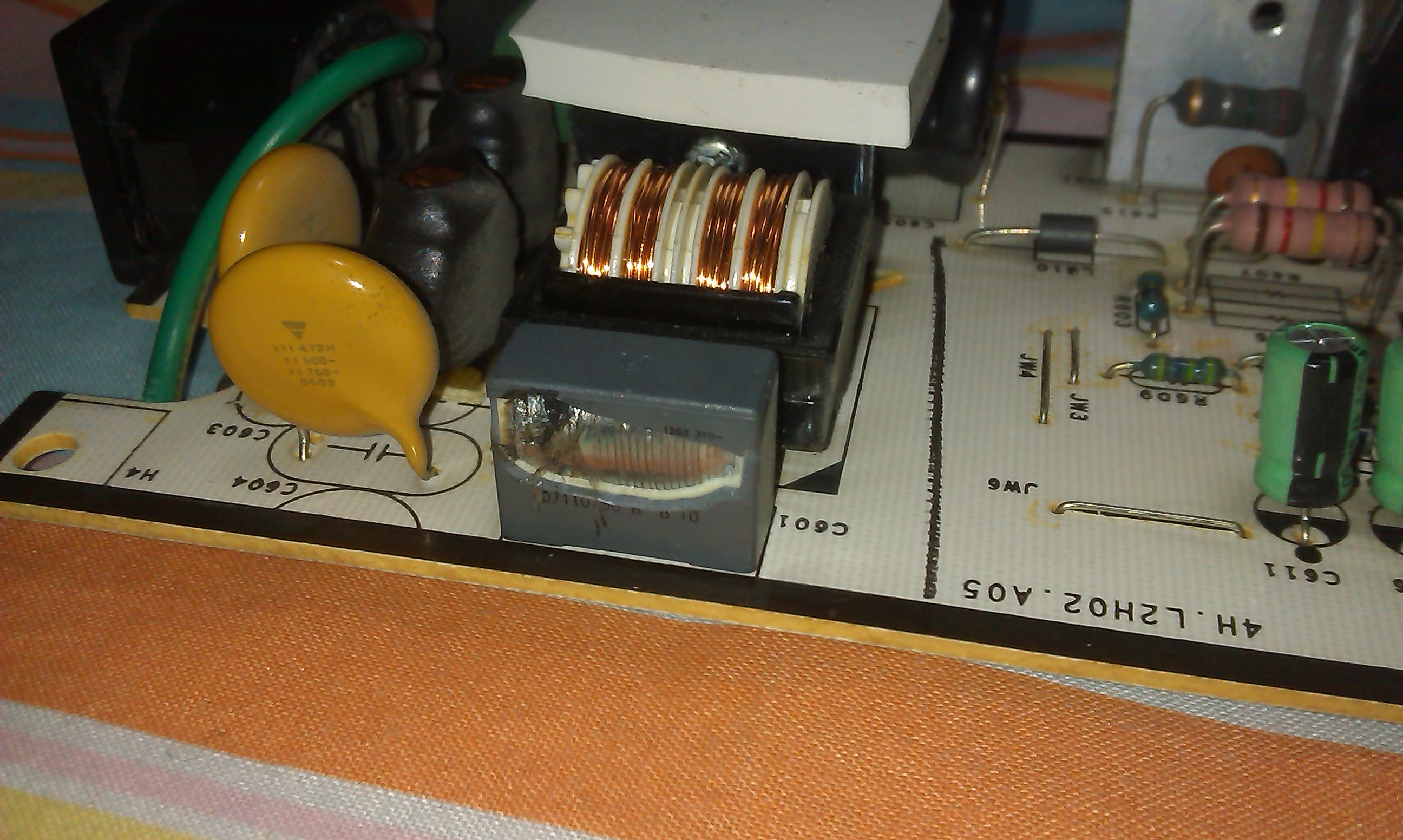

                                    I am trying to repair the power board of my monitor (it is also a 2007fpb) and it seems a capacitor is destroyed.
                                    I want to replace it but the values are destroyed aswell. Can anyone tell me the value of capacitor C601? It is the only rectangular capacitor in the board. Or if someone has the scheme of this board it would also help.
                                    Best regards

                                      https://www.badcaps.net/forum/showth...ht=dell+2007fp
                                      Where is this cap at? sub power supply board, main power supply, etc?
                                      Pictures?

                                        Re: Dell 2007FPb - help identify replacement diode
                                        Thanks for the fast answer
                                        I think this is the PSU.
                                        I attached the photos.
