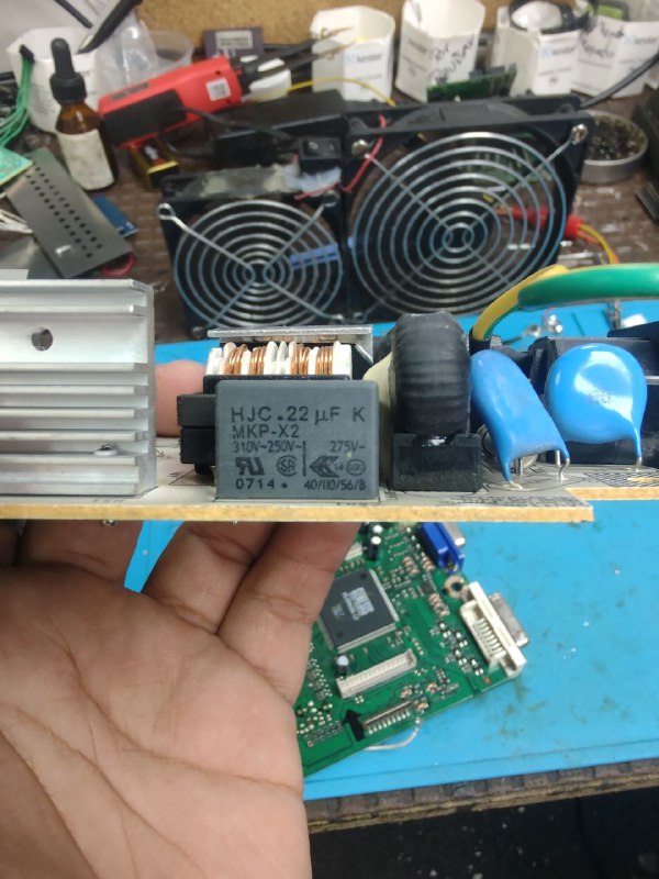

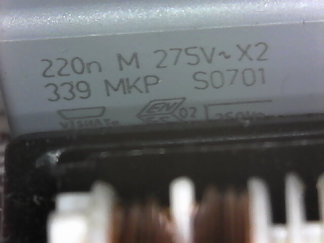

        I know this is an old thread, but I'm repairing one of these monitors now. Here's a photo of that capacitor C601 on the main power board for future reference. It's a 220nF 275V one
