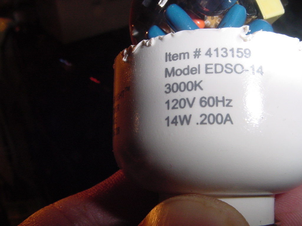

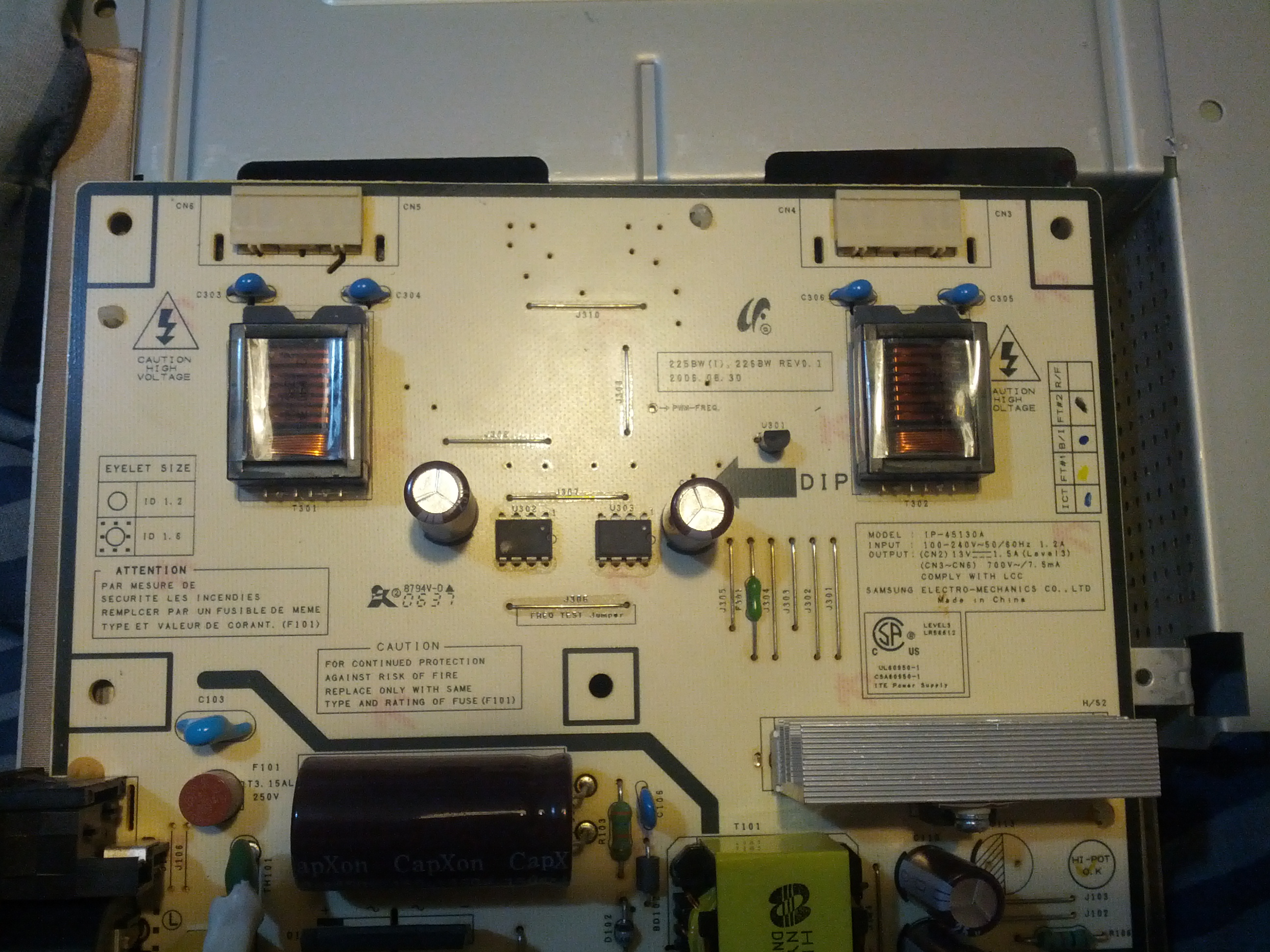

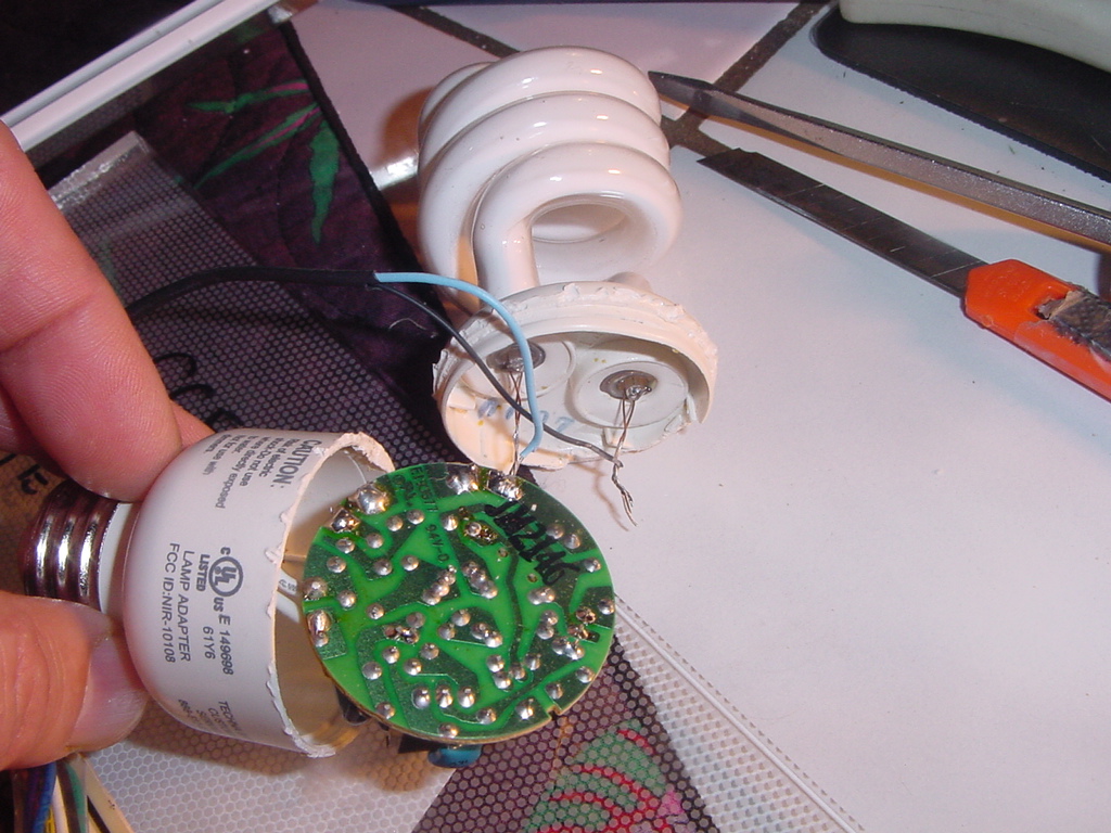

    Do not throw away those broken CFL (14Watts or smaller), you can use them for testing your LCD monitor inverter circuits without buying spare lamps for testing.

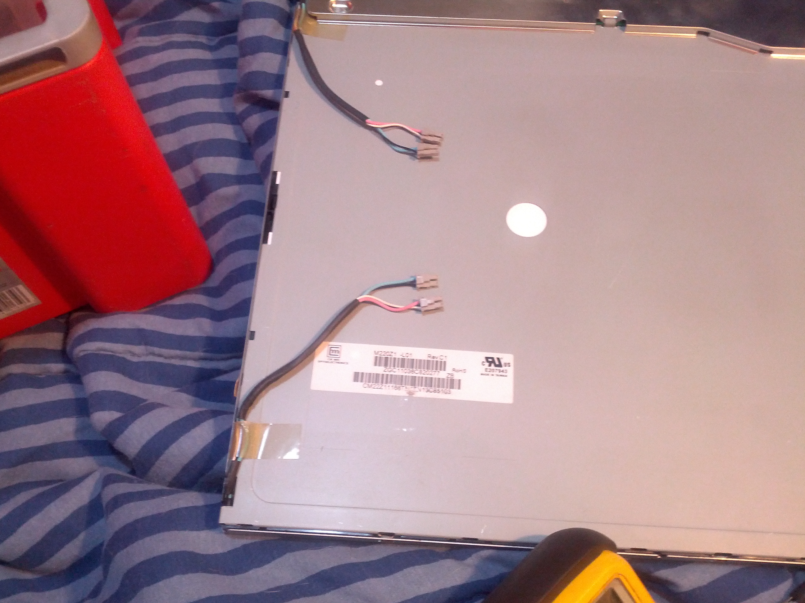

    You can solder the wires directly to the connectors on the inverter board or you can get the correct connectors but then you have to have more than one type.

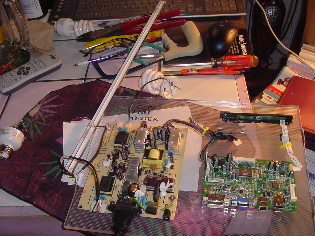

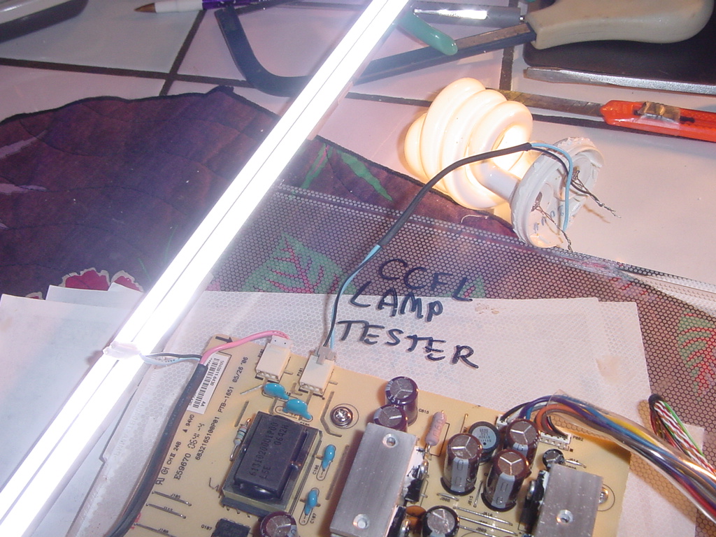

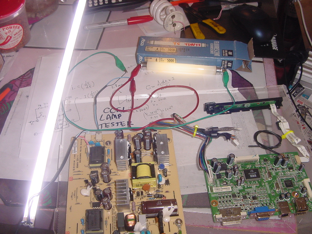

    I tested it out on my lamp tester board as you can see in the pictures.
    I open up the lamp assembly using small hack saw just enough for me to crack it open, just be real careful.
    Enjoy!

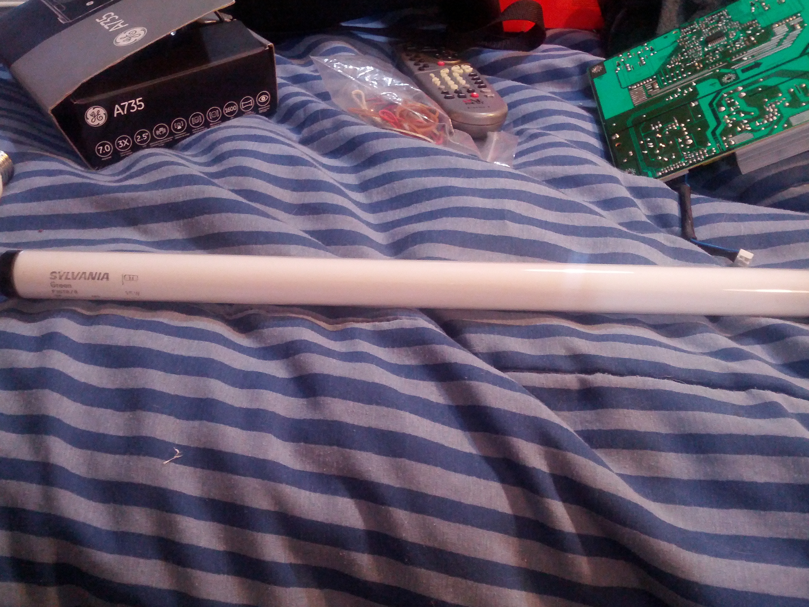

                Update with T5 4Watts lamp

                    OK. I have 13w and 23w CFLs but no 14w.
                    Does the wattage matter if all I'm using is the top half?
                      Re: Inverter tester using old CFL
                      That will be too big (the 23W), 14w or smaller as shown will work. I did not try with other 13/14W with big body (such as used for under counter lights) yet to see if it will light up. Your 13W CFL twisted bulb should work.

                              Would this bulb work?
                              I fix therefore I am.
                                Way too big even though it is the same wattage. I tried many shape and size and so far the curly one with 10~14W seems to work well.
                                  Wow, thanks for the quick reply. Looks like I will have to sacrifice a new bulb in the name of science. From the pictures I surmise that you don't need hook up to screen to test. Do you have to have a signal coming from the computer? Looks like that was not connected as well. Also, do all of the leads have to be hooked up to bulbs (mine has 4 leads for 4 bulbs?)?
                                    I force the bl_on line on mt tester board, you will have to have your monitor connected to the running PC but you do not need to have the screen T-CON connected.
                                    You have to have 4 working lamps, if one failed or not connected, the inverter will go onto shutdown mode.

                                      I was afraid of that. So I might need to make as many as 4 test bulbs? Or I could try hooking 3 up to LCD with 1 test bulb and hope only 1 CCFL is bad in my monitor and keep trying until lamps stay lit.
