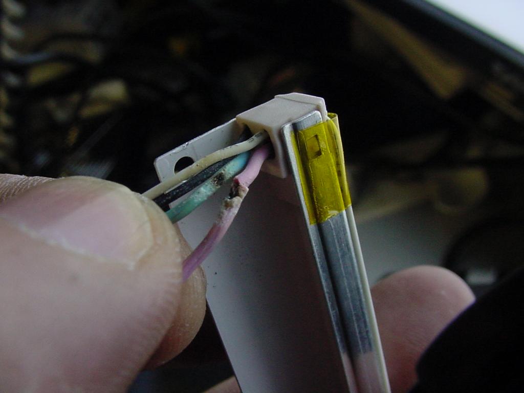

          Bad lamps and bad wiring.
            #85
            Re: Inverter tester using old CFL
            Bad lamps and bad wiring ii.
              ^^ OH MY.... ^^
              How many thousands of LCD monitors have you fixed to collect all that?
              Gee. To think I already had second thoughts of doing a lamp replacement after I did my first, because I thought it was so "involved".
              My deepest respects and hat off to you sir! You have quite the patience and skill.
