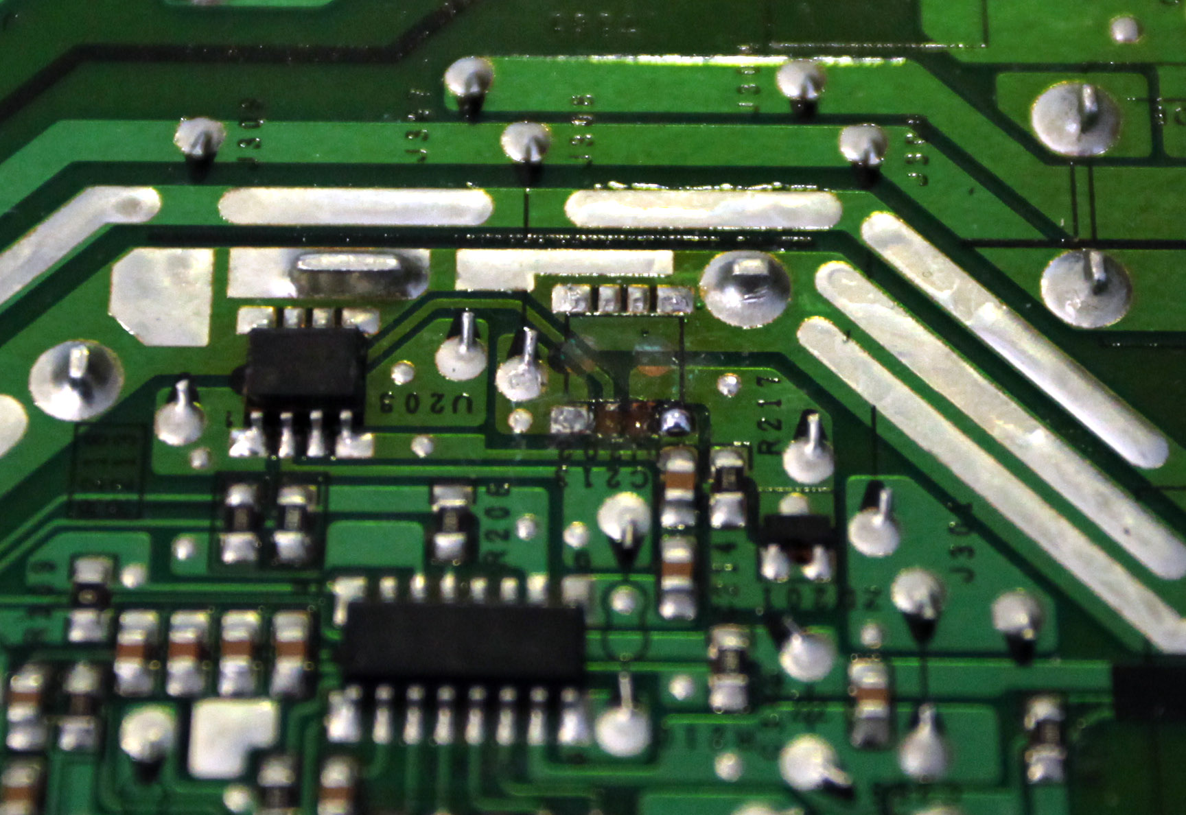

                      Two of the 8 legs came off along with all the solder on the board. I guess that can't be that easily fixed...

                        Can you show us a picture of what's happened?

                          #32
                          Re: Samsung 940b - classic nod backlight problem
                          sure can
                          here's a photo. i believe you'll destinguish my messup
                            Originally posted by bocca
                            sure can
                            Its not that bad of a mess! these things happen.
                            I'm pretty sure you can get away with patching the Pins with the missing pads to the next nearest connection.
                            The board looks clean what did you use?

                              good, so there is still some hope
                              You will have to guide me on that nearest connection business, as I'm not sure I quite got it.
                              Clean in what sense? General cleanliness or soldering stuff? Thnx, by the way
                                Basically you have to figure out where those pads connect to in the circuit. If you look at the datasheet the two solder pads you lifted are either pins 6 and 7 or pins 2 and 3. I can't tell from the photo and regulars will notice that in one thread yesterday, I can't tell north from south in a diagram.
                                If there is any solder pad left, then you may be able to use the continuity beep on your multimeter to find out where the pads connect to. Then you can use some wire to bridge the connection.
                                Something like this ...
                                http://www.circuitrework.com/guides/6-1.shtml
                                    Wow, thanks retiredcaps
                                    I will do what you both proposed, and try to look for a place to bridge the connection

                                      you can desolder this little mosfets (8pin smd) with a little pliers.
                                      take the ic whit the pliers and add solder to four legs on both sides,then pull up
                                      you must add heat on both sides quickly 2 or 3 times.
                                      just repaired one samsung syncmaster 153v , whit 2 of 4 AO4600 mosfet shorted,due to dry capacitors.
                                      My soldering iron is a "JBC" 25W, whit soldering tip slightly curved.
