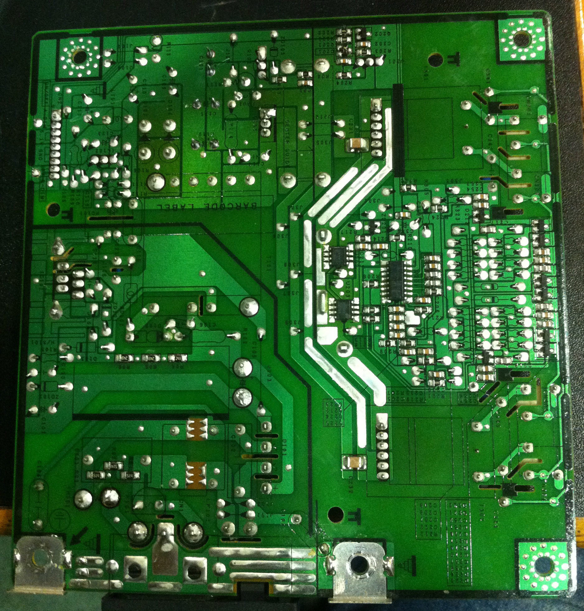

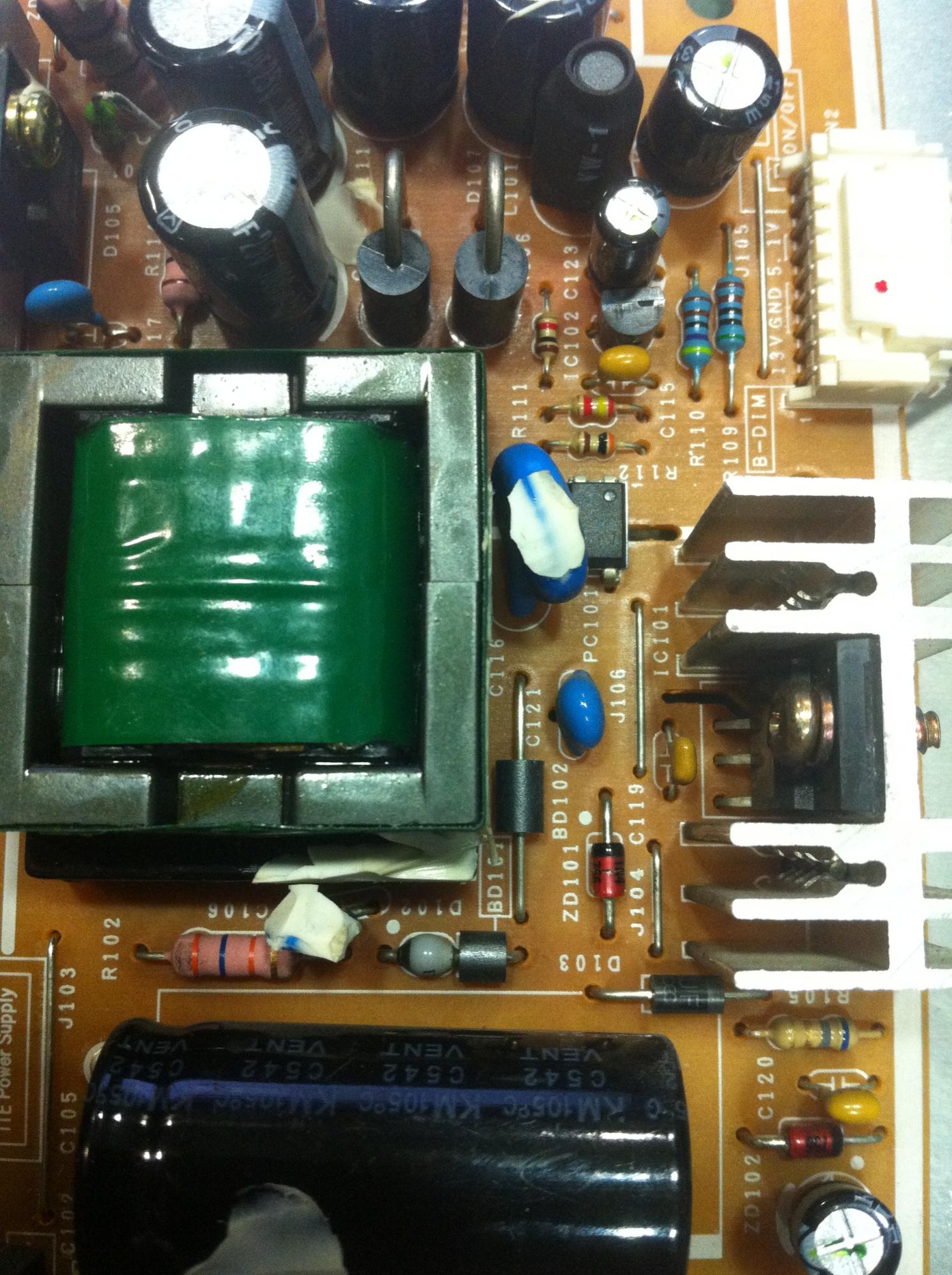

    Hi peole My first post here, although I've been following unregistered for months now
    So, i have two Samsungs 940b with identical problem from the topic title. opened one up and found of course 3 bulged capacitors. Those are the infamous 820uf 25v. I replaced them with 2x1000uf + 1x470uf. Plugged everything back, but tough luck.
    So consulting posts from another topic about 740n ( https://www.badcaps.net/forum/showth...?t=5136&page=6 )
    i looked for the F301 red fuse. Seems like it's ok.
    So now i'm lost basicly
    My motherboard model is: IP-35135B
    Capacitors were capxcon, replaced them with Jamicon.
    Oh and one last thing, before anyone answers. I'm from Serbia, and we don't have a lot of options on buying here. Ebay or any other online store is not an option.
    Current here is 230v, 50/60hz
    So I'm posting pics now
    http://imgur.com/a/sRb0f
    if you need anything else just tell me. it would mean a bunch if i fixed these two bad boys

            Jasgriff, did you want some angle photographed different? I did not quite understand that last thingy in your post

              A good picture of the bottom of the board. Similar to your first picture.

                EDIT: Here's the bottom of the board and a detail on the soldered capacitors and resoldered 301 fuse

                      See those 3 chips on pic 4. Can you read the labels on them?

                        Re: Samsung 940b - classic nod backlight problem
                        Yup. two smaller ones are "4502c AA5VD"
                        and the bigger one is very hard to read but i'll give it a shot
                        B1131 G
                        FF984 7528
                        might not be right thou
                        oh and other monitor is the same resolution as this one, 1280x1024, so it should show the picture
