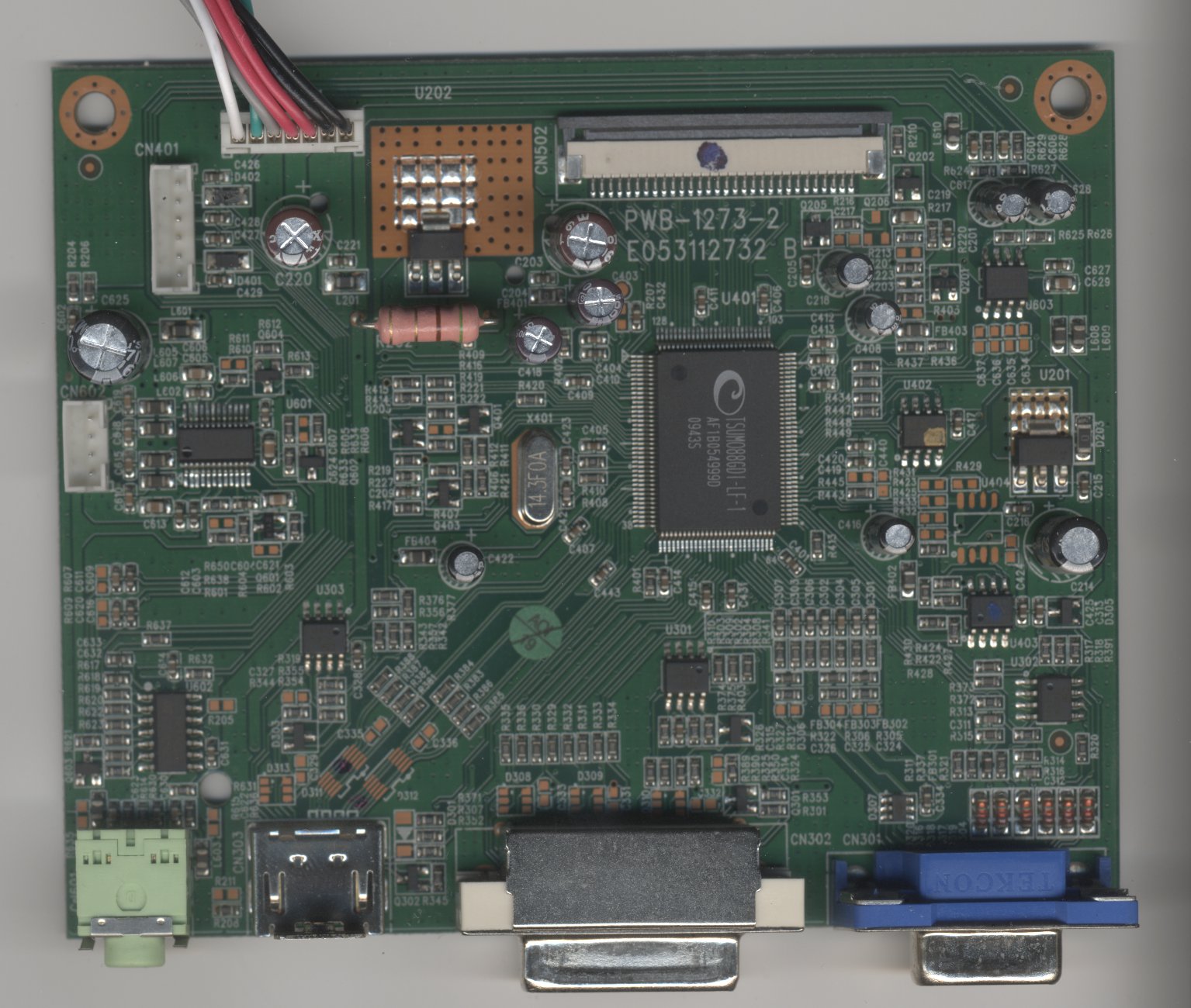

HP 2159m Dead, no power

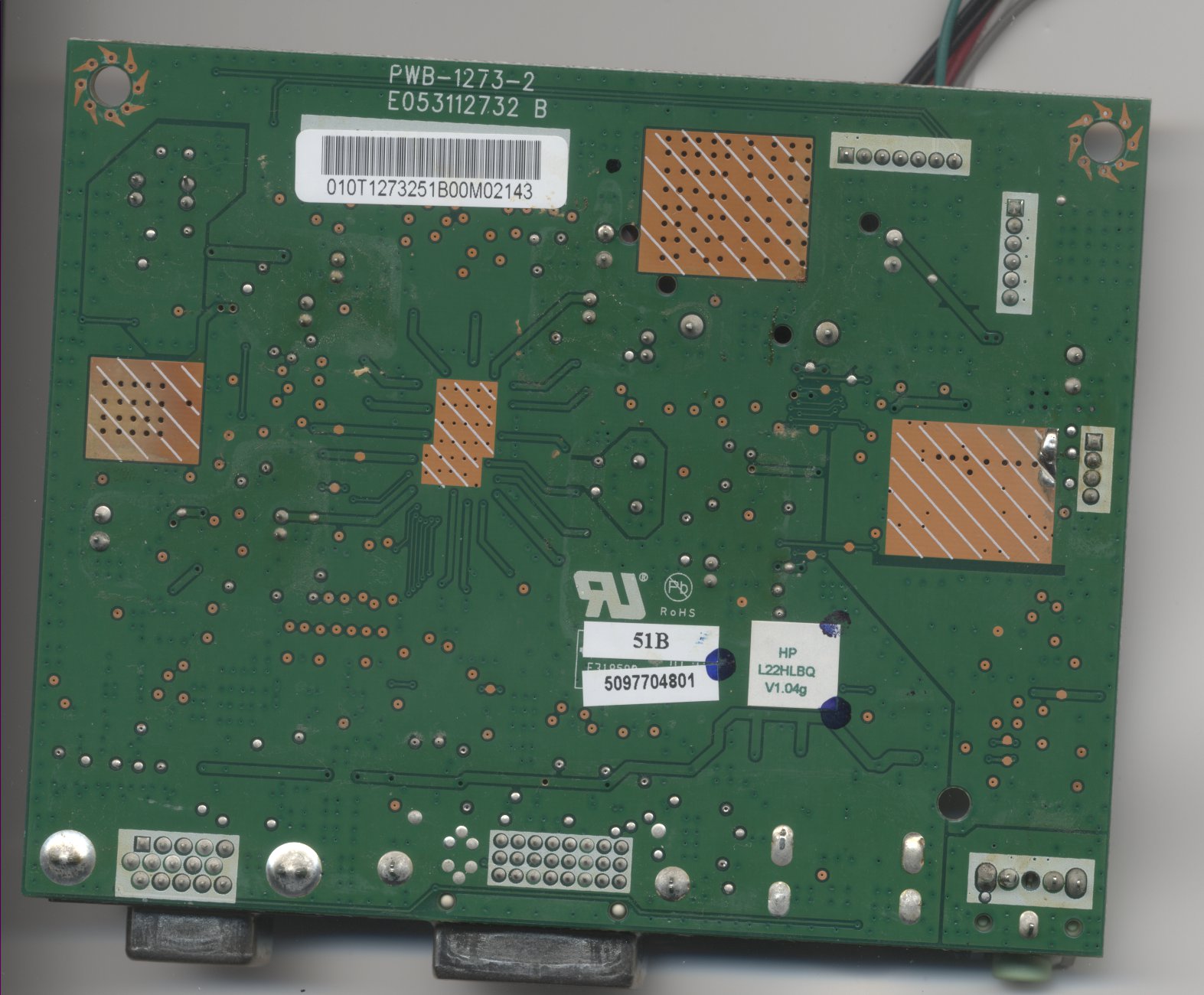

    Do you have good pictures of the main board? It can be as simple as bad voltage regulator.

      Re: HP 2159m Dead, no power
      Here they are. Is the voltage regulator on the main board? I thought all that stuff was on the power supply.
          The Voltage regulators are probably the components with "U" numbers.
          There are 2 3 legged ones and maybe some others. The 8 legged ones maybe regulators but not always.
          You/we need to know what is written on them.
              Wow, that is a useful and serious document.
              here's what I've got:
              U201
              MT1117
              3.31002M
              first lead - 0.0 V
              second lead - 1.523 V
              third lead - 5.269 V
              U202
              AX1117
              A-18
              943A
              first lead - 0.0 V
              second lead - 1.805 V
              third lead - 5.081 V
              The best I can tell, these are fixed VRs for 3.3 and 1.8 Volts. the first one appears to be bad? The model lettering is confusing, however, I am not sure I looked at the right data sheet, and I could not find direct correspondence on the data sheet anyway.
                  U201 IS 3.3 fixed regulator, you only getting 1.523V, so that is bad.
                  U202 is a fixed 1.8V regulator, it is OK.
                  Check or replace that C214 next to it.

                    I can't see any adjusting resistors so yes ,they are fixed and U201 appears to be bad. I say appears as sometimes it can be a knock on effect from
                    an attached faulty capacitor.

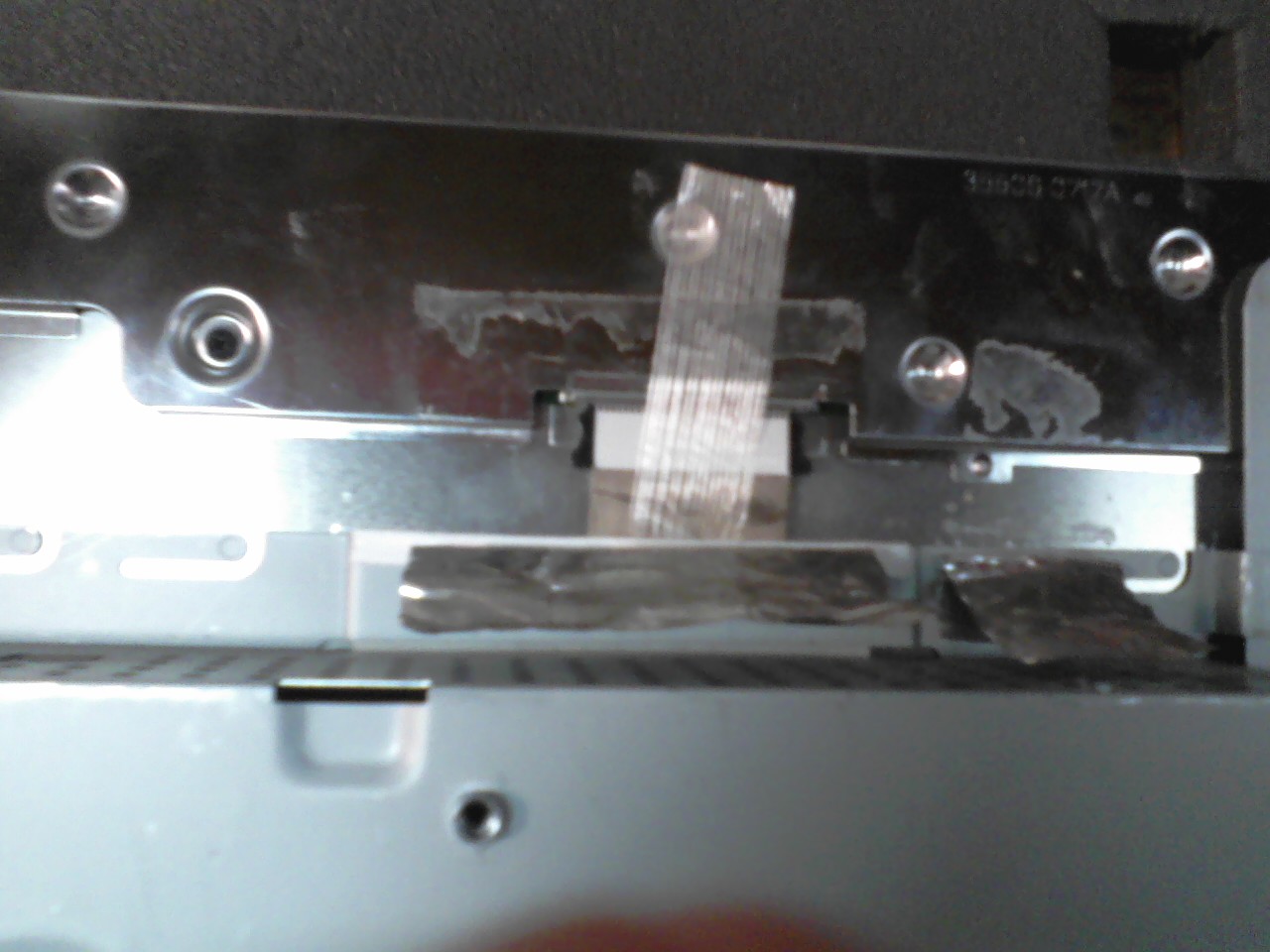

                                #35
                                Issue seems to be resolved, mostly:
                                1. I made sure all screws were in place so grounding was properly done.
                                2. The ribbon cable connector on the LCD side was bent, I bent it back. It was really a bad connector. Some HP exec saved some $$$. I am attaching a picture of the connector so others may watch out for it. It is a simple slide-in thing, there is no wedge or lock of any kind, thus it is held on with a piece of tape. The tape in the pic is OEM, not mine.
                                Thank you all for your help.
