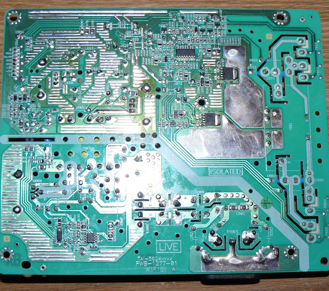

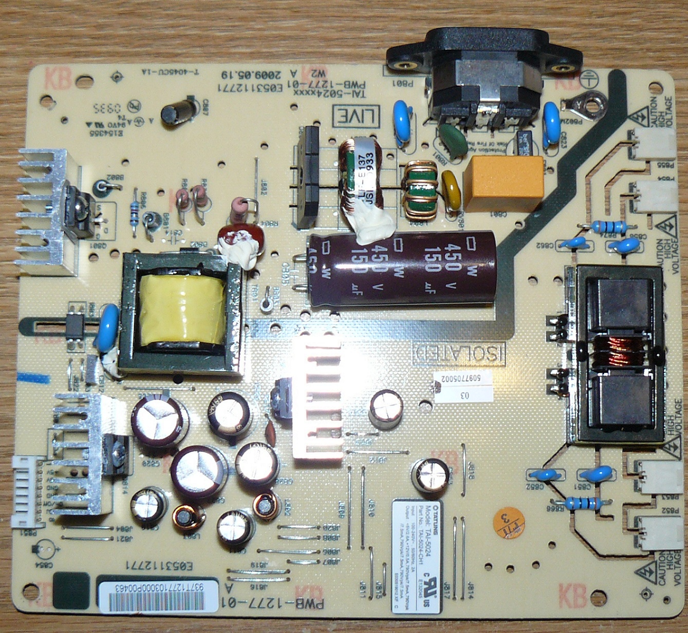

    I have a Hp 2159M that is completely dead. I pulled it apart and the 4A fuse is blown. I don't see any scorch/burn marks at all. The power supply has some lelon caps and some united chemcon caps.
    The lelon caps are RZW series
    The united chemcon caps are KY series except for the big cap which is W series.
    I know the lelon caps don't have the best reputation but should i replace the fuse and see what happens or change out the lelon caps along with the fuse?
    Its tempting to just put in a new fuse but i am unsure if a dried up cap could cause a fuse to blow. I don't have any background on this monitor like if it endured a lightning storm.

    The likely causes for a fuse to become open are:
    1) bridge rectifier (long black rectangular component - just above the big cap as per your picture) is shorted
    2) power mosfet (Q801) is shorted
    If both those components are okay, then replace the fuse and apply power.

      The mosfet (Q801) is shorted
      S1-G1 "0L"
      S1-D1 "0L"
      G1-D1 ".687 Mohm"

        What range did you set the DMM to? Those readings indicate Q801 is not shorted. 'OL' would indicate it was out of range, while .687 Mohm implies 687Kohm, certainly reasonable given the drive circuitry.
        Testing by inserting a new fuse and seeing if it blows is not a good method of troubleshooting. I use a Variac (variable transformer) and monitor the current as I increase the voltage slowly. An alternate method is to wire a 60 to 100 watt incandescent light bulb in place of the fuse. If the bulb glows at full brightness, there is a problem. If it lights up only briefly and the power supply is putting out normal voltages, it's safe to put in a new fuse.

          I know you probably made a typo and meant "not shorted". What about the bridge rectifier?
            oops
            3:45 a.m. i guess the coffee hadn't kicked in yet.
            The bridge is testing good also

              Where would the best place to check the voltage if the bulb only lights up briefly? P851 connecter, the power mosfet, large cap?
              I'd do this with the signal card disconnected. Test the voltage across the large cap (should be 1.4 x line voltage - 165 volts in North America), and at the output connector to the signal card. If those test out, put in the fuse, retest, then it's time to hook everything together and see if the monitor works.

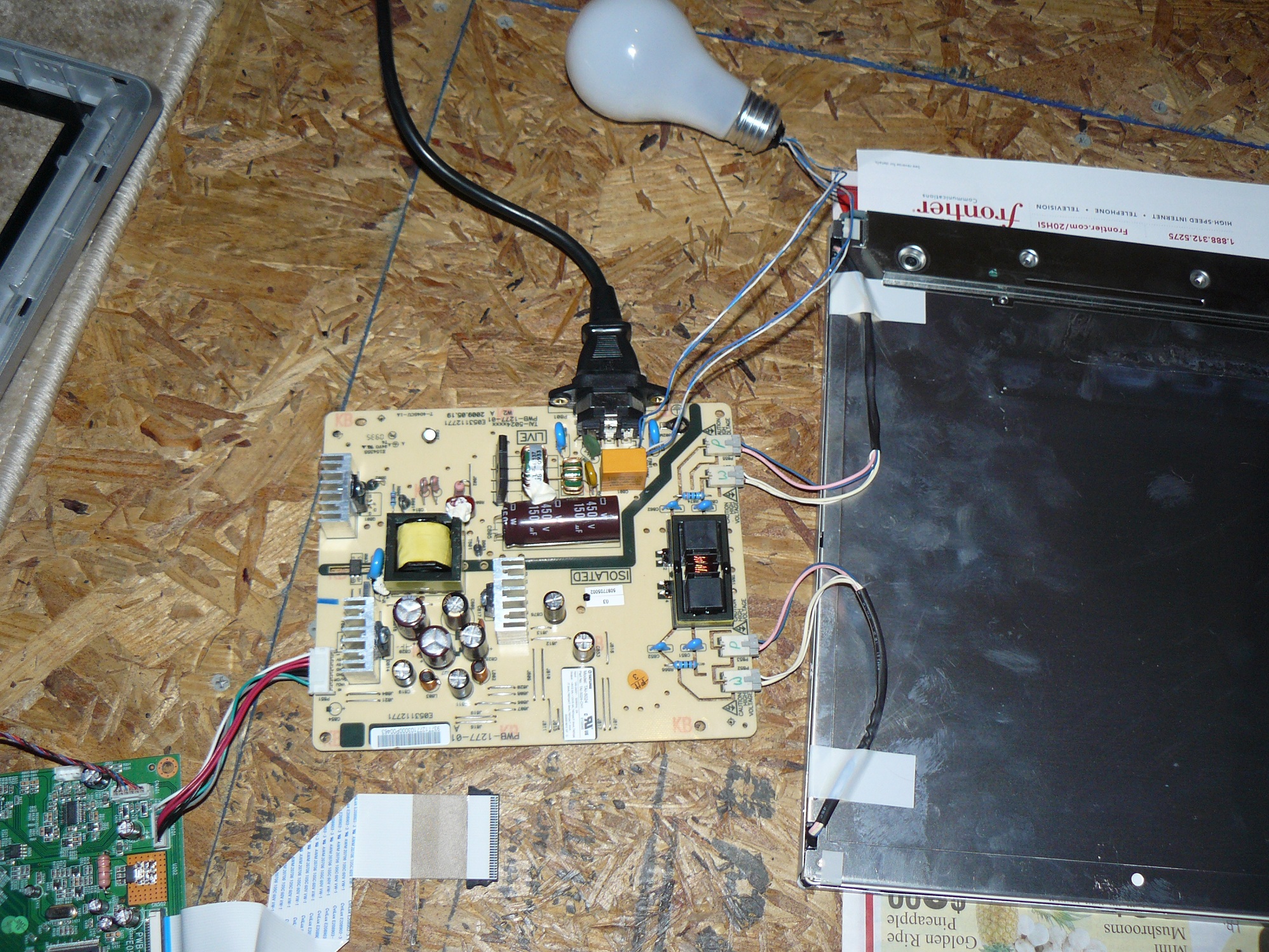

                    I used a 60 watt light bulb. Hooked it all up and the bulb doesn't light up at all. I'm only getting 58.2 volts dc at the large cap. Checked the connector and i'm getting in the range of .385-.511 volts dc. I had to run the signal card becuase the on/off switch runs through it. Does the light bulb need to be grounded?
                    I took a picture incase i'm doing this wrong.

                      I grounded the bulb at it lights up full brightness doesn't go off in the 10 seconds that i hold the wire to a ground point.
                      The monitor doesn't go into standby (amber light) for atleast 30 seconds which seems a bit long since i don't have a video source connected. With the bulb grounded and it lighting up at full brightness i'm still only getting about 59 volts d/c.
                      Is there anything to check or do you have any thoughts on the bulb lighting up?

                        You are doing it wrong.
                        First, a little discussion. This is a standard power supply for a monitor. The supply is on whenever the AC cord is plugged in. There is no need to connect the signal (logic) card, all we're trying to do is see if the power supply comes up without any load. And no, it is not necessary to ground the lamp.
                        In the setup I described (no signal card connected) I would expect the large cap to show close to 21.4 x line voltage - 120 to 150 volts, and I would expect to see voltage on the output connector. The whole purpose of this test was to see if there was anything drawing excessive current on the primary side of the main transformer.
                        The results you got indicate it is time to remove the lamp and insert a fuse.

                          I think i figured out why i was getting the 59 volts dc at the large cap. I was putting the red probe on the positive on the large cap and the black probe on the ground on the main power connecter.
                          Doing it the way you explained in the last post i'm getting 163.7 volts dc by using the negative lead on the large cap.
                          So the next step is to replace the fuse and recheck voltages then put it all together and try it out?
                          Thanks for the input and sorry for being a "big dummy"

                            AH!!! A common mistake. That hot ground will mislead you every time. Yes, put in the fuse, double check voltages, (but I don't think there will be any problems), and proceed from there.
