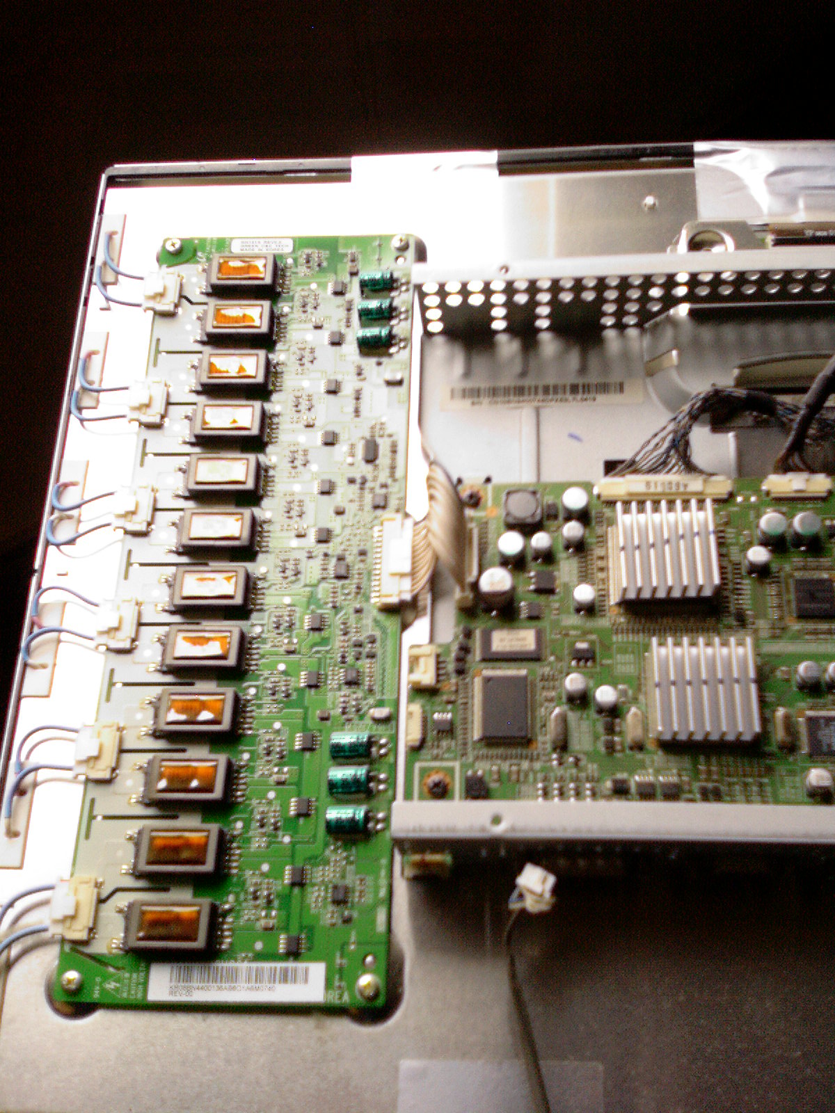

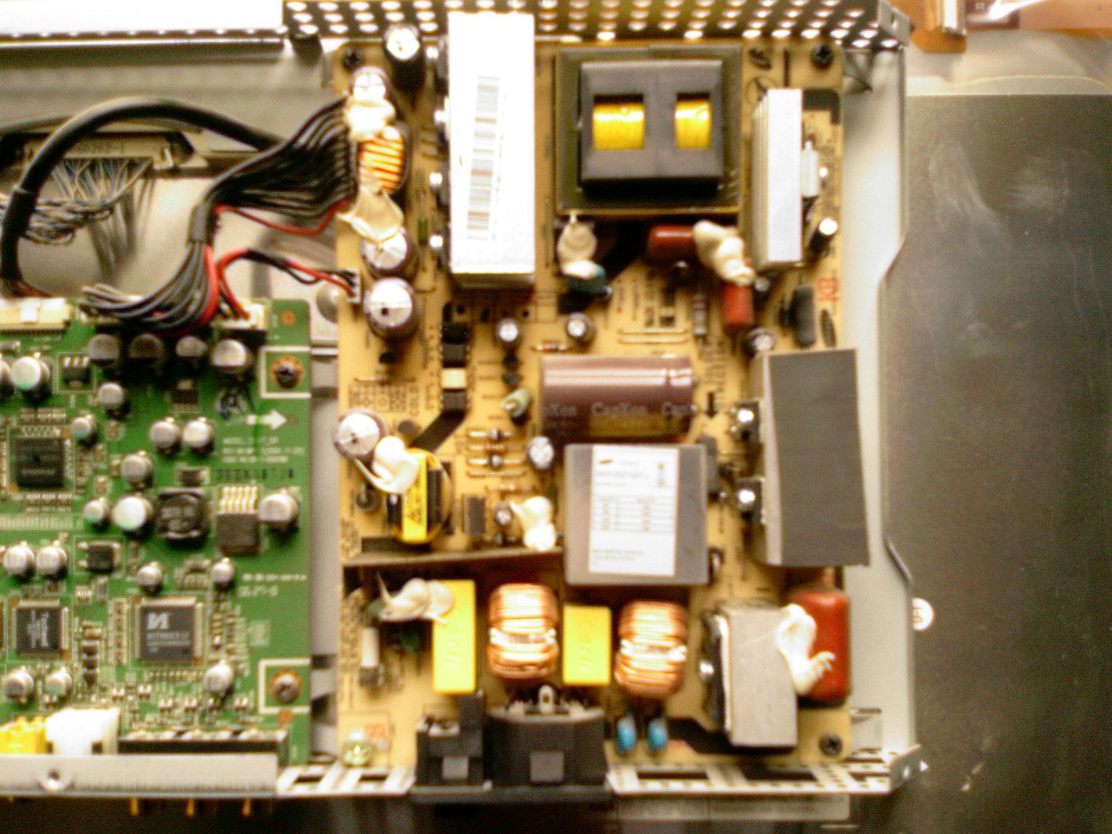

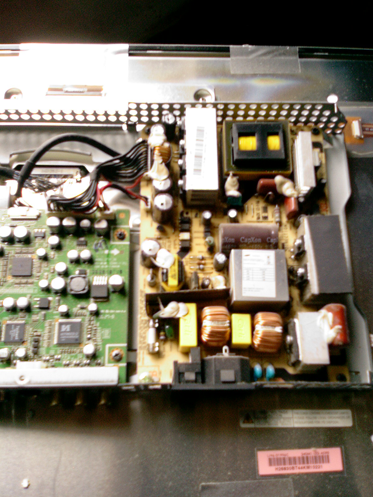

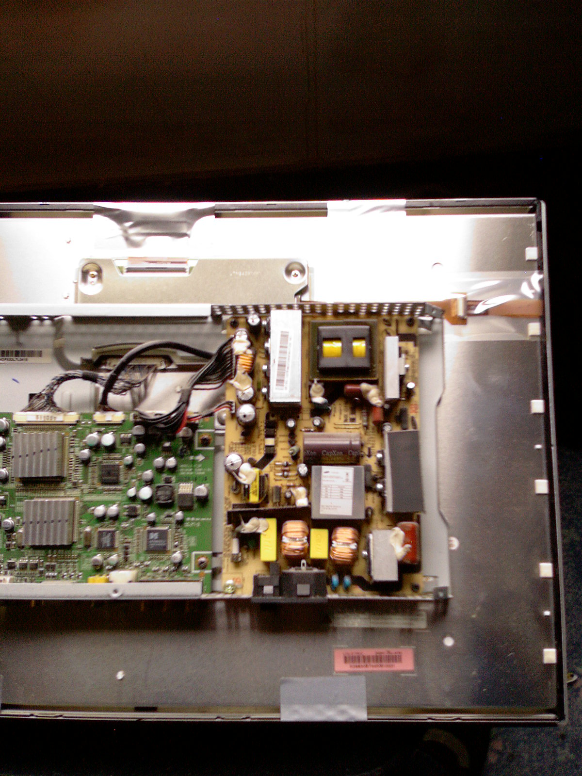

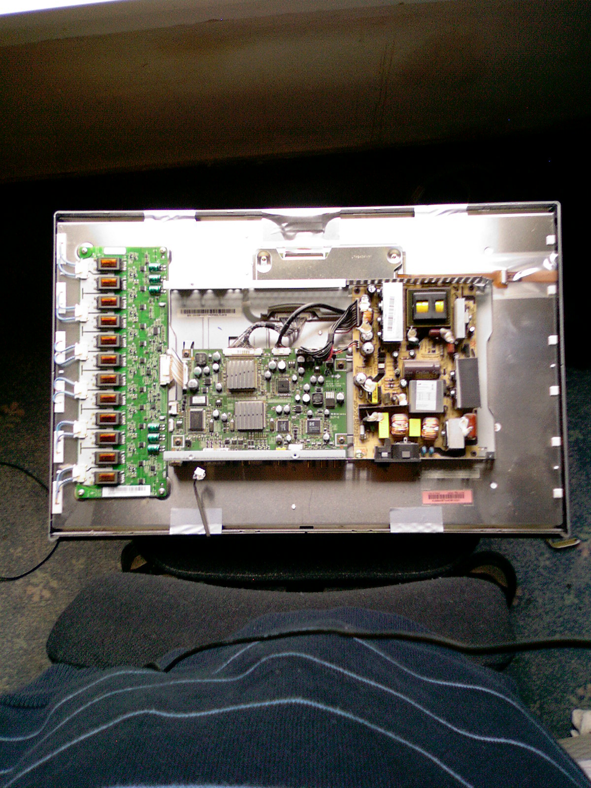

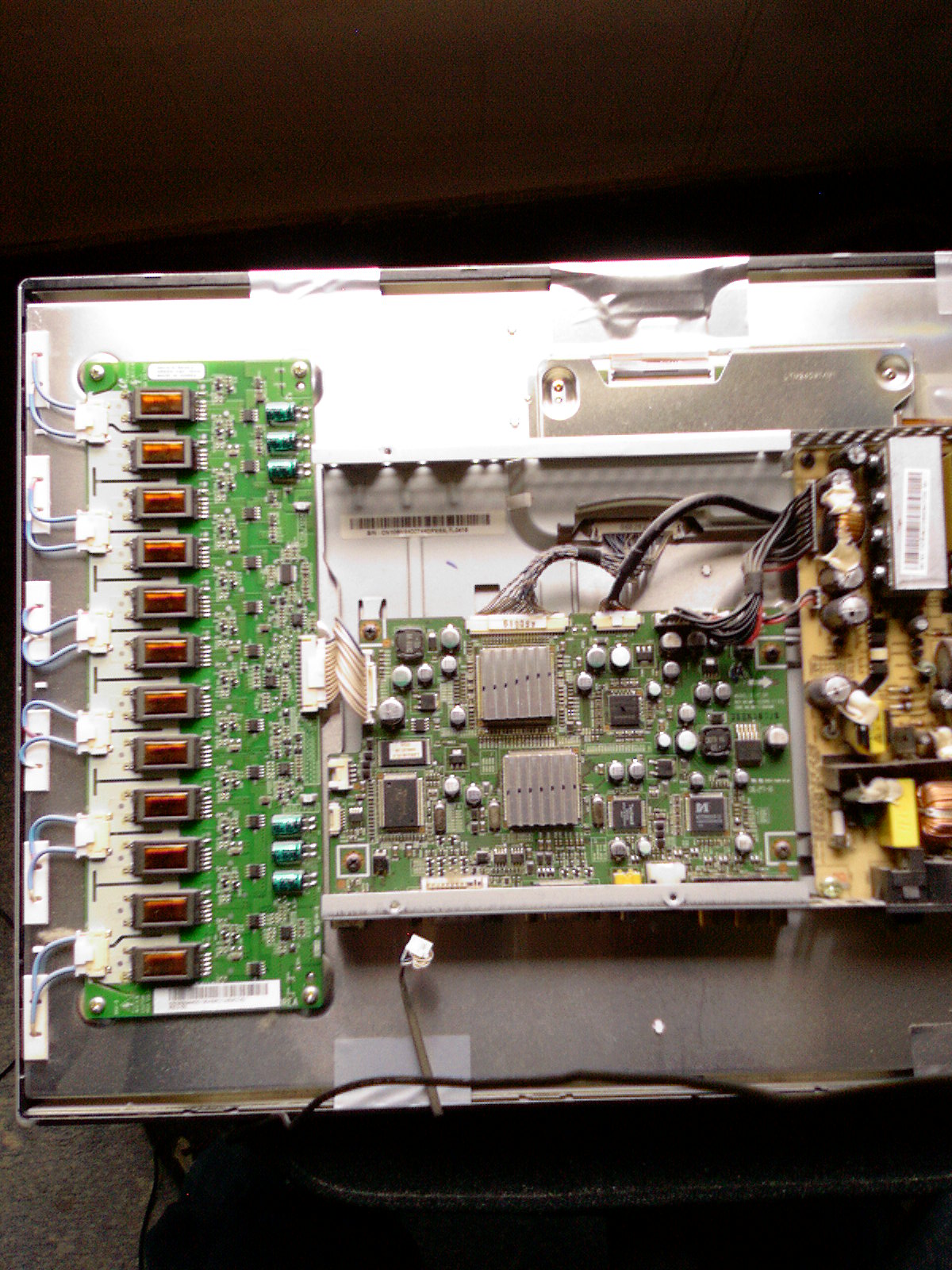

      • tuk
        • Nov 2011
        • 33
        Re: Samsung 244T ...stuck in standby

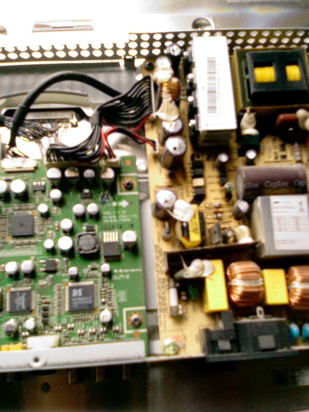

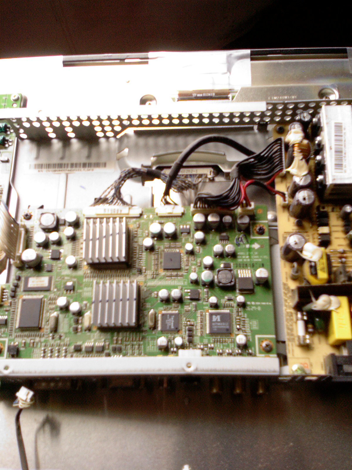

        ok, sorry about the pic quality..best I could do
        a few changes in symptoms: the standby trick doesn't work any longer and only worked 2-3 times so maybe irrelevant ...after putting the 244t back together the power light took 5 mins to come on..havent seen this before; usually I leave in standby overnight..so it didn't like the cold start even though the monitor was working for a few hours before I took it apart ...also using a hairdryer on the top back vent is the only way to bring it out of standby now...
        the 3 caps(1000uf 35v capxon) you can see in pics 14,15,16 ..are a bit swollen the large cap to the right of those looks flat
        • trebo
          • 514
          • Wales, UK
          its not easy to tell from your pics but it looks like you have 3 caps that have rounded tops on them on the power supply board, they are just off the top right hand corner of the signal board, if I am right you will need to recap board
            yes they are rounded ..but would using a hair dryer make them work?
            • trebo
              • 514
              • Wales, UK
              no, have you been browsing Fixya LOL
              the psu needs to be recapped
              it needs low esr quality capacitors
              post a better picture of the power supply board
              the reason why it got hot was bad caps, this can lead to bigger problems
              • jayoung

                With an aging and/or near end of life capacitor, heat (either from the monitor being plugged in and turned on or an external source like a hair dryer) will lower the esr of the capacitor. This could allow the capacitor to function thus allowing the monitor to function until the heat is gone and the system goes "cold." The monitor would only function normally at this point if the capacitors are the only issue with it. This theoretically could work, but it is by no means a permanent solution. Once "cold," the monitor would be back to exhibiting the same symptoms as it is now.
                With this said, most members on this forum would recommend replacing ALL of the capacitors on the power board. If you replace just the visibly bulged ones now, you may find yourself opening the monitor back up at a later date to replace more that have failed.

                  no decent camera only a phone cam that doesn't allow closeups ..the pics I'v posted are the best I can get ..but those 3 caps you mention do have raised tops ..Im just wondering about the heat thing ..as ordering components is expensive here and would like to get it right first time if possible

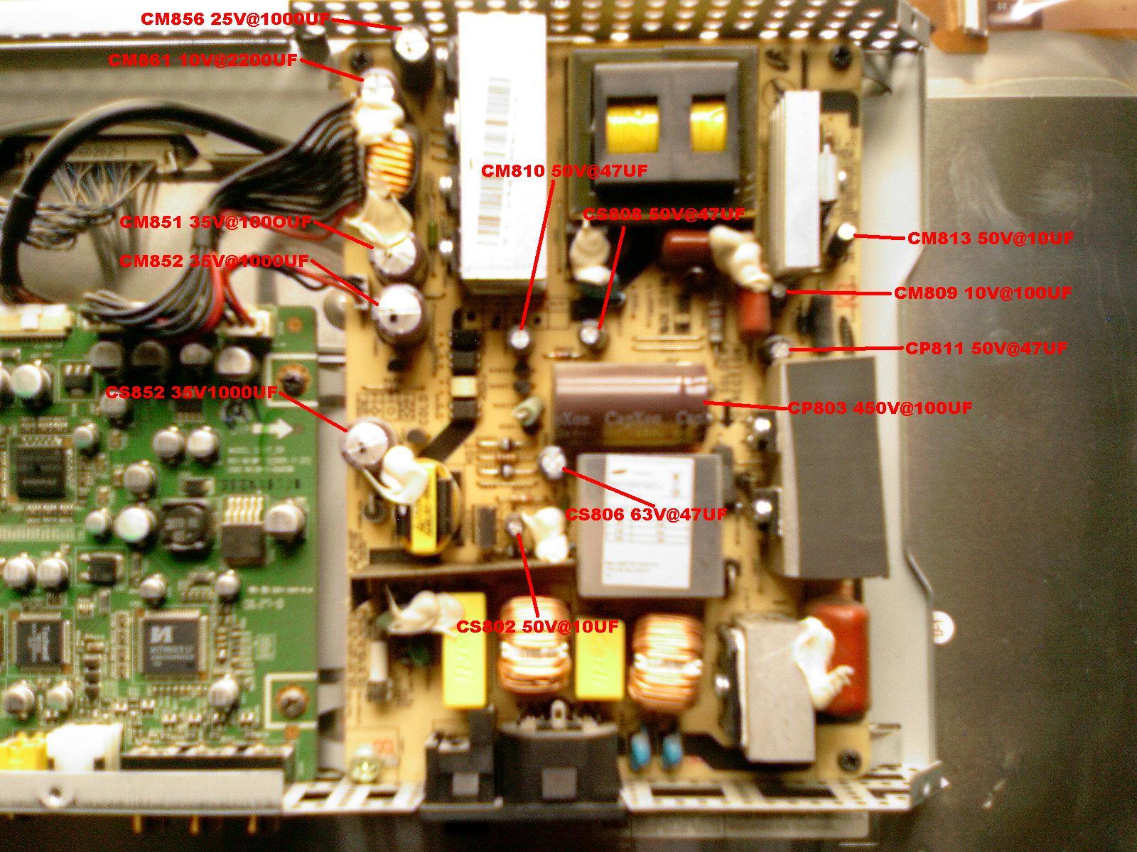

                                      yep, Farnell have a £24 min order but free delivery ...RS don't seem to like dealing with the public ...their site requires a trade account to make an order..they have a shop in town but it's a trade counter so not sure if I can buy from them easily ..I could probably add a few more things to my Farnell order to make it up to £24 ...Rapid are ok but they want £7 delivery...I could spend that £7 at Farnell instead ..I will price out the suppliers when I know exactly the parts I need...
                                      ...and on that note I'v just noticed crazyjonny has different cap values from me
                                      https://www.badcaps.net/forum/showpo...89&postcount=8 ...thread here ....I think one of us has got 2 values swapped by mistake
                                      CM856 25v@1000uF
                                      CM861 10v@2200uF
                                      CM851 35v@1000uF
                                      CM852 35v@1000uF
                                      CS852 35v@1000uF
                                      CS806 63v@47uF
                                      CP803 450v@100uF
                                      CS808 50V@47uF
                                      CM810 50v@47uF
                                      CP811 50v@47uF
                                      CM809 10v@100uF
                                      CM813 50v@10uF
                                      CS802 50v@10uF

                                        You may have different revisions of the board.
