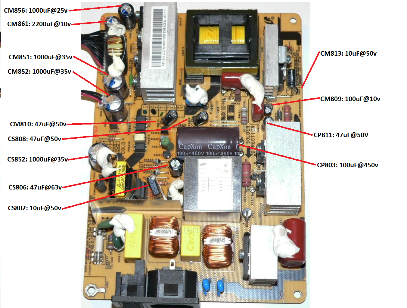

    could be ..its just a bit funny that if I swapped jonnies values around then his list would be the same as mine
    me:
    CM809 10v@100uF
    CS802 50v@10uF
    jonnie:
    CM809 50v@10uF
    CS802 10v@100uF
      Re: Samsung 244T ...stuck in standby
      wait tho ...that means our part lists are the same ..the only question is which way round the 2 caps go ...I could go ahead and order ...and then just check the caps when I remove them to put in the new ones
      can someone confirm the above isn't nonsense ..I'v been staring at this all day and a little tired ..but want to get on and get them ordered
        Check actual voltage.
        If either are over 10v that's where the 50v goes.
        Also post pic showing locations so people can look for pics elsewhere that might give a clue.
        I think there's quite a few pics of that board right here in this forum.

          just to check..can you see my pics in post #19 of this thread? ..maybe I have to make them visible or something?
            No I can't see the values in that pic..... LOL
              did a forum search for "244t" but couldn't find any decent pictures of the power board ..found a couple on google images but they are not much better than the one I used ..if someone has a link or can upload a decent pic of the power board for a 244T...I will label it for future ref
              here is my shopping list so far ..based on this Capxon datasheet and ordering from Farnell ...if someone could cast an eye and also offer suggestions where I'v run aground ...would be much obliged
              1) #### for the 47uF@50v couldn't find a lower esr than the CApXon & for the 47uF 63v could not find a higher ripple & lower esr
              2) Could not find datasheets for the last 2 on the list so went with a guesstimate ...the 450v is vertical to the board and where the pins meet the board there are 2 silver square feet ..but I'm thinking these are just normal through hole and not snap in?
              3) For the first one I'v included the values for FR,FM,FC for comparison ..I decided to go with the FR where possible as the values seemed slightly better

                                thanks, will open it back up tomorrow ..meanwhile here is a better pic of the 244T power board
                                  #36
                                  the caps are CapXon VENT :KM and GL series....

                                    e2a: just seen this in another thread...
                                    Originally posted by PCBONEZ View Post
                                    The CapXon KM are not low ESR so ESR is not shown in the data sheet...
                                    ... go by the ripple ... and get low ESR caps anyway because they should have been used there anyway.
                                    As I said:
                                    Try to avoid extreme 'upgrades' with the ESR. [Which means excessively lowering ESR.]
                                    In -some- circuits too low of an ESR can cause problems.
                                    There is no such thing as too high of a ripple rating.
                                    The Ripple Current spec is essentially a max current rating.
                                    Also, you can safely use caps of a higher voltage rating than original as long as they physically fit.
                                    The voltage rating is a max limit, not a target value.

                                        http://uk.farnell.com/jsp/search/pro...sp?sku=1800654
                                        CM861
                                        CAPXON GL105c VENT C620
                                        2200uF 10v 13x20mm 1690mA 0.040Ohm 6000 hours @ 105°C
                                        PANASONIC EEUFR1A222L
                                        2200uF 10v 10x25mm 2470mA 0.018Ohm 10000 hours @ 105°C
                                        http://uk.farnell.com/jsp/search/pro...sp?sku=1800626
                                        CM851
                                        CM852
                                        CS852
                                        CAPXON GL105c VENT C624
                                        1000uF 35v 13x30mm 1950mA 0.036Ohm 6000 hours @ 105°C
                                        PANASONIC EEUFR1V102
                                        1000uF 35v 12.5x25mm 2600mA 0.018Ohm 10000 hours @ 105°C
                                        http://uk.farnell.com/jsp/search/pro...sp?sku=1800671
                                        CS806
                                        CAPXON KM105c VENT P602
                                        47uF 63v 8x11.5mm 140mA ???Ohm 2000 hours @ 105°C
                                        PANASONIC EEUFC1J470
                                        47uF 63v 8x11.5mm 405mA 0.342Ohm 2000 hours @ 105°C
                                        http://uk.farnell.com/jsp/search/pro...sp?sku=1848470
                                        CS808
                                        CM810
                                        CP811
                                        CAPXON KM105c VENT P626
                                        47uF 50v 6.3x11mm 115mA ???Ohm 2000 hours @ 105°C
                                        RUBYCON 50YXF47MEFC6.3X11
                                        47uF 50v 6.3x11mm 244mA 0.4Ohm 2000 hours @ 105°C
                                        http://uk.farnell.com/jsp/search/pro...sp?sku=1144633
                                        CM809
                                        CAPXON KM105c VENT P618
                                        100uF 10v 5x11mm 105mA ???Ohm 2000 hours @ 105°C
                                        PANASONIC – EEUFM1A101
                                        100uF 10v 5x11mm 280mA 0.3Ohm 2000 hours @ 105°C
                                        http://uk.farnell.com/jsp/search/pro...sp?sku=1219453
                                        CM813
                                        CS802
                                        10uF 50v 5x11mm 48mA ???Ohm 2000 hours @ 105°C
                                        RUBYCON – 50YXF10MEFC5X11
                                        10uF 50v 5x11mm 100mA 1.5Ohm 2000 hours @ 105°C
                                        http://uk.farnell.com/jsp/search/pro...sp?sku=1144632
                                        CP803
                                        CAPXON GL105c VENT C610
                                        100uF 450v 18x41mm ???mA ???Ohm
                                        NICHICON UPW2W101MRD
                                        100uF 450v 25x50mm 350mA 1.5Ohm 8000 hours @ 105°C
                                        http://uk.rs-online.com/web/p/aluminium/7153293/
                                          #40
                                          Your choices all look good.
                                          Both Rubycon and Panasonic are fine.
                                          FR or FM to replace GL is good. They need that much.
                                          About anything works for KM.
                                          Given what they have to offer right now I'd skip the 450v unless you have some reason to think it's bad.
                                          You're getting the hang of pickin' caps.
                                          Good job.
                                          Mann-Made Global Warming.
                                          - Dr Seuss
