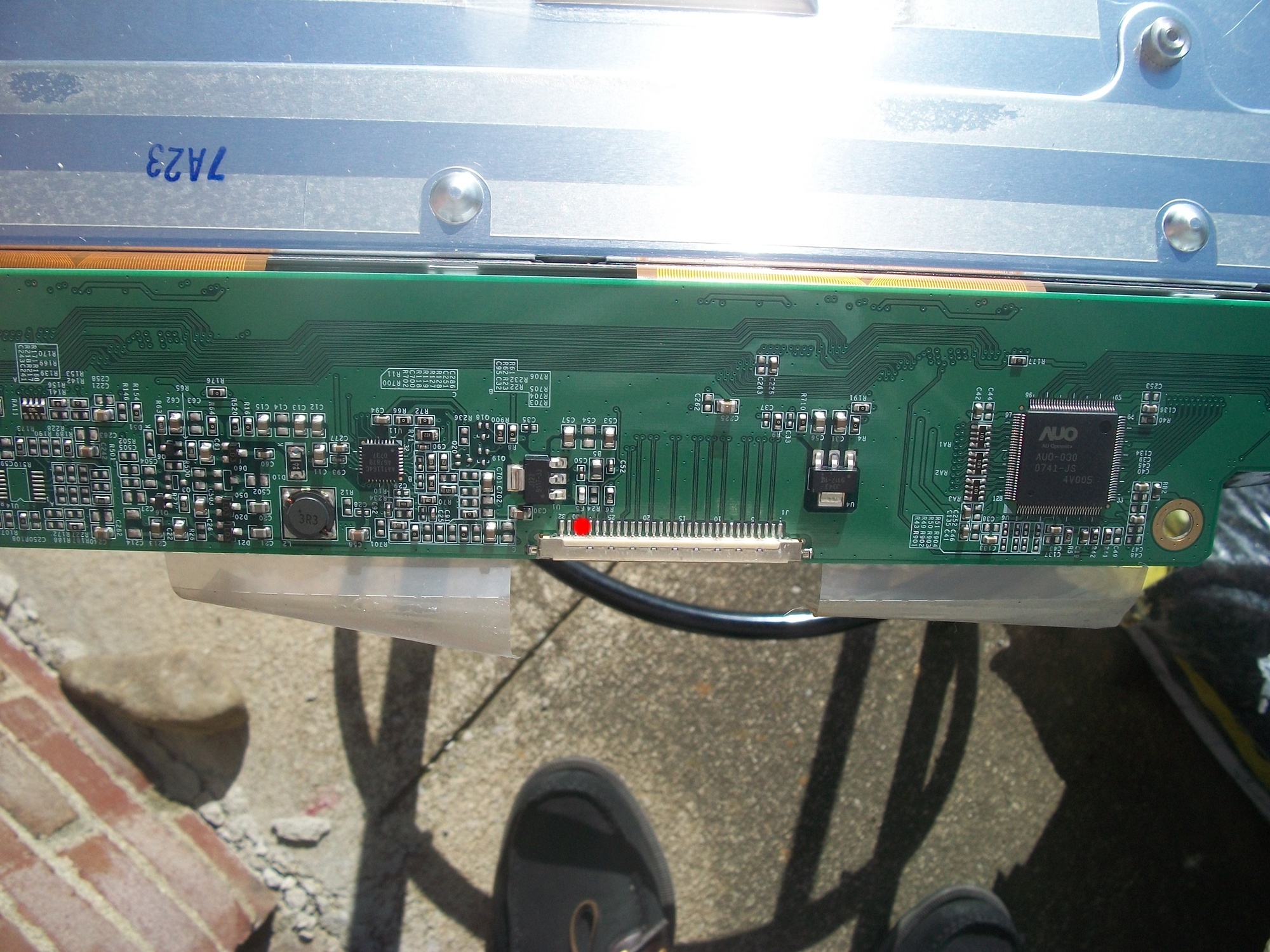

                                    I finally found a fuse on the Main Board (it test good) and just tonight found a fuse on the Controller (Panel) board. I took a picture, but it is really small. It is just above the red dot I placed on the picture. I need some help with what the specs are on the fuse. Of course there is nothing written on the fuse itself.
                                      1) Is the fuse open?
                                      2) The picture is too fuzzy to tell. If your camera has macro mode, enable it and take the board to a window when it is sunny outside. That should produce a clear focused image.

                                        Sometimes my fingers outpace my brain. Yes I tested the fuse on the controller board both for continuity (showed open) and on the resistance setting went directly to O.F so I believe the fuse is bad. As soon as we see some sunshine I will retake the picture. Supposed to get some today. So after turkey I will repost a picture.

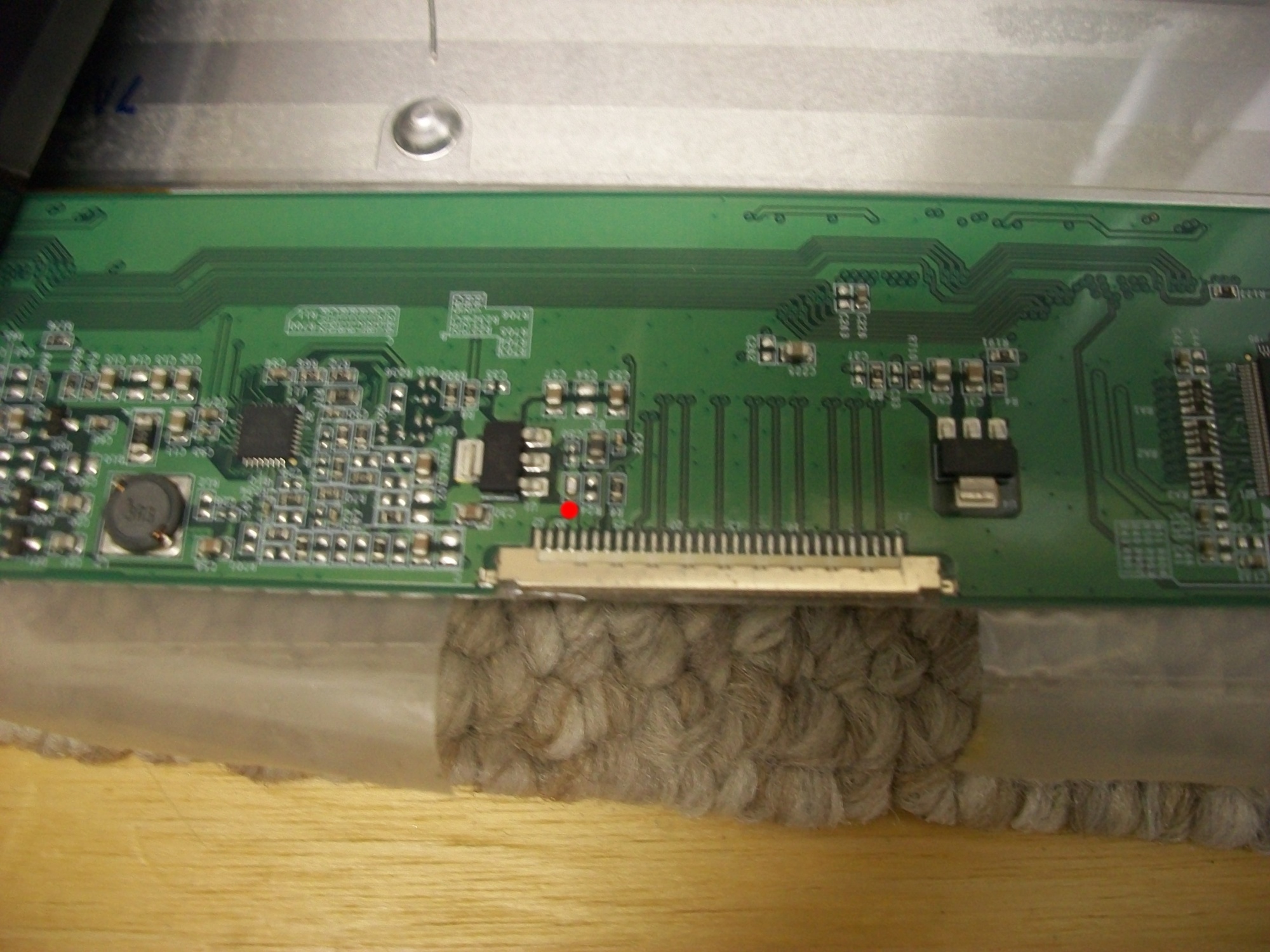

                                          Turkey was postponed for about an hour. I took the picture again and the Fuse is the little white SMD just above the red dot. It is also just to right of the first leg of the big IC with 3 legs. Hope this picture is clear enough.
