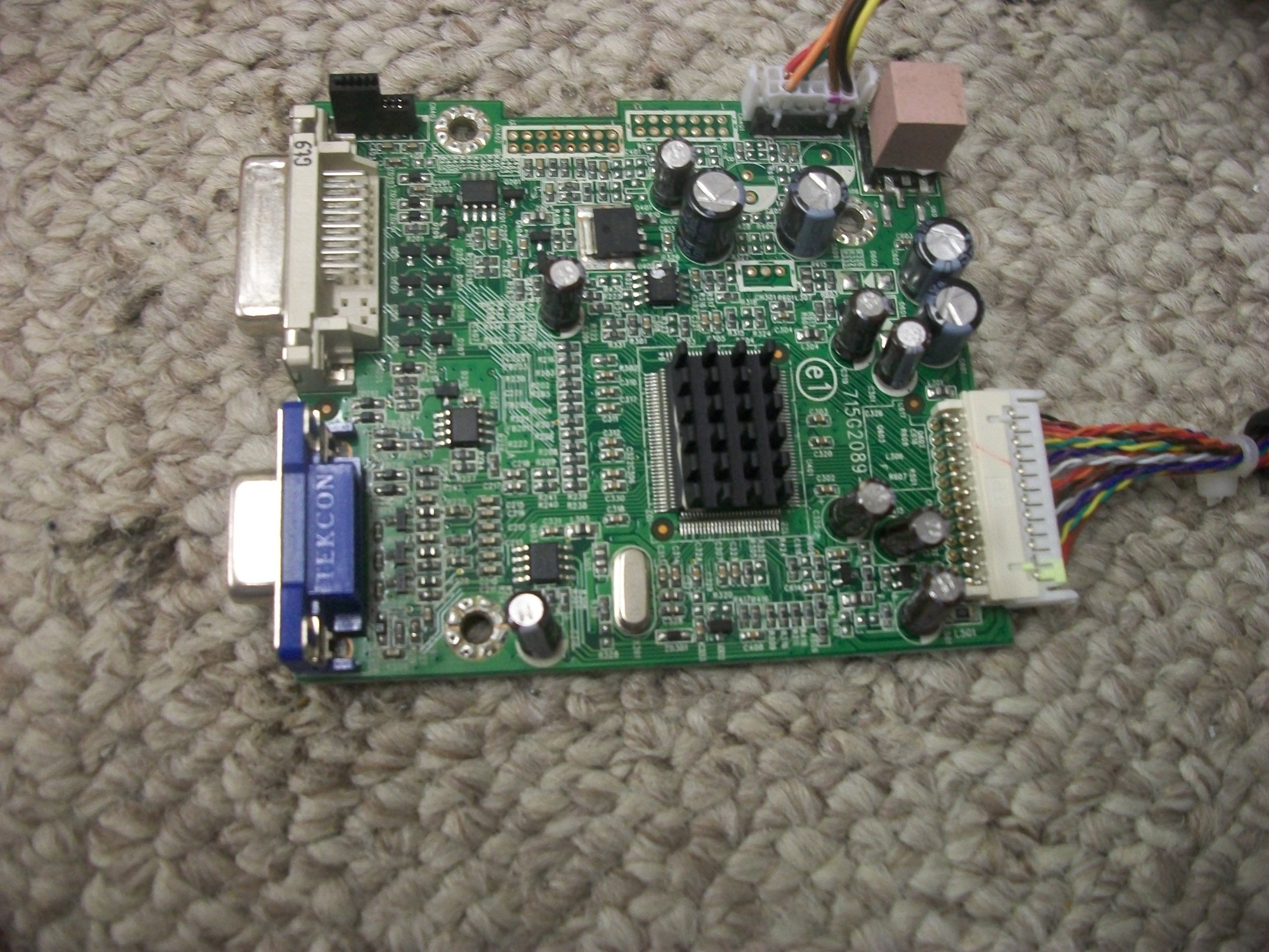

                                  Pictures of signal card attached.

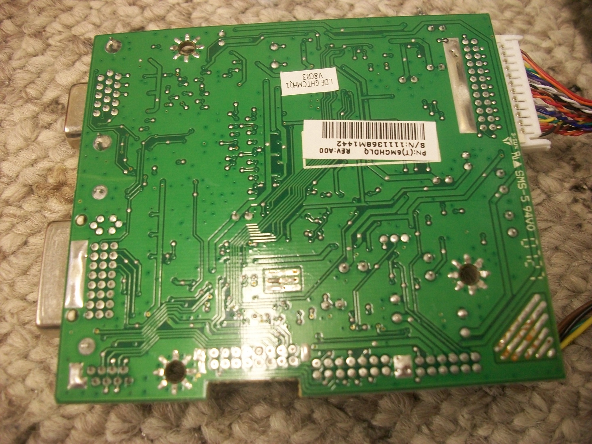

                                    OK, power supply is working, and sending 5 VDC to the signal card. Did you check the wires at the connector or at the signal board itself? The connector pin seems to be a little high.
                                    Unfortunately, the picture of the top of the signal board leaves a little to be desired, could you retake it, please.
                                    Whoops, just to make sure we are on the same page, this is NOT the 'panel board' you referred to above, is it?

                                      No it is not the panel board. That board is attached to the back of the LCD Screen. I took the readings from the connector. The connector on the power board has nine pins in a straight line. The connector on the signal board has two rows of pins so I was not sure which pin was which and I just measured at the top of the connector where I could tell what wire went where. I will try to get a better picture. It is dark here now so I will take it first thing in the morning.

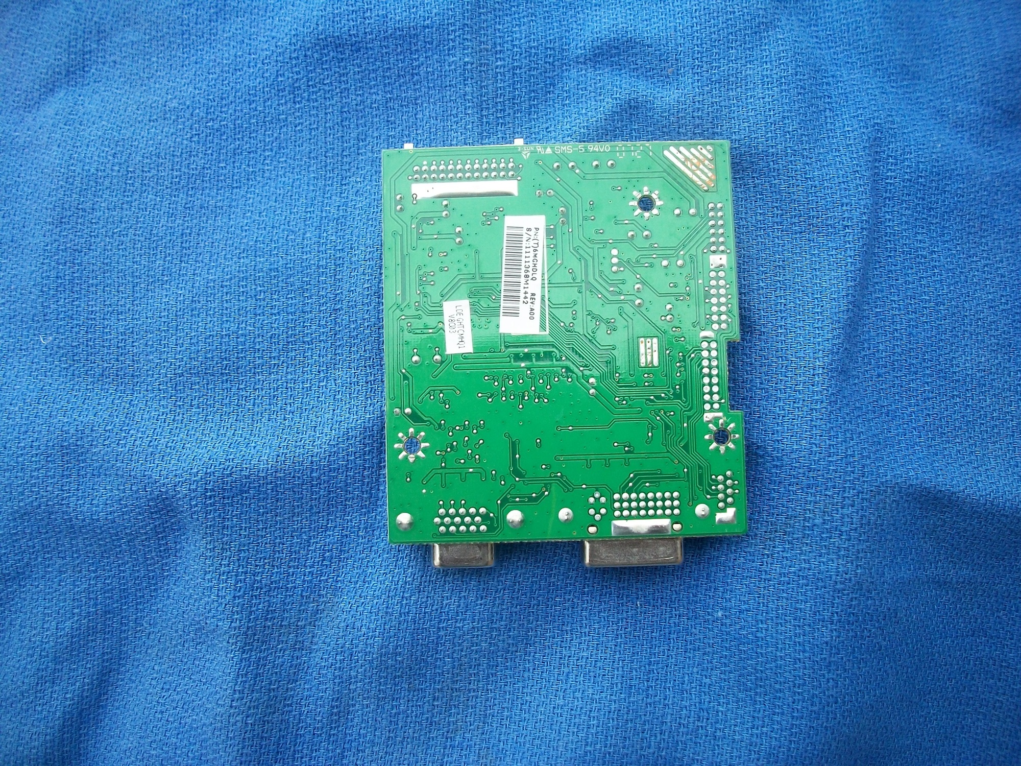

                                        A quick background on what is happening here. A monitor is totally 'fly by wire' - the processor on the signal board controls everything. Once the power cord is plugged in it scans the front panel looking for a key press. It turns the power LED Green (or blue), amber, and off, the inverter on and off, adjusts the brightness, and turns the power to the LCD panel on and off. And of course, it also processes the video information.
                                        At this point it's very likely the signal card is bad and we have to figure out if it is repairable.

                                          I understand. Hope these pics will help.
