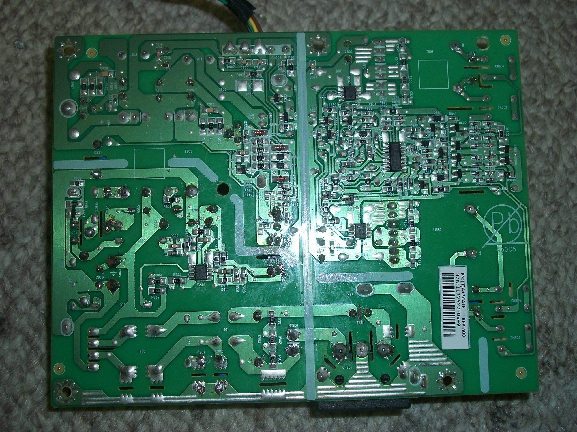

    1) All those readings are good. It looks like your multimeter has a threshold of 2V for diode testing before it reads 0L (out of range).
    2) It always helps if you tell us the problem and symptoms.
    3) Good clear pics.
    4) NR901 (backside) looks like it has dodgy solder cracks?

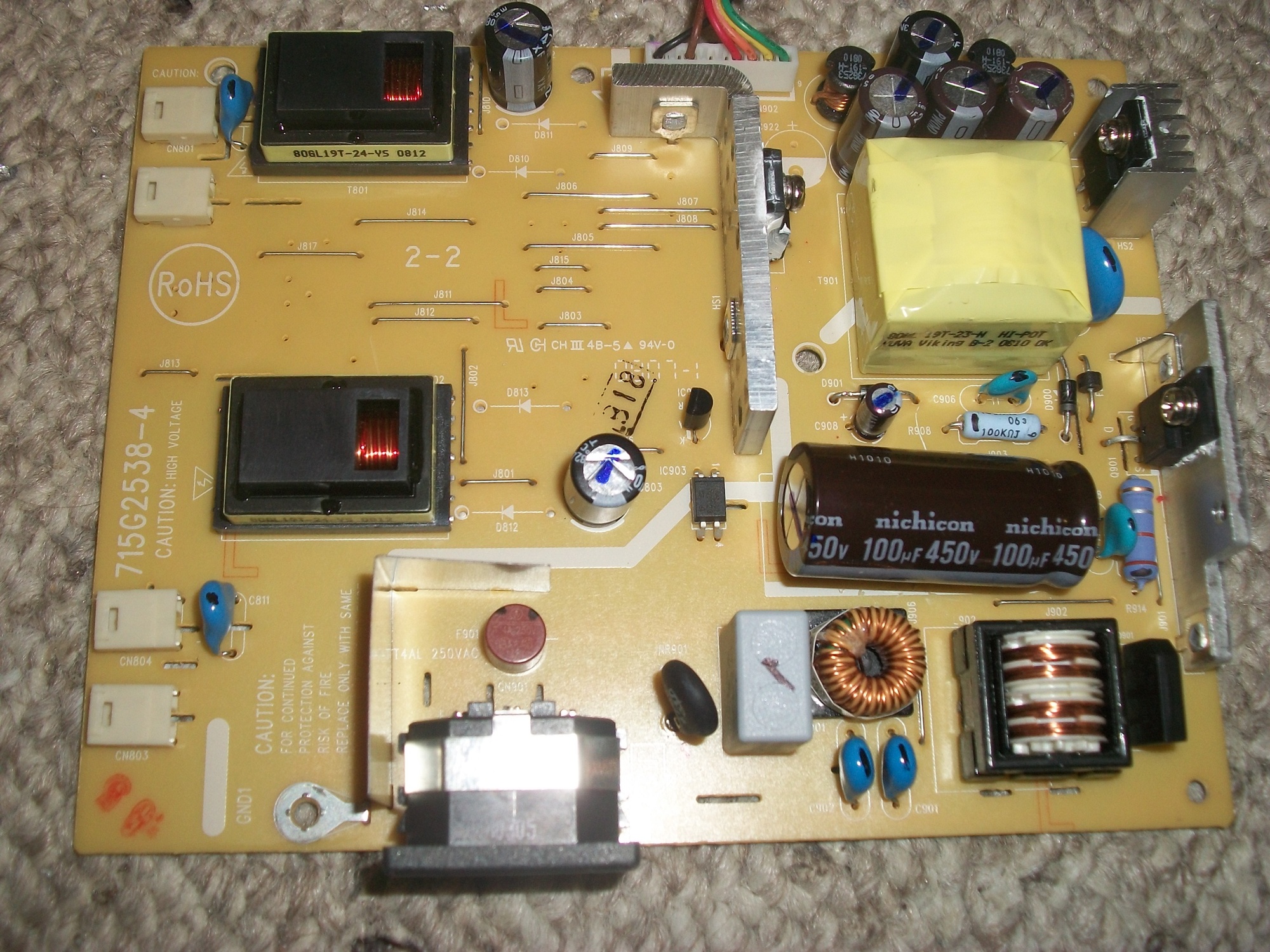

        Re: Dell E207WFPc
        1) What is the DC voltage across the big cap? Be careful measuring this as it could be around 165 V DC.
        2) What is the DC voltage across the startup cap (C908)? Is it steady or fluctuating?
        3) On the backside, what is part number for IC901? For bonus points, find the datasheet and provide a link.

            Re: Dell E207WFPc
            Voltage Across Big Cap = 173v

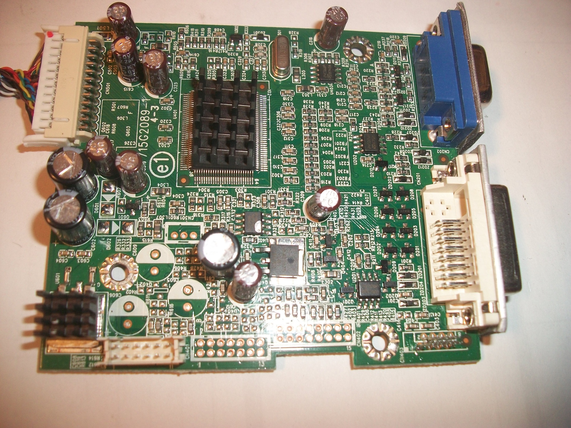

                Ok, I'll get pictures. Cloudy, Rainy and getting dark here. I will post asap in the morning. Thanks.

                  Re: Dell E207WFPc
                  1) Those DC voltages indicate your SMPS is working.
                  2) Now we need a clear focused picture of the logic/main board.

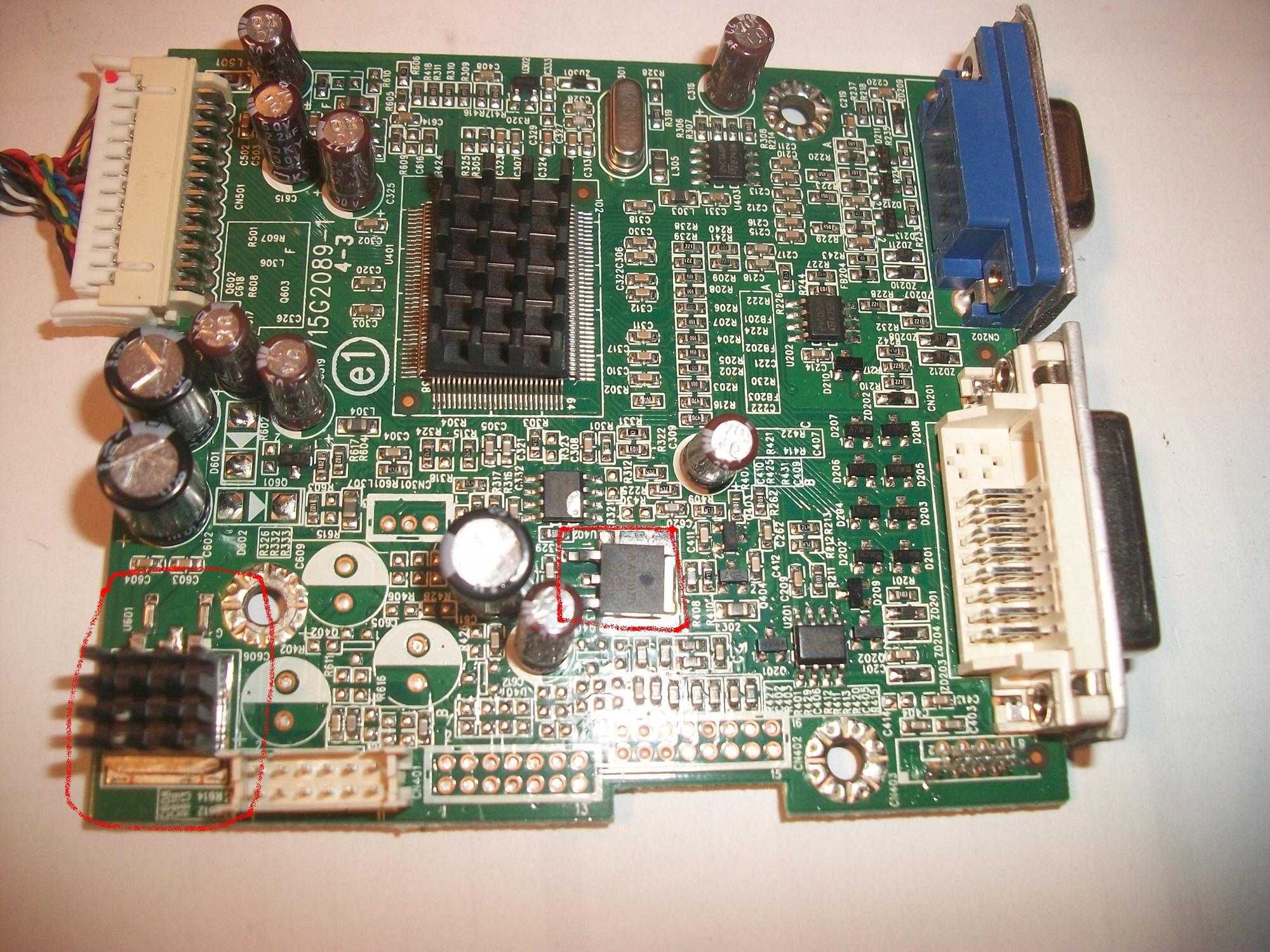

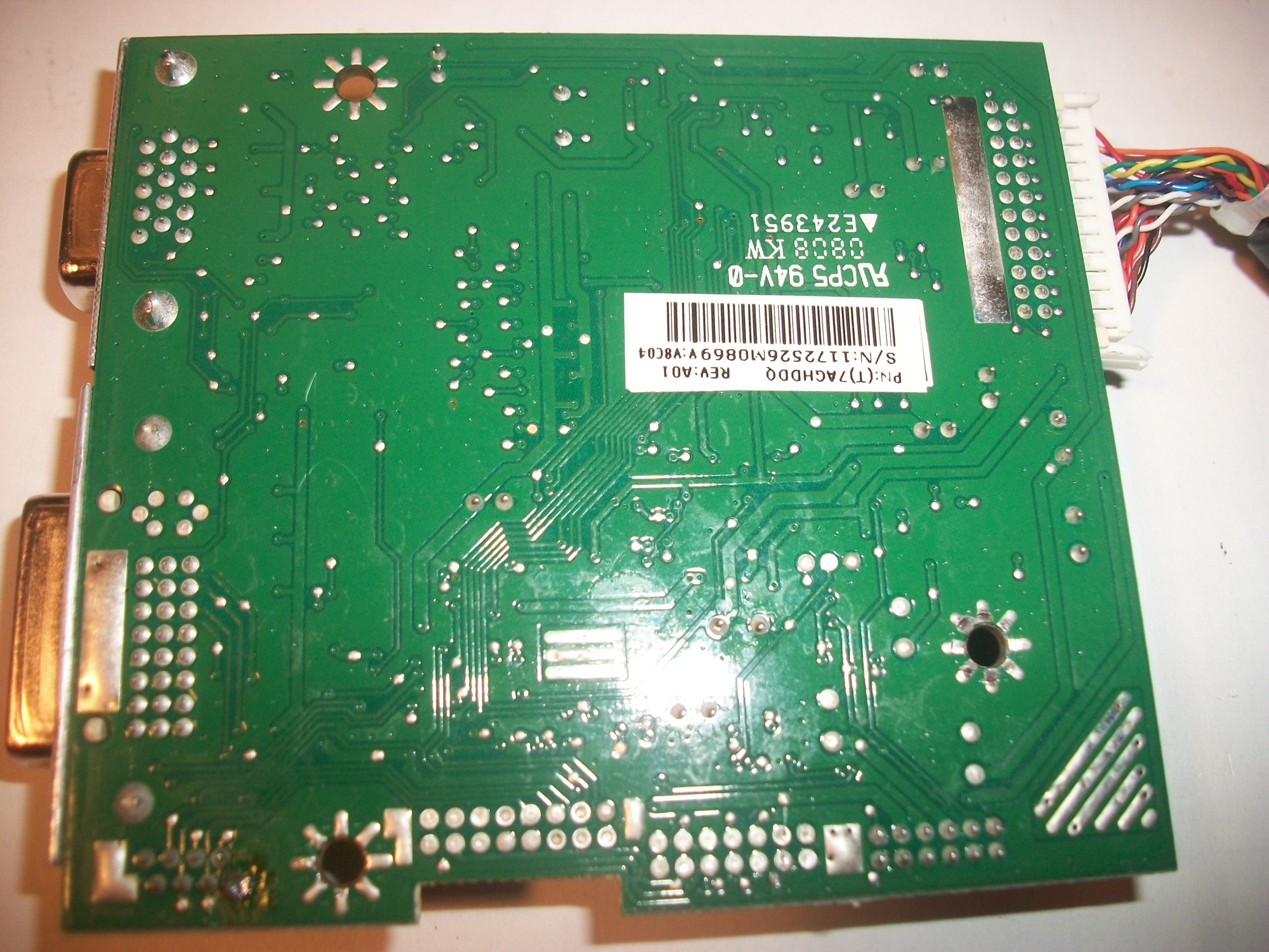

                    Ok here are the two Video Board Pictures. Sorry about the flash. It is still a nasty day today. So I had to improvise the picture taking.

                      Re: Dell E207WFPc
                      Is that a solder splash across pins 1+2 on U402?
                      also can you post data on the 3 pin component? just under and to the right of U402 as flash has obscured it
                        Re: Dell E207WFPc
                        1) Interesting. Did you recap this main board too? Or did it come with Rubycon and UCC KY caps?
                        2) The voltage regulators are circled in red. We want the DC voltage readings from all the 3 pins (Gate, Source, Drain) with respect to ground.

                          Re: Dell E207WFPc
                          Solder splash appears to only have been on top of U402 not between legs.
                          The component you are referring to is Q401 and the number is AZ1117D. Here is the datasheet: http://pdf1.alldatasheet.net/datashe...1117D-1.8.html

                            Re: Dell E207WFPc
                            I make it a habit of never touching a main board unless I absolutely have to. They are so hard to remove components from. I don't know if someone tried to work on this board before I got it. Picked it up off of Craigs List.
                            I will get your readings on what you have circled. Get back to you with those soon.

                              Re: Dell E207WFPc
                              Hmm, now that I relook at the backside, it looks like the original caps from the soldering.
                              You almost never see high quality caps (especially low ESR) on the logic board since they don't undergo the same stress as caps on the SMPS.

                                Re: Dell E207WFPc
                                Do you mean for me to take the readings with the power on and the main and power boards connected.

                                  Re: Dell E207WFPc
                                  I believe you are correct. The solder points look just like factory work.

                                    Re: Dell E207WFPc
                                    Yes.

                                      Re: Dell E207WFPc
                                      Readings on component (with heat sink)
                                      G = 2.2mv S=5.07v D=3.28v
                                      Q401
                                      G=2.0mv S=3.28v D=1.79v
                                      Just for my knowledge, I thought you read transistors (Q401) by taking an ohms reading between the different legs G-S G-D & S-D.

                                        Re: Dell E207WFPc
                                        Q401
                                        The readings for the voltage regulators look good. The "usual" voltages are 1.8V and 3.3V.
                                        Yes, that is one test. Voltage regulators can be shorted. However, the test for a short doesn't verify if it outputting the correct voltage or not.
                                        For example, a AL1117-33 regulator should output 3.3V DC. The suffix -33 denotes the output voltage.
