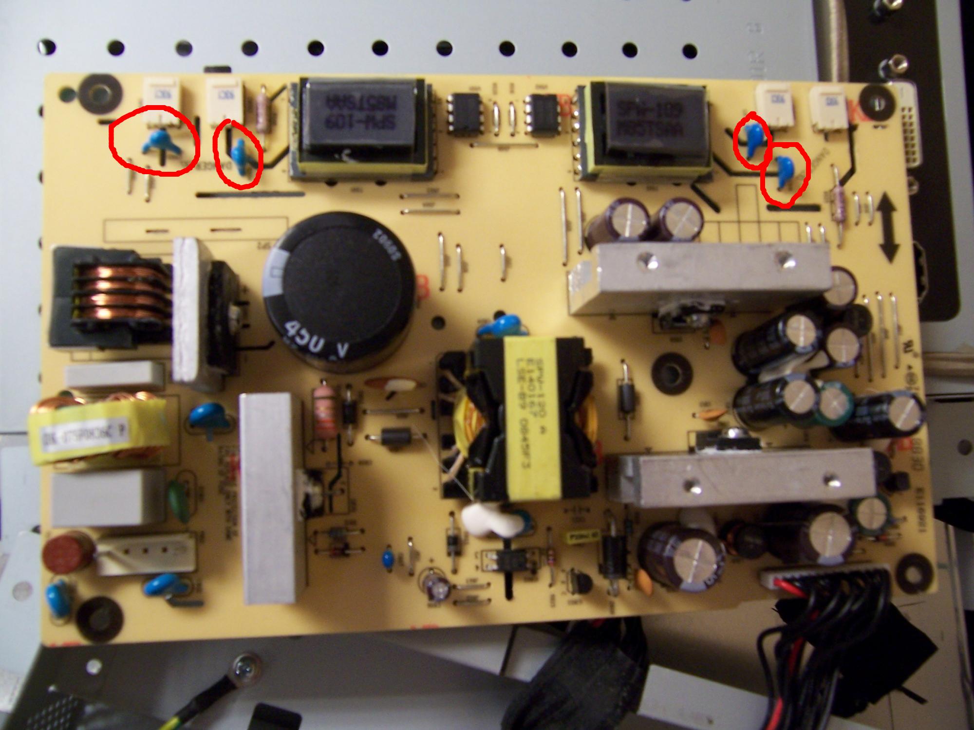

                  Originally posted by IRIEBLUES
                  Sportsman99,
                  reading this thread helps... however, someone like me.... well I know I am having the same issues and not sure what all these caps you guys are talking about.... I'd just like to buy the same parts you bought and hope it works... can you assist?
                  These caps circled in red, they are high voltage capacitors, see if any of them look brown (they are normally blue).

                    Hi guys - brand new - been reading and searching
                    my question is are the caps at 503 and 504 the same and is that also true on 517 and 519
                    my 504 is crispy!
                    my 503 reads N3 3KV SEC
                    my 517 reads N3 3KV SEC
                    my 519 reads 12J 3KV JNC
                    my thought was 504 might be the 12J 3KV JNC and maybe since 519 looks a little "dark" I would replace both 504 and 519
                    lastly is there an "alternative" cap that will not burn up - this thing was a PITA to open and I would rather not repeat in 6 months
                    THANK YOU for your inputs!!!
                      #30
                      Re: Vizio LP2626/VMM26-F20I
                      504 is the same as 519, they are symetrical.
                      I use TDK or MURATA, VISHAY from Digikey or Mouser. Just type in 3pf 3000V (or 6300V) in the search box
                      3pf 3000V, this will be hard to get.
                      12pf 3000v.
                          I repalce them with what they should be, two are 3pf, two are 12pf. I replaced tham as a set. So make sure you mark each location to make sure you install the right value at the right location.

                              WOOOHOOOO!!
                              Thank You - the monitor works perfectly - We bought some caps off ebay out of Canada for about $4 took about a week to arrive, about 5 minutes to install, tested - worked, put it all back together and I have one really happy boy! that is a very nice monitor!!!
                              Thought I would close out my end - so many newb's never come back and thank forum regulars -
                              as for what we did (guess that is important too) I replaced cap c517 and c519 with same size 12pf 3kv caps )only one was "burned"
                              I would like to add - the "ribbon" connector on the power board does NOT unplug!!! - if you want it to be removed you have to unplug it from the other end which required removing the other metal box, pcb and a few wires - then unplug the cable to the power board - use some sort of a marker to mark the placement of the box before removing so it will align with the back when re-installed (its just "taped" in place)

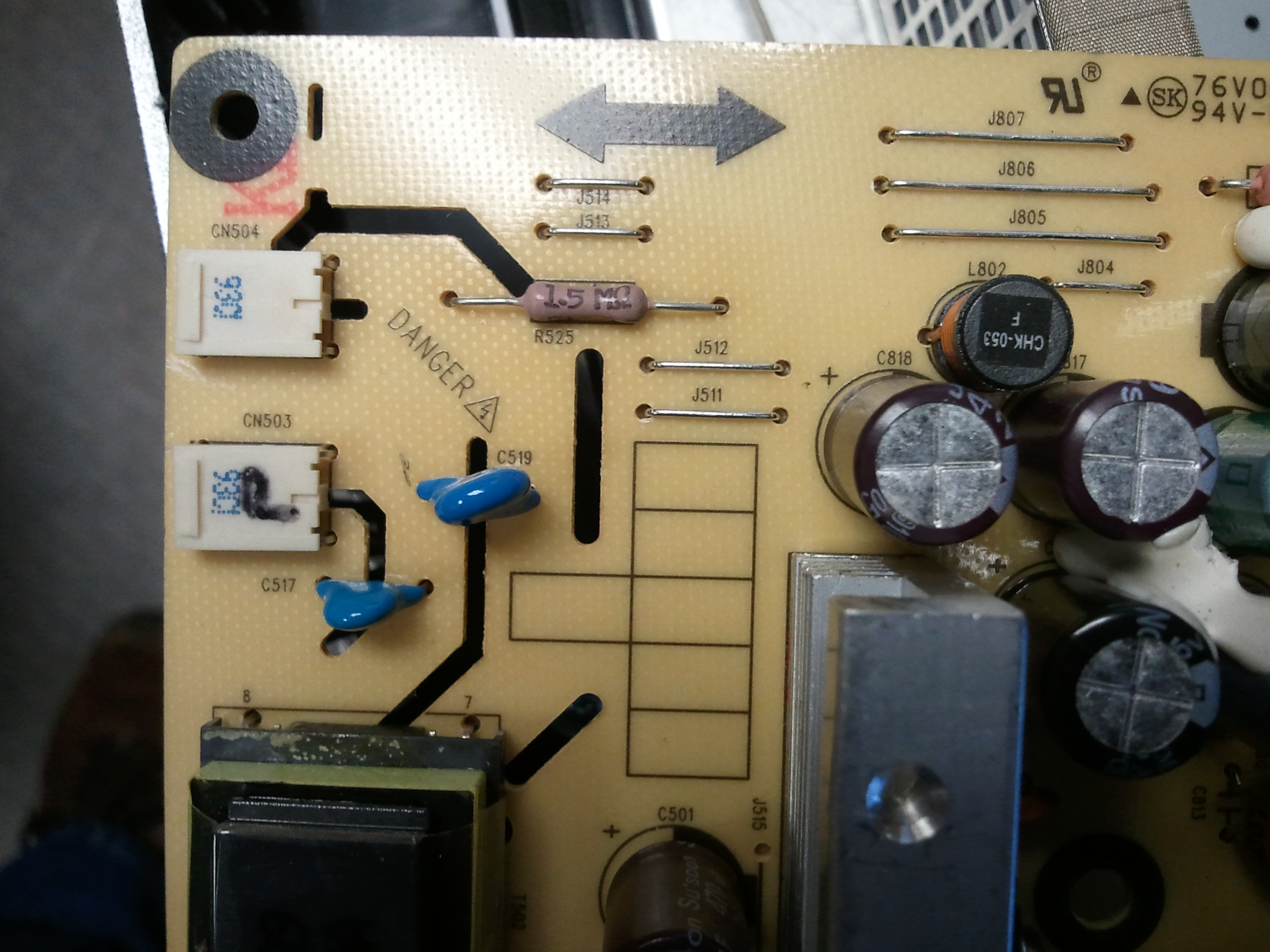

                                SO i bought another monitor and replaced the 12pf caps the monitor comes on then off again after 3 seconds. i read resistor r525 and and it reads .9 Meg, can anyone tell me if this is a 1.5 meg resistor it is hard for me to read the color bands i would say it is brown/green/green. i did not have the 3pf caps but will get a couple of them but i wanted to replace resistors at the same time. Since they did not seem to read what they should.
                                i did see the pictures posted to this forum, awesome pictures i might add, still unsure of the resistor values.
                                  Does it read the same as R508? Did you test it off the board and your are not touching the meter probes with your hand?
                                      Well i decided to pull the power supply out of my working LP2626 monitor and i really like the way they stamped the resistor 508 and 525 it is a 1.5M resistor.
                                        #39
                                        That is correct. I just looked at my board last night.
