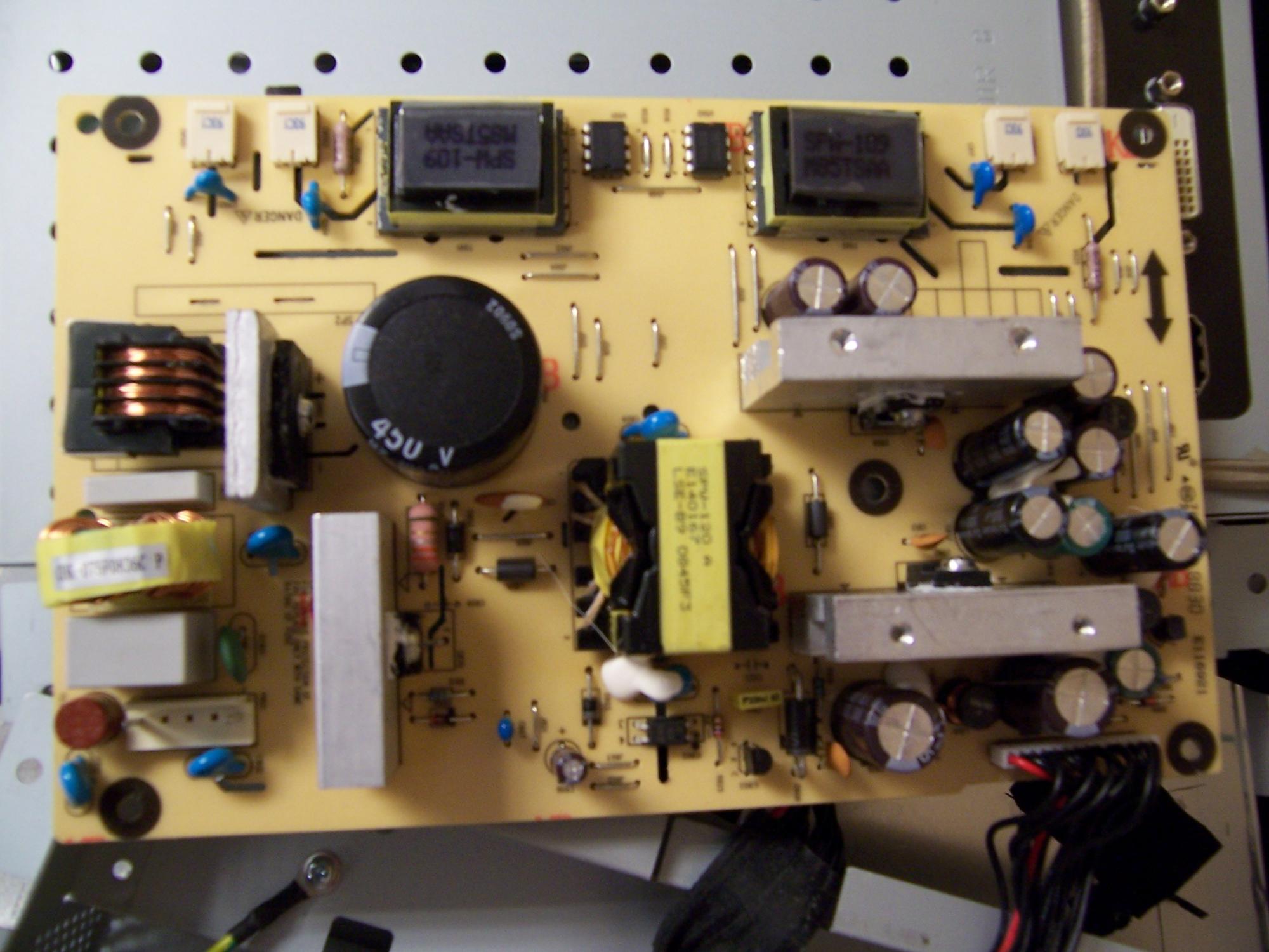

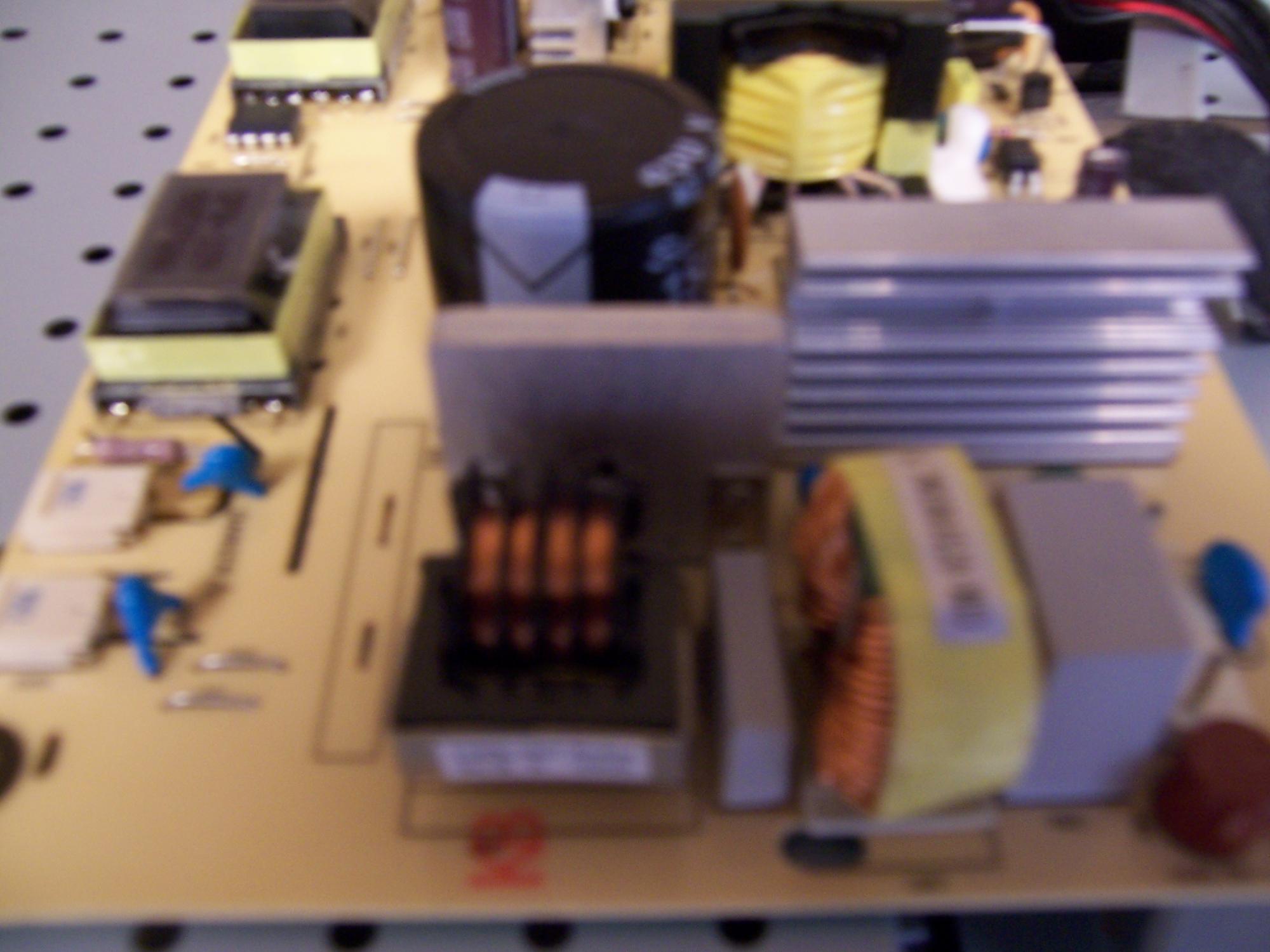

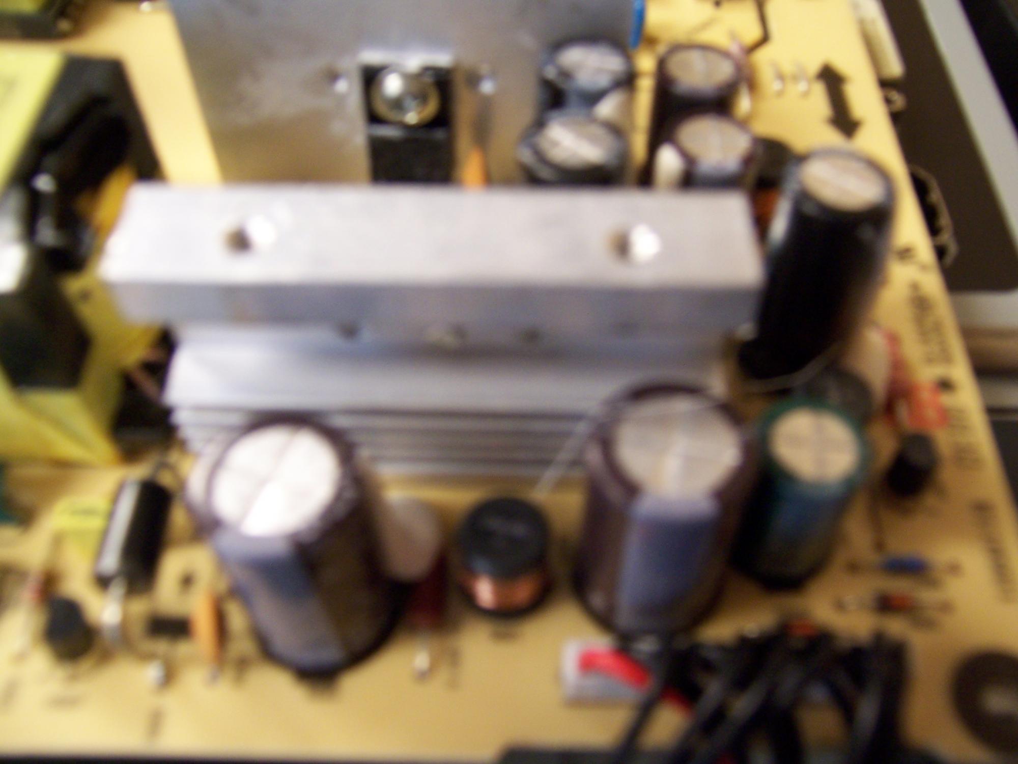

      Re: Vizio LP2626/VMM26-F20I
      I have uploaded 3 pictures, could you give me some info of repairing the CCFL?
                We seem to say this several times a day. The very best advice we can give is to supply several pictures. Each picture should be as close to 2000 x 2000 pixels without exceeding that size. One picture should be of the top of the power supply, one of the bottom.
                In most cases the control signals for the inverter are strictly one-way. The signal card turns on the inverter and sets the brightness. If the inverter encounters a fault condition and shuts down, the signal card does not know about it. I HAVE helped troubleshoot failures of the protection circuitry on inverters. It is very tedious.
                    Originally posted by sportsman99
                    what would you need pictures of and ill be glad to upload them. would i be time ahead to just purchase a inverter ckt? i would be glad to trouble shoot, with your assistance. i do have a o'scope and familiar with using one. oddly enough, i dont have a schematic of this tv or any tv and i do not know what or how much of this is the inverter ckt. this monitor was given to me from my boss and it is of great desire to fix this unit, especially if i could fix at the component level. your assistance would be very much appreciated.
                    thanks,
                    A picture of the bottom of the power supply might give us the information to help you. Without it, I can't help.

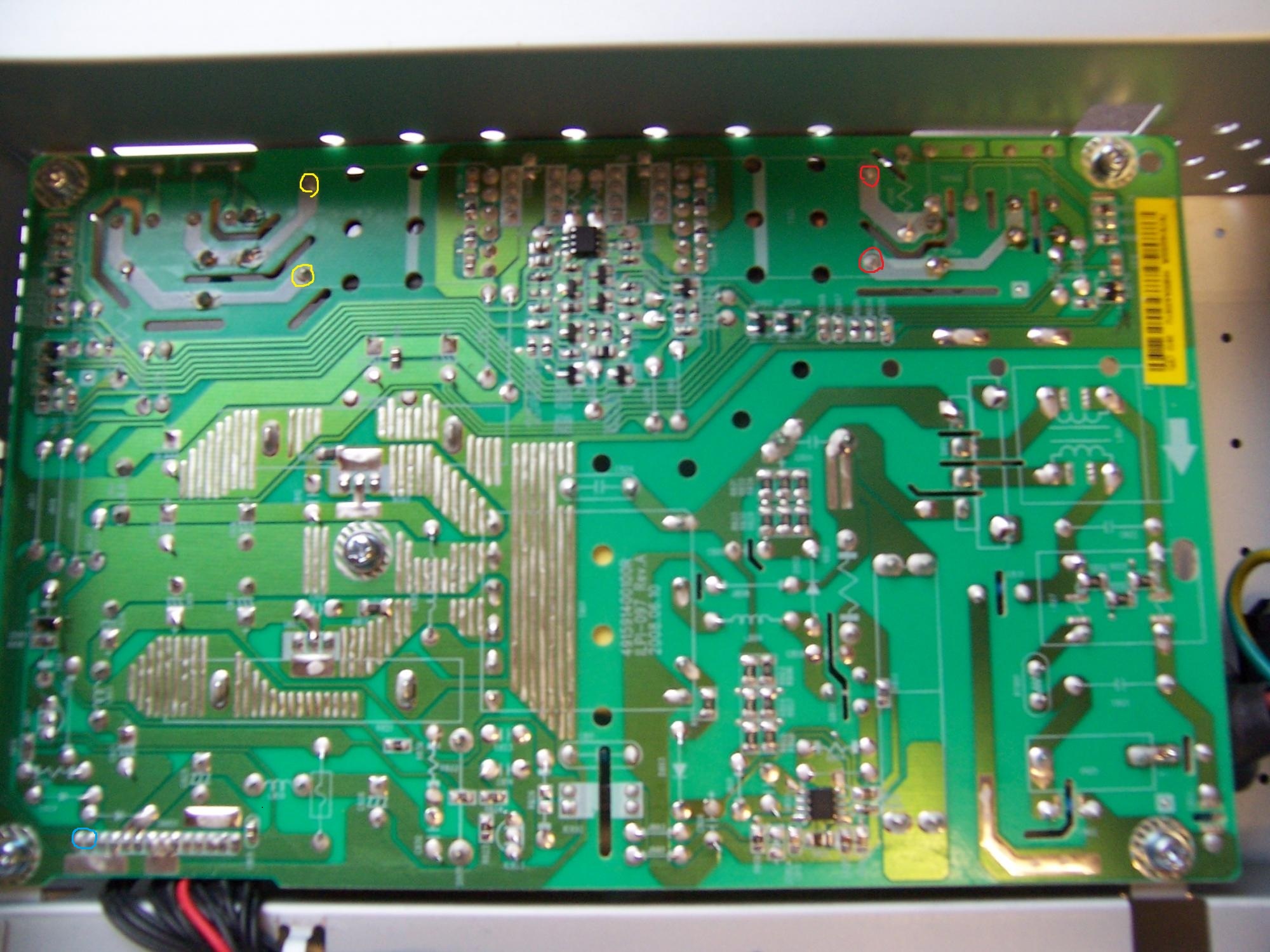

                      here you go thanks,
                      • PlainBill
                        • Feb 2009
                        • 7034
                        here you go thanks,
                        I was rereading an earlier post. Please verify that even if only one CCFL is connected, the display comes on for two seconds and then goes black.
                        Also, we seem to have missed a troubleshooting step or three. After the display goes black, have you tried shining a flashlight on the screen at an angle? Can you see the desktop (or whatever was being displayed)?
                        If you can't, one additional step is necessary. I've marked up your latest picture. In the lower left corner I have circled two pins in teal. I believe these are the control signals for the inverter. Check the voltages on these pins when the screen is on, and again when it goes black. If the voltages do not change, you have 'two seconds to black'. Report those voltages.
                        And the last steps. I've circled two pins in the upper left corner in yellow. What is the resistance between those pins? And also, there are two pins circled in red in the upper right corner. What is the resistance between those?
                        Aww, crud. I just examined the picture of the top of the power supply carefully. Between the two heat sinks is a greenish cap. What brand is that?
                        PlainBill
                          the resistance between the yellow circles is 436 ohms on a digital meter.
                          the resistance between the red circles is 436 ohms on a digital meter.
                          the voltage at the teal circles the one to the outside is 5v ~ 4.96v
                          the voltage to the second teal circle to the inside is 2.9v
                          i did not see a voltage change during picture to black screen.
                          i did not see a picture with a flashlight.
                          the capacitor is a samxon 680 micro F 16v.
                          thanks,
                          • PlainBill
                            • Feb 2009
                            • 7034
