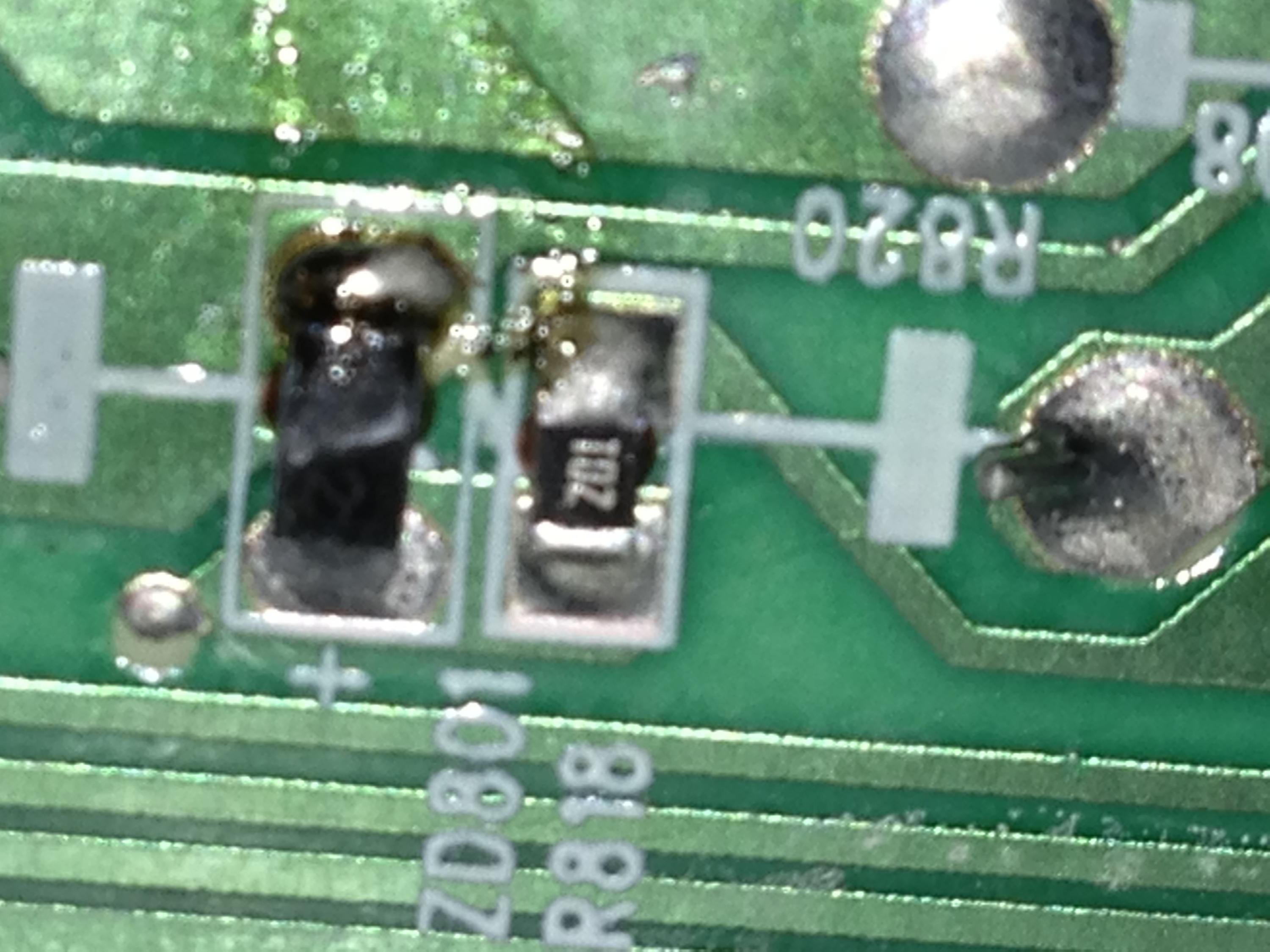

Re: Vizio LP2626/VMM26-F20I
The resistor is close enough tolerance of 5%.
That cap needs to be replaced.
Vizio LP2626/VMM26-F20I
Re: Vizio LP2626/VMM26-F20I
Would that be a possible cause of my 2 seconds to black screen? I can find that caps on E**Y and get a couple. The R508 resistor measures 1.44 Meg. I think the color code is brown, green, green. I think that is 1.5 Meg and the tolerance code is gold.
Thank you,
CPeterLeave a comment:
Re: Vizio LP2626/VMM26-F20I (after thoughts)
I tested resistor R508 and the value is 1.44 M ohm
CPeterLeave a comment:
Re: Vizio LP2626/VMM26-F20I
Brilliant info. Thanks. I took a photo of the connections before disconnecting, or so I thought. Then spent quite a while searching on the internet for the answer to the connections and found this post.
I located and replaced the blitzed capacitor (C504) with this http://tinyurl.com/h9bft46. However the fix does not seem to be successful or at least complete. I only replaced the one capacitor because it was clearly fried, but not any other components. this project is sorta beyond my patience level and lack of diagnostic tools/knowhow. Nevertheless, thanks to all who offer their time to help others.
I'm inclined to buy a whole power supply board, if I can find one.
>> You have 4 individual lamps set up in two pair for the top and bottom edges of the LCD panel. The pink and blue pair can go into either pair of the receptacles on the board.
So what you have as shown in the picture, the left pair the pink one can go into the left most connector, the blue can go into the connector to the right of it, and so on.Leave a comment:
Re: Vizio LP2626/VMM26-F20I
Okay, I have replaced the c504 with a 12pf 3kv capacitor and made sure the lamps have the correct wiring but it still doesn't seem to want to power on :/ Is it possible something else is blown? The first time I tried to power it on I had the wires in the wrong lamps and the power supply was not mounted, i saw a spark and there is a very tiny black dot/charred area above the label. Could this have caused something else to blow, because everything else on the board looks fine. Any help is greatly appreciated.
All the previous posts have been very helpful with teardown and what to look for.
Thanks!
images of my board below.
http://imgur.com/a/eFEihLast edited by XCrunner; 08-09-2015, 03:27 PM.Leave a comment:
Re: Vizio LP2626/VMM26-F20I
You have 4 individual lamps set up in two pair for the top and bottom edges of the LCD panel. The pink and blue pair can go into either pair of the receptacles on the board.
So what you have as shown in the picture, the left pair the pink one can go into the left most connector, the blue can go into the connector to the right of it, and so on.Leave a comment:
Re: Vizio LP2626/VMM26-F20I
I am aware this is an old thread, but would anyone be able to help me with a couple of the plugs? There are four slots that say "8AN3" near where the capacitors are. I am not sure which cords go into them.Leave a comment:
Re: Vizio LP2626/VMM26-F20I
To all who posted info on this... Thank you! Thank you! Thank you! Thank you! Thank you!
Just got my order from Mouser including the 12pf 3kv and 3pf 3kv caps and 1.5mOhm resistors. The resistors did not test not off-value once I removed them from the board, but they looked a little toasted so I swapped them anyway. The 3pf caps didn't test as defective either so I'm not sure they needed to be replaced. Anyway, my monitor, which would flash on for about 2 or 3 seconds and then go black, is all fixed now for about $10 instead of $200+ to replace the monitor. Many Thanks!!!
In case it helps anyone find the parts, here's what I used...- 1.5M resistor - Vishay VR68000001504JAC00 (Note: these are huge, but well over-spec'd)
- 3pf cap - muRata DEF2CLH030CJ3B
- 12pf cap - TDK CC45SL3FD120JYNNA
Leave a comment:
Re: Vizio LP2626/VMM26-F20I
I was researching the N3 3KV SEC capacitor to confirm its value. SEC seems to be the Manufacters logo Success electronics LTD in Tiawan. They confirmed 3pfLeave a comment:
Re: Vizio LP2626/VMM26-F20I
I didn't want to start another thread.
It's a possible purchase, but I don't know what could be the problem?
It just needs a reset or an EPROM issue?
http://www.youtube.com/watch?v=mJHpo...ature=youtu.be
It seems like it's in a test pattern of some kind.Leave a comment:
Re: Vizio LP2626/VMM26-F20I
Lots of good info in this thread! I have a similar problem but the difference in my situation is there is no message on the screen before it goes off. Image is present on LCD. Backlight comes on for a couple seconds and then just goes off. Inverter signal voltage is constant at multi-pin cable connection.
I have been able to determine that the backlight fluorescents are ok (hooked them up to a inverter board from a similar monitor : stayed lit), I had the blue ceramic caps in stock so I replaced them : no difference. What else is strange is that if I change the input source or turn the signal to the monitor on and off, the screen comes on for a couple seconds again each time. Initially I thought this might be a problem with the logic board signalling the power supply board. But like I said the inverter signal voltage is constant and I can trace the it to the small batch of SMD resistors and transistors just before the set of three 8 pin IC's before the step up transformers. Without a schematic I can't trace it through any further. It seems to be sensing something, or a cap or transistor is breaking down in that circuit.
What other signal factors are involved? What about feedback signal from the backlight output circuit? Anyone have a schematic for this board? I feel I am very close...
EDIT: Oh, forgot to mention. Once ceramic cap and 1.5m resistor were slightly discolored. As I said, I changed the caps, measured resistor and it measured OK.
Any help would be appreciated. Thanks!Last edited by thepeaceseeker; 05-22-2013, 08:11 PM.Leave a comment:
Re: Vizio LP2626/VMM26-F20I
Thanks for all the great information. With a little more help, I feel this is fixable.
Leave a comment:
Re: Vizio LP2626/VMM26-F20I
Just registered so I could see the pictures—thank you for these posts; gave me the extra oompf to go the rest of the way, dismantling (this monitor is the most insane thing I've had to get into! and I thought laptop screens were annoying...). One of the 12J 3KV (C504) was horribly disfigured. Interesting that it seems to be that one in particular across the board...?Leave a comment:
Re: Vizio LP2626/VMM26-F20I
That is correct. I just looked at my board last night.Leave a comment:
Vizio e601i-A3 - Has Sound and Display, But No Backlight - Bad Power Supply Board or Bad LED Bulbs ?by Tynan DillI was given this TV from my great uncle. He said it just wouldn't turn on one day out of nowhere, replaced the TV, and gave it to me to possibly fix and use for myself.
Assuming...7 Photos -
This specification for the Acer Aspire ES1-533-C504 Notebook can be useful for upgrading or repairing a laptop that is not working. As a community we are working through our specifications to add valuable data like the ES1-533-C504 boardview and ES1-533-C504 schematic. Our users have donated over 1 million documents which are being added to the site. This page will be updated soon with additional information. Alternatively you can request additional help from our users directly on the relevant badcaps forum. Please note that we offer no warranties that any specification, datasheet, or download...09-06-2024, 06:27 AM
by SS454vizio e650i-a2 (LWJAOZBP Serial) led backlight flashes then turns off, has video (via flashlight) and audio.
panel: au optronics T650HVN05.4
72 led total on 12 strips, 6 led per strip wired in three groups of 24 (led driver board has three anode and three cathode pins)
link to datasheet: https://datasheetspdf.com/pdf-file/8.../T650HVN05.4/1
Vizio 56.04219.641G (liteon PA-3231-01WN-LF) Power Supply Unit
https://www.shopjimmy.com/vizio-56-0...-power-supply/
Vizio 55.75J01.001G (91.75J10.004G) Main Board... -
by mrtekHi.
picked up another TV. This time is a Vizio M65-C1. TV does not turn on. I had repaired another 60 inch vizio , Bad main board.
When power button is pressed, the Power led indicator on the bottom right, turns for a few seconds and then it fades away. No backlight or Vizio logo on screen. Removed back cover and repeated test.
This is the TV This TV is a little different from the Samsung I have worked on. Power supply is on the Left side, Main Bd is on the right side, T-CON , not in the picture is on the bottom. I am assuming that the boards in the middle are the LED... -
by howardc64Failure Symptom
No picture, just red vertical stripes. Google search shows quite common problem for these recent Vizio M series although red vertical stripe pattern may differ. Some call it "Netflix" boot screen haha.
Where is the short?
Panel has 4x buffer boards. Quickly found the 1/4 panel buffer board with the problem by selectively disconnecting buffer board flex cables.
Having recently fixed another Vizio with similar symptoms that was a shorted ESD diode array ( link ) Probed the ESD diode array but... - Loading...
- No more items.
Leave a comment:
