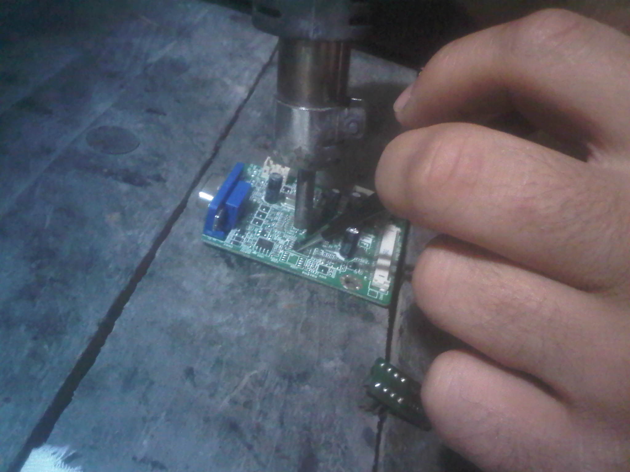

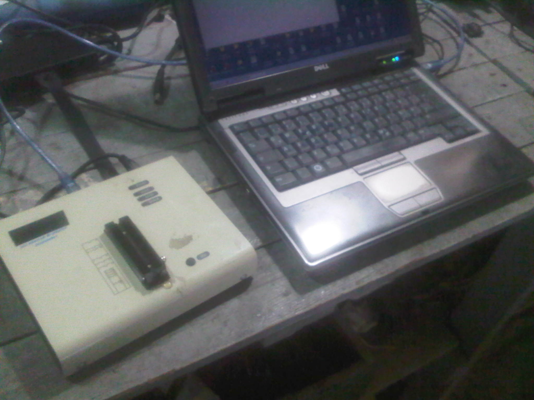

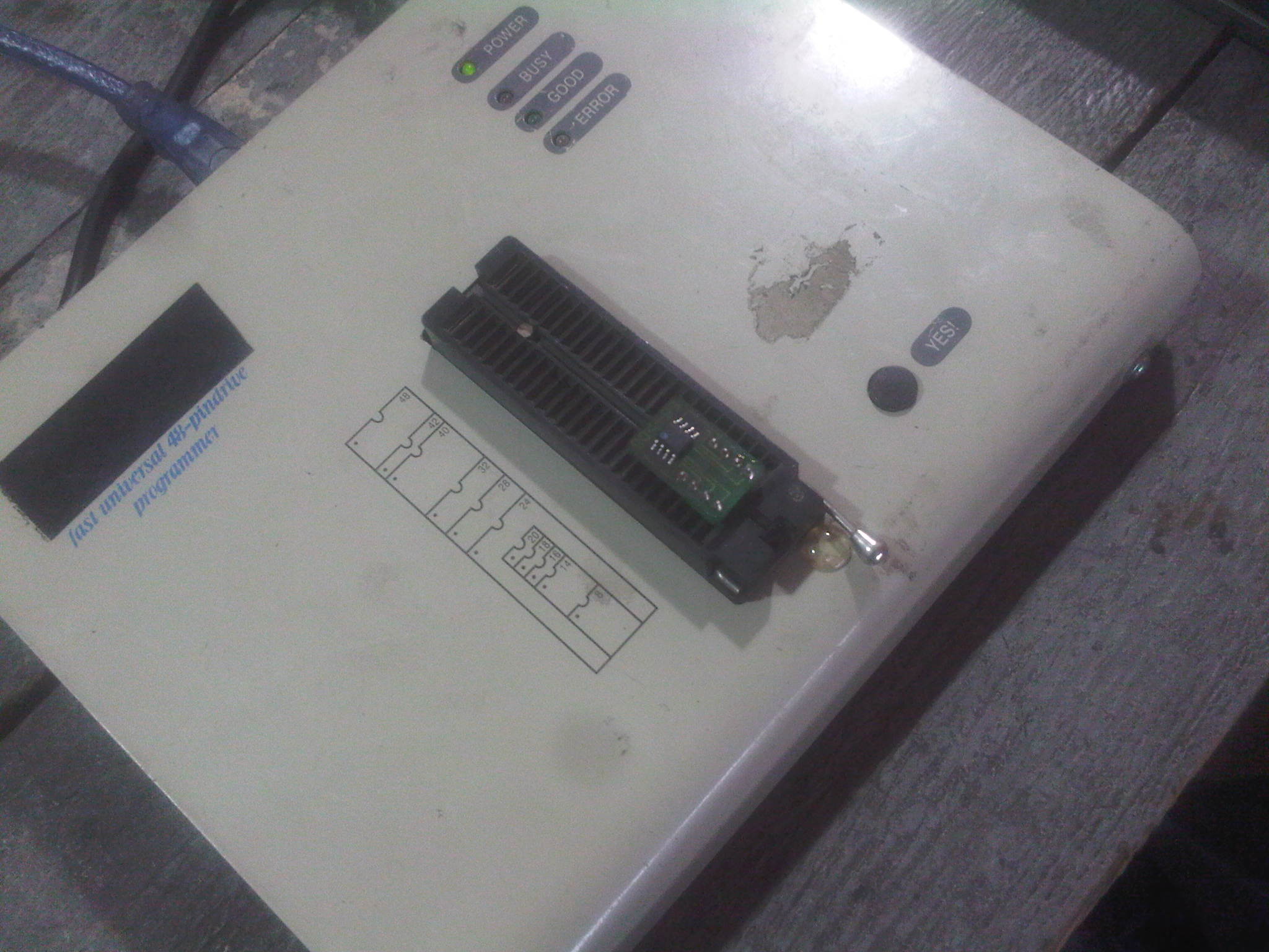

                    • senndogg
                      • Dec 2011
                      • 383
                      • Albania
                      #70
                      Re: LG W2234S Repair Help...
                      Hello people,
                      its been a month i dont enter the forum because of an internet malfunction, and now lets get down to business, seriously!
                      this LG i have was completely dead. no signs of life.
                      measured the voltages. 5V ok. tested with a 2W lamp, ok, no voltage drop.
                      measured the regulators in the main board. 3.3V ok, 1.8V ok.
                      measured the voltage in the power button. 3.3V.
                      at this point i searched THIS forum and heard about the firmware problem.
                      as i dont have much time for the chip to be shipped from china, i found the FW online, and i want to share it with you.
                      went to a friend of mines, who has a ELNEC programmer, and the procedure was routine for him. it took 5 minutes to unsolder it, to test-read it (found it was corrupted), to rewrite the .bin file, and to solder it back.
                      its working great!
                      thank you guys and i am pleased to help!
