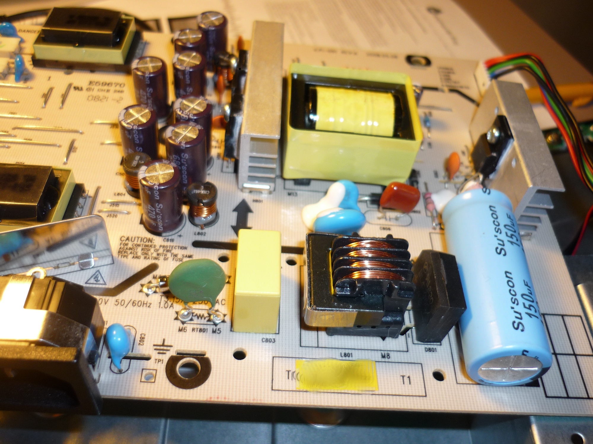

    I have an LG W2234S that isn't working. The screen turns on and shows the LG logo and then about 2 seconds later turns off (black screen, no power LED). Then it turns on again and shows the logo (and power LED is on)... Repeat.
    I've pulled it apart and none of the caps are bulging or leaking. The big filter cap (150uf 450V) only charges to about 160V though... I feel like this could be a problem? I've heard also that the u108 chip (25L1005) on the logic card can get corrupted. I'm not sure this is the issue since it does actually display the LG logo for a few seconds but I could be wrong.
    Any help would be greatly appreciated!

    The symptoms could indicate bad caps, or possibly another problem.

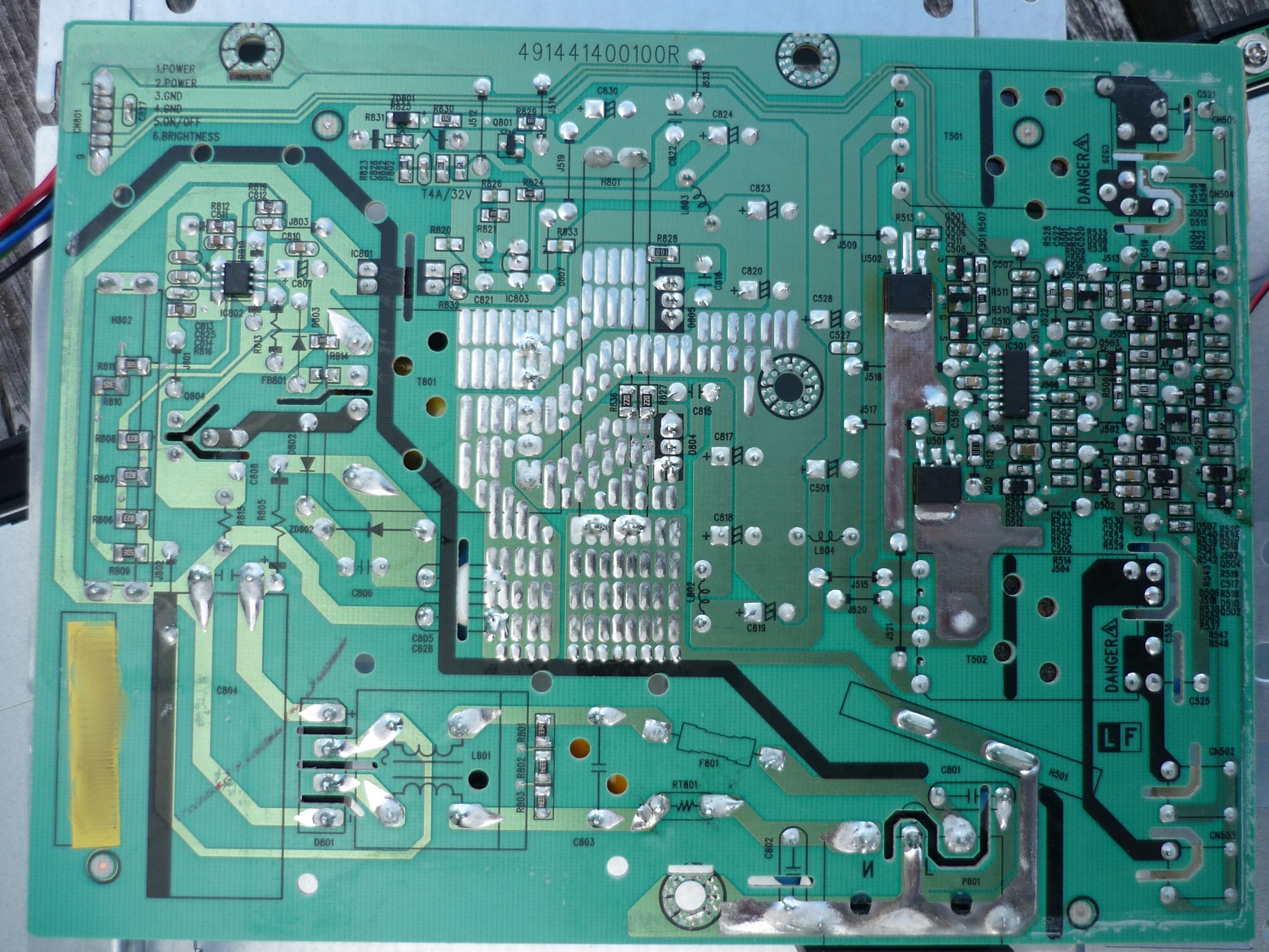

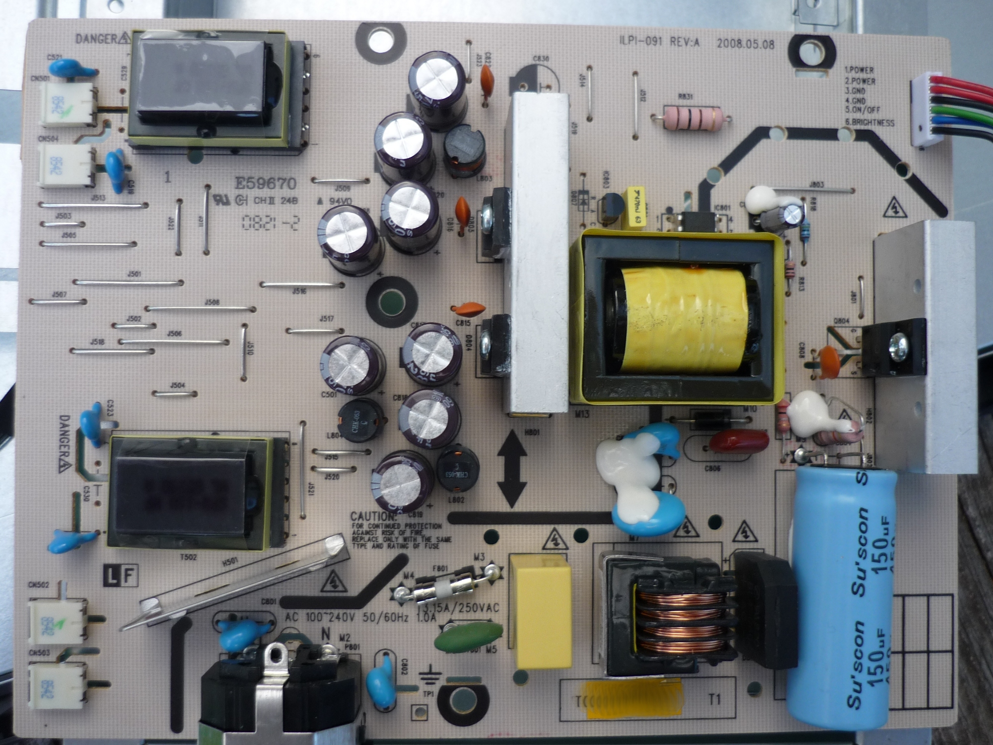

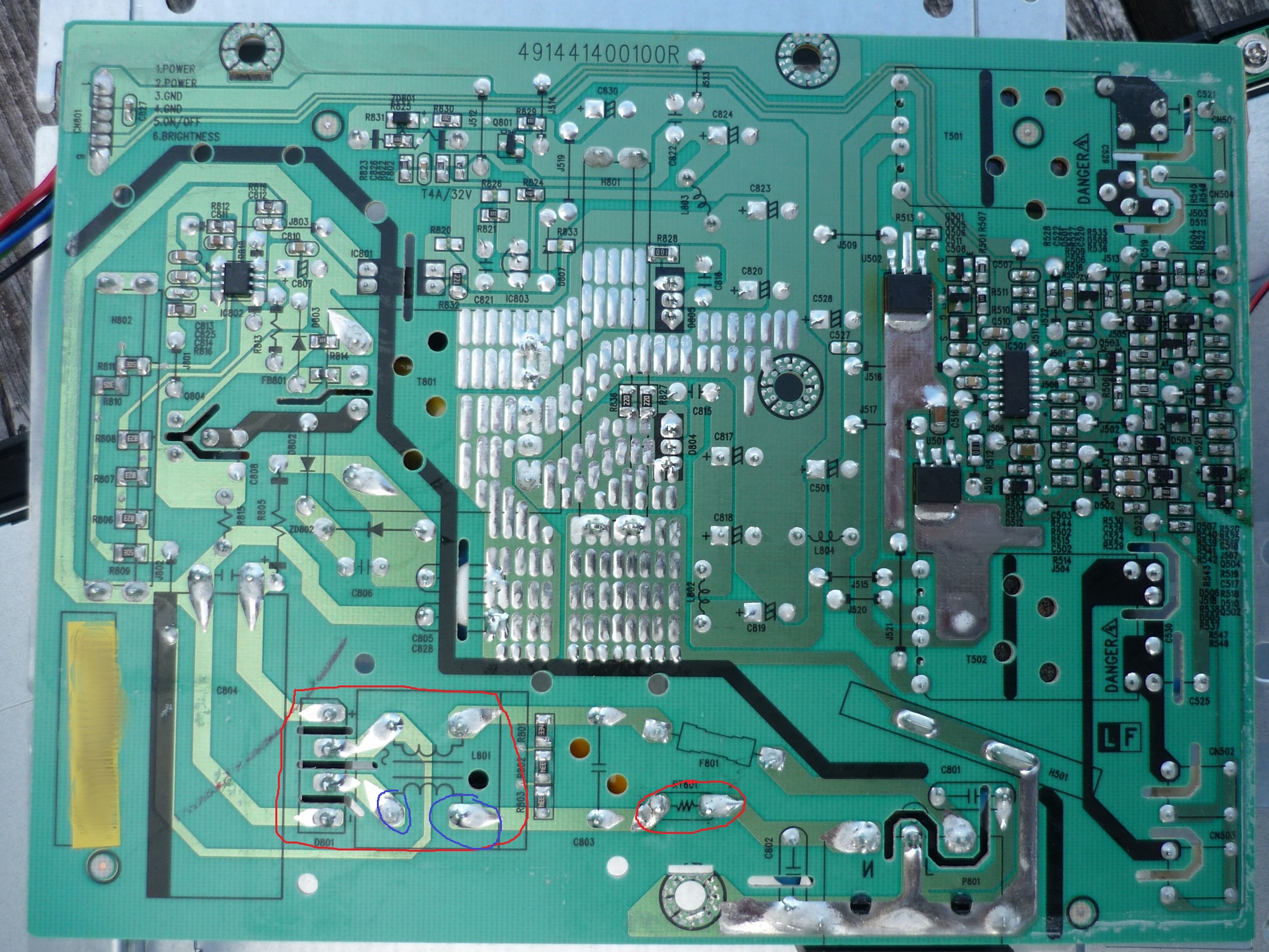

    1. Please provide sharp, well lighted pictures of top and bottom views of the power supply, and a top view of the signal card. Take the pictures from as close to directly over the cards as possible. A resolution as close to 2000 x 2000 is also helpful.
    2. For best results, the test you described above should be done with the monitor hooked to a computer displaying a stable image - a the desktop, for example.
    3. Please confirm that the backlights and power light go off at the same time, and come back on without any action on your part.

      Re: LG W2234S Repair Help...

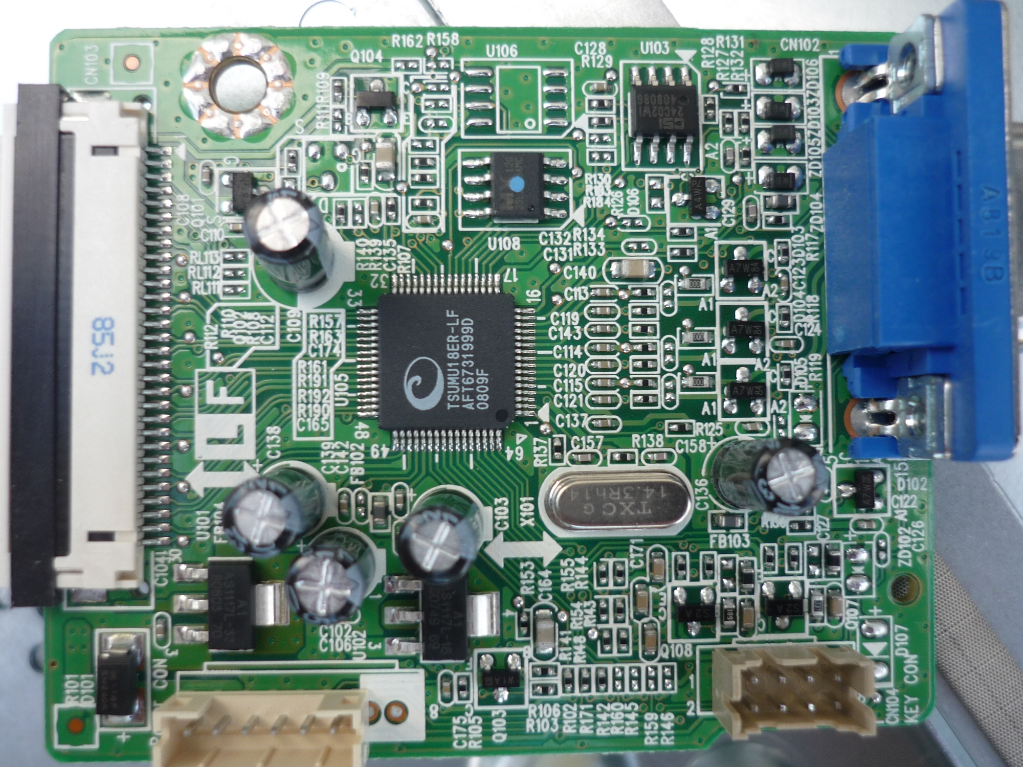

      Thanks for your help! In response to your questions:
      1. See the attached photos.
      2. Unfortunately I can never get to the point where I have a stable image since the monitor is turning on and off every 2 seconds (literally). I did perform the same measurement anyways. When the screen is powered on it measure 148Vdc across the big cap and when it's off it's 157Vdc across that same cap.
      3. The backlight and power LED do infact turn both on and off at the exact same time. The controls are unresponsive during the time that the monitor is on.

            Thanks for confirming that. The 'smoking gun' in this case is the voltage across the large cap. If Charlottetown, PE is tied into the Canadian power grid, you have given a very solid clue as to the problem. The voltage across the large cap should be 1.4 x your AC line voltage, and quite stable whether the monitor is on or off. With the variation you describe, either you have SOMETHING drawing way too much current, a thermistor that is not working, or the main filter cap is bad. Su'scon does not have a good reputation.
            There are a number of ways to test this theory. Choose one or more of the following methods.
            1. Disconnect the signal card from the power supply. Measure the voltage across the large cap. It should be VERY close to the 1.4 x line voltage figure (for 120 VAC the figure is 167 volts), and stable. If it is much lower, CAREFULLY run your hands near the board, looking for a source of heat. Do NOT touch any heat sinks!!!
            2. With everything hooked together and the monitor plugged in and flashing on and off, short across the thermistor. That is the green device just below the fuse. Since I'm asking you to do this while power is on, I'm also asking you to be very careful. If you elect not to try this, I understand.
            3. If you have access to a capacitor rated at at least 200 volts, and 100uF, wire it in parallel with the existing cap. If the flashing stops, that virtually proves the theory.
            4. Buy or borrow an automotive tail light. My favorite is the 1157 dual filament bulb. With the power supply / inverter disconnected from the signal board, temporarily hook it across C819. Check the voltage across the main filter cap.

              • alexanna
                • Mar 2010
                • 1346
                Wile you are wating for some more sugestions.Try reflowing solder in the red and blue circled areas.

                      165.6V is the calculation I get.
                      When I resoldered those points the voltage went up to 161.5V(max).
