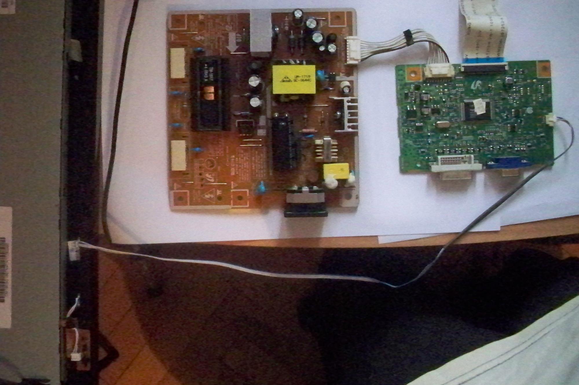

                      Here are some pics. First is the whole assembly ip board -> main board -> function PCB/power button. The following are the ip board, main board and function pcb with measurements done as Glennjamin did. Last is with the bad caps I replaced.

                        I'm not sure what the problem is.You have established that the LDO regulators are working properly. There are three 8 pin ICs, one has write enable held off, that would be the program memory, so the chances it is corrupt are greatly reduced. The is no reset controller, so we can eliminate that possibility. Remember that the power LED is controlled by the GPU.
                        The best advice I have at this point is trying to reinitialize the monitor. I haven't found any information for this monitor, but the process goes something like this. Unplug the monitor, hold down several of the control buttons (I don't know which ones) plug in AC power, wait 3 seconds and release the buttons. Most monitors have 5 buttons - that yields 31 possible combinations.

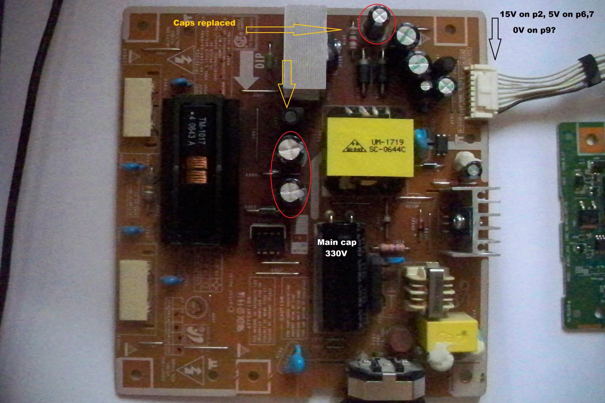

                            One thing though, the service manual (pdf 7) says I should have 5V on the 9th pin on the ip board -> logic board connectors, yet somewhere else it says that 0V should be for the ON status. I have 0V as well, (though as I mentioned, I do have 15V on pin 2 and 5V on pin 6 and 7). Would this be an issue?

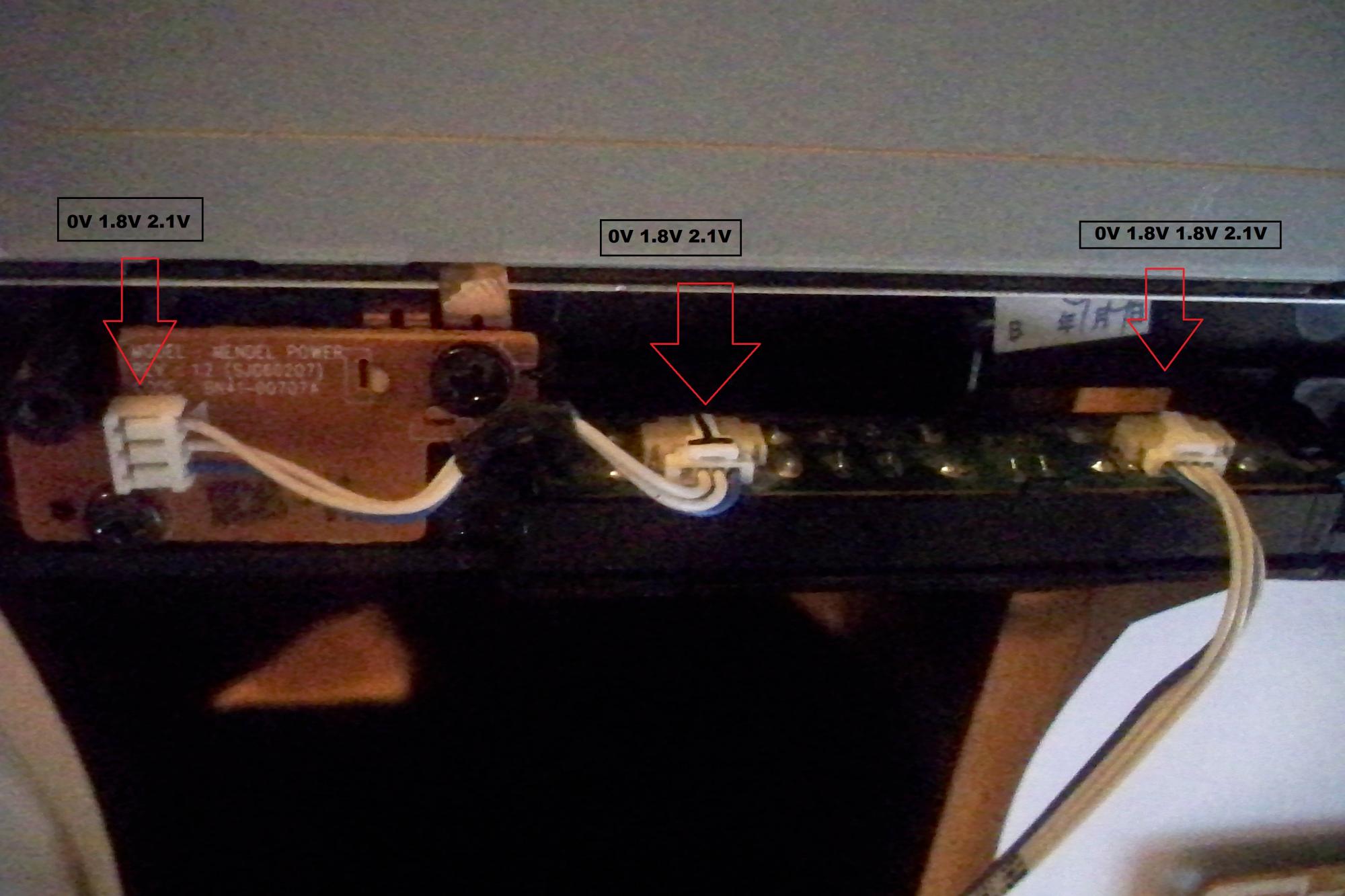

                                    After a bit more testing, the 5V on pin 6&7 and 15V on pin 2 are solid (no fluctuations). On pin 9 there's 0.141V constantly. Next to it it says On/Off, and the manual says that On is 0V (but as I mentioned, it says that during testing it should be 5V).

                                      I suspect a misprint in the manual,Usually at least all I have noticed the on/off voltage 3 volts or higher when the logic board requests back lights.
                                      Would you mind re-testing the voltage regulators,they can cause problems. And they must be within 1% of the rated specification.

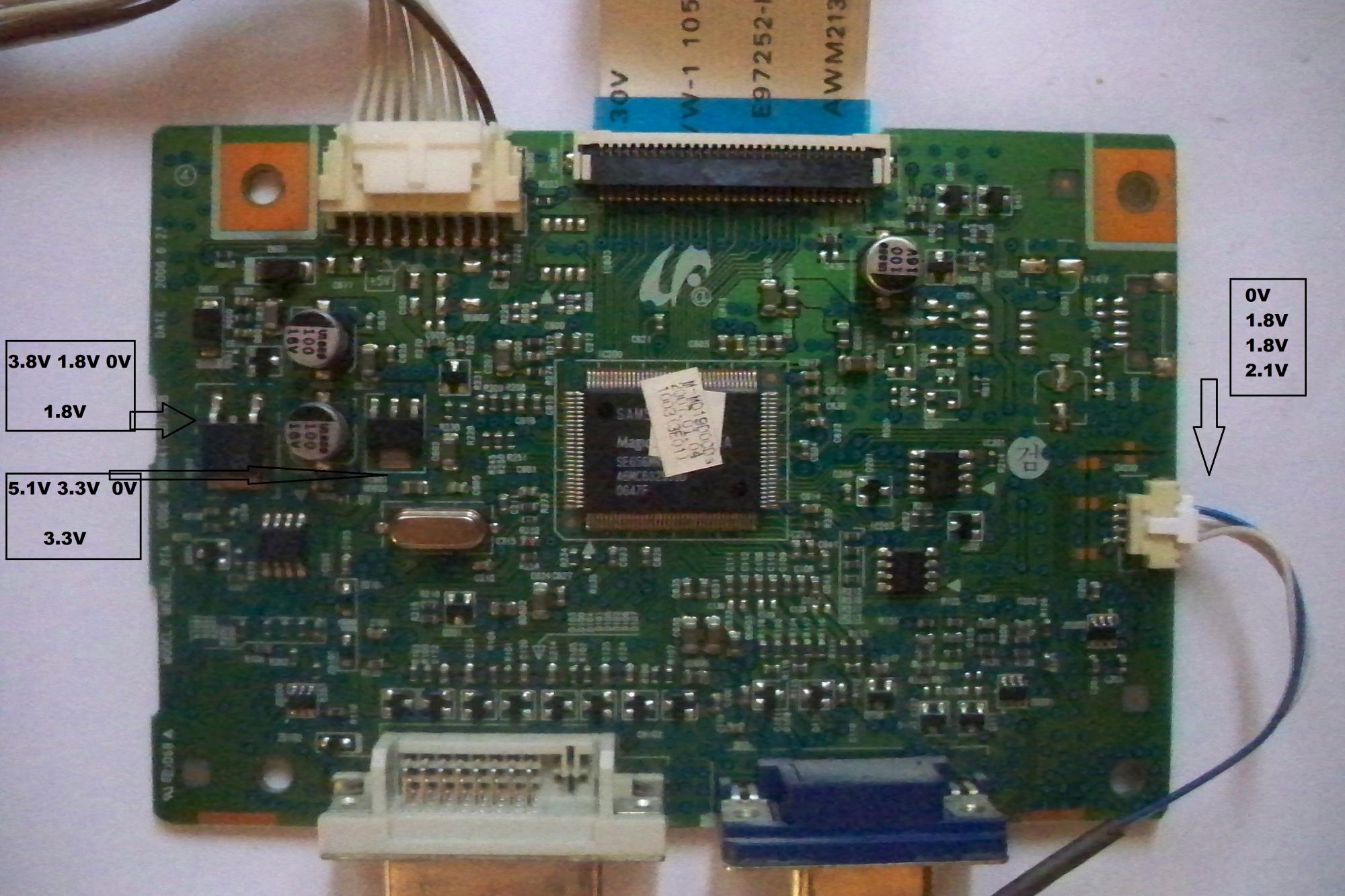

                                        As seen in the picture (from left to right):
                                        IC602: 3.8V 1.8V 0V and 1.8V on the bottom
                                        IC601: 5.15V 3.3V 0V and 3.3V on the bottom

                                          Those voltages are some common voltages we see.
                                          One thing to think about the flow chart you're looking at is for no power, you actually have power.
                                          The front power LED is not turning on and 0 volts on the Back light on pin indicates that the logic board is not asking for back lights to be on.
                                          One other simple test would be to verify that on/off pin on the front panel switch changes state as the power button is pushed. Usually this starts out as a high voltage and goes low when the power button is pushed.
