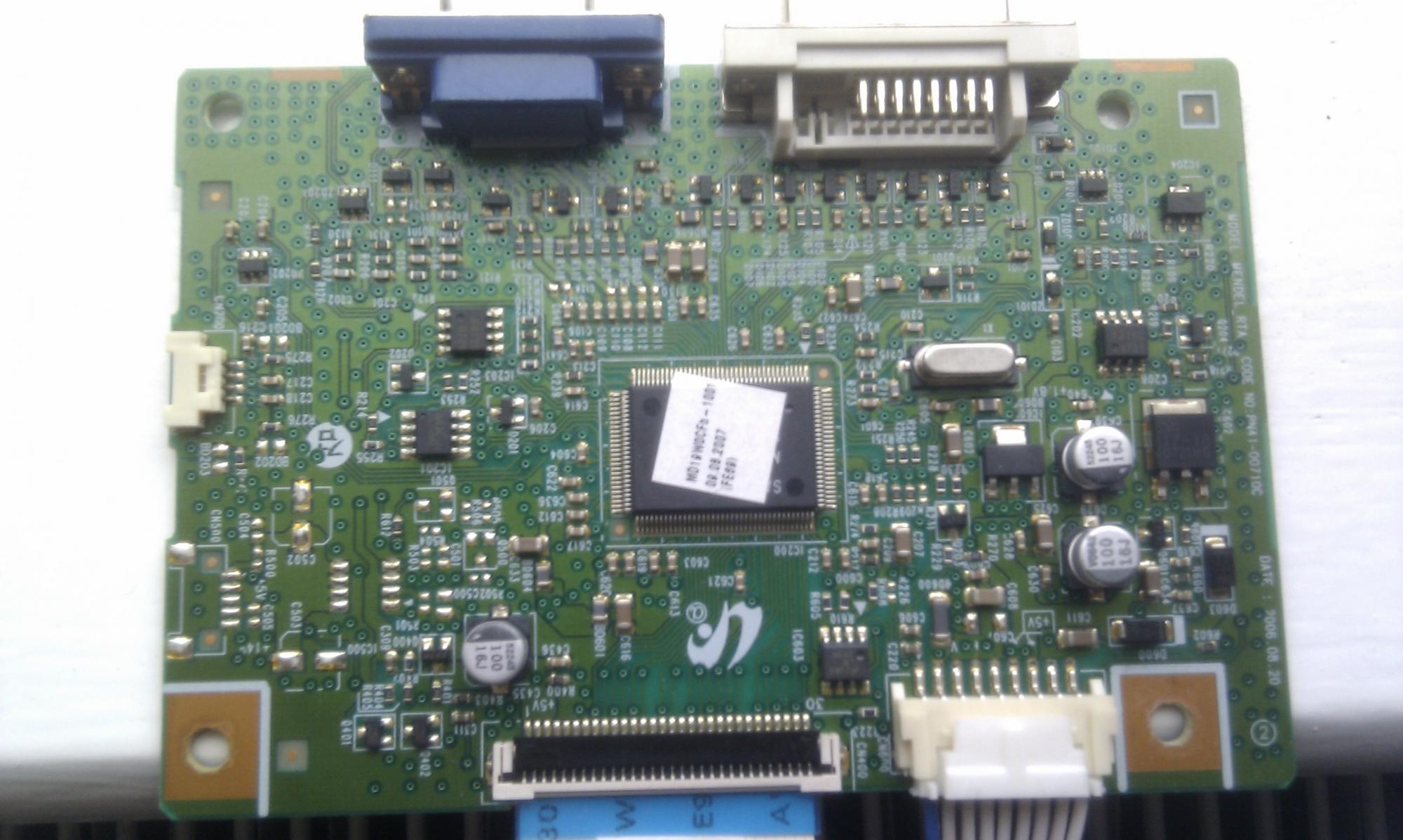

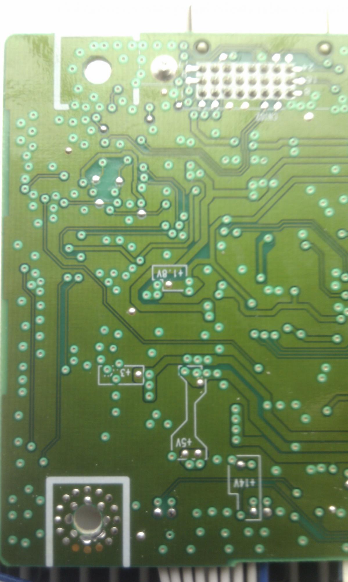

        • Glennjamin
          • Oct 2010
          • 16

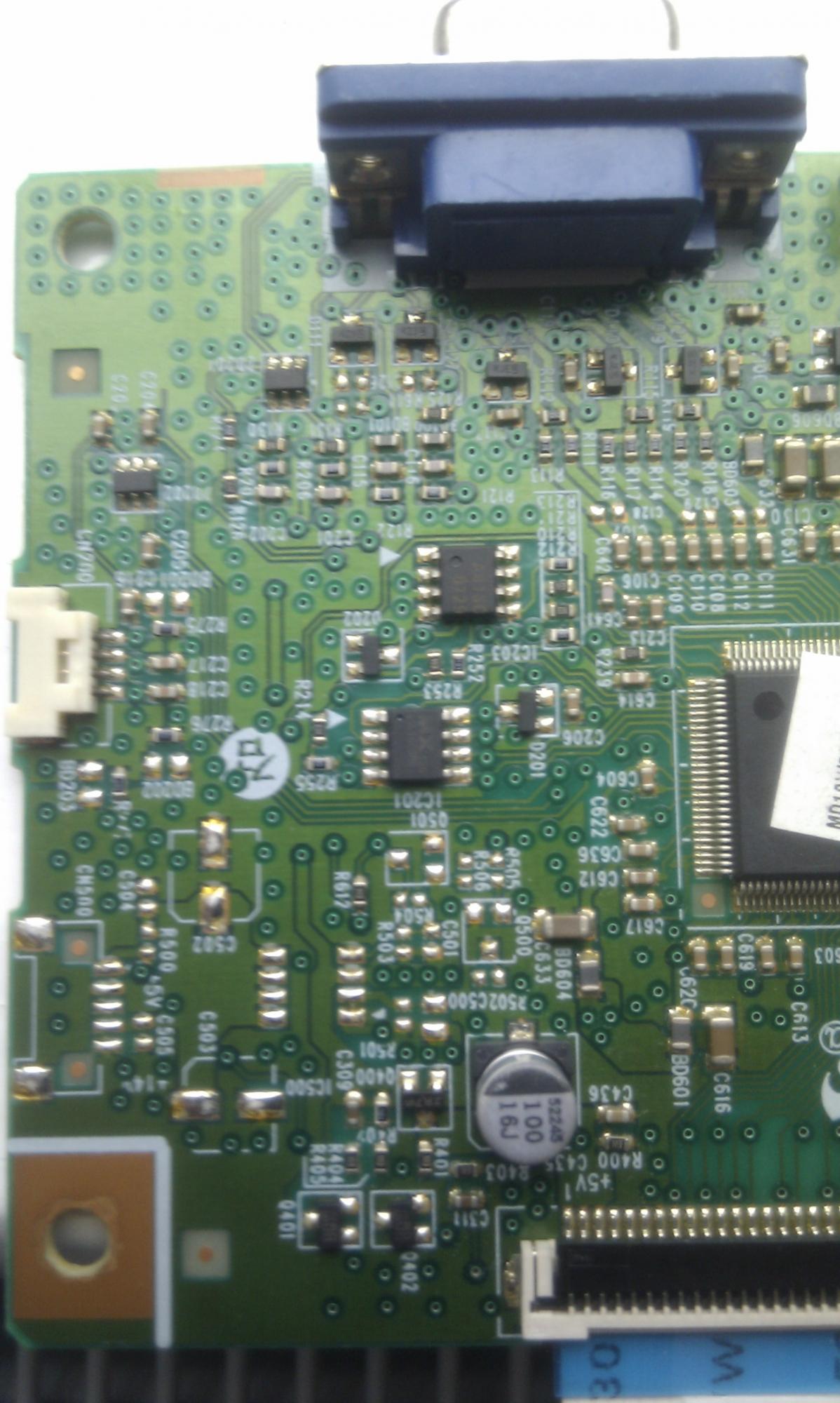

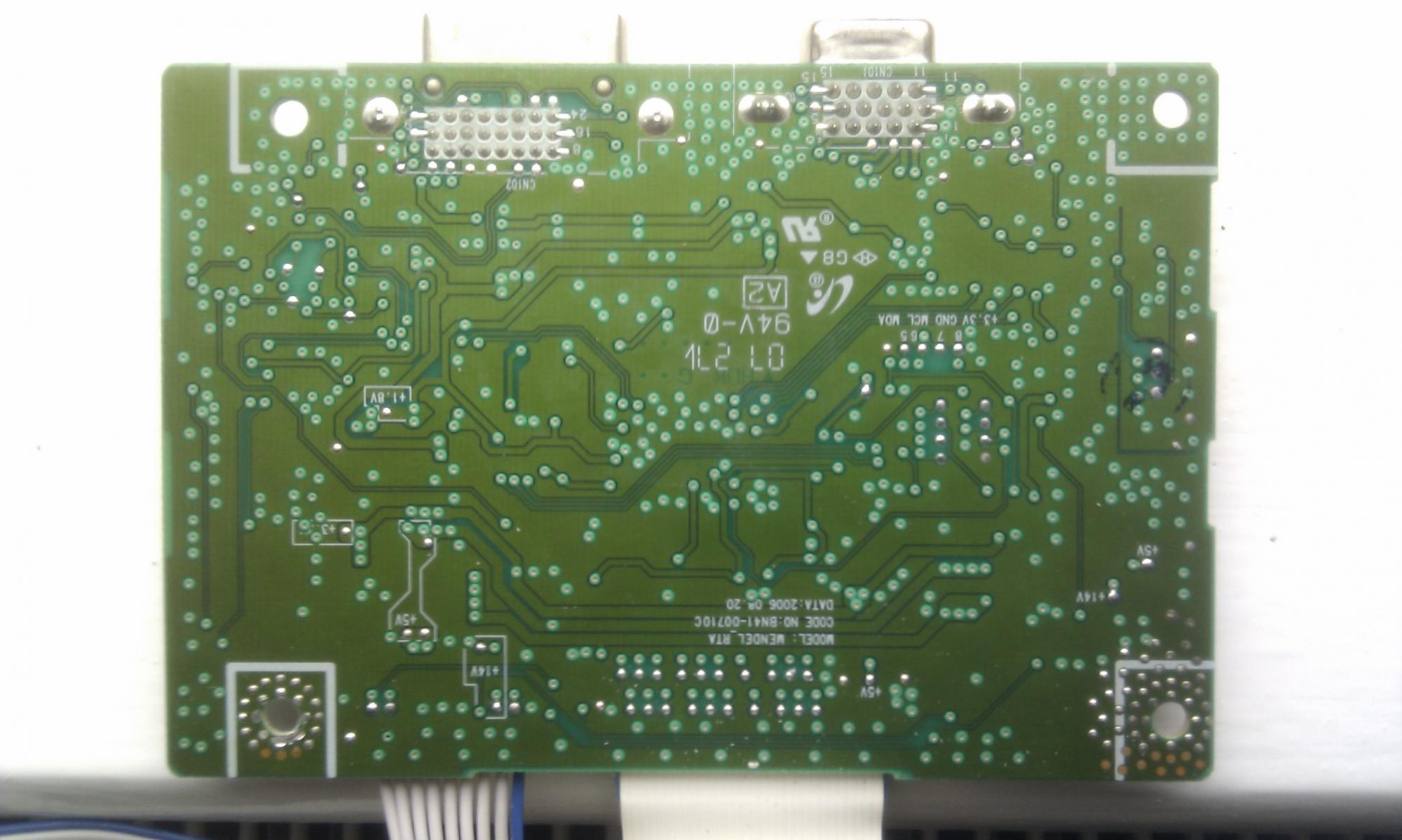

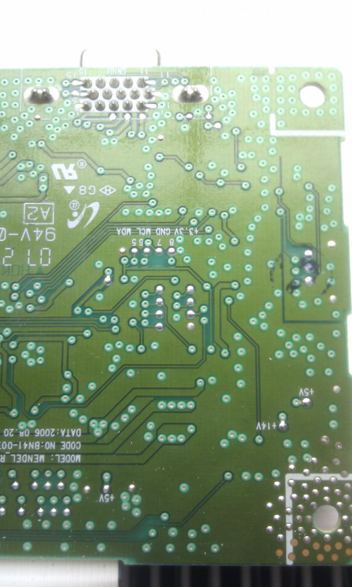

          Re: Samsung Syncmaster 931BW - No Power
          Logic board pictures -
          1. Full front
          2. Full back
          3 & 4. Close halves of front
          5 & 6. Close halves of back
          • jetadm123
            • 2169

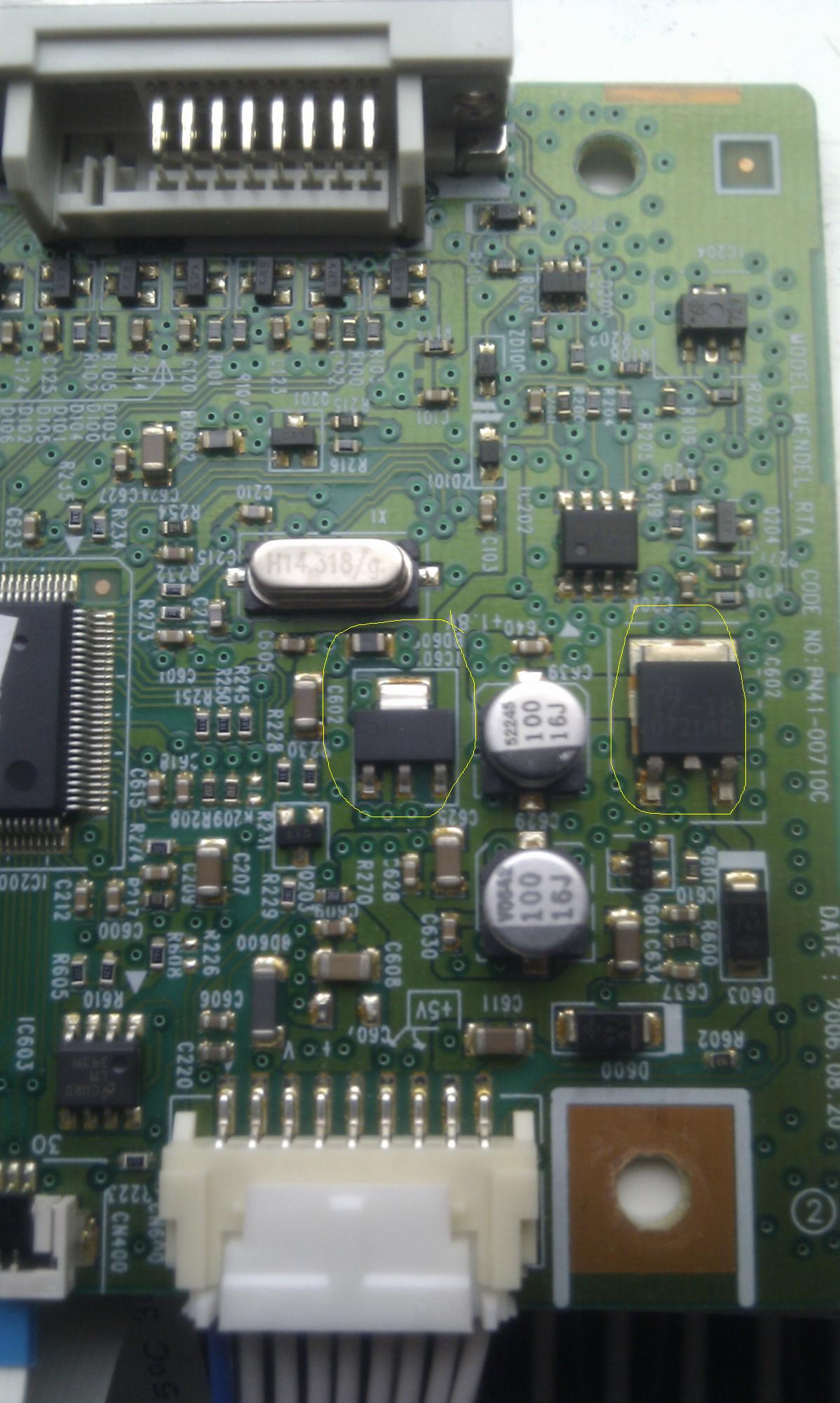

            At this point, I would suggest measuring the output of the voltage regulators circled in yellow. Measure and report voltage at each leg and metal tab (at the top of each regulator). Also, please include the part number off of each regulator.
            • Glennjamin
              • Oct 2010
              • 16
              How would do that with my DMM, I'm still quite the novice 25 posts later this thread sorry! On 20VDC and the black & red probe on which points exactly? Thanks.
              • jetadm123
                • 2169
                20VDC setting is good. Neg (black) probe on one of the screws holding down the logic board. Pos (red) probe on each leg and tab as requested.
                • Glennjamin
                  • Oct 2010
                  • 16

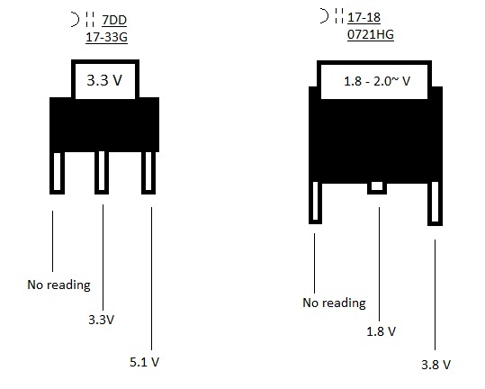

                  Thanks for clarifying, I've attached a picture illustrating the values of the two regulators and their part numbers above each.
                  • jetadm123
                    • 2169
                    #29
                    The outputs look good for both regulators. The input voltage for the right side regulator seems a bit odd at 3.8V. Not sure if there's a short somewhere dragging down that voltage. Try measuring the input voltage of the right side regulator again. This time place the neg probe on the left leg and the red probe on the right leg.

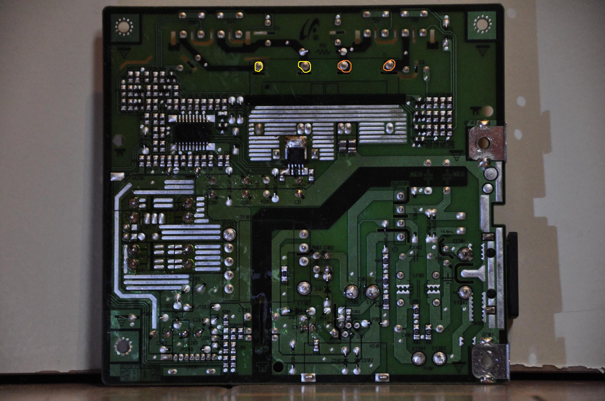

                              Dear all,
                              I did a complete recap (except main 450V cap) and the symptoms remains the same.
                              As before, the backlight functions one second and then shuts down. It never switch on again (unless I push on / off button). So there is no retry after a timer.
                              Have you got any idea of what it could be ?
                              Thanks,
                              renArD
                              PS : Let me just correct something I said : there are no 30V bursts on the 15V line, it is my voltmeter failure (curious).

                                I've marked up the picture you supplied of the power supply bottom. Note there are two pins circled in orange, and two circled in yellow.
                                Set your DMM on the 2000 (2K) Ohms range. Measure the resistance between the pins circle in orange. Report that. Measure the resistance between the two points circled in yellow. Report that. If the two numbers match to within 3%, the transformer is probably good.
