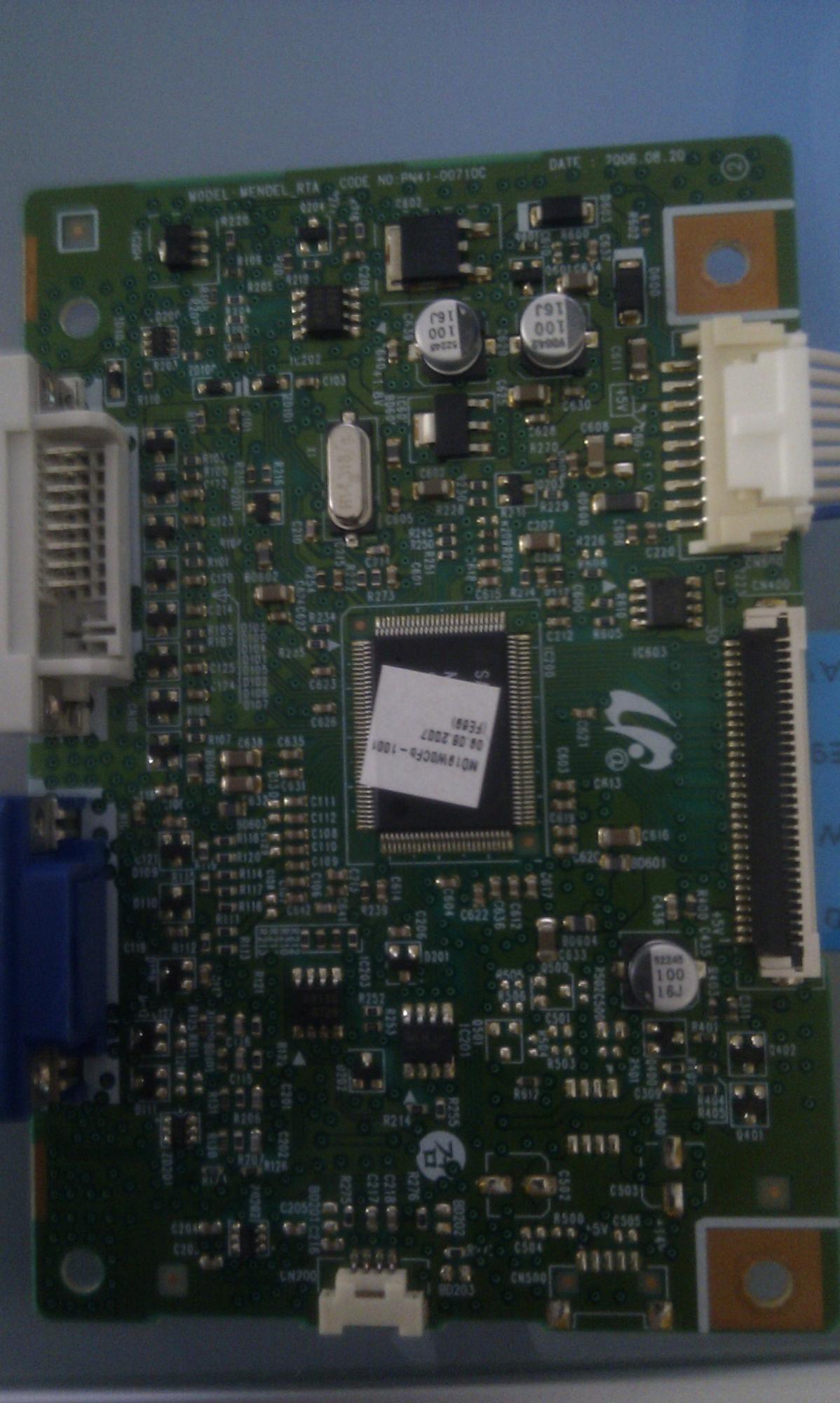

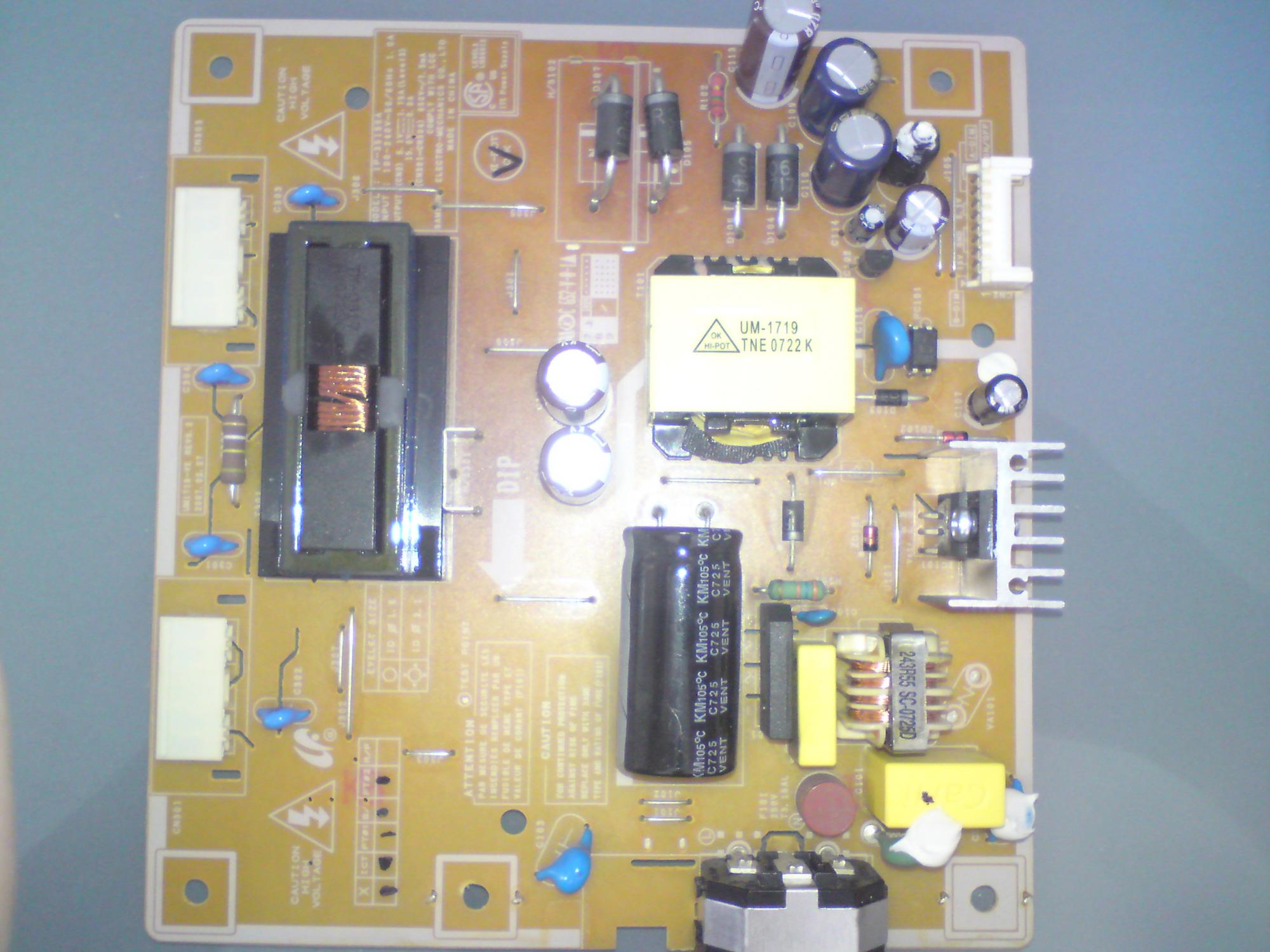

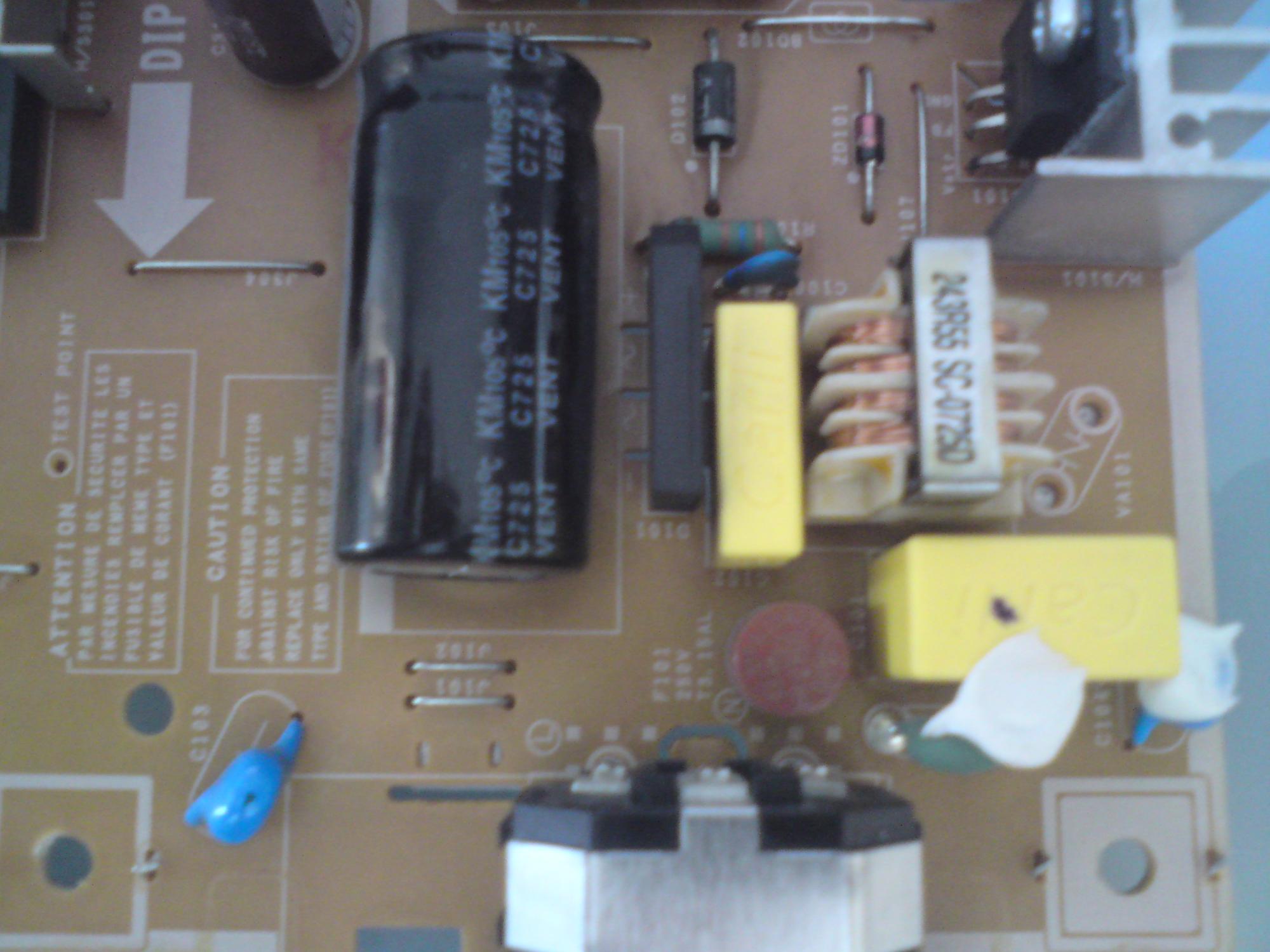

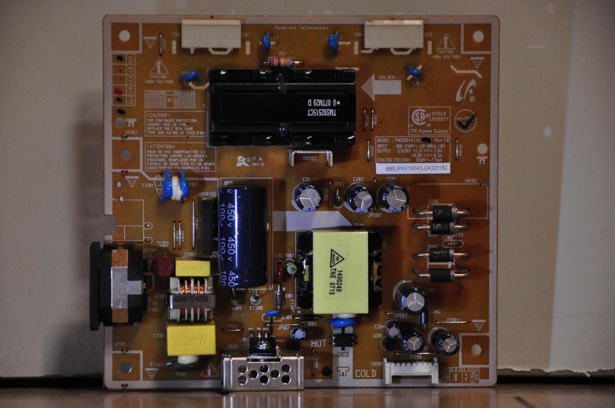

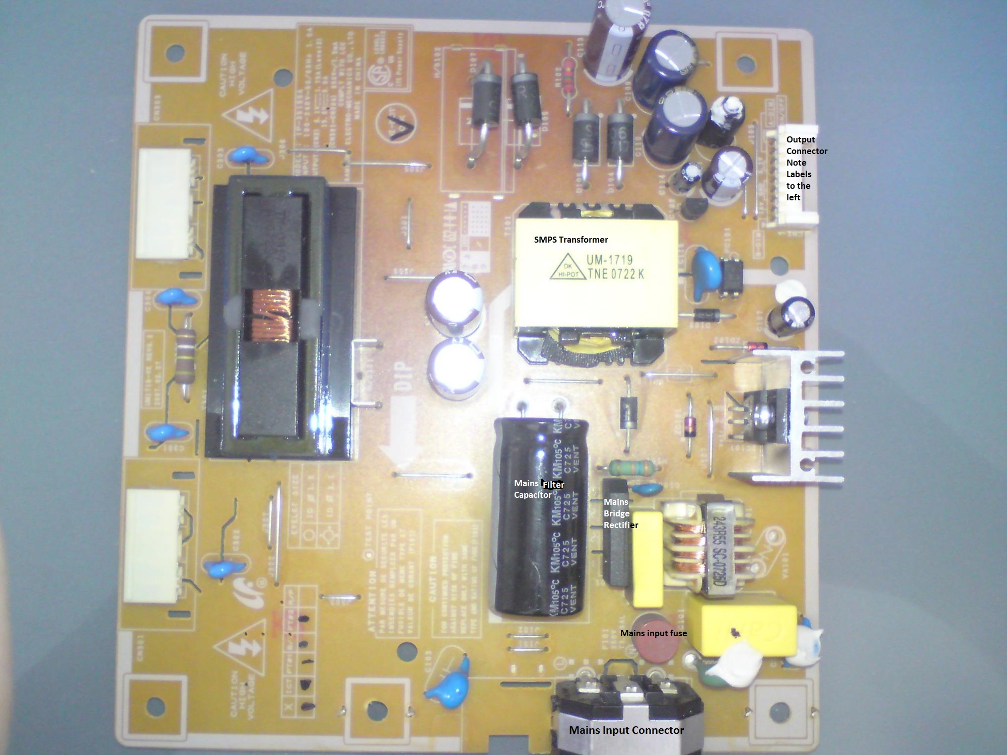

        Re: Samsung Syncmaster 931BW - No Power
        Thanks for the replies, pictures attached below (overall image of power board, then two closer pictures).
        I live in London in the United Kingdom, PlainBill. Wikipedia says it's 230V here. Is that right?
        1. This this the brown cylindrical component next to the mains adapter?
        2. I see the mounting screw, but there seems to only be one power output (the white plug, top right corner of pic), is this OK?
        Much of this is new to me but I'm enjoying learning, please bare with me!
          Oh, this is going to be a training session. Maybe I should bookmark this...
          I've labeled a few of the components. The part you had mentioned is the mains input fuse. Hint: There is a system for component identifiers. C101 would be a capacitor, F101 would be a fuse, D is for diode, T is for transformer, CN denotes a connector, R is for resistor, and Q is for Transistor.
          The first step would be to set the DMM to the 1000 VDC range and carefully measure the voltage across the leads of the Mains Filter Capacitor. This should be about 320 volts, so be careful. A voltage 10-20 volts higher or lower does not represent a problem, a voltage of less than 10 volts indicates the fuse has blow or the power cord is not plugged in. Report those results
          If you measured the proper voltage, reset the DMM to 20VDC. If you notice the output connector, the function of each of the pins is identified. Hold the black lead on one of the pins labeled GND and measure the voltage on the pins labeled (I think) 5.2V and 15V. Report those results.

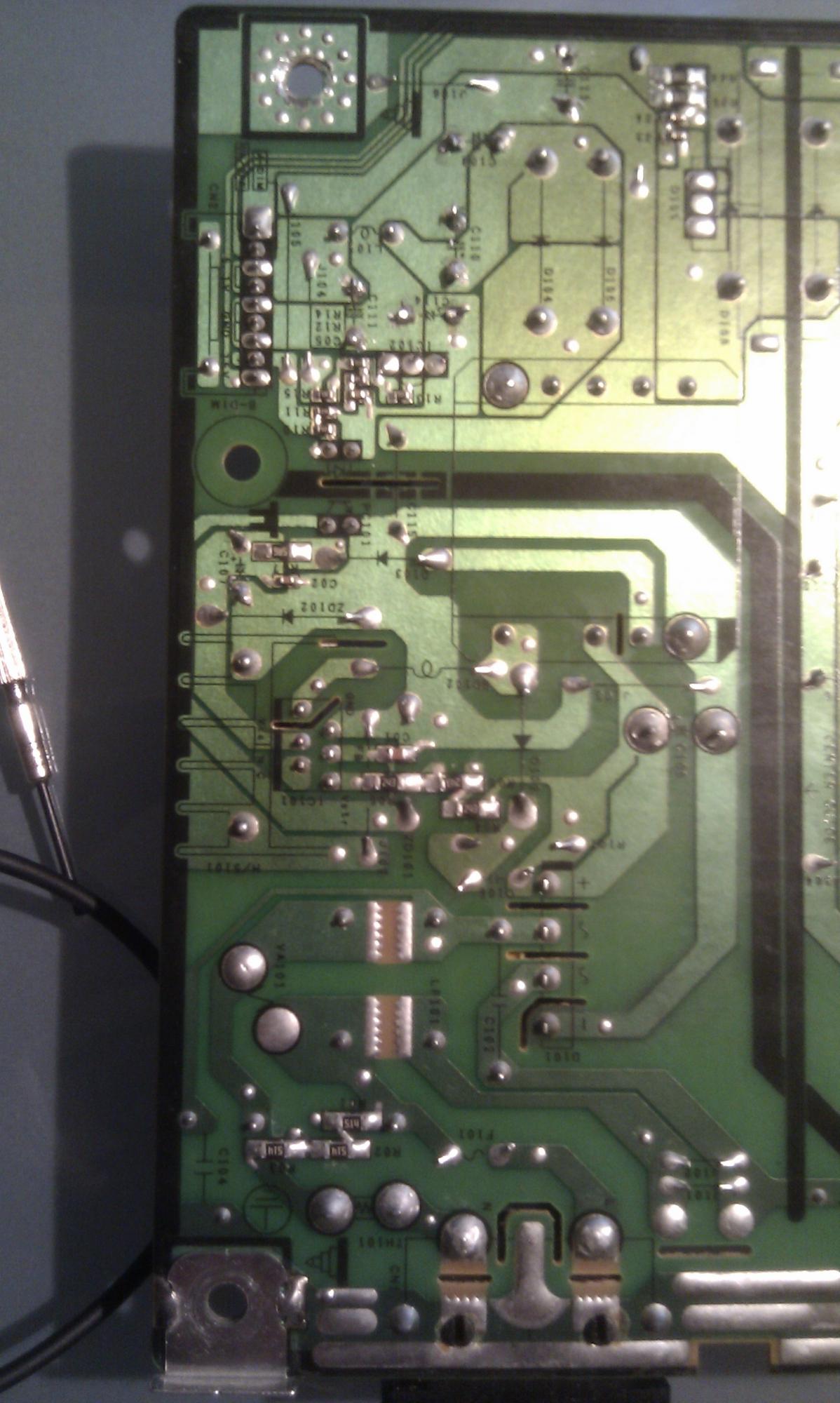

                  That's good, it tells us that the power supply is the problem. We can fix most things that go wrong with a power supply. Fixing the signal card can be much harder.

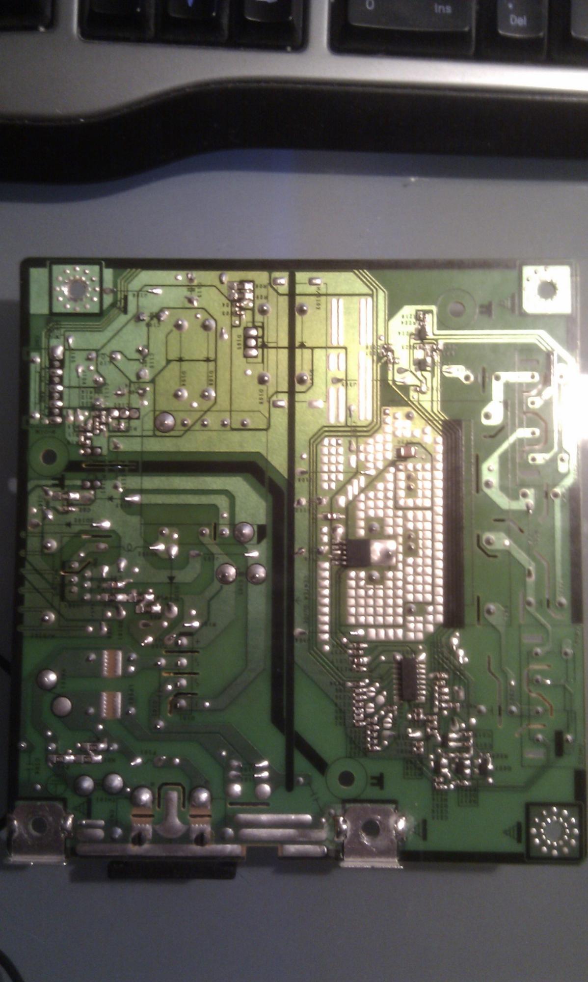

                  Your next mission is to take a picture of the back of the power supply. When you take the picture, make sure the mains power connector is closest to you, just like the picture of the top. That makes tracing signals easiest. Also, what is the part number of IC101 (it's attached to the heat sink).

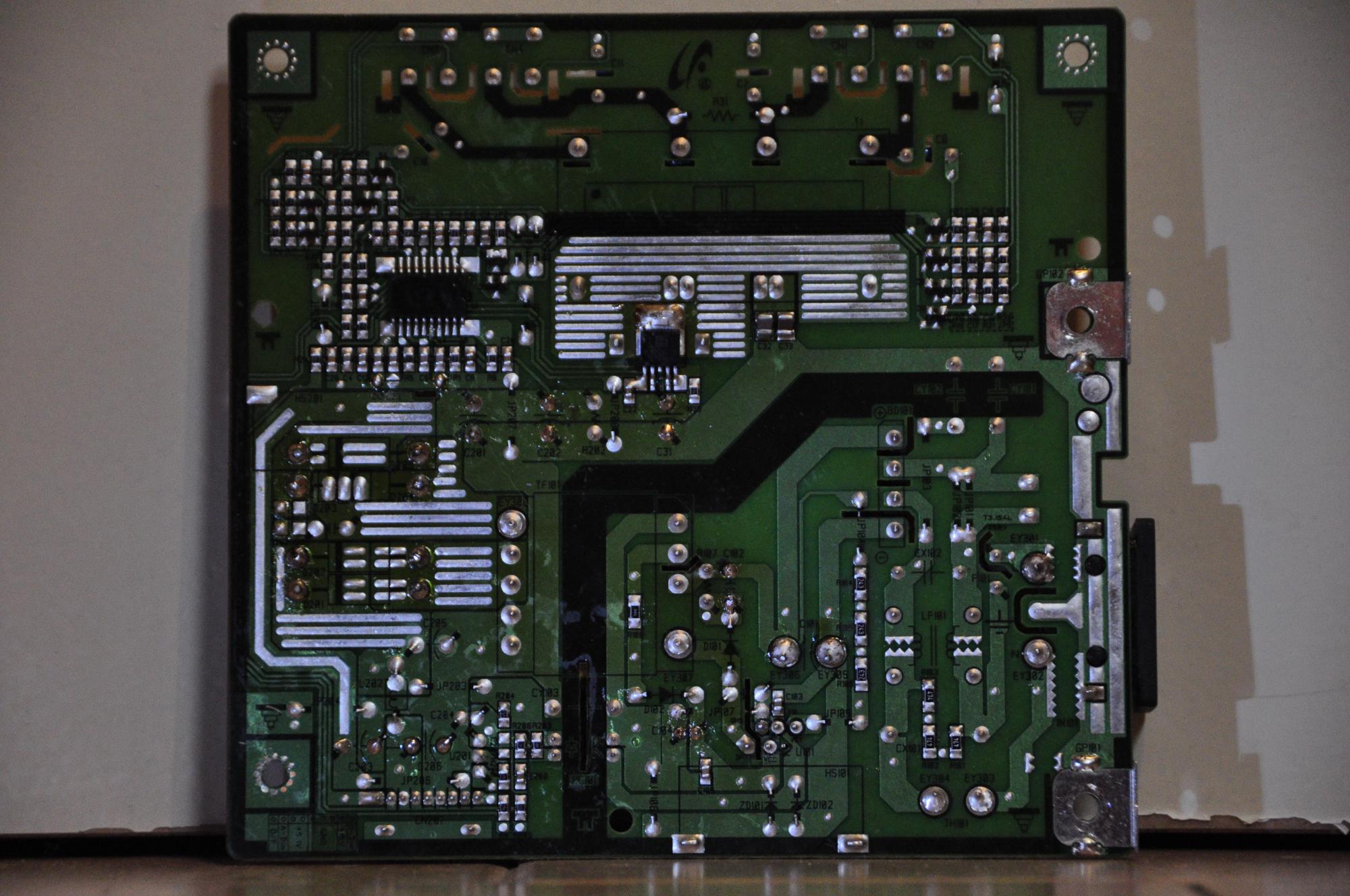

                    Pictures attached, did my best with artificial light as it's quite late here now. I hope you can make them out otherwise I will do them again in the morning.
                    RE: IC101, the writing on the side of it is as follows -
                    F DH15
                    E
                    DM0465R

                      Bingo!!! FSDM0465RB is a Fairchild Power Switch integrated SMPS controller and power FET. The datasheet is here. Use the datasheet to identify the pin numbering scheme, then CAREFULLY measure the voltage from pin 2 to pin 3.

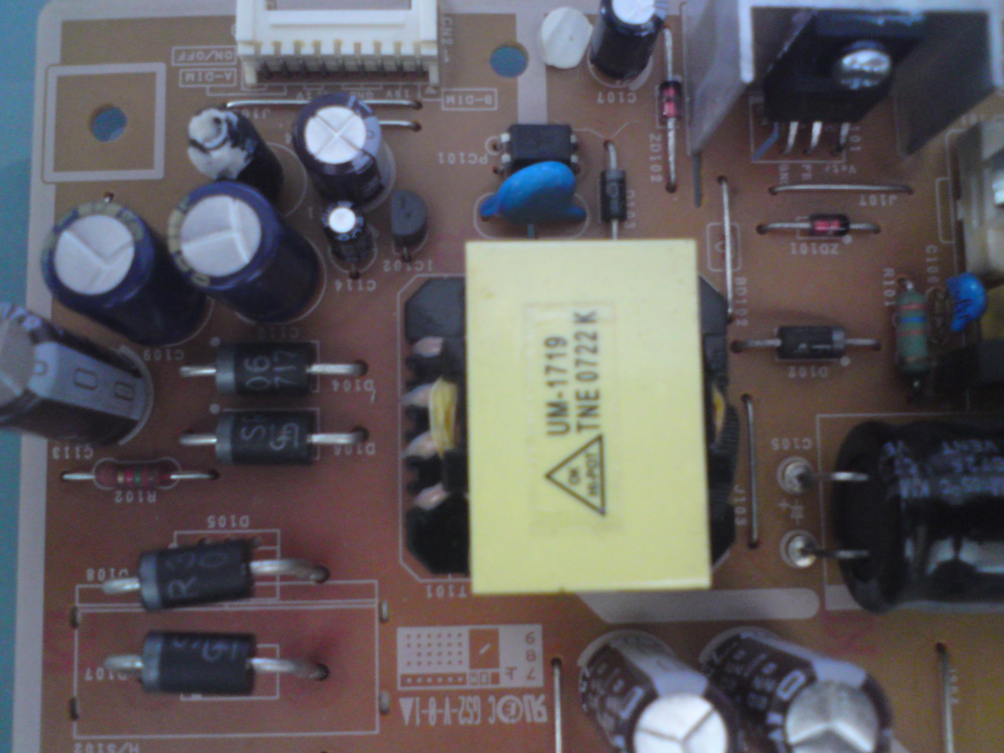

                                        If it can help anyone :
                                        - I upload two photos of the version I have
                                        - This version of the board (PWI1904SJ A Rev 1.0) seems to be also used in the Samsung Syncmaster 940NW.
                                        - Here is the list of the original caps :
                                        * "100uF 450V" for C101
                                        * 3x "470uF 25V 105°C brand JH" for C31, C202, C201
                                        * "1000uF 16V 105°C brand JH" for C205
                                        * 2x "330uF 25V 105°C brand JH" for C203, C206
                                        * "1uF 50V 105°C brand JH" for C204
                                        Regards
