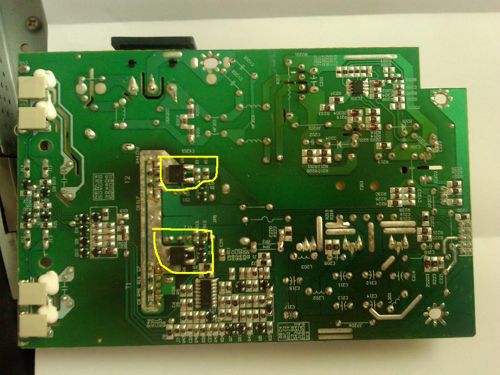

    Hi have this board which appears to be earthing out on the 5v rail .
    All caps have been changed ( FCs and low esr hitano).
    Both shottky diodes renewed ( D205 and D206).
    power mosfets are new ,bridge rectifier ok ,main cap showing 339v.
    14v rail not earthing so ok not sure where to check next .
    Originaly the outputs showed 22v on the 14v and 8v on the 5v, after i had replaced all the parts it blew the R217 resistor (0.33 2watt)
    so have now changed that too.
    I dont want to power it up when i am getting continuity on the 5v so unless
    i am wrong and it should be that way .
    Any input would be great

    The Source Resitor R217 burning out, would make me immediately look at the Mosfet again(even if it was new),also as you have changed lots of parts, then solder bridges may have inadvertantly occured,also all the caps the right way around ?? I have messed that up before.

      All caps are right and have checked for bridges these were the first things i did (messed up too before )
      I will retest the mosfets but am sure these are ok

        Does the replacement for D206 have a metal mounting tab? If yes, then is it properly insulated from the heatsink?

          Both shottky have plastic casings

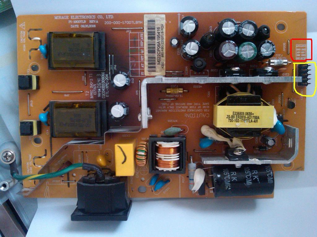

                  Ok breif repair history
                  Board came in with no power most caps bulging so all replaced .
                  Mosfets tested ok but had spares and there were heat marks so changed those for new , transformers tested ok so resoldered .
                  Shottky tested 10100 ok 1060 faulty so changed both (both new).
                  On now tracing the 5v rail i have noticed on the schematic that ZD203 bridges between earth and 5v so i have tested this .
                  Result with analogue meter
                  X1 = open
                  X10 = open
                  X100 = open
                  both ways
                  DMM on diode setting
                  reading both ways down to zero
                  So i am assuming that this is where the problem lies .
                  I am going to remove it and check the 5v pin but the only replacement i can get (6v2) are axial ones ,can get smd type if i want to buy 5oo and wait 2 to 3 weeks
                  Axial should be ok or should i wait for surface ones and have a serious excessany thoughts ?

                    Just use a regular axial zener diode. Makes sense that the zener shorted if something on that rail went terribly wrong. It's just that they insist not using them anymore (of course, so that more expensive components blow when the power supply acts up), so i didn't think of that.

                        The zener is there to protect the rest of the parts if the power supply goes awry. It does not do anything during normal operation. Since it's job is to short out and shut down the power supply, use a 1.3W diode. A half watt one may simply melt and allow the power supply to do further damage.

                                        On the schematic in post #1 of this thread, there's a zener diode (ZD203) across the 5V output. Try checking it for a short.
