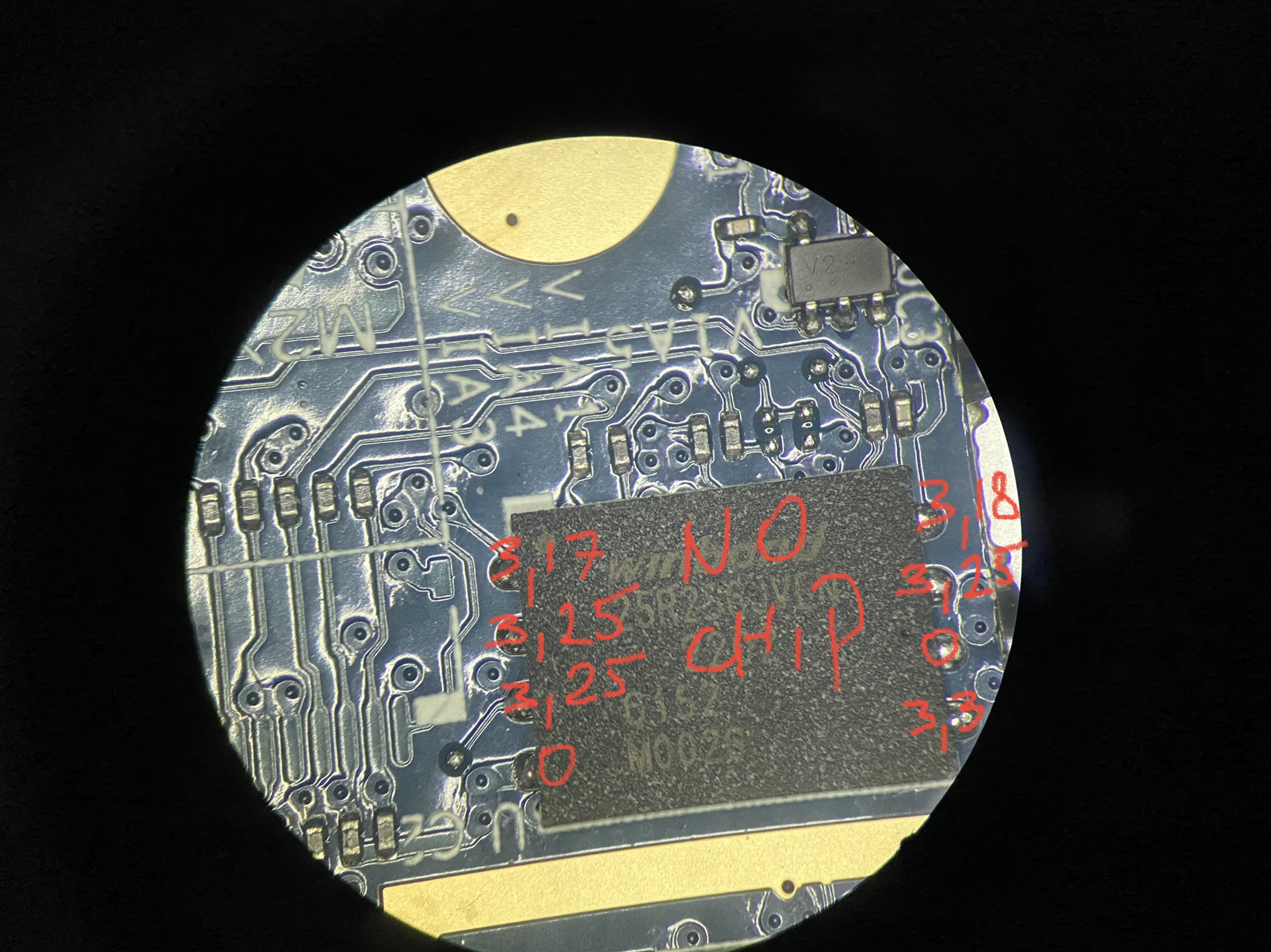

    Hi there,
    I got 2 Dell laptops with a locked bios (dell management protection).
    When I sent the dumps to this forum I got unlocked .bin files.
    The issue I am getting the voltage on the bios chip pins has changed once I soldered the chip back (with the unlocked even original bios file) and doesn't turn on anymore.
    Before I started to re-program the chip the voltage on the pins were 3.3V almost on each pin. Once I soldered the chip, voltage changed to 1.9V or 1.3V on few pins. No 3.3V anymore.
    I appreciate any help to get me this laptops back to life and return to customers.
    THANKS.

    Re: Dell Latitude 7420, 7320 voltage changed
    remove the bios chip and measure voltage on the remaining pads again to see if 3.3v is there.
      Yes. The 3.3V is present on the pins when no chip is present.

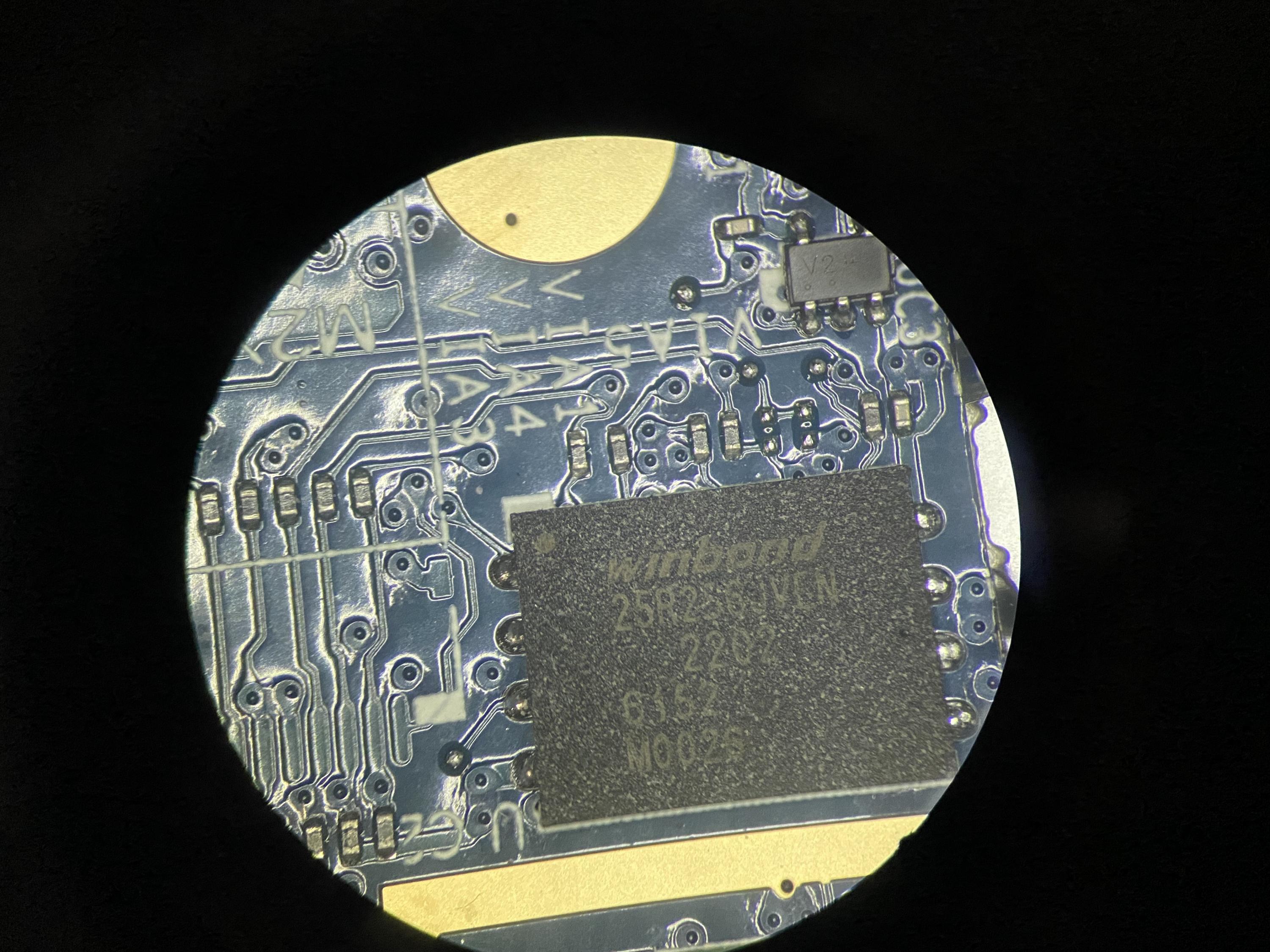

        Are you soldering the bios chip in correctly or is it upside down?
        Post a clear pic of the soldered bios chip.
        Confirm that pin #1 on the IC matches pin #1 of the logic board.

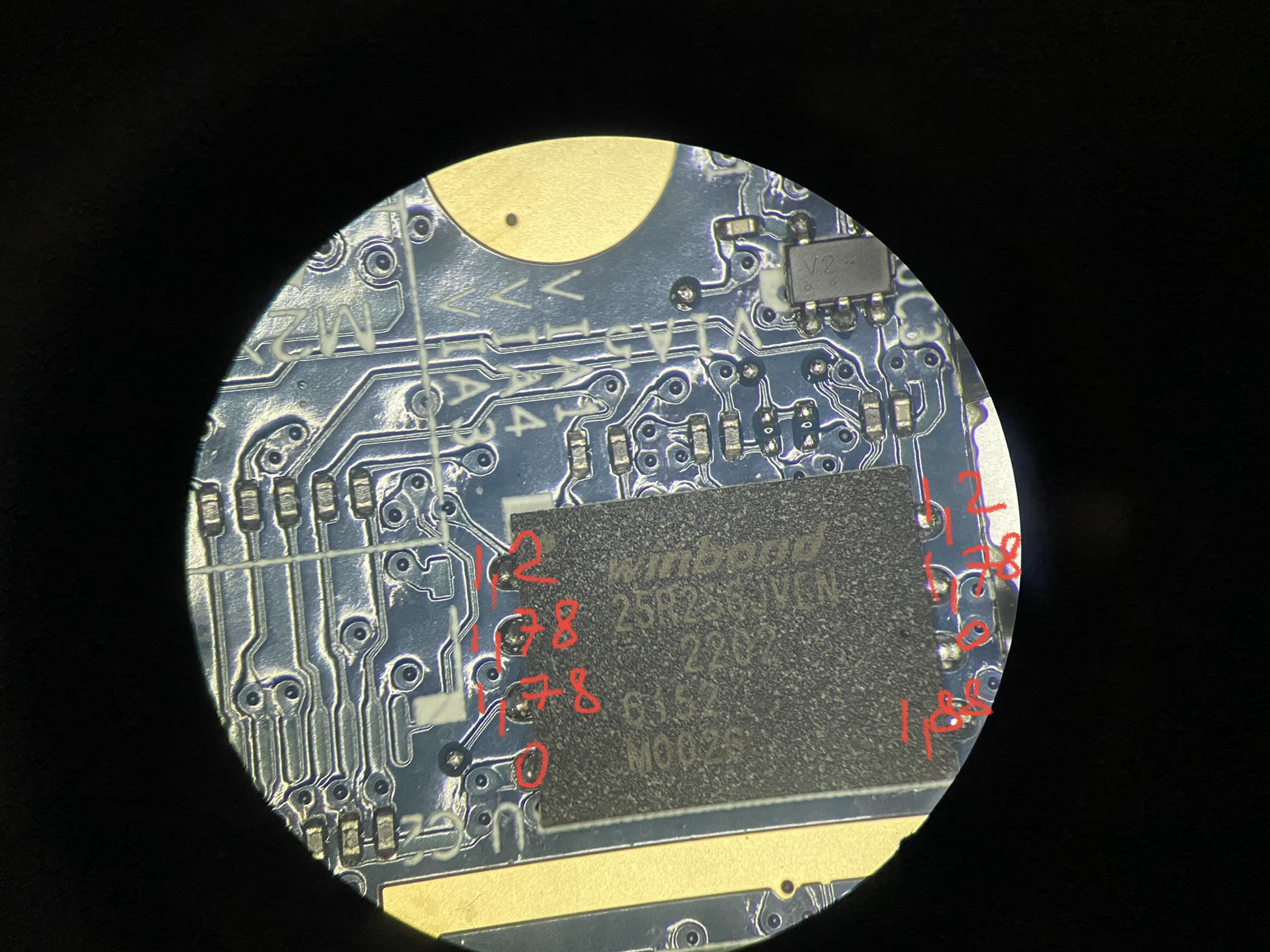

            I can confirm the bios is in right position with pin 1. I am working on 2 identical motherboards and both failed. I am able to read and write to the bios. Not sure if it's faulty. I found out the verification of the written data fail in one of the programming software. Other one is not complaining about verification.
            Can not properly programmed chip cause the voltage change?
            If I burned both chips or their are faulty where I can get empty chips?
            Sending a screenshot attached.
              US $4.16 | New Original W25R256JVEQ 25R256JVEQ 25R256JVEN W25R256JVEIN In Stock
              https://a.aliexpress.com/_mKbb3Ru
              You should have a bios image of 32MB for this device.
              Is this correct?

                • mon2
                  • Dec 2019
                  • 14152
                  The Vcc (power rail) of this flash should not be lower after soldering in correctly.
                  I think the issue is that you are using a meter to measure?
                  The pins are toggling high and low so the meter is unable to measure quick enough due to the toggle rate. Then you will read a lower voltage on pins that are not static.
                  Post the voltage of each pin.
                  You may not have a fault here.
                      I am able to post the measurements within 3h as will work from home.
                      As a reference I took the 3.3V measurements from a working board with a password locked bios. I had no issues to measure which pin is 3.3V and which not. Once I re-programmed it and soldered back to the same board the voltage has changed.
                            I tried a different one EZ2019+ and all went OK. The same results (attached). Without chip higher voltage, with chip lower voltage and laptop won't turn on or show any light.
