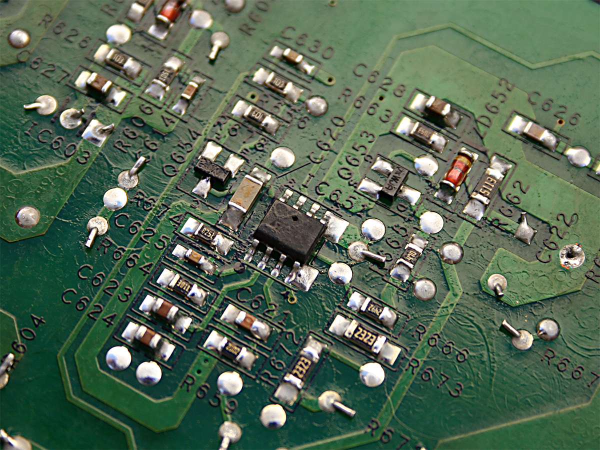

    We have a Winner:
    My 2407WFP is working again.
    The for the cap C626 i used 1nF, Farnell 1856532,
    seems to work fine.
    Still working on the Schematics, have it but need to draw them better.
    Will post when ready.
    Thank you for you help!

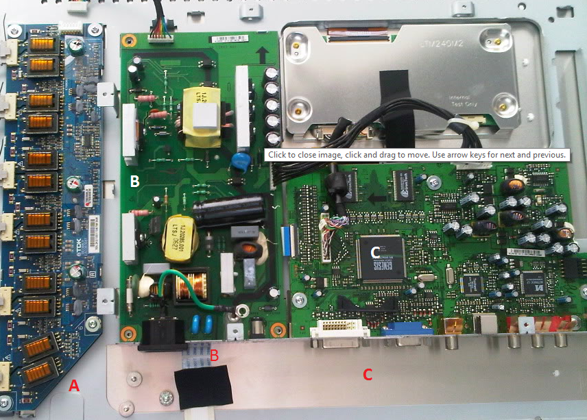

            Dell 2407WFPb Monitor - Unresponsive
            issue with 2407 where the monitor works for 1-2 hours. then unresponsive, no display (can see the backlight working). Buttons don't function, unplugging/plugging power on resolves it but it comes back faster next time. there is also flicker once in a while. Opened the monitor and looked at all PCB's for bad caps (all look nice and no bulges or residue of any kind), nothing that I can tell visually. Will post a few pictures in case I missed something. Given the symptoms which PCB should I focus on, power or inverter.

              Re: Dell 2407WFPb Monitor - Bad Cap
              I had this problem with my 2407 - in my case I swapped the signals pcb in the end and it has been fine since <touches wood quickly>
              I tried recapping the pcb before I replaced it but there was no change in behaviour.
                Thanks. will Try it out. Just to make sure, the "Signals" board (is it the C board or the inverter A as in picture.)
                    Ok.. here are some photos of the damage. I've already removed the big cap and R670, and installed a Rubycon 450v 120uF capacitor. I just did some testing and I believe Q651 is bad, and now that can see the IC's up close, it looks like IC651 may be bad. Not sure on that though.
                    But I came here to get your guys opinion considering I'm very novice at diagnosing problems with circuit boards.
                    I found "new" power boards for the 2407wfpb on ebay, shipped from Hong Kong for only $24.99, which isn't a bad price. From my understanding though, they come with Elite caps, which should be replaced on day 1.
                    As a backup plan I came across a laptop power brick which is 19.5v (actually reads 20v on my meter), 5.13A 90watts. Spec wise, it seems perfect for modding the 2.5mm jack on the power board and going that route. I'd rather not risk killing this screen though.

                          Yes Quantumraj, that's the one. Good luck !
