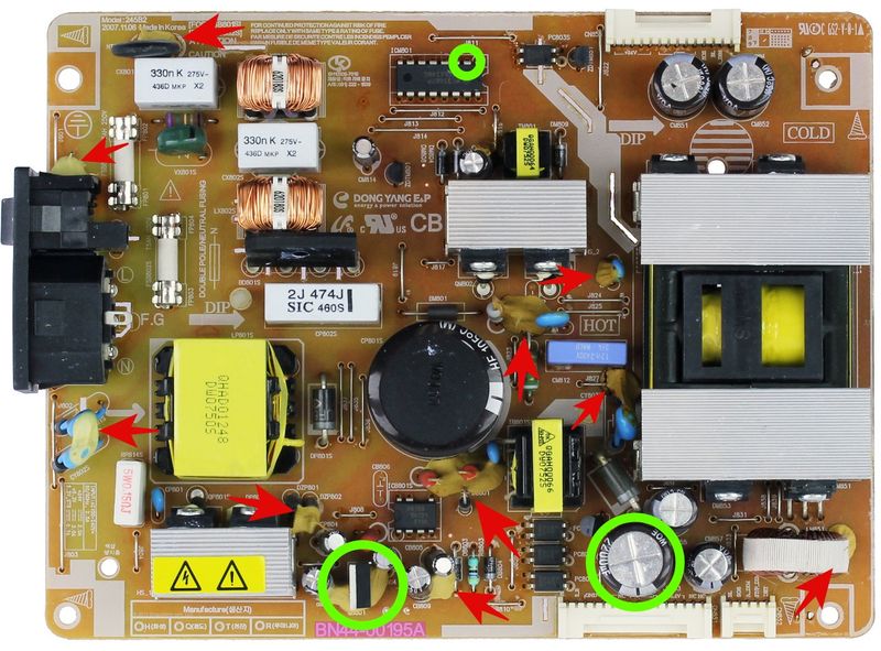

                            • joshmonger

                              • R_J

                                • joshmonger

                                  #96
                                  Re: Samsung SyncMaster 2493HM black screen with power
                                  Originally posted by R_J
                                  If it acts up again, try replacing CM806 (10µf/50v) Also CB806 and CP811 (47µf/50v), these caps are on the ic's VCC line and fail often.
                                  Thanks, I'll keep that in mind. I did pull CB809 to remove some glue and it tested good on capacitance and ESR so I put it back in. It seems like it's more the glue that was the main culprit in most cases. When I have time I will take an image of my board BN44-00195A or a stock one and circle the area with the transistor to make it easier for others. The glue was in other places too though I spent quite some time cleaning it up. So silly the whole product was ruined by putting glue (which is serving no purpose other than breaking the product) randomly on spots that I assume are likely to heat up. Also might be good to reflow pin 10 MC33067P.
                                  Last edited by SMDFlea; 08-04-2022, 10:48 AM. Reason: Added image to badcaps from dropbox
                                  • joshmonger
                                    • Aug 2022
                                    • 4
                                    #97
                                    So the image in the previous post we have a pic of the board and the green circles highlight the bulged cap that was replaced, the transistor that was causing the problem with glue hidden underneath arcing the legs together and pin 10 to be reflowed. All of the red arrow are glue areas to be carefully removed as they have potential to arc as well. Hope it helps somebody!
                                    Actually This is the correct picture, I realized I labeled pin 10 incorrectly as I was looking at it upside down.
