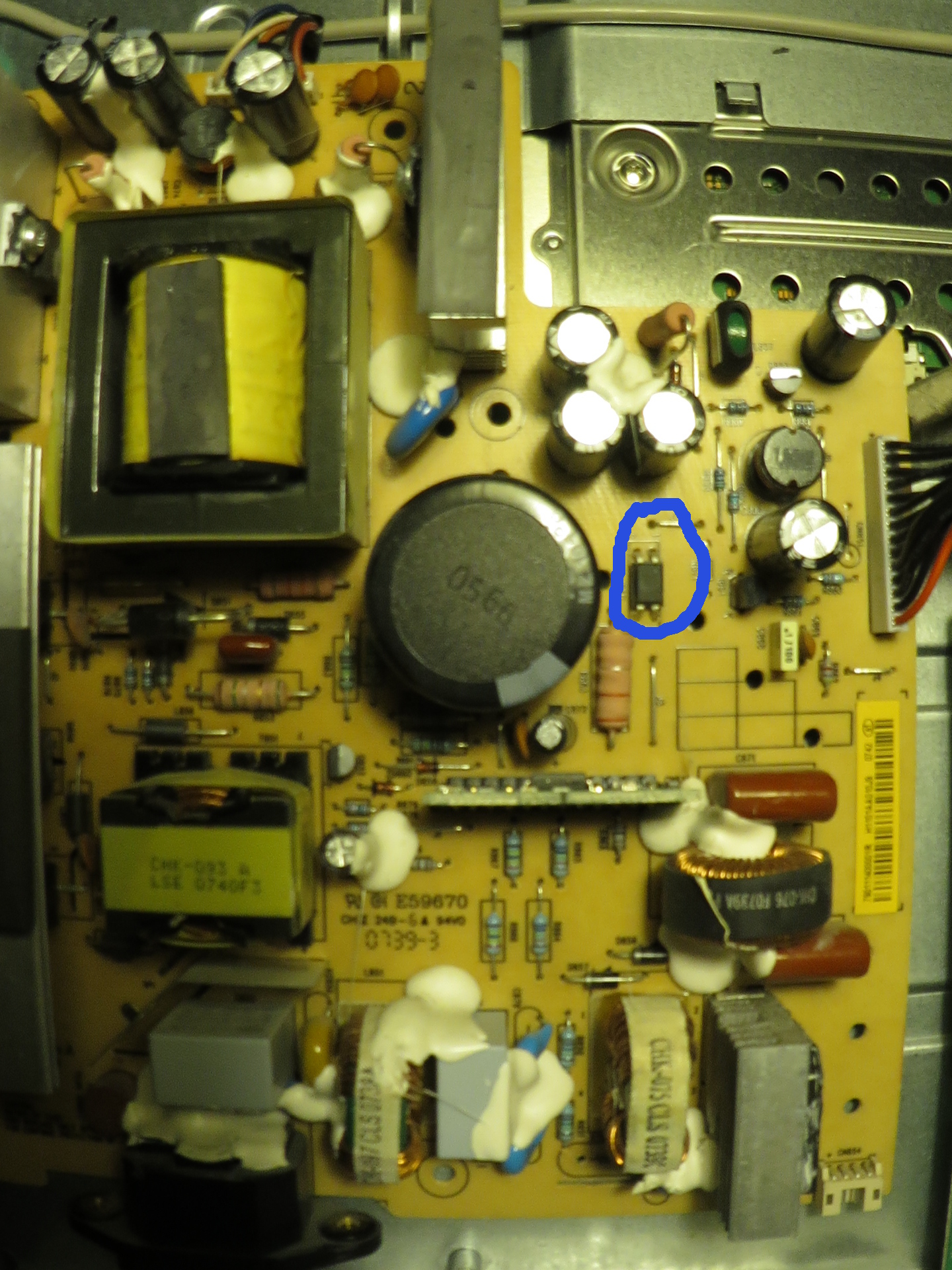

          Re: HP W2408H No Power (Surge) Repair - Success
          i also went through all diodes and resistors, all are reading nothing suspicous.
          what is this guy i marked with a blue circle? it says some numbers on his back (0734 8178 y). what could his purpose be in this universe .) and how can i test him?
          • vinceroger69
            • Mar 2012
            • 6714
            • uk
            i think its a optocoupler but not sure how to test it though.
            • jamalC
              • Sep 2015
              • 14
              • denmark
              thx for the reply!
              do optocouplers live long and strong?
