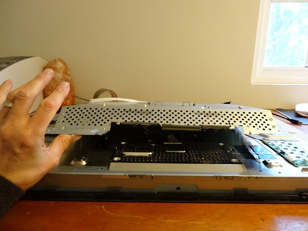

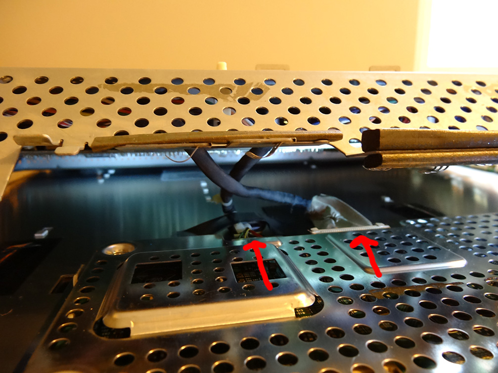

        • Lumberjack777
          • Dec 2010
          • 464
          #464
          Re: Dell 3008wfp faulty power supply
          Originally posted by vvulture
          Just an update...
          I've replaced D22 and got power back.
          But...
          Now, only the top half of the screen works fine... the bottom half is black and displaying faint vertical lines across the entire witdh of the screen.
          I have dismantled the screen one again and checked all connections which seem fine.
          Any ideas ?
          When assembling you have 2 cables that connect inside the heat shield. It's common to knock one partially loose when connecting the 2nd one. You need to get back under the heat shield and make sure those 2 cables are firmly plugged in. I usually add a piece of tape just to keep them plugged in.

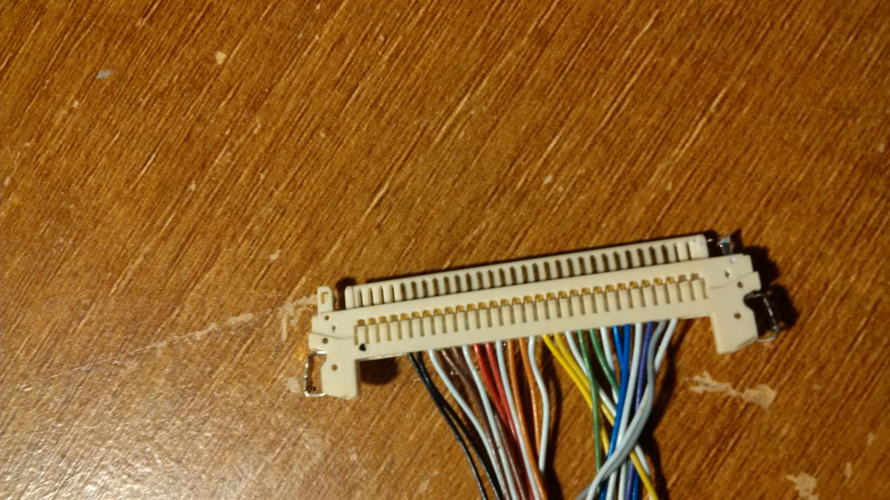

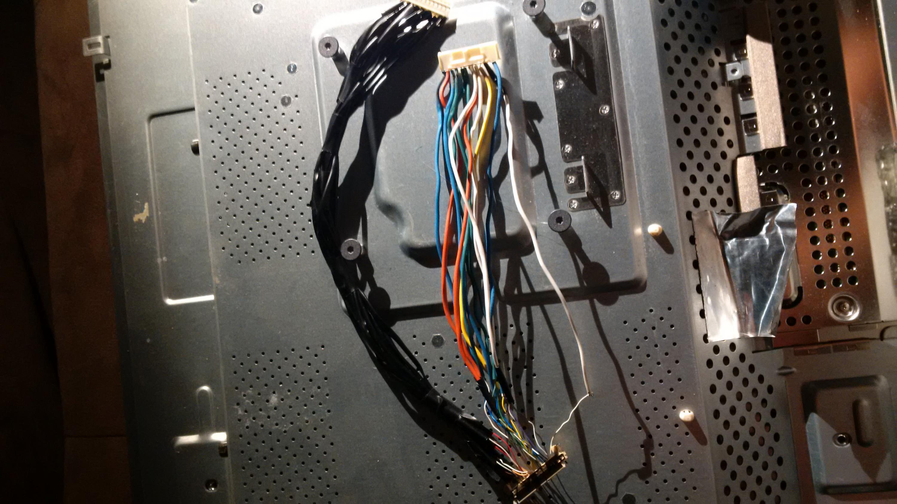

                      • valkyr
                        • Jun 2015
                        • 8

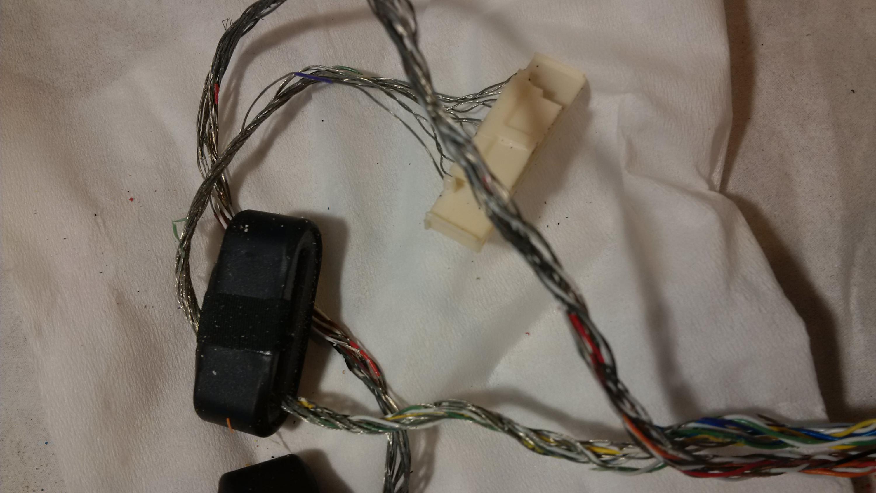

                        #471
                        Hey, I took apart a 3008wfp yesterday, found the issue in the attached photo. I have never seen cables do this before, so I was quite disheartened when I realized this was the source of my 'monitor turns on but no display' issue.
                        Before I go and attempt to reheatshrink this cable, does anyone have a spare one, or a project 3008wfp that they gave up on, that they would be willing to sell me this cable from?
                        Hoping for some Luck!

                          #472
                          Today is your lucky day!
                          Since you provided a picture, I can check through all my cables, and I'm sure I have a spare somewhere.
                          Send me a PM, and I'll find one tomorrow afternoon at the shop.
                          • Agent24
                            I see dead caps
                            • Oct 2007
                            • 4951
                            • New Zealand
                            #473
                            WTF!!????? I have never seen or heard of that happening before.
                            I'm guessing someone in the plastics factory in China did something really stupid with the mixture.... haven't seen anything like that since those ancient rubber-insulated mains cords that 'melt'.... Dell should be sued for a fire hazard!
                            Should be pretty easy to just pop the contacts out of the connector housing though, and solder brand new wires onto them, than replacing the whole cable with one that might just do the same thing...
                            -David VanHorn

                              • valkyr
                                • Jun 2015
                                • 8
                                #475
                                Right? Isn't that strange?
                                I will double check when I get home today, but when I was looking at it earlier, it didn't look like I could pop those that easily without breaking somethings. The side in the photo is easy enough, but the other side is a very tight 'ribbon like' connector.
                                But I'm always willing to try something new. Having a good one sent to me was just going to be the easier option for me Less work.
                                I will try to repair, and send you a PM, Lumberjack, if i get defeated with my current cables.
                                Also if you require a better picture, I can get that for you later today as well.
                                Thanks for the reply's.

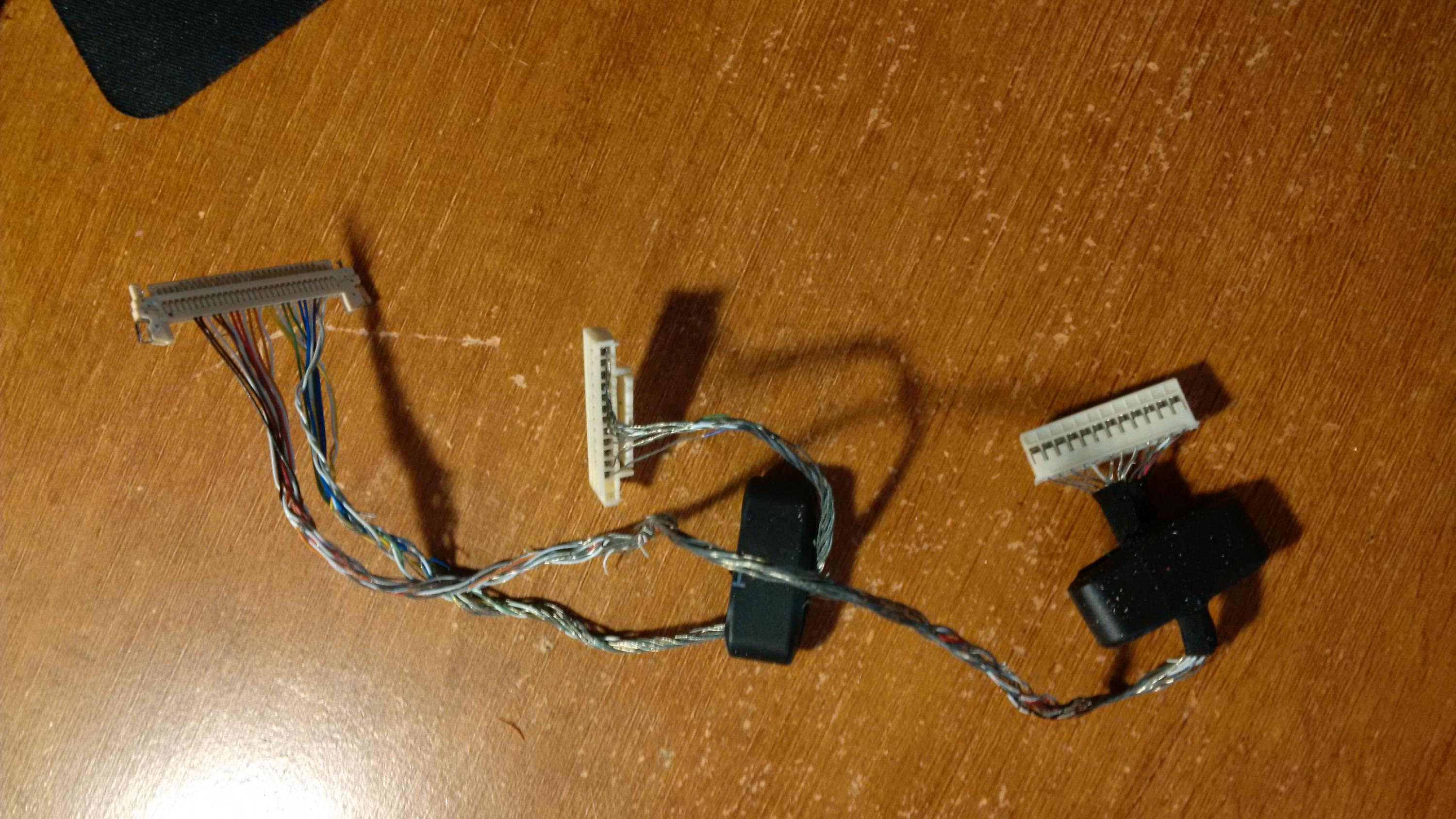

                                  #476
                                  Hmm... Can you show some photos of the other connector?
                                  If you do go to replace the wires, might be good idea to only go one at a time, so you don't mix any up - I wouldn't know if they are all wired in sequence or not!
                                  EDIT: Is it the LVDS cable for the LCD panel?

                                  • valkyr
                                    • Jun 2015
                                    • 8
                                    #477
                                    Sure. Here's a couple. Going to try posting from my phone, haven't done this before.

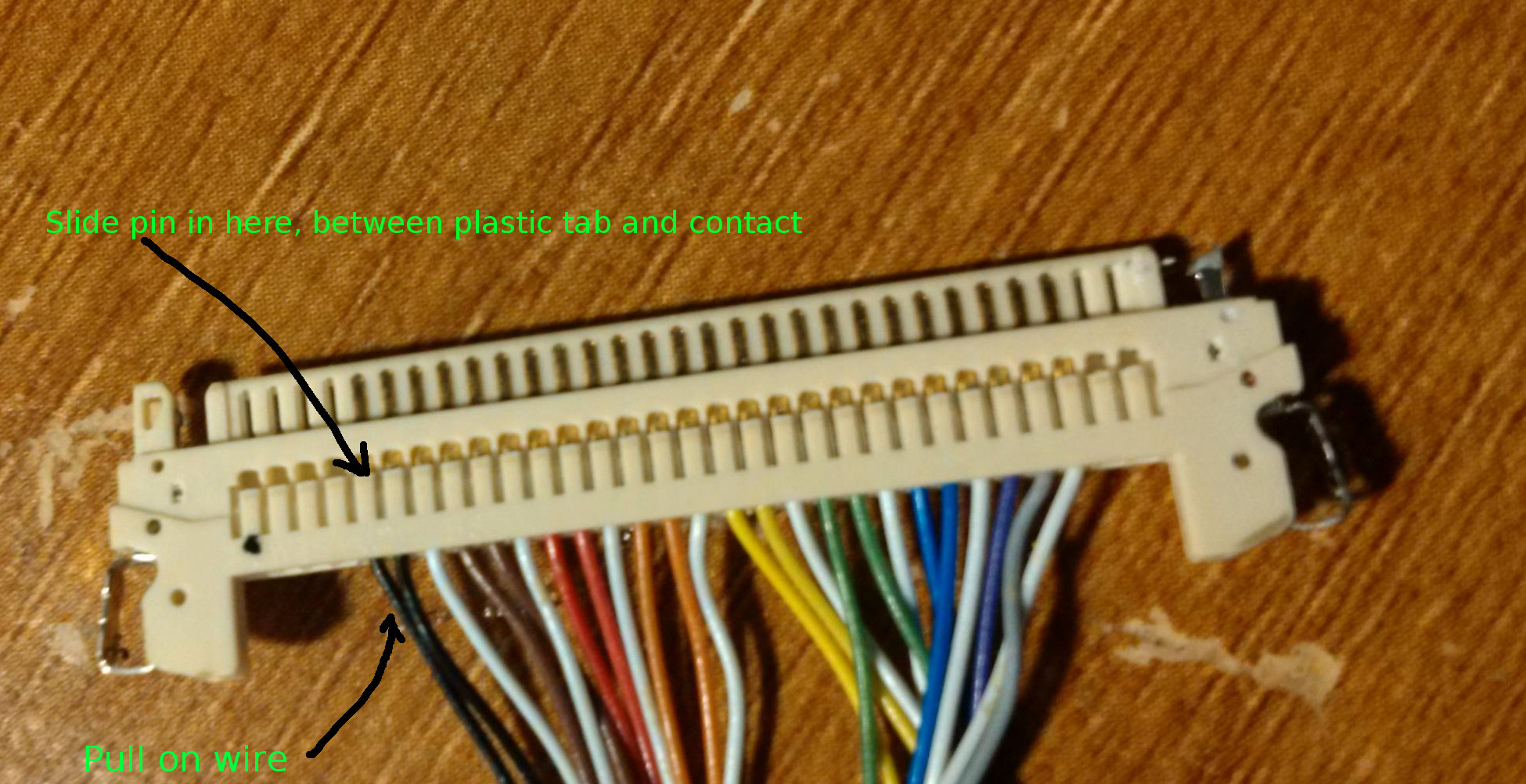

                                      • Agent24
                                        I see dead caps
                                        • Oct 2007
                                        • 4951
                                        • New Zealand
                                        #479
                                        You should be able to take the wires out by sliding something with a thin pointed end (like a sewing pin\needle etc) under the plastic tab and pulling on the wire. See photo.
                                        That should get the wires out, but it will probably be real fun to solder new ones to the contacts. I hope you are good at soldering...!
                                        Another idea may be to cut off the original wire but leave a little still connected, and solder the new wire to that. You may need to use heatshrink to cover the join but it would have to be quite thin so it can fit into the connector housing as there is probably not much room.
                                        Tricky but doable I reckon...
                                        EDIT: Now that I think about it, cutting the wires a few cm from the connector and replacing them, then using heatshrink for the old portion of wire probably makes more sense and would likely be easier...

                                          #480
                                          Took a little vacation and came back yesterday.
                                          Decided to heat shrink and electrical tape the wires apart just to test out and see if this would fix before I sought a more permanent solution.
                                          Turns out, the wires were either a symptom of another problem, or when they touched, they took out something else.
                                          Since the problem is not visual (no bad caps) that about does it for my electrical troubleshooting skill.
                                          Any suggestions?
