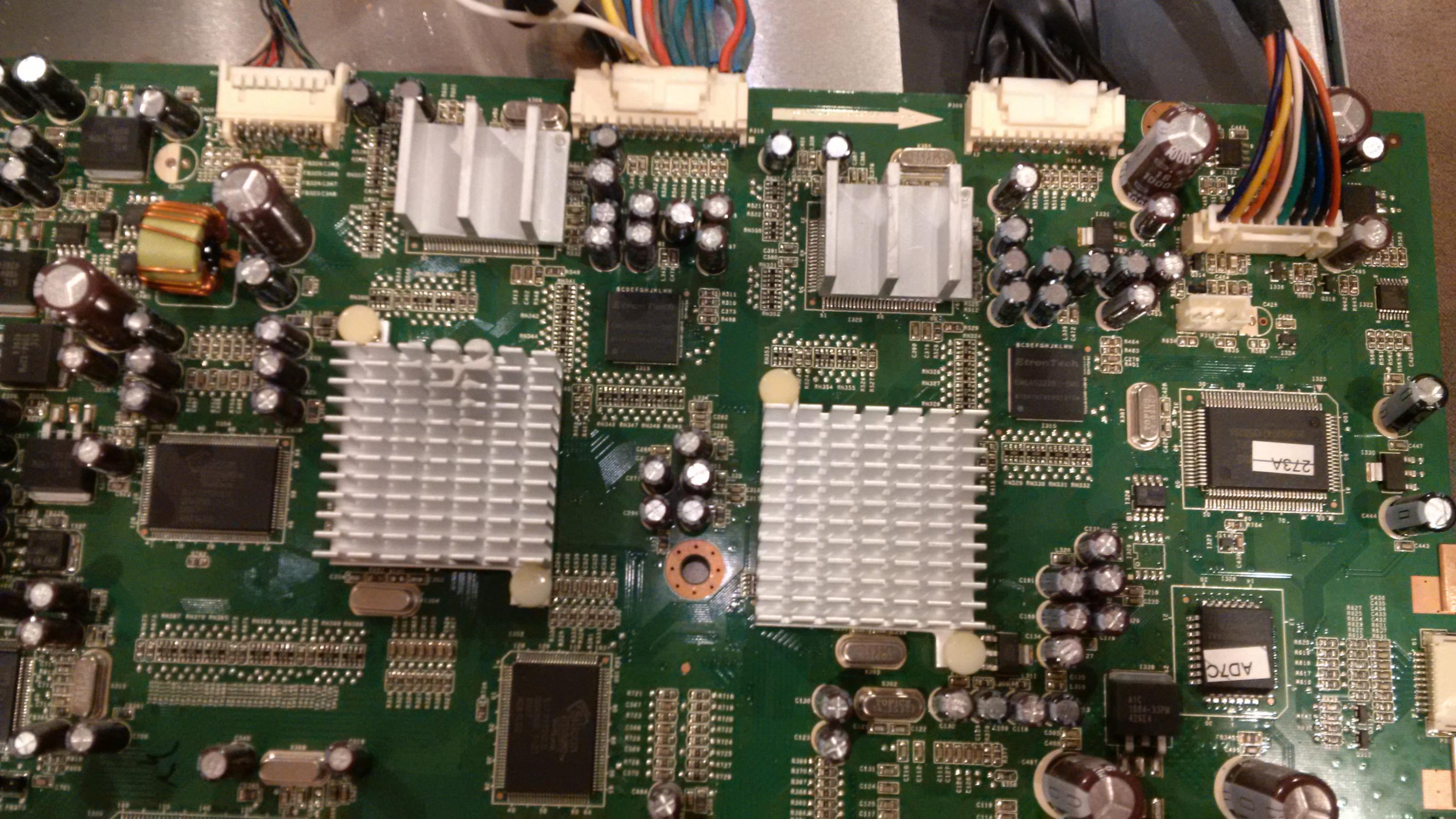

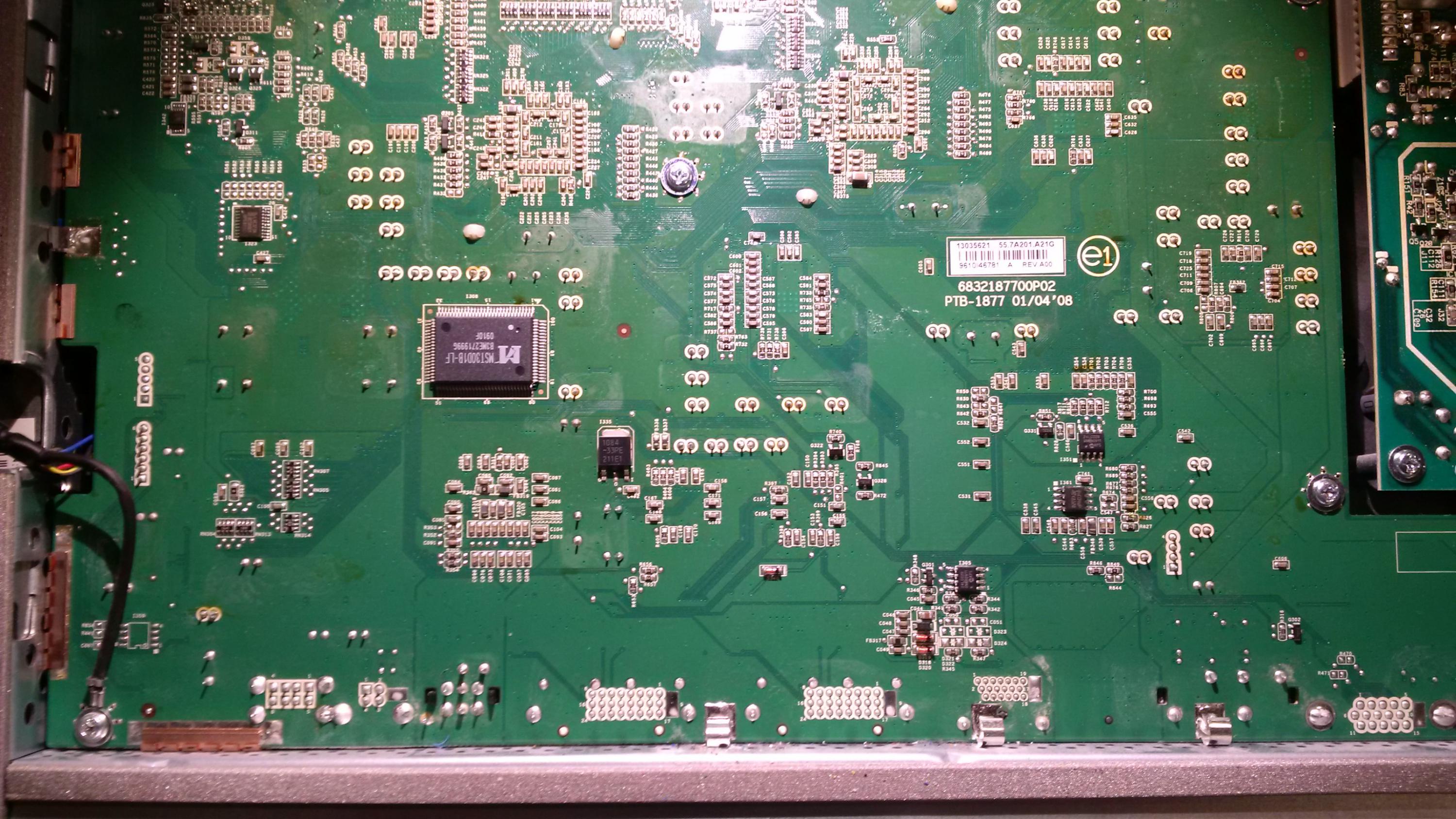

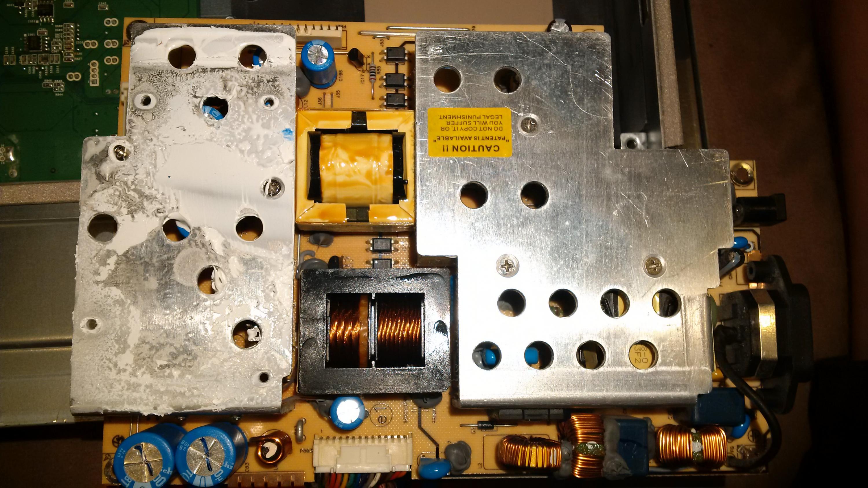

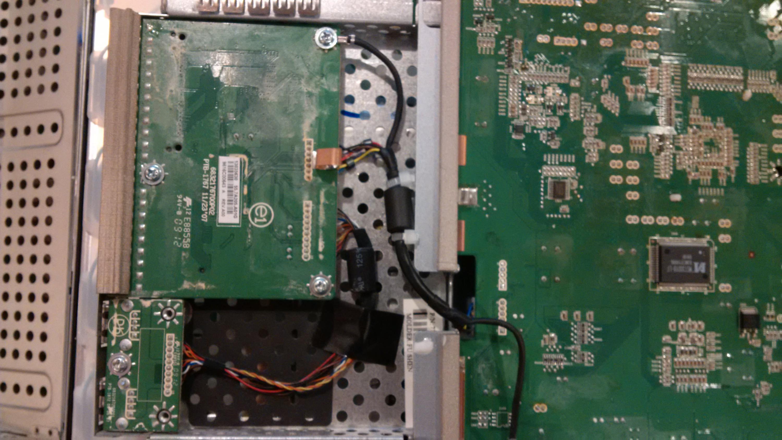

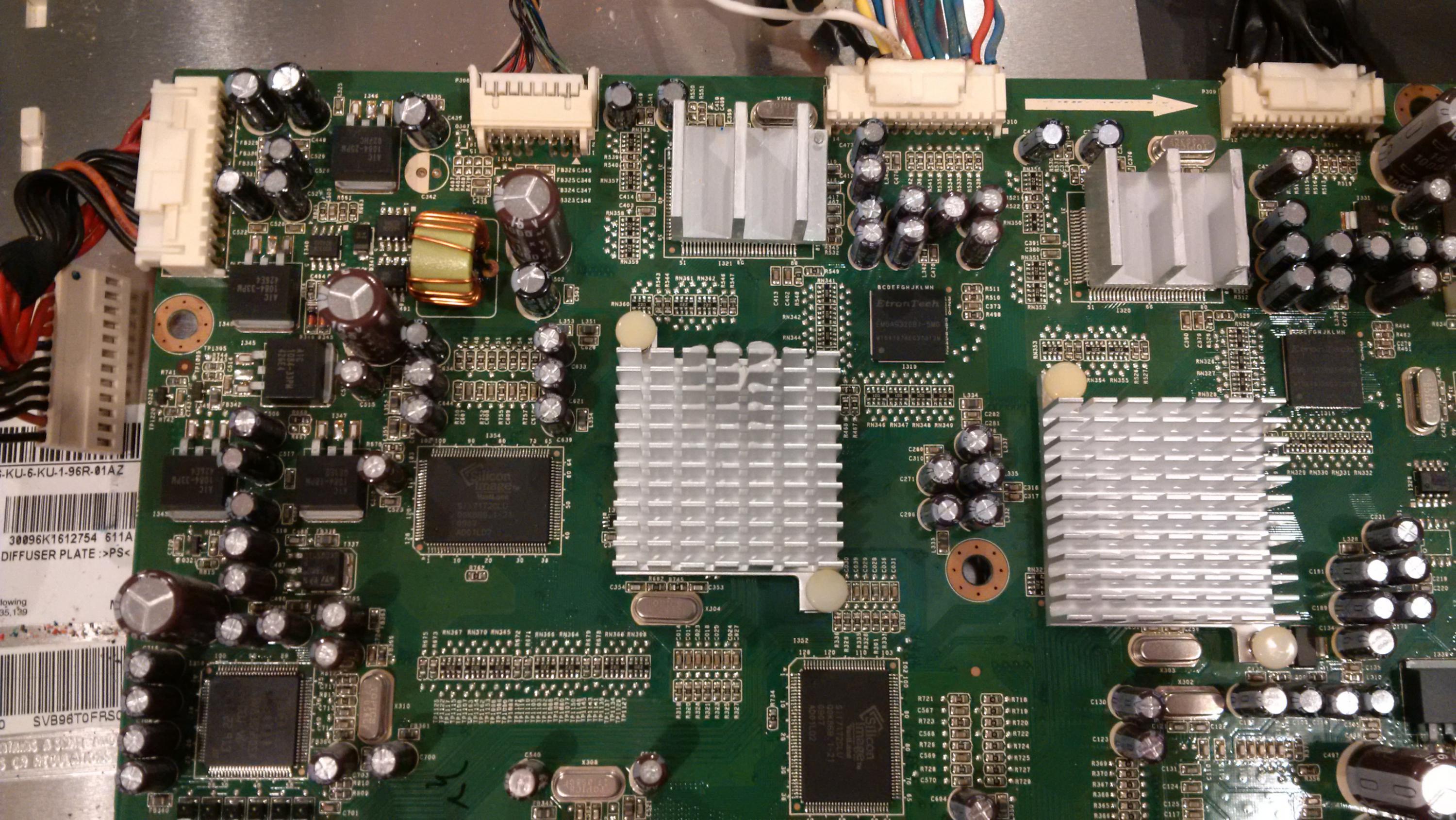

        #483
        Re: Dell 3008wfp faulty power supply
        I'm not sure how much I can help given the situation with the LVDS\TMDS(?) cable and what it may have caused, but I will give it a try.
        First of all if you can take some good photos of the boards and upload them that will greatly help. It's hard to get a general idea of the circuits when we can't see them. It also helps show potential problems you may have missed. Some things are not obvious if you haven't seen them before, for example.
        Then I would suggest you start with measuring all the power supply rails and ensure they are within spec. This would also include any secondary regulators on the logic boards. Additionally, checking any fuses which may be present on the board(s). (This is where the photos come in handy to help with identifying these)

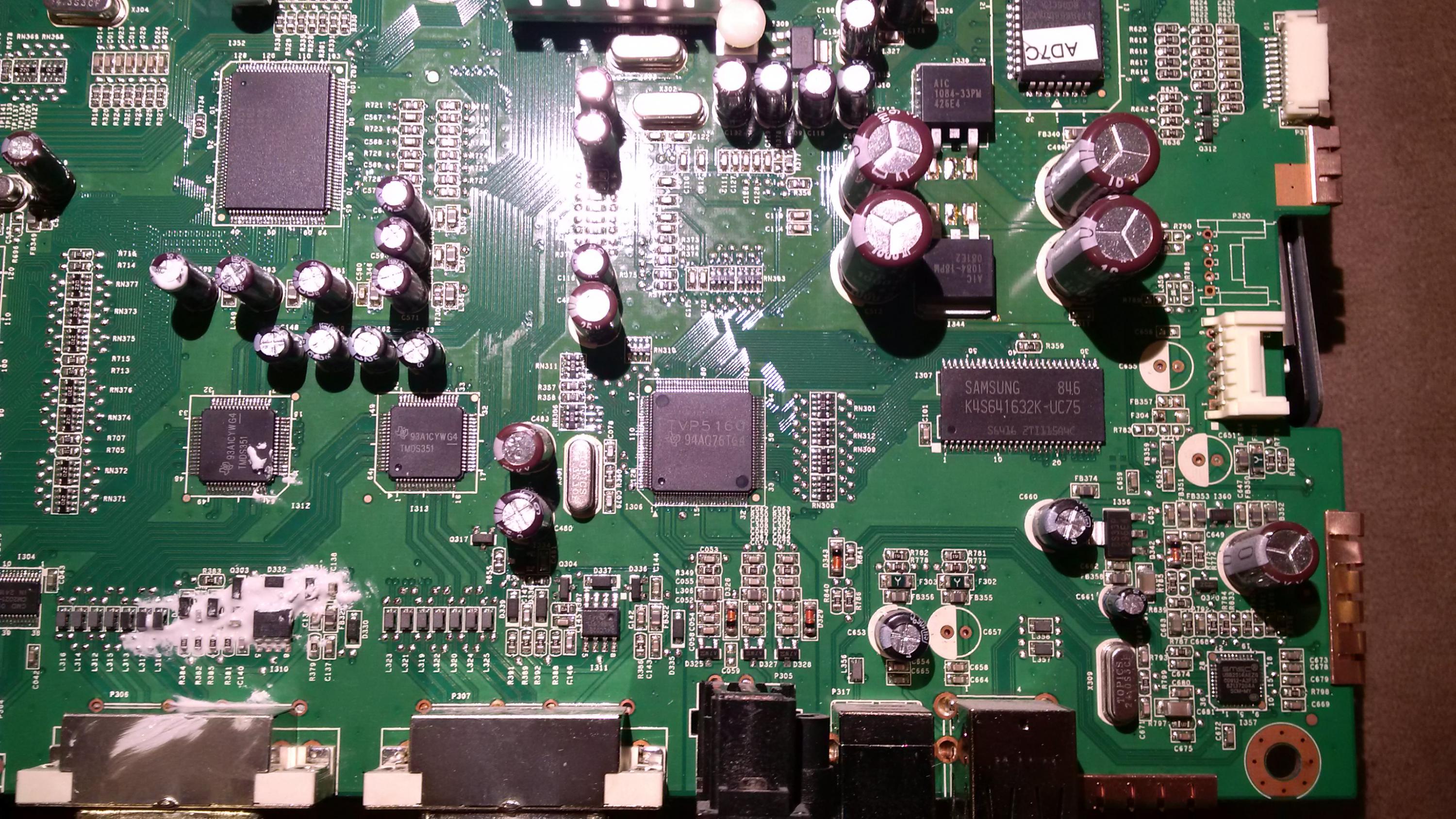

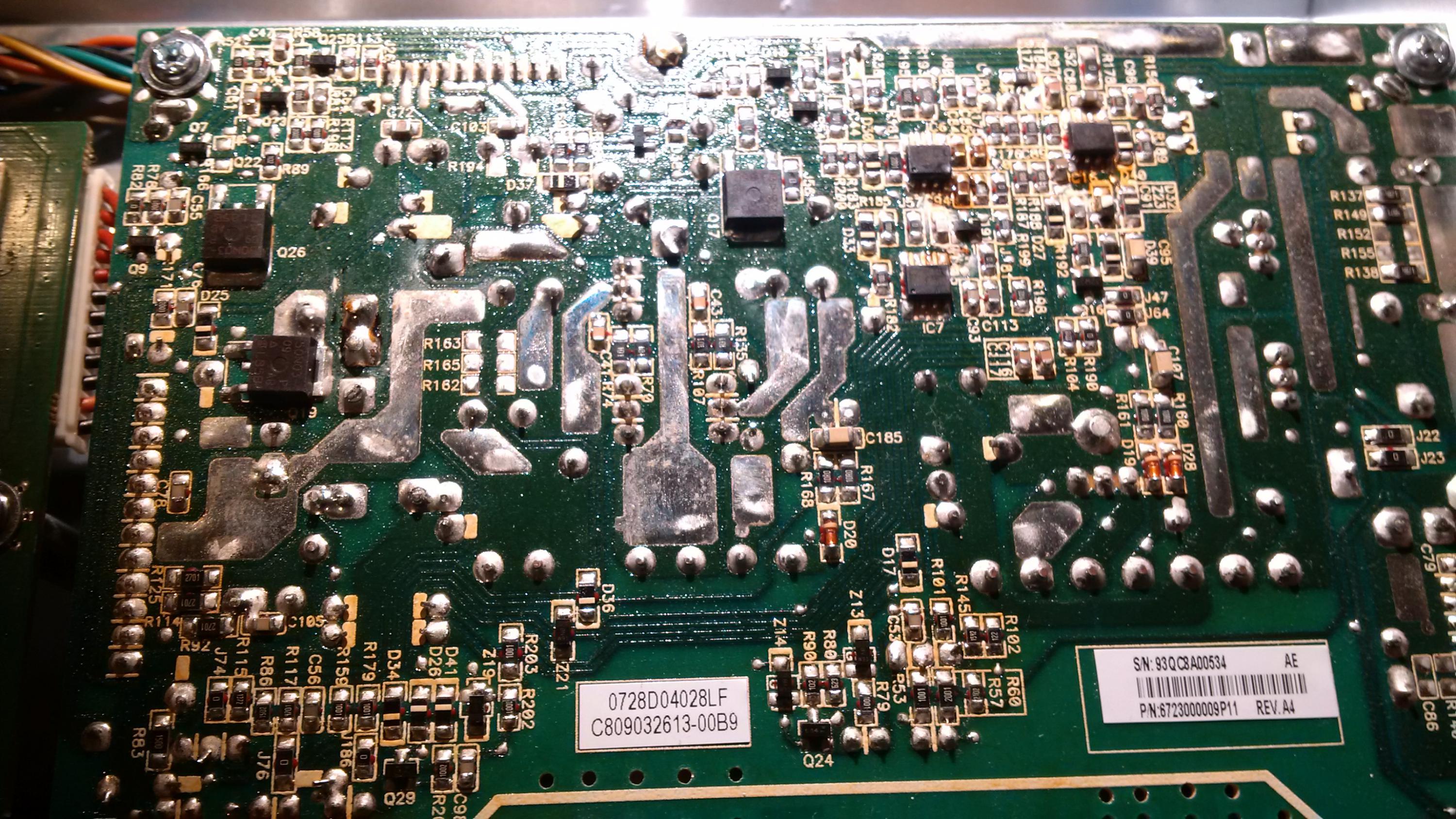

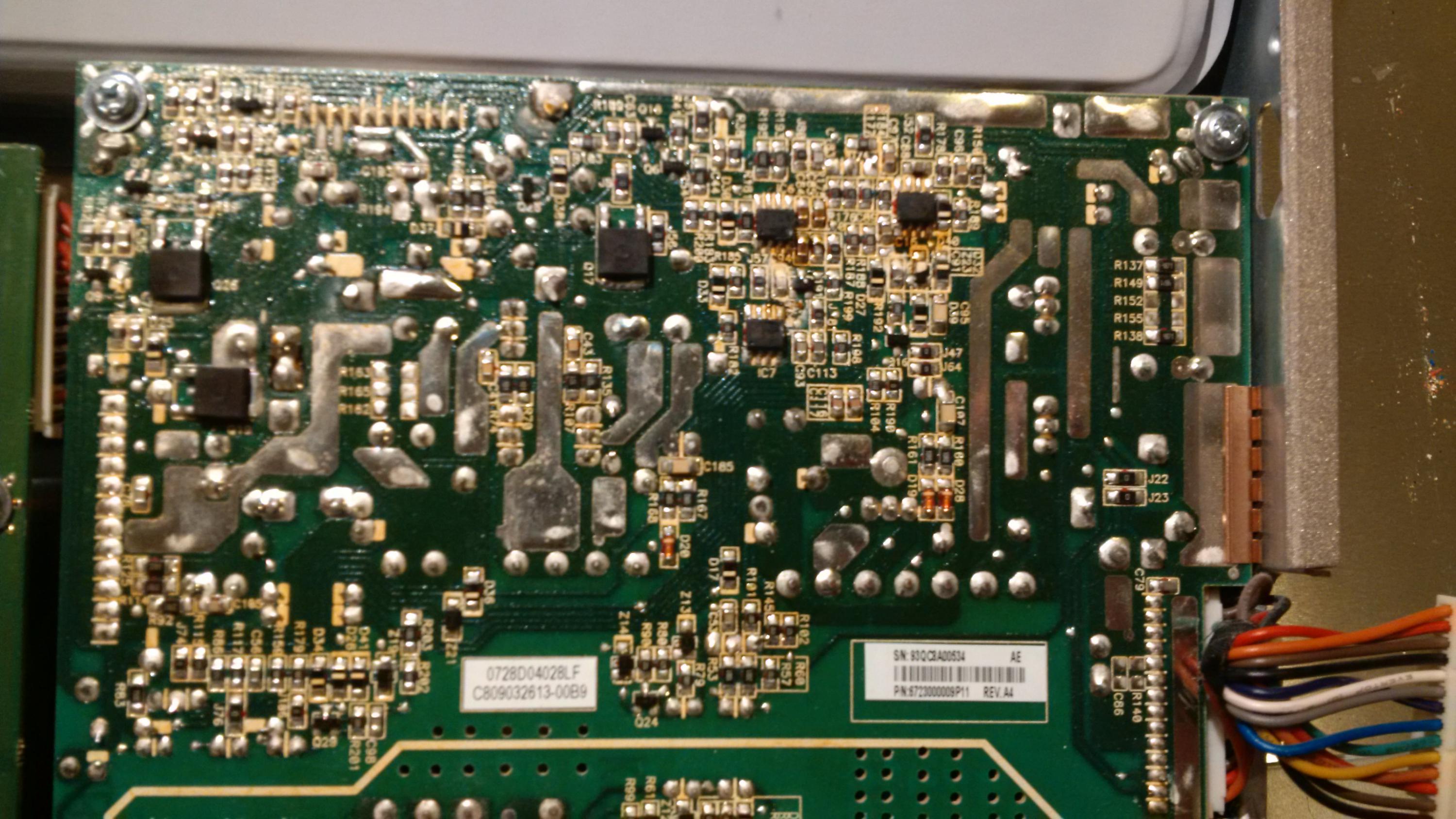

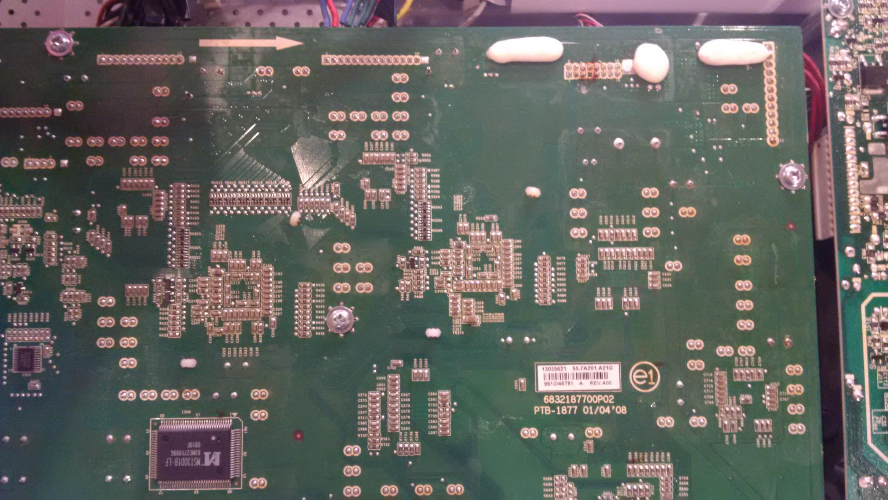

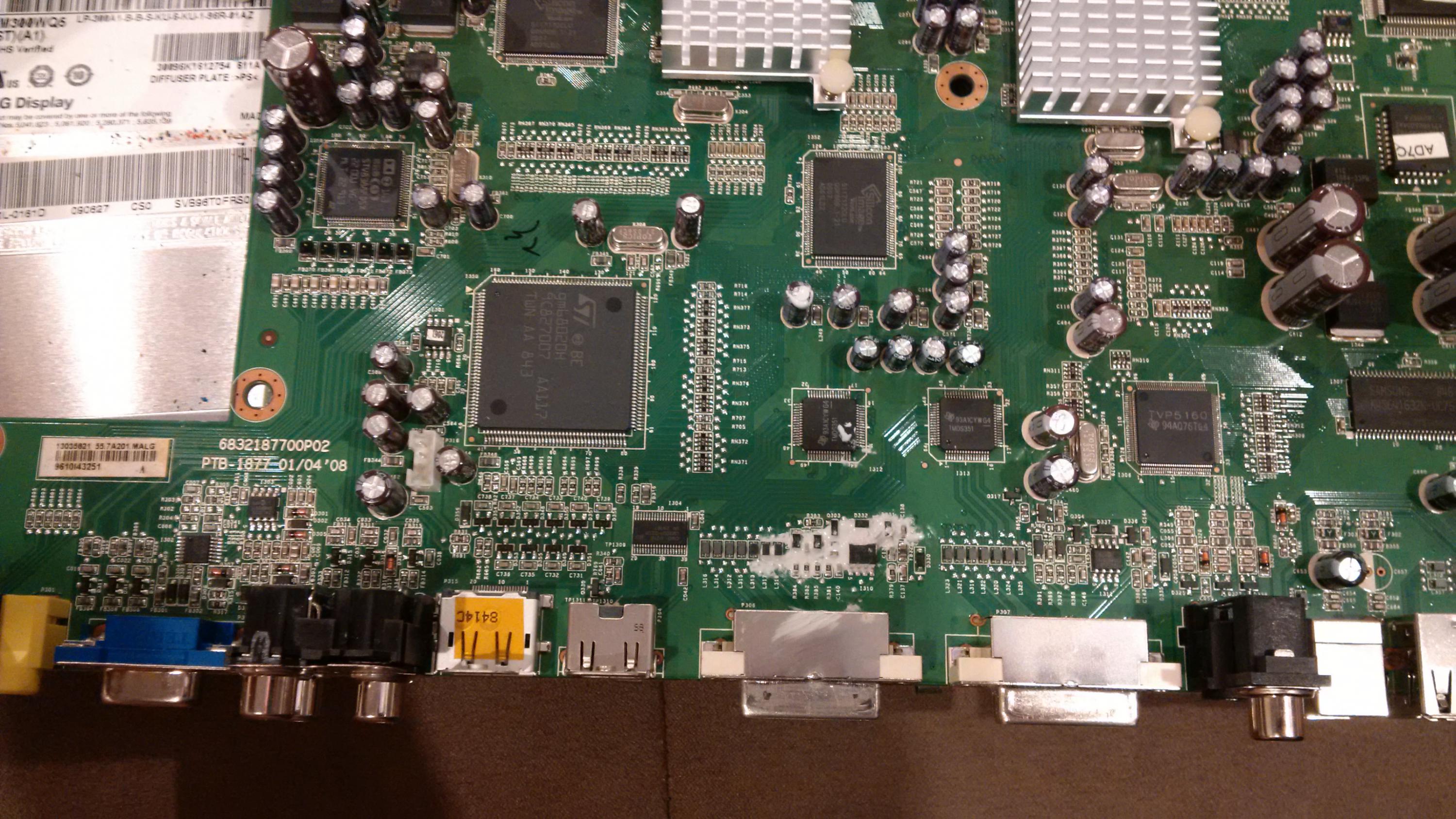

          #484

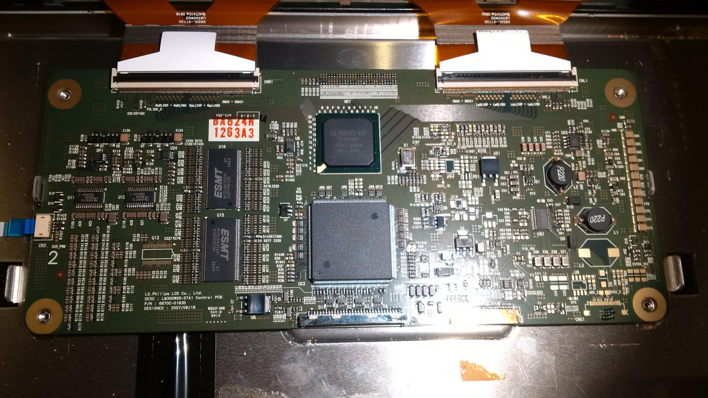

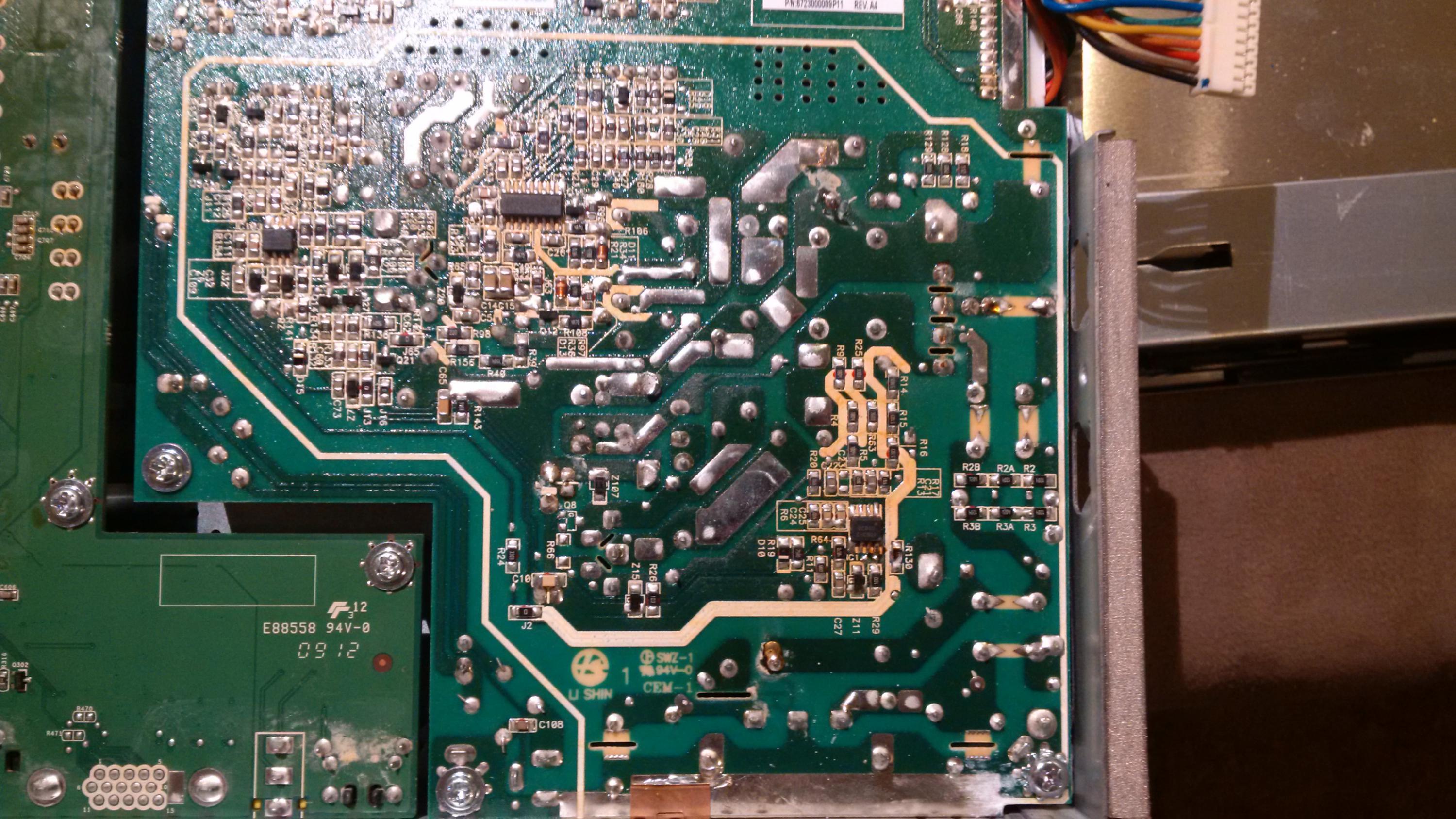

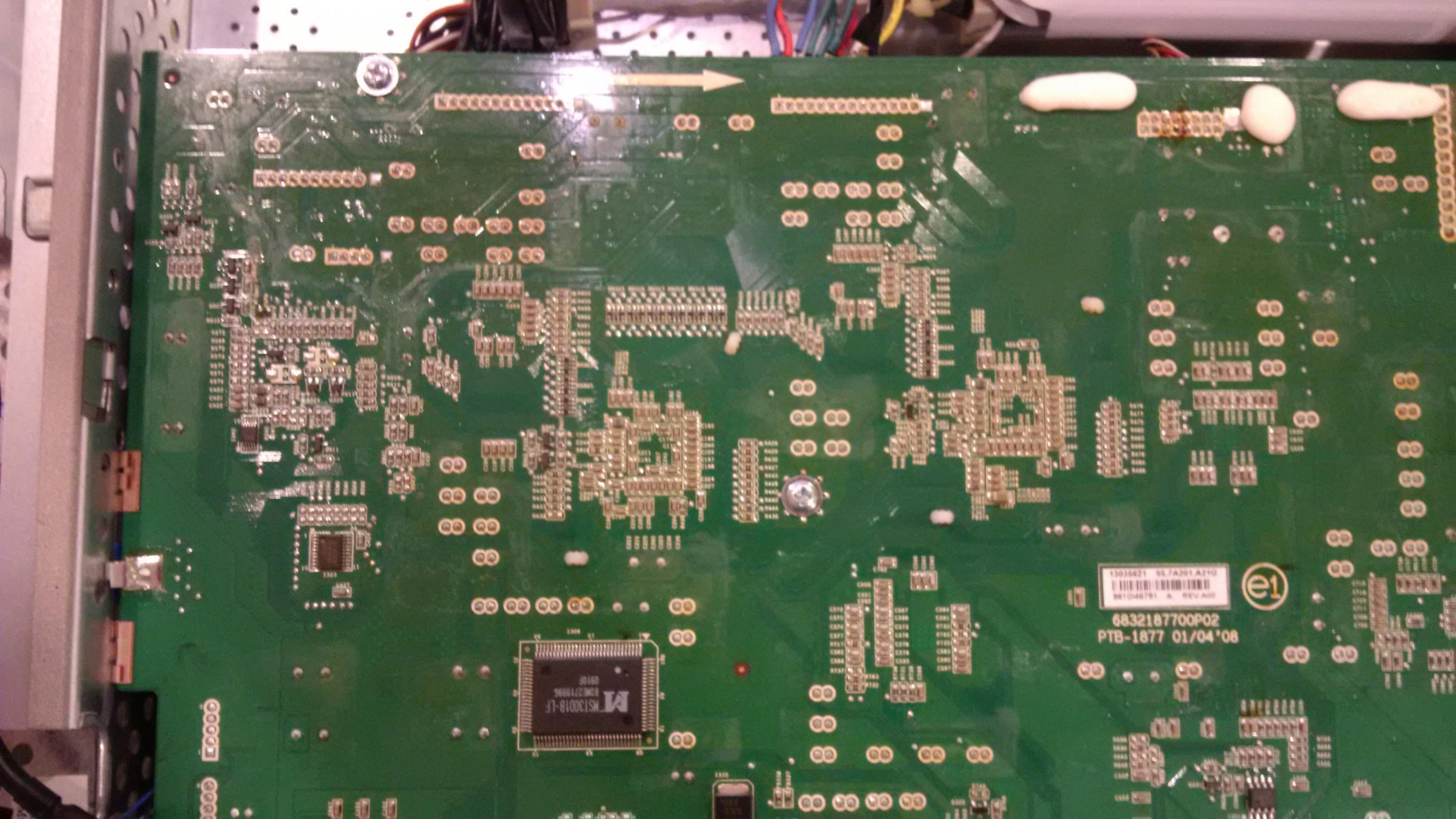

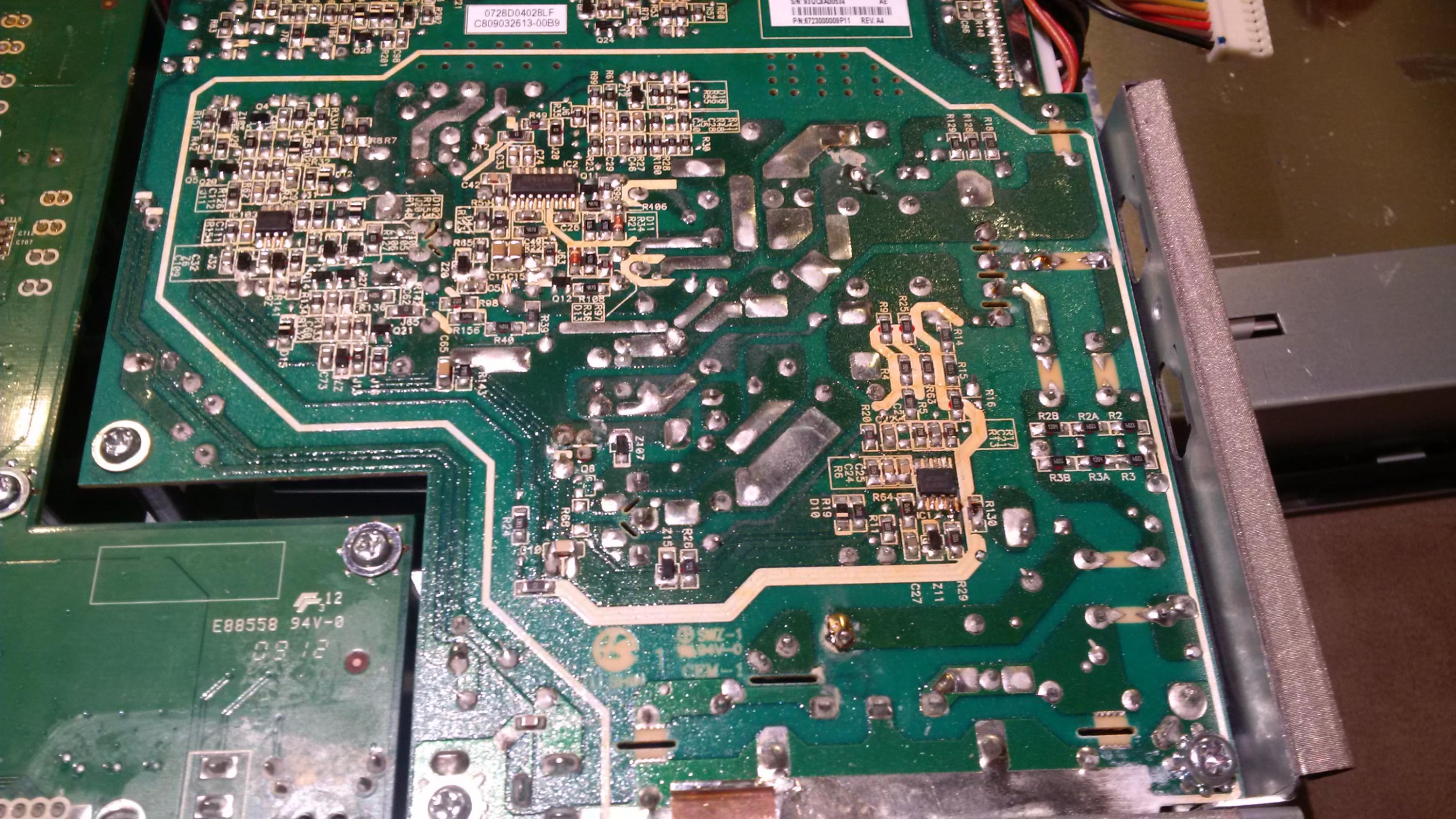

          Sorry for the late reply, I have pictures now, some are better than others, let me know which one you would like to get a closer look at.

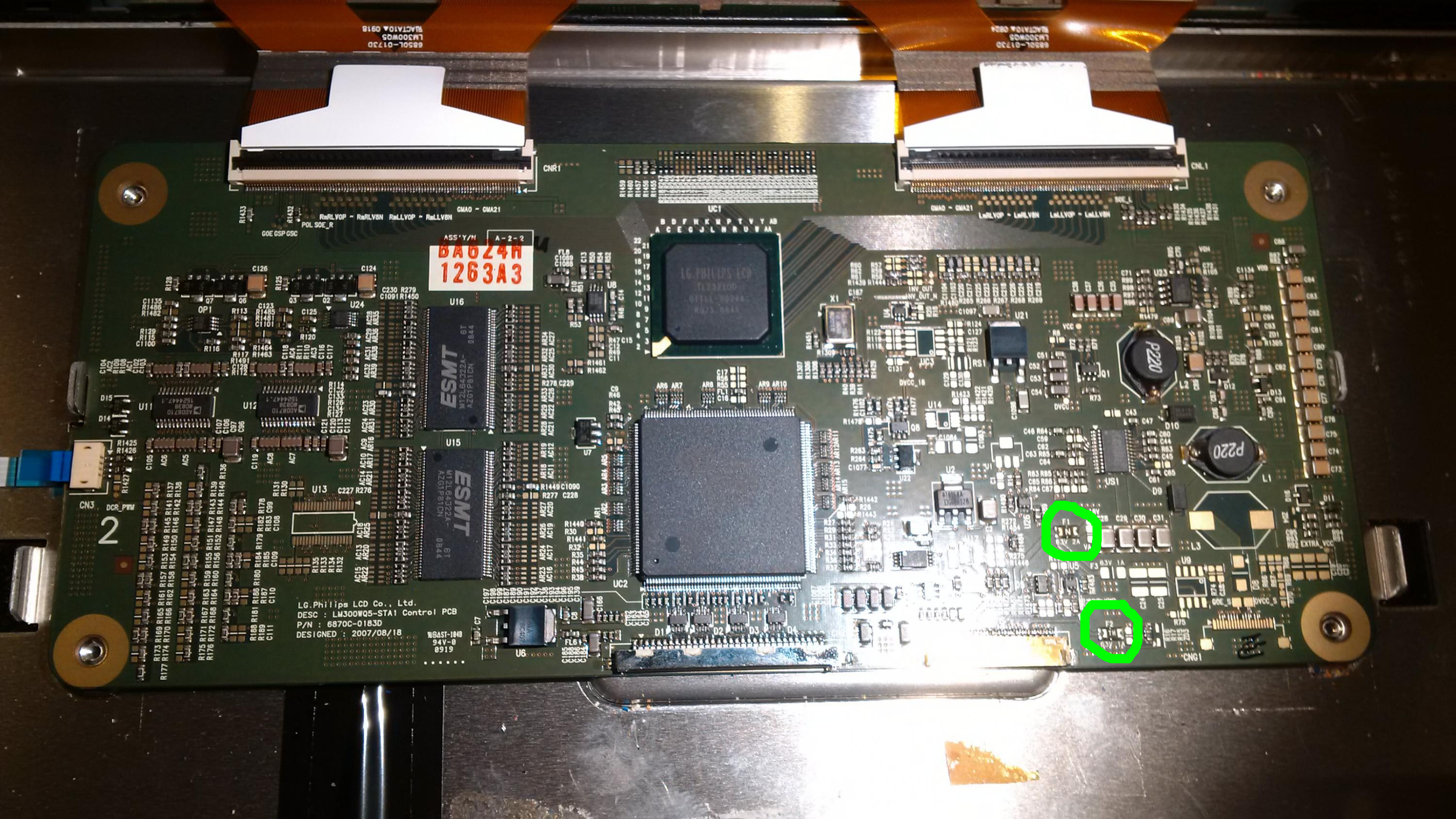

              #486
              I notice two SMD fuses on the T-CON board, if the cable shorted, they might have blown. I have marked them (F1 and F2) in the photograph. I would check those to start with.
              -David VanHorn

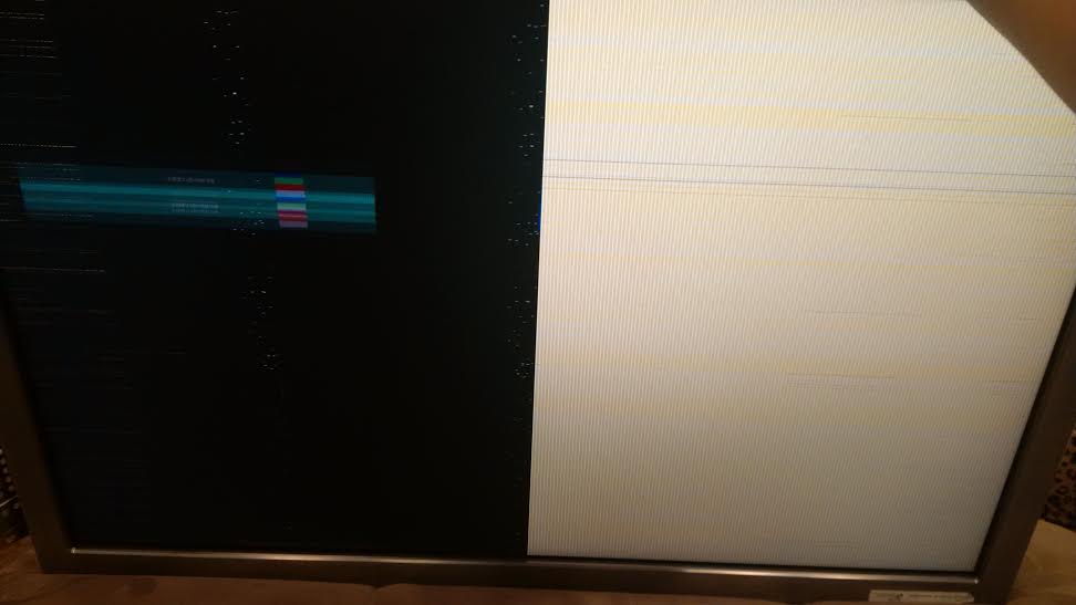

                #487
                Good Eye
                Sorry I haven't responded in a bit, been on vacation.
                I had a chance today, tested with a multimeter and the F1 fuse looks to be the culprit. I lightly soldered a connection to bridge it for a test, and booted up the monitor.
                And... Display!
                A very bad and weird switching between a full white screen; a half screen with a very messed up display, and the other half black.
                I took a picture.
                It's a step in the right direction, tho not sure if it's repairable yet. Going to research these symptoms next.
                If my understanding is correct, the F1 is simple on or off, so my solder job wouldn't be the cause would it?

                  #488
                  Yes, a fuse which is intact looks to the circuit for all intents and purposes as another piece of wire. So replacing it with a blob of solder would make no difference. You can always check by measuring the voltage on each side of the fuse and they should be the same.
                  One thing however, you should really check there are no shorts first before jumpering a fuse (Sorry, I should have mentioned it before), but since nothing went up in smoke, it's probably OK.
                  It's possible something on the TCon board has been damaged and leading to the picture corruption.. it's also possible your repaired cable is not in good enough shape to cope with the high speed data signalling required.
                  You could at least try checking the regulators on the TCon board and ensure they are putting out the correct voltages - these look like U6, U7, U21 and U22, and maybe U23. If you aren't sure how to check, give the part numbers for each of those.
                  But possibly someone else will have better advice when they see the picture fault you posted.
