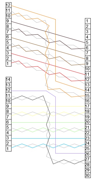

                  I need help to repair this cable:
                  http://i61.tinypic.com/zwjn8y.jpg
                  Could anyone explain me how to properly connect this 3 connectors A,B,C
                  example: A1 - B6, A2 - B2 .... A24 - Cx
                  and which of wires to TWIST?
                  Thanks everyone who can help me!
                    Re: Dell 3008wfp faulty power supply
                    That is one hell of job!!!
                    I have only seen 3 cases of that - here is one
                    https://www.badcaps.net/forum/showth...008WFP&page=12 start at post 240.
                    I think you will just have to replace it wire by wire
                      I have replaced wire by wire, but forgot to twist wires. I think, this is only problem. However, I like to check if cable is properly wired.
                              TMDS Cable the scheme, on the future
                                Thanks for posting that- could be helpful in the future
