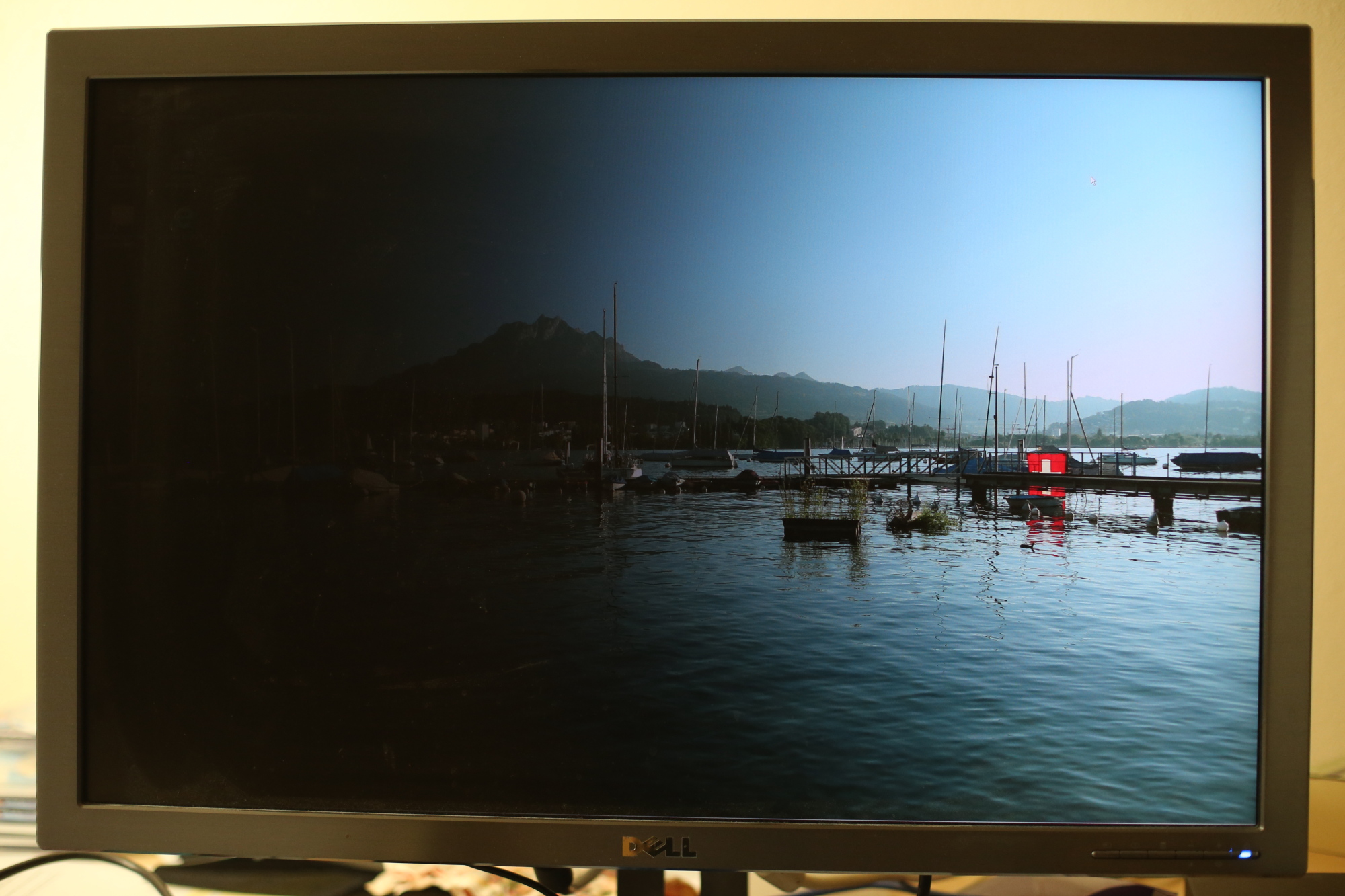

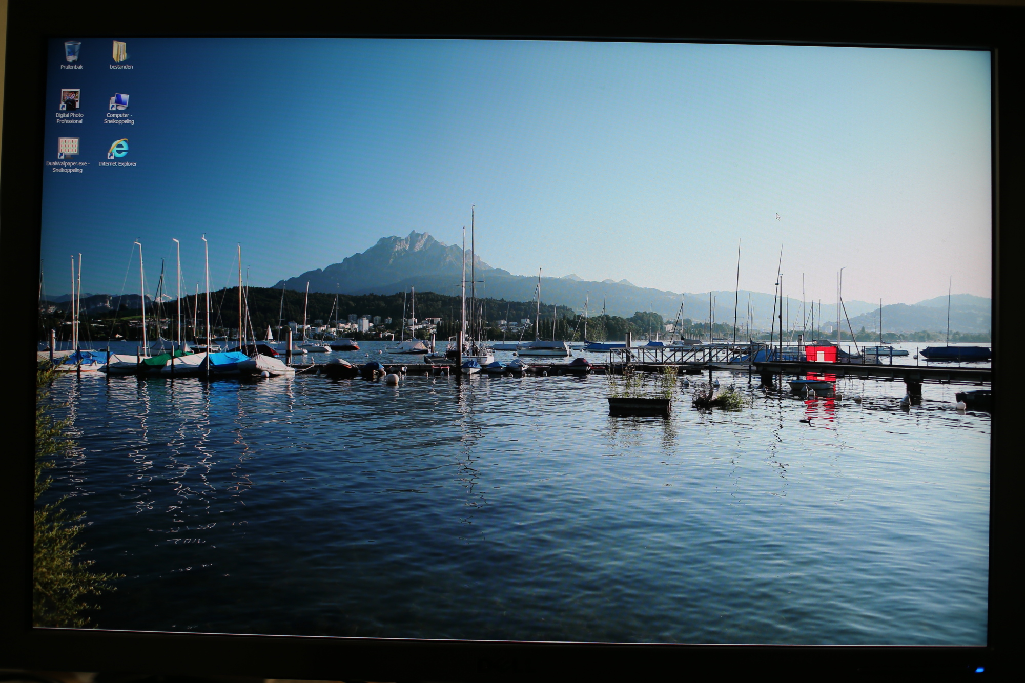

Re: Dell 3008wfp faulty power supply
This forum is *very* helpful!
I will certainly follow those nicely detailed & photographed steps; thanks for the links.
However the plot thickens. Yesterday the following went down:
1. I kept the monitor (while in failure mode) on for a while *without* any signal being sent to it.
2. All of a sudden, the screen pops up again! (blue screen: no signal)
3. Connecting the DVI cable with a signal on it makes it go back into failure mode (i.e. black).
4. *Disconnecting* that same cable makes the screen switch on again!
So after a while I thought: let's connect the thing with an analog cable.
5. It worked!
6. After a while I switched it back to DVI --> it worked! (including full-res)
7. Putting the computer to sleep --> display into hibernate (orange LED).
8. Switching computer back on --> Display starts flickering again!
9. Unplugging power cord & plugging back in --> no avail (still flickering)
10. Another computer sleep (orange LED) and back --> display works again.
I included 2 images: one of the screen in 'flicker' mode and one in normal mode.
Before I open it up I think I'll explore this failure mode a bit more. Particularly if the analog connection has had anything to do with it.
If I can get a workaround, I don't have to open it during Christmas
I'll update later. Thanks again.Comment
That's great advice Selldoor. I'm beginning to think this might be a different problem......
EDID corruption. I remember reading about this while doing some research on a Dell 3008 stuck in a color cycling mode.
Fabian. You can read the thread at Dell right here... http://en.community.dell.com/f/3529/t/19249766.aspx
Technical info on what EDID is here.. http://en.wikipedia.org/wiki/Extende...ification_data
And the only known software with instructions provided by Dell to fix this (since removed by Dell, but hosted here) http://darkshade.homeip.net/cgi-bin/...?m-1318862778/
*****Important****** Any time you are dealing with firmware, or flashing, there is a danger that something could go wrong and the EEPROM could be rendered totally useless. Since the Dell 3008 has 2 DVI ports. Check the other one to see if it works. You could always just use the VGA port. Or HDMI. In other words. ***use at your own risk***Comment
