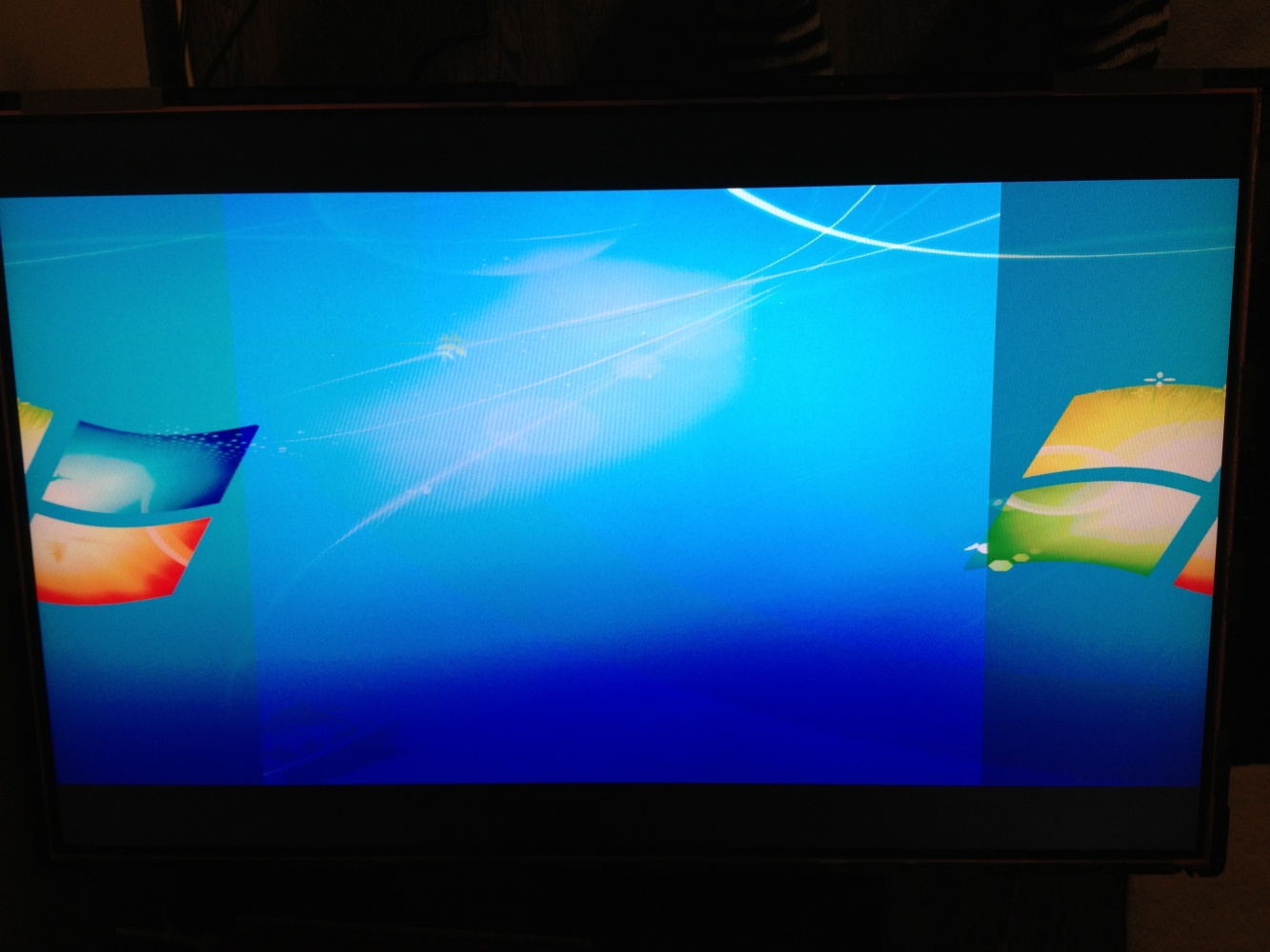

    A few days back i turned on my Dell 3008wfp monitor and i got this nice image. I kept it on for like an hour and the image didn't change.
    After reading most of the threads here all the issues point out that the capacitors/condisators are broken/weak.
    But i cannot find any broken capacitors/condisators on the board or in the power supply. I have taken a few photo's.
    What i do notice is that the signal input board has strange brown stuff on the back.
    Do you guys have any idea whats wrong and how i can fix this?

      So I got the new tcon board from Buyqual. Although it was 6870C-0183E instead of 6870C-0183D and is not entirely compatible with the display I managed to revive the lower part of the dispay by pressing on the lowest ribbon. It seems that the tcon board is faulty and I just need to find a correct replacement.
      I attached a couple of pics of the current situation. The first image represents the situation before I applied pressure on the ribbon. The second pic shows the horizontal displacement of the image caused by the incompatible tcon board. The black bars are due to the image source.
      By the way, Gurty's images are quite similar to the partial image distortion I got with original tcon board. Maybe that's due to the tcon board failure as well?

                    Gurty, I had the brown residue on my logic board, too. I don't know if it's excess flux from the manufacturing process, heat damage to the board, or what. But it didn't seem to affect the function of my display, so I didn't try to do anything about it.
                    My repaired monitor is still going strong!
                    Aaron
