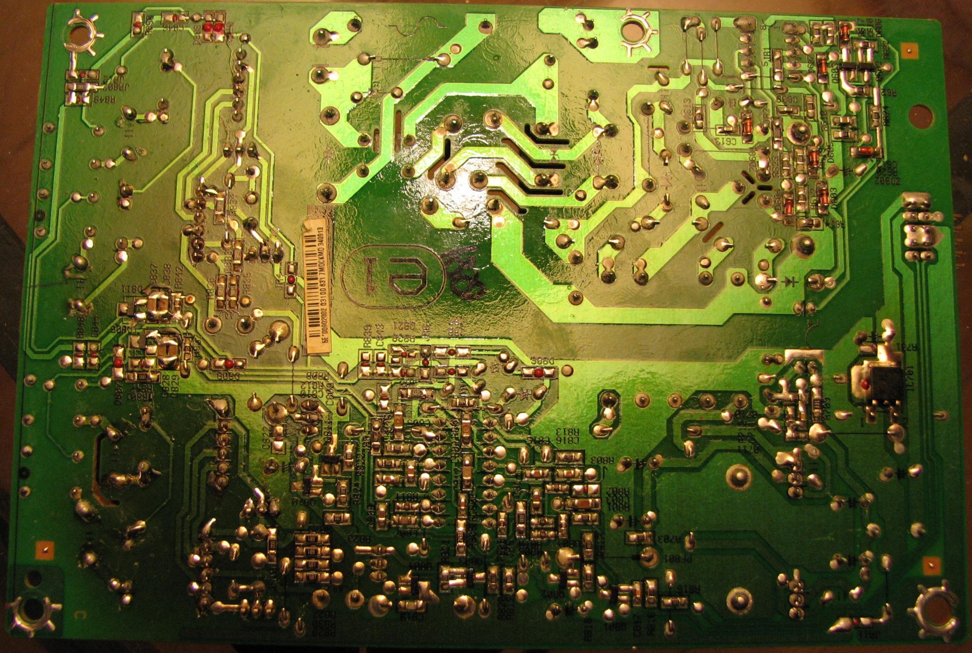

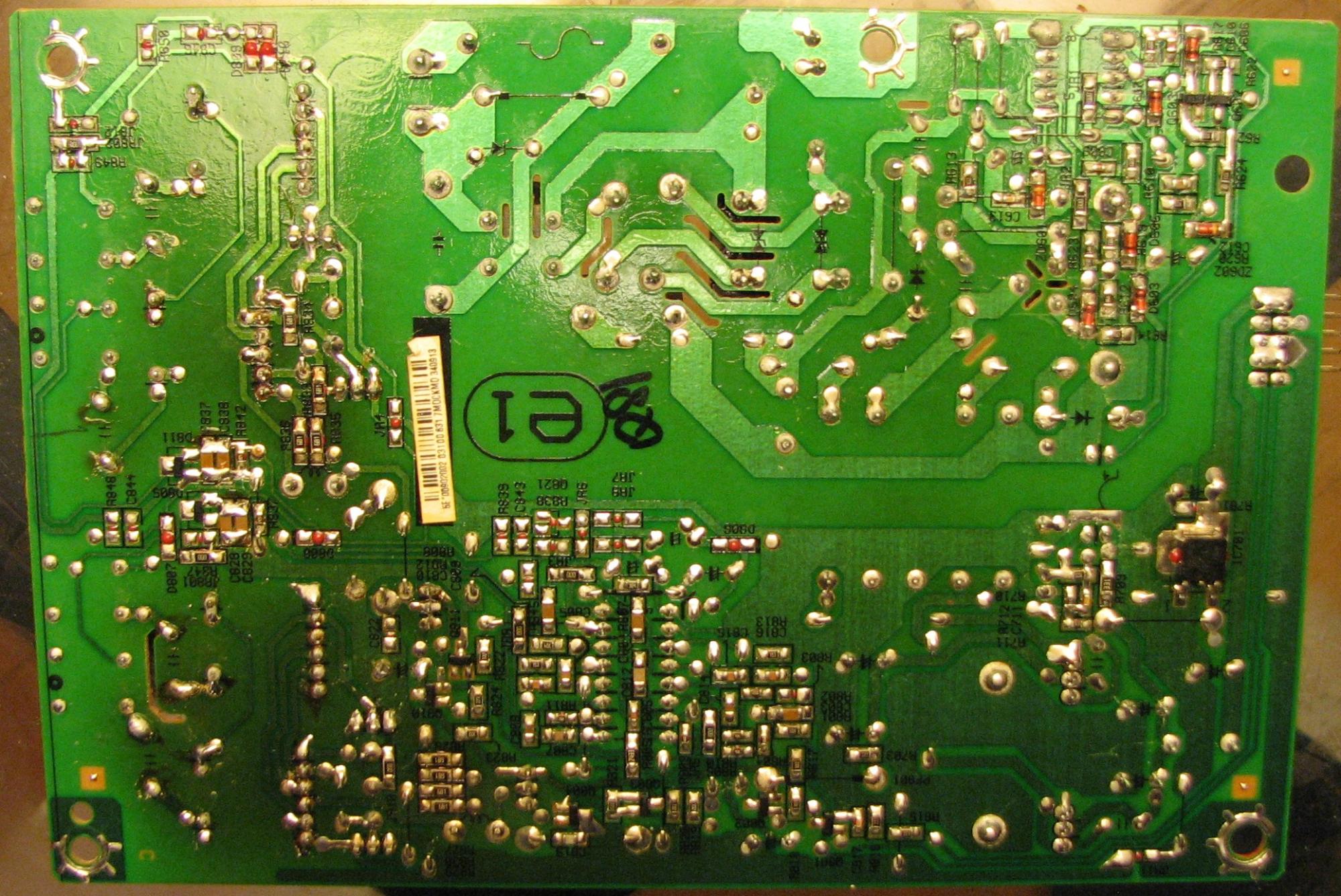

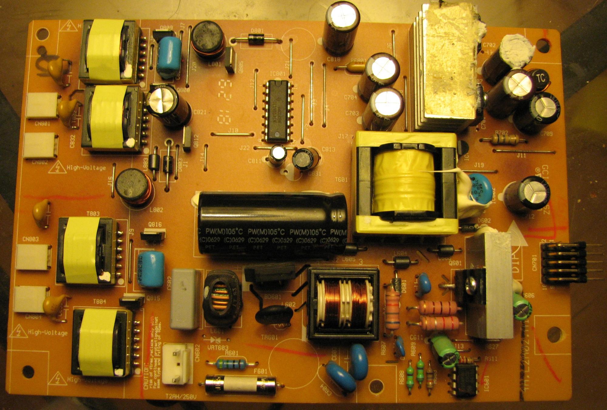

    I dont know where to start. The monitor is a Dell E177FBp, i changed 2 caps to make it power one now its have 2 sec to black.
    I tested it with an other panel and it do the same but tale a little longer.
    Here are the pics, i dont know what to do now?
    i changed C821 only
    IC801 = 66clcem, tl1451acn
    IC601= 1200AP40, CPCD, 0618G
    I have a DVM and a scope but i dont know how to use it yet!
    thx for your help!

    Replace the rest of the electrolytic caps with name brand, low ESR caps such as Panasonic FR, FM, or FC. Resolder all the transformers.

        1) What is that "crud" on cap C702?
        2) With power off and lcd unplugged, measure across the secondary inverter transformer pins with your multimeter set on 2000 ohms.
        The pins on the backside will be the ones "leading to" yellow high voltage capacitors. You should get a reading the 250 to 800 ohm range as a guess.
        Measure all 4 and report the findings.
        Normally, I would mark it up on supplied picture, but I'm having a bit of a difficult time mapping it spatially (maybe because I had to get up at 4:40am this morning).

            it is heat sink compound like on computer cpu . i will test those inverter today. Do i test acros high voltage output?

                      I am unsure why no one has recommended checking the 5707 transistors. On this monitor They can fail and not take the inverter fuse out. If one or more are bad there is a good chance you can find it by hooking up one CCFL at a time and then powering on the monitor. Those particular CCFL connectors will not even briefly light the CCFL.

                                    You also needed to check the 2 FET's located at Q812 and Q805. I fixed a similar board earlier today, and one of the FU9024N FET's was shorted. Hopefully your repair kit includes those.
                                    I ended up having to replace a shorted C5707, a shorted FU9024N, and the fuse at PF801 was blown also.
