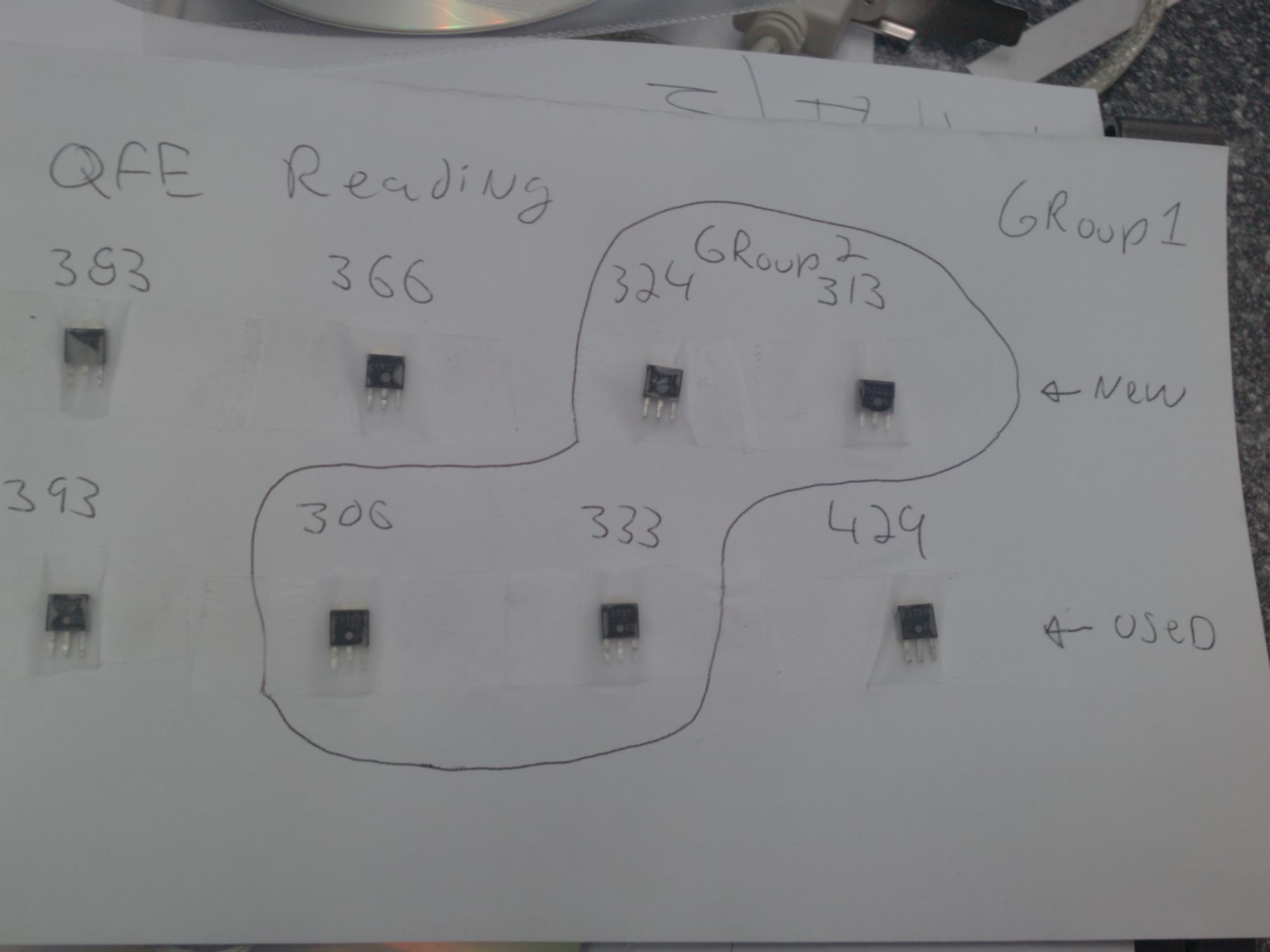

    here are the hfe reading form the old and new parts i will try group 1 since the are all above 350! Let me know what you think!
    • retiredcaps
      • Apr 2010
      • 9271
      Re: DELL E177FPb im ready for my first troubleshooting! need your help!
      Did you check out the ccfls with a "good one" as per post #10? If you have a spare lcd, it is easy to do.

      • pr0cess0r
        • Jan 2011
        • 110
        yes but i will try it again to be sure!
